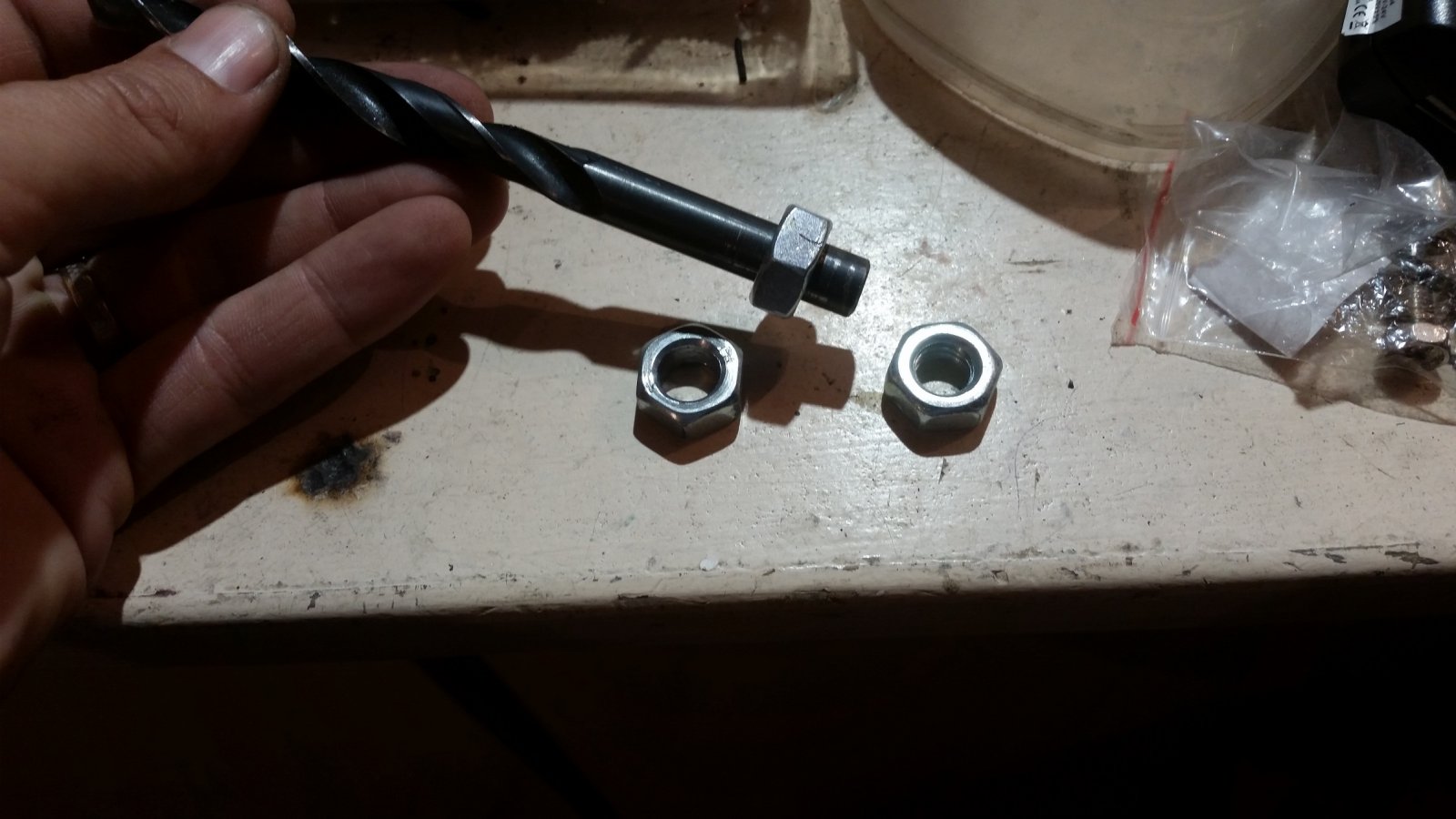

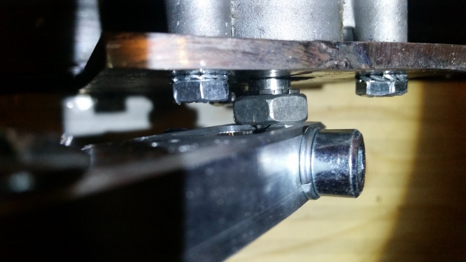

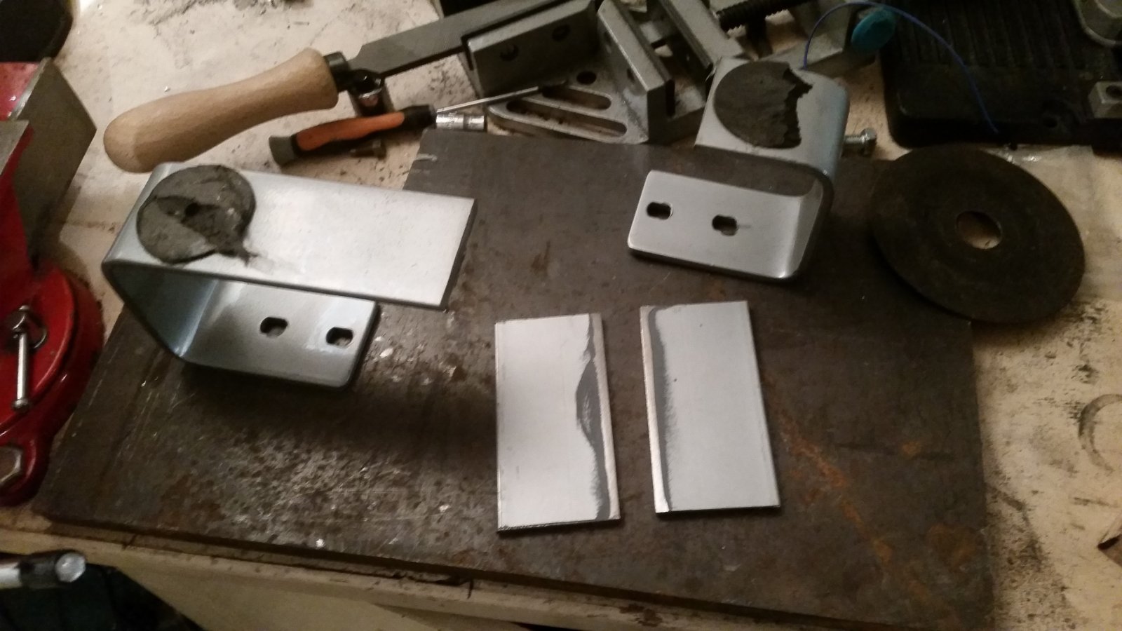

    Drilling a nut to make a spacer for the motor shaft

    View of the shaft with the arm and the spacer

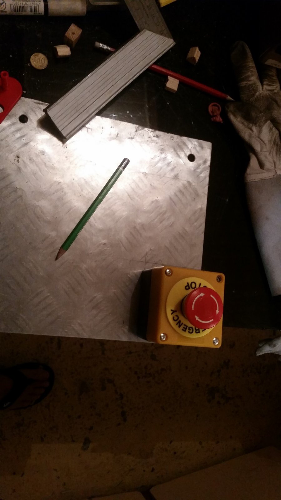

    The support of the emergency stop

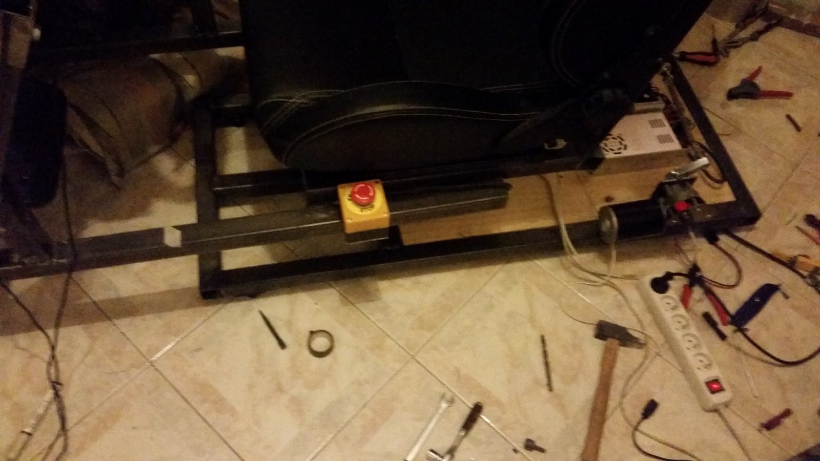

    The emergency stop installed and wired

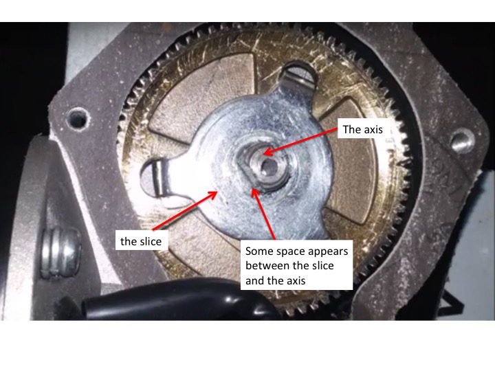

    Hello, I have a problem with the motors, the axe can move around 3/4 degrees in both directions when the motor don't move.
    I followed the tutoriel to add a bigger slice to remove this space in the shaft of the motors but the problem is the slice between the axis (wich hold the arm) and the gear, does someone know how to fix it ? jeu moteur simu.jpg

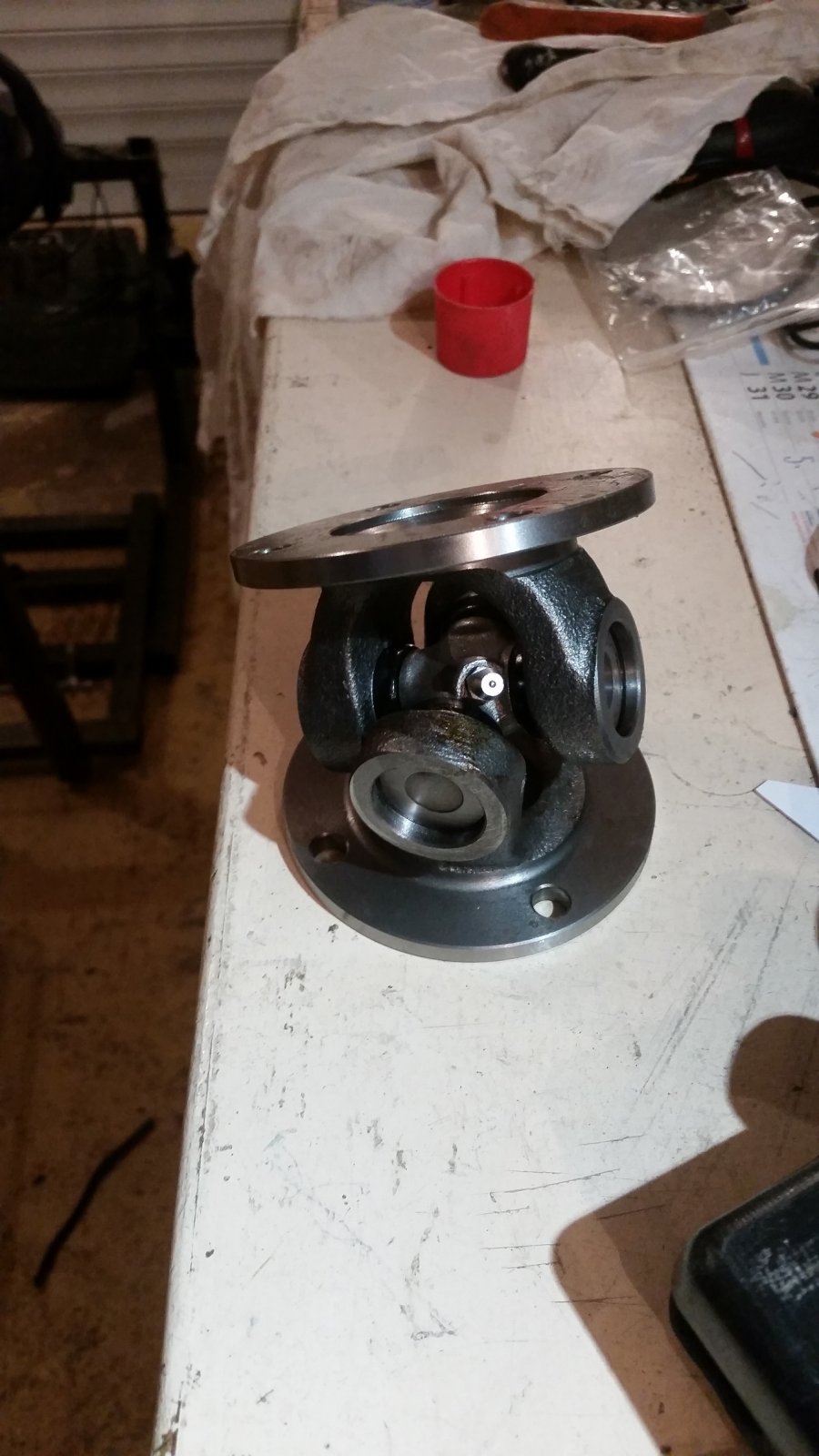

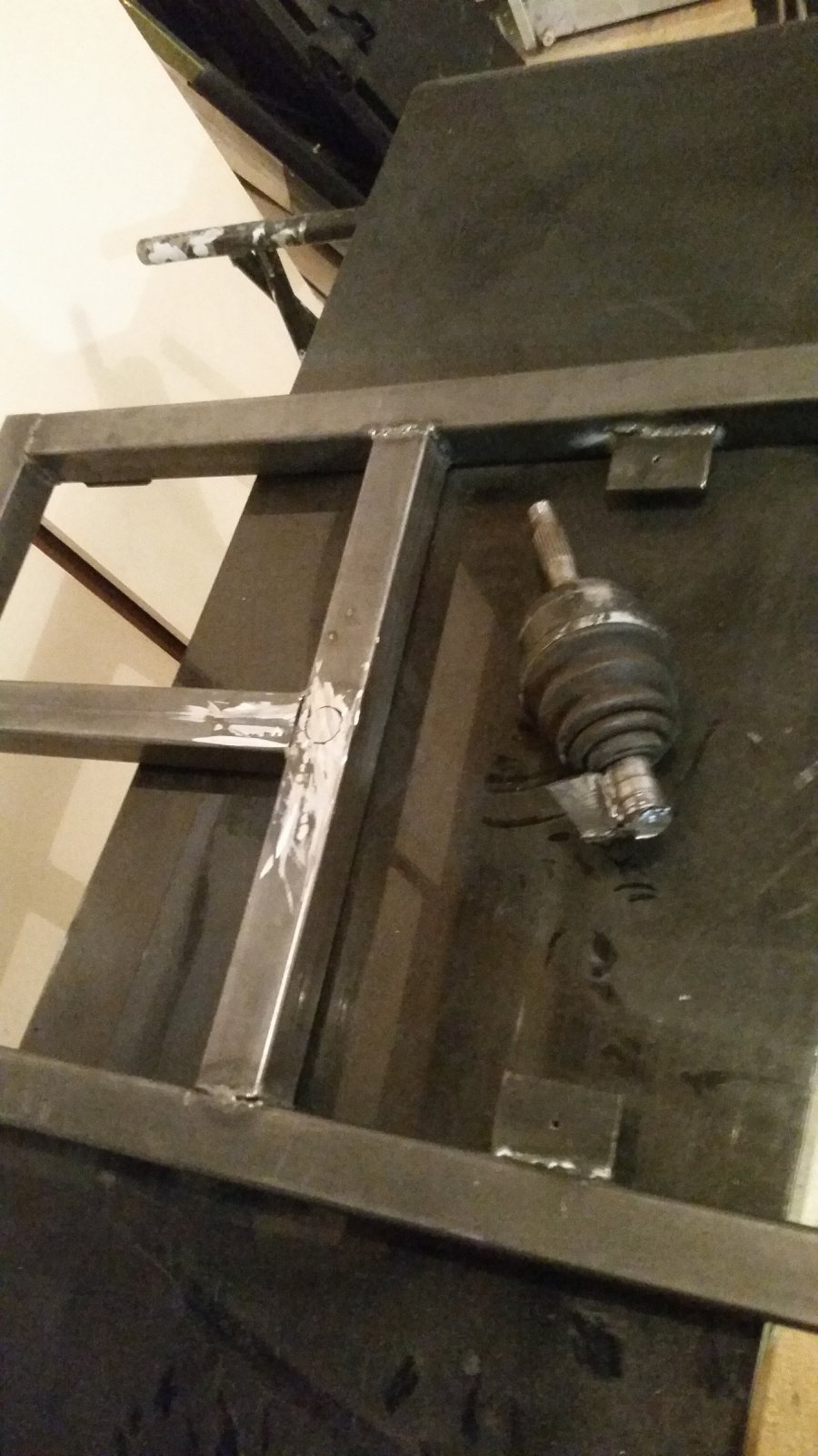

    Breaking the old U-joint to install a new one

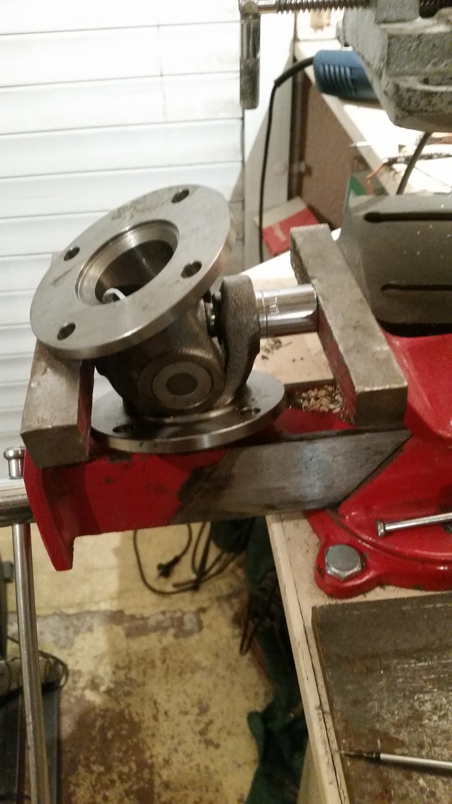

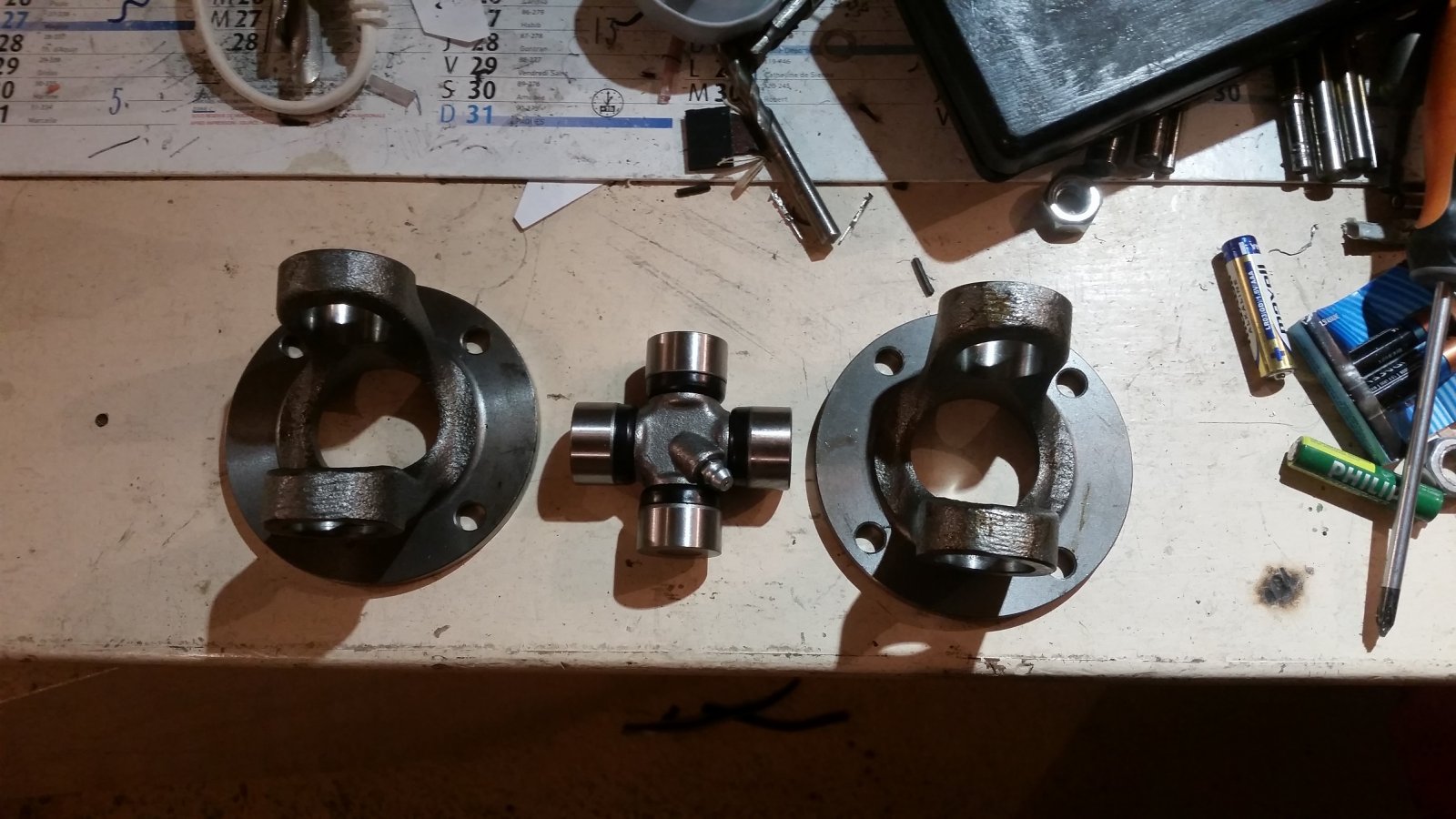

    The new U-Joint

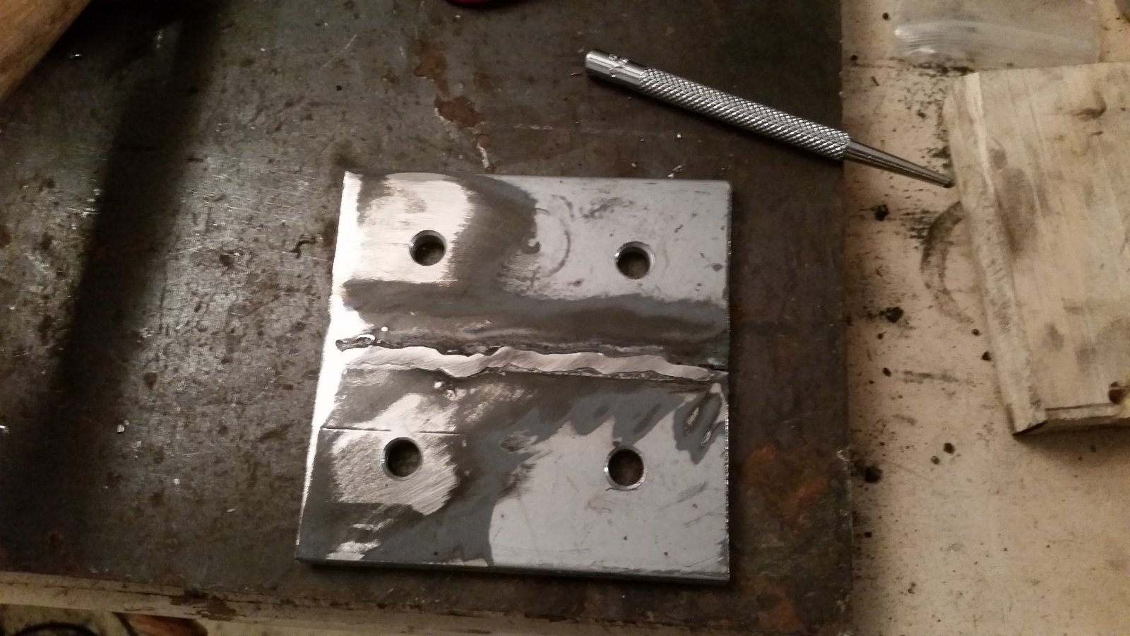

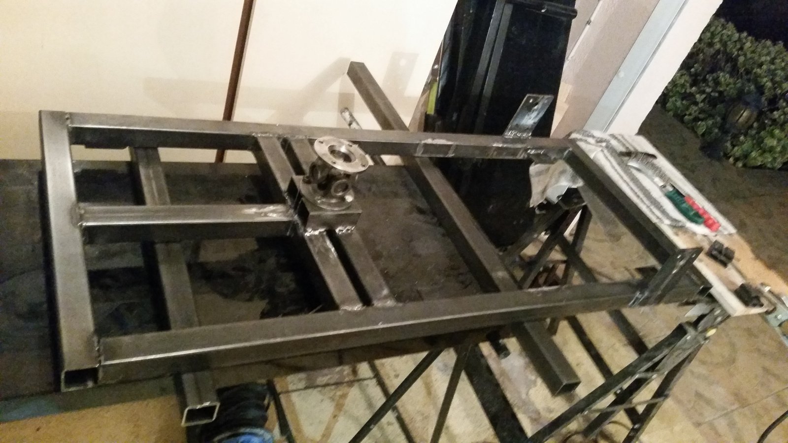

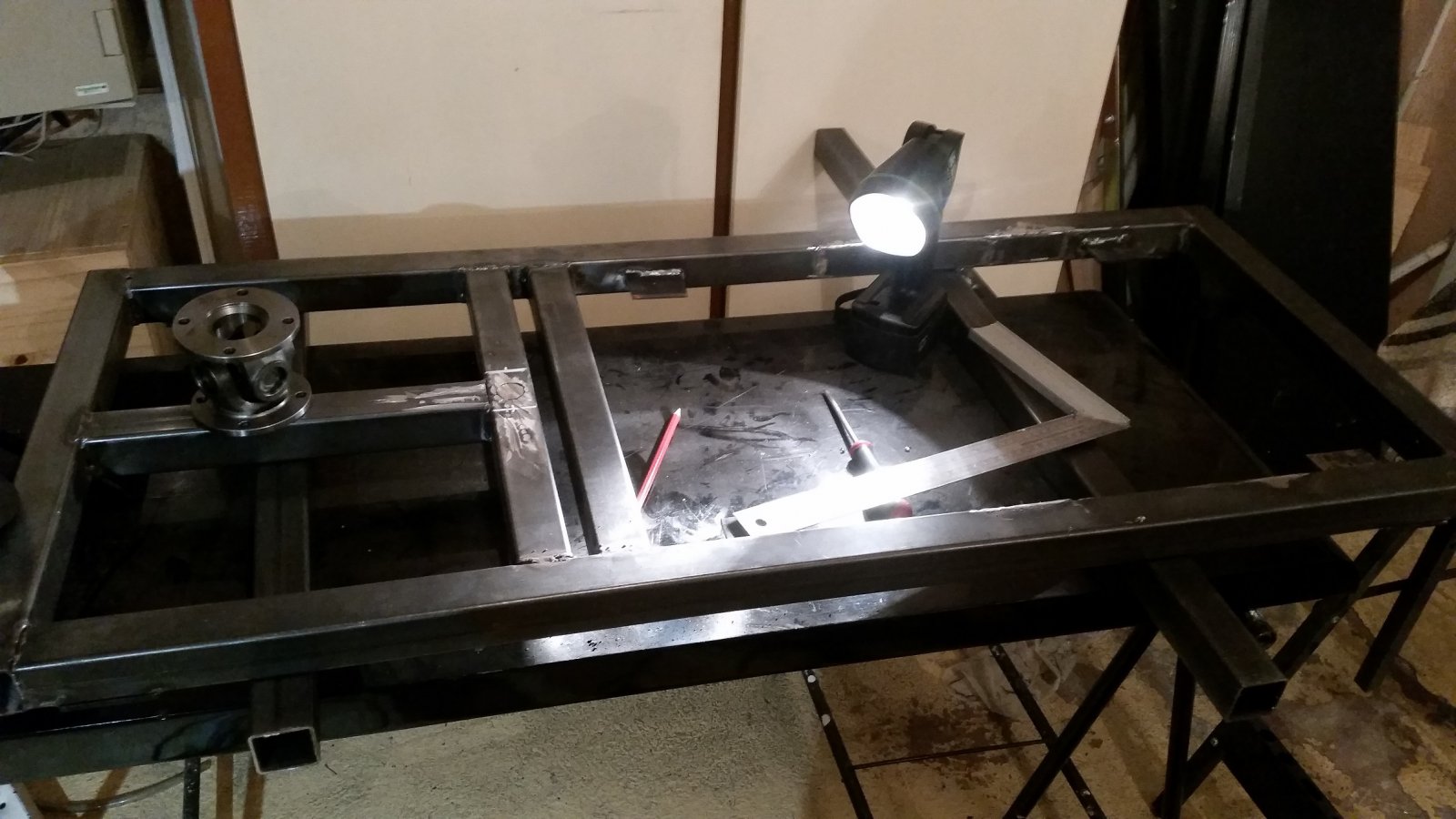

    Reinforcement of the structure to hold Ajout renfort U.joint.jpg the new U-Joint

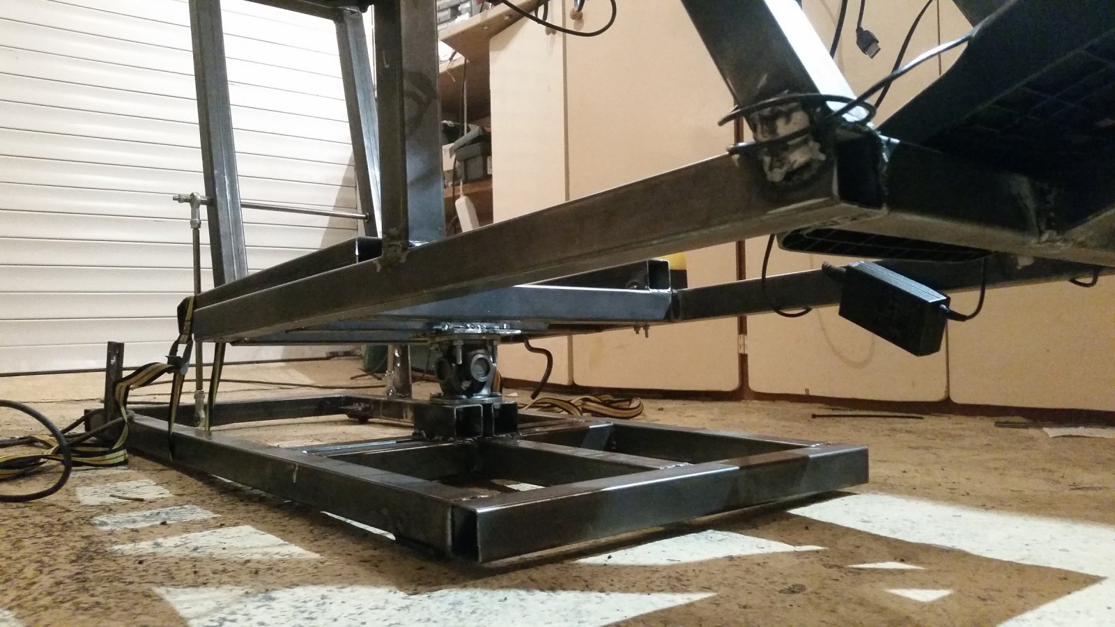

    Support fot the U-Joint

  15. creazyrider
    creazyrider Active Member
    Sep 12, 2017
    197
    france
    850Coins
    +56 / 1 / -0

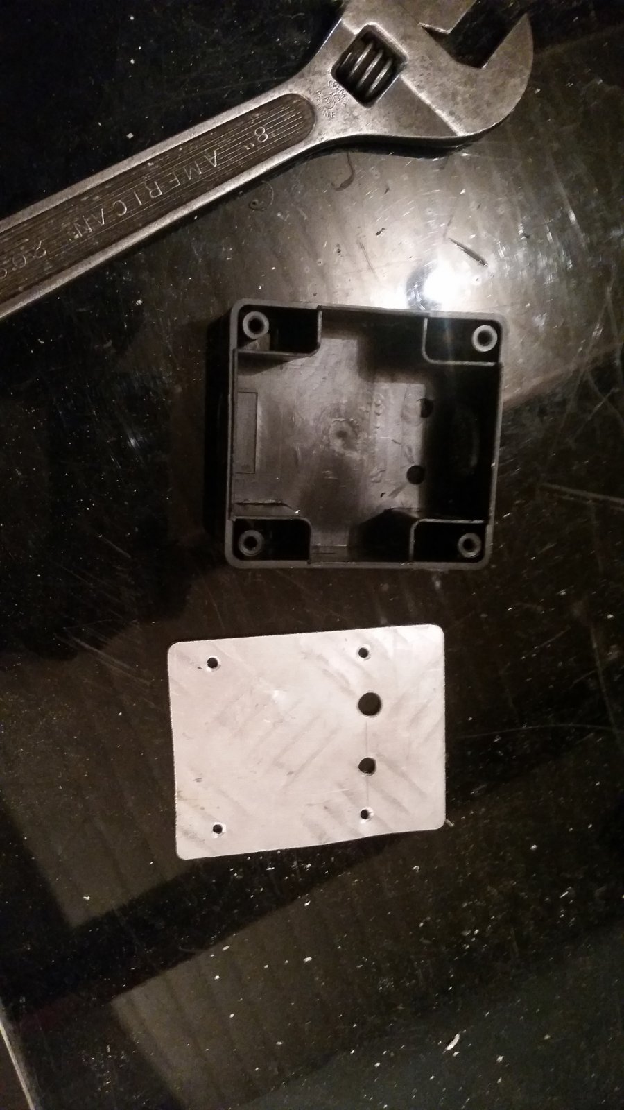

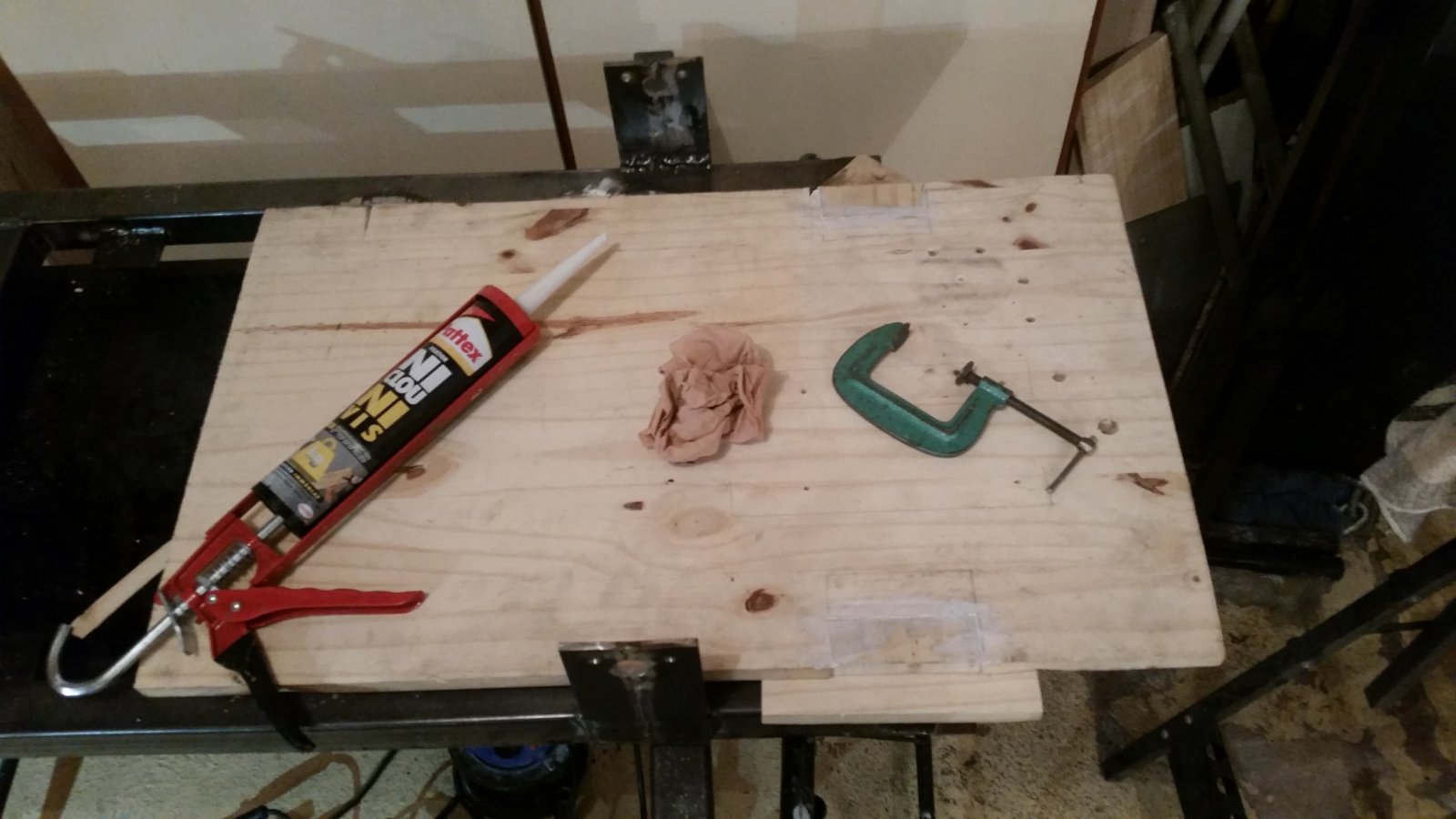

    Modification of the plate for the electronic
