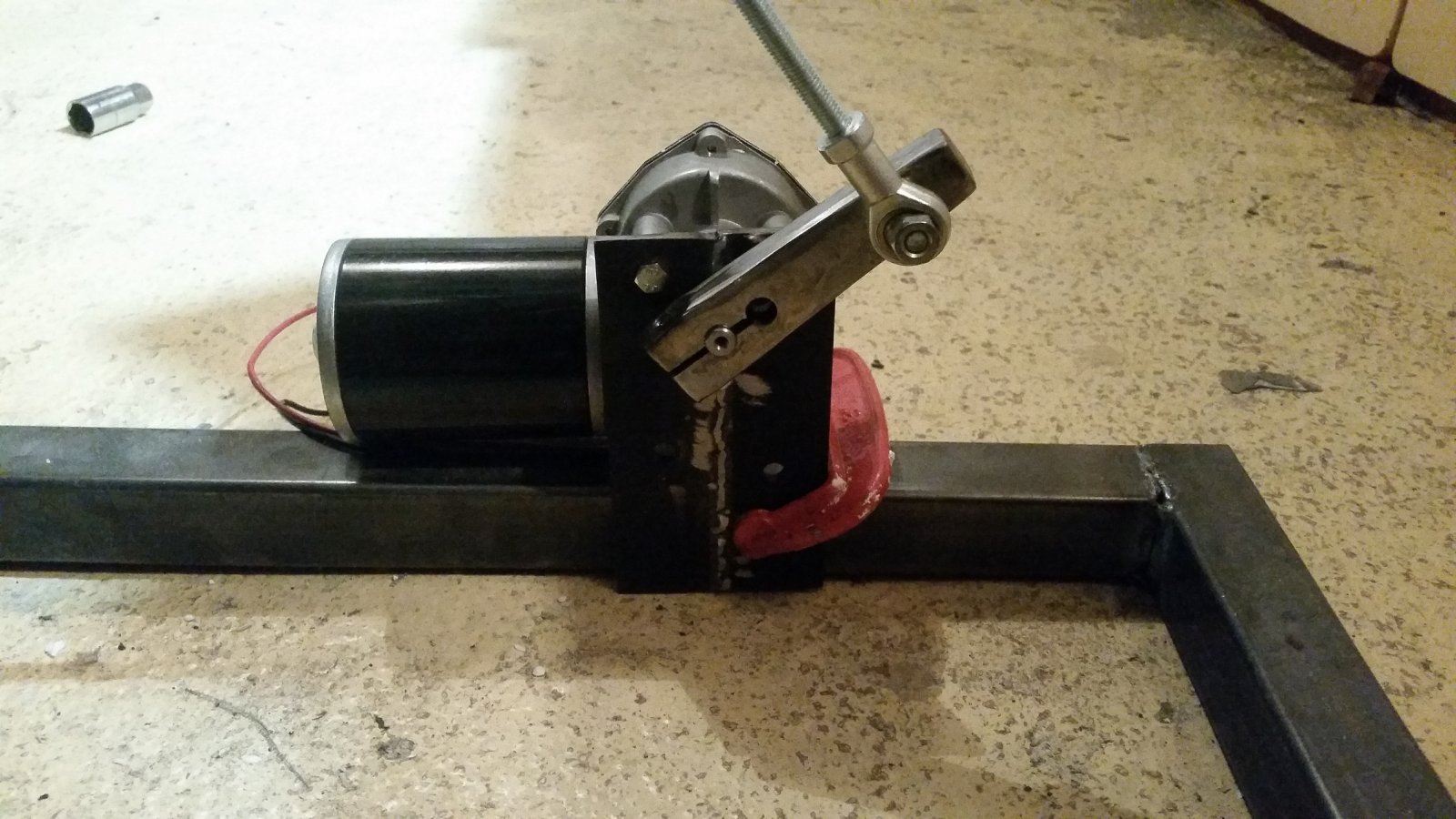

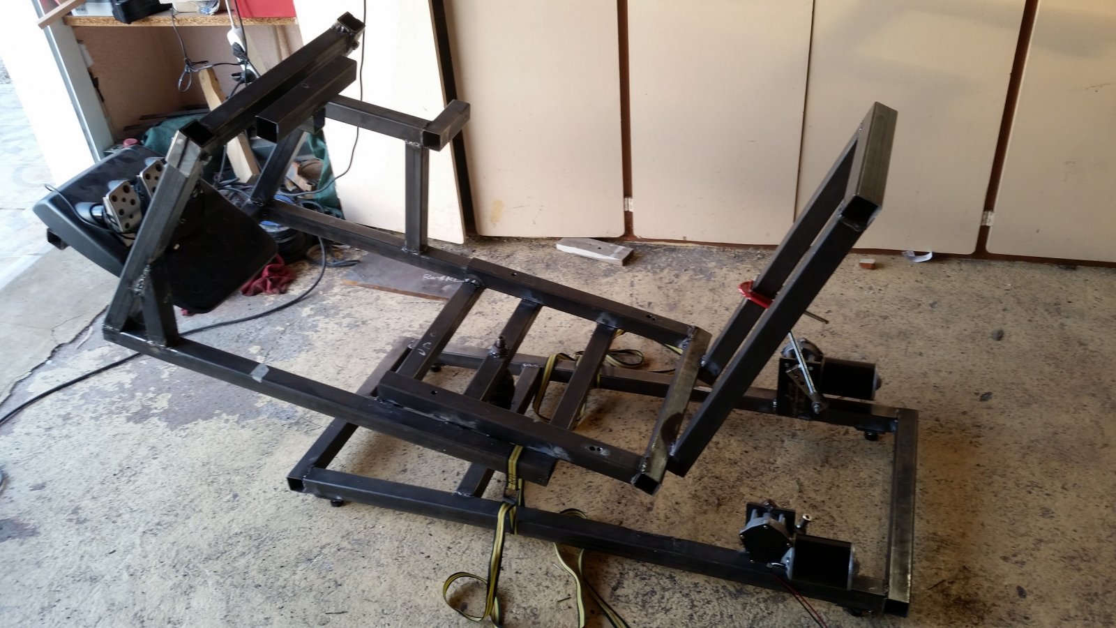

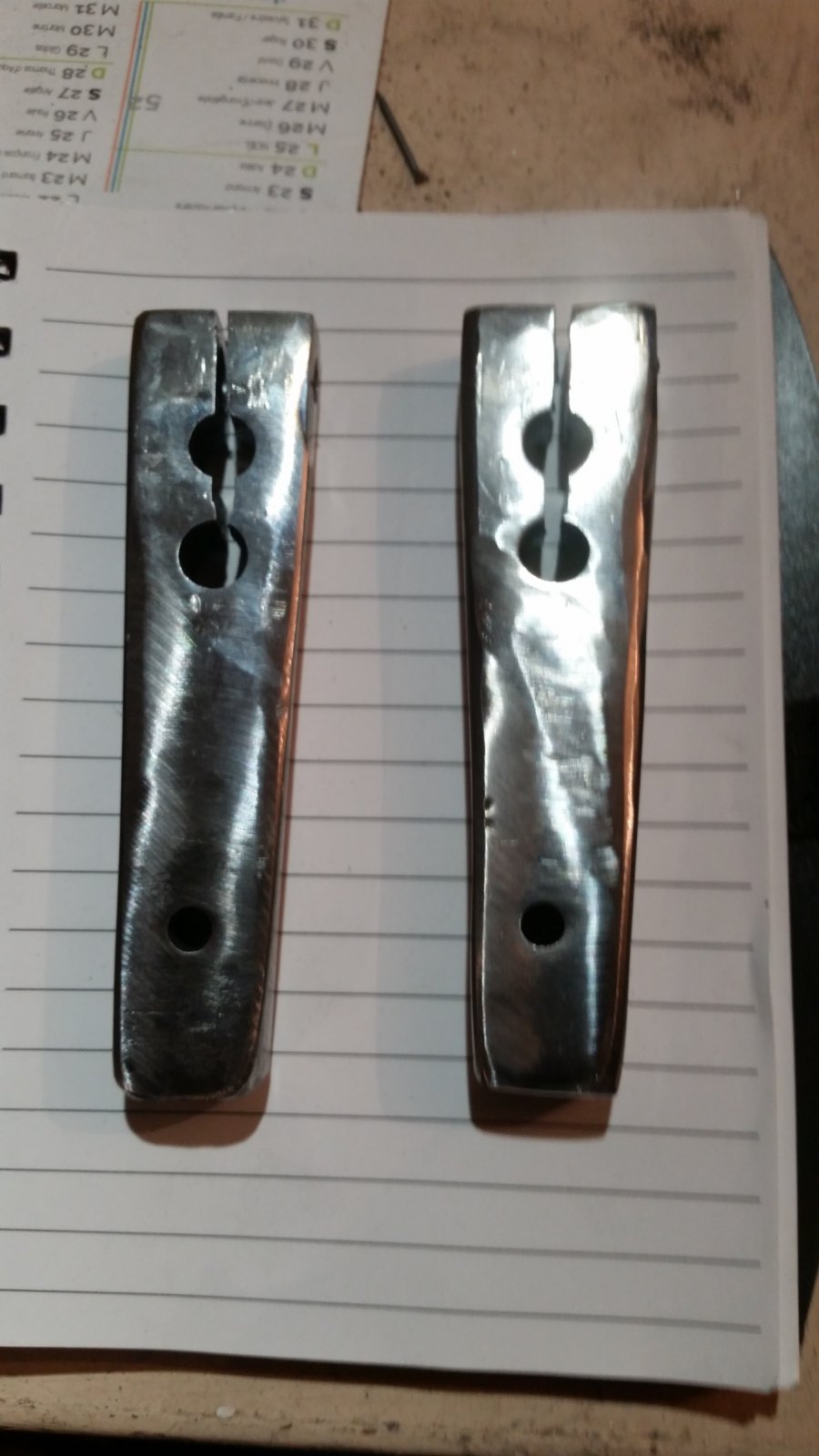

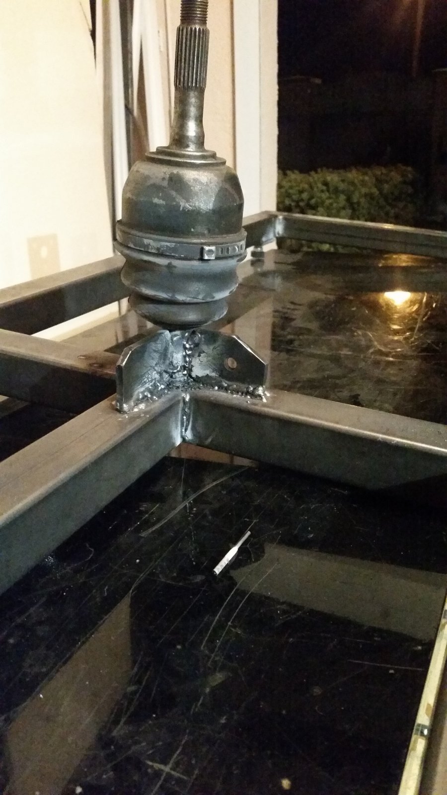

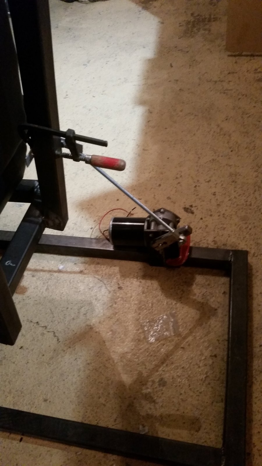

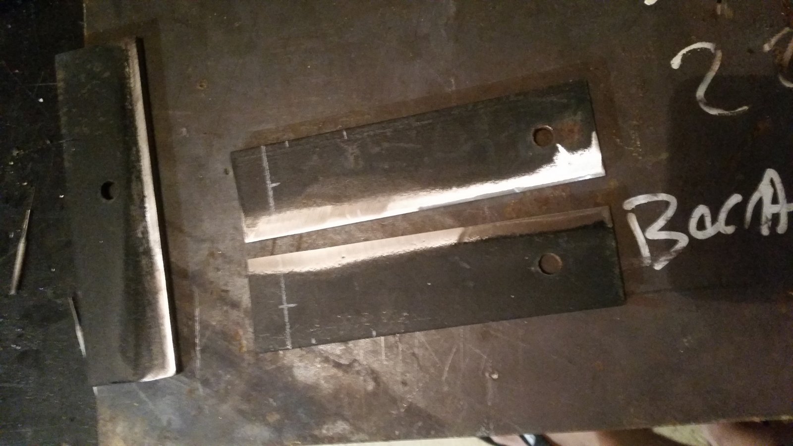

    The arm finished

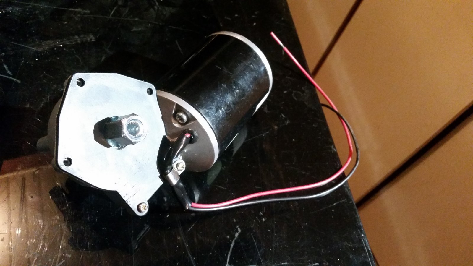

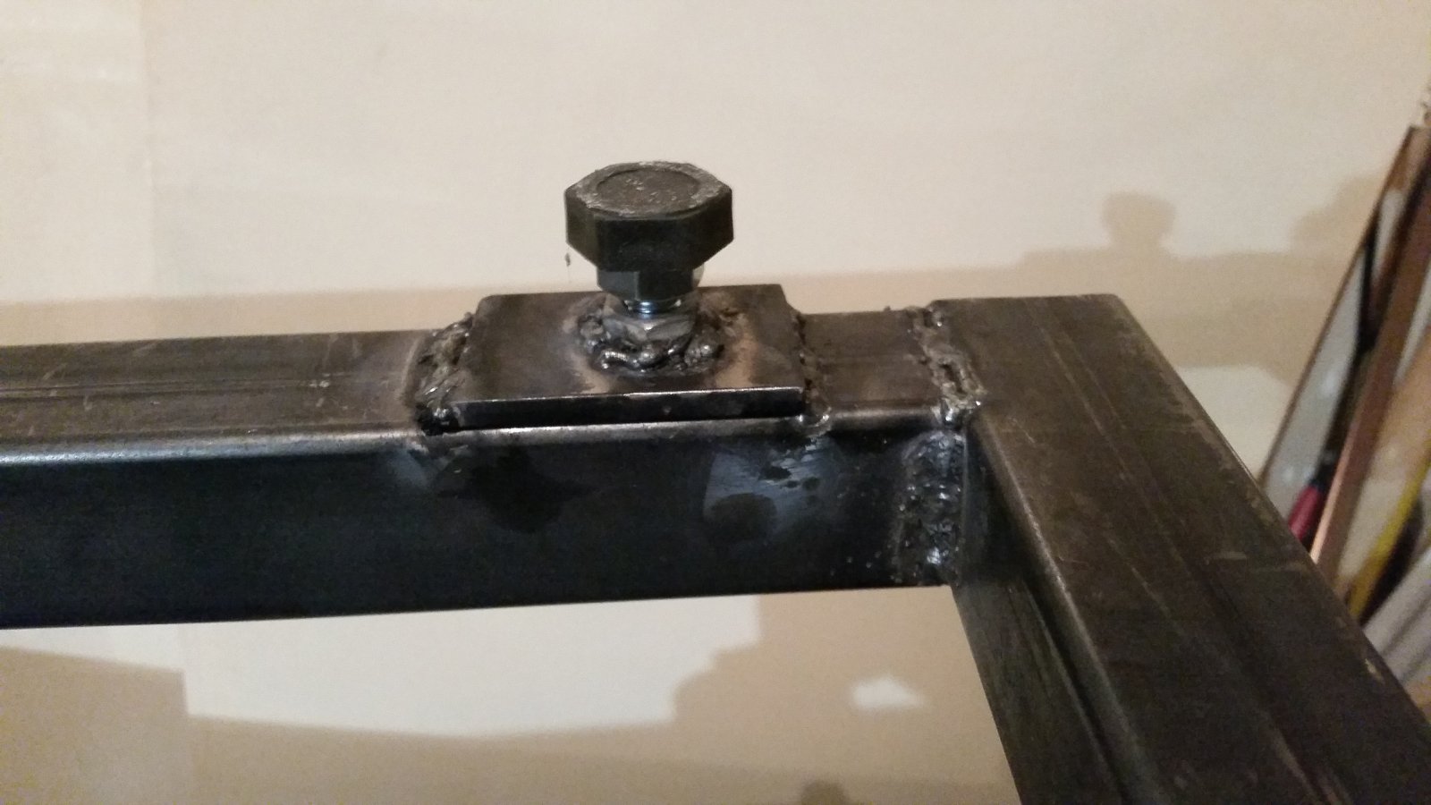

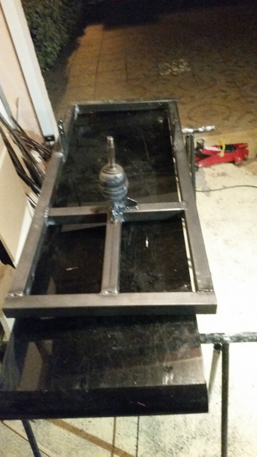

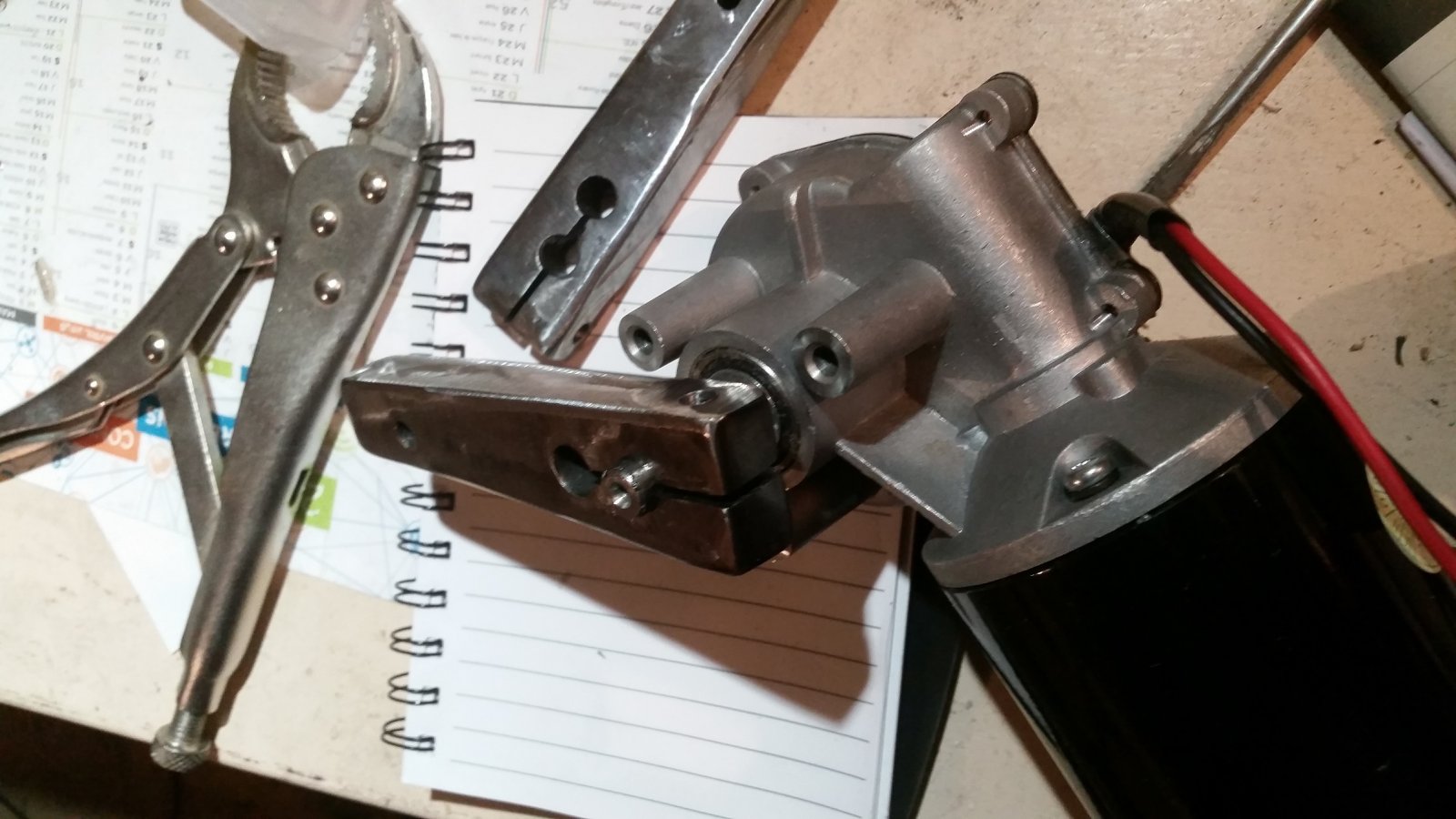

    Fitting in the shaft of the motor

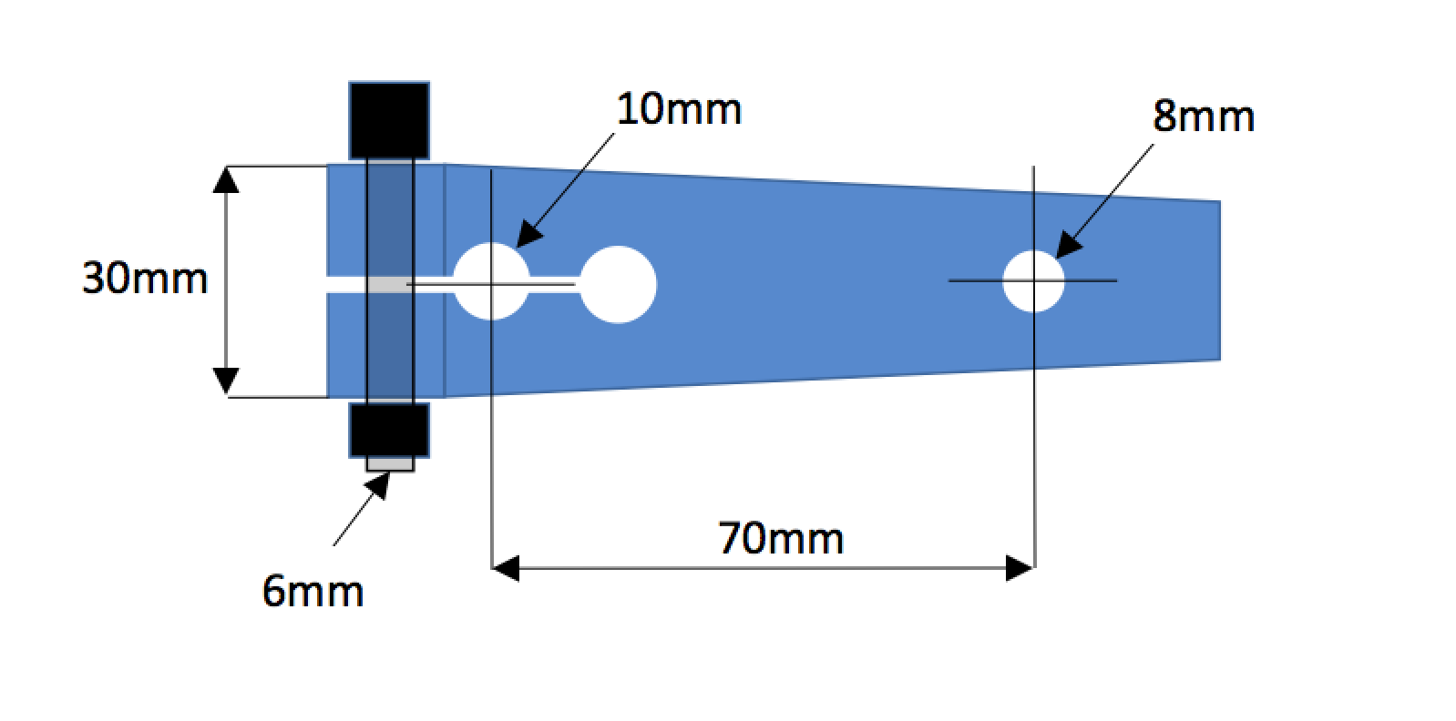

  4. Poo9jao
    Poo9jao I Like all Mod
    Jul 22, 2018
    9
    Coppy Machine Service Engineer
    Bangkok Thailand
    146Coins

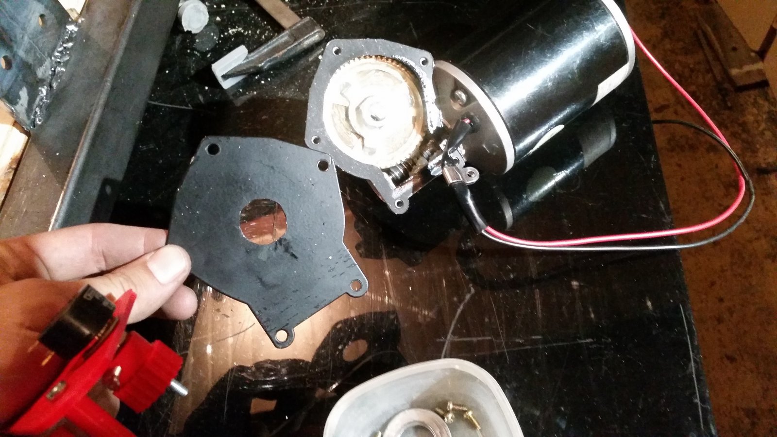

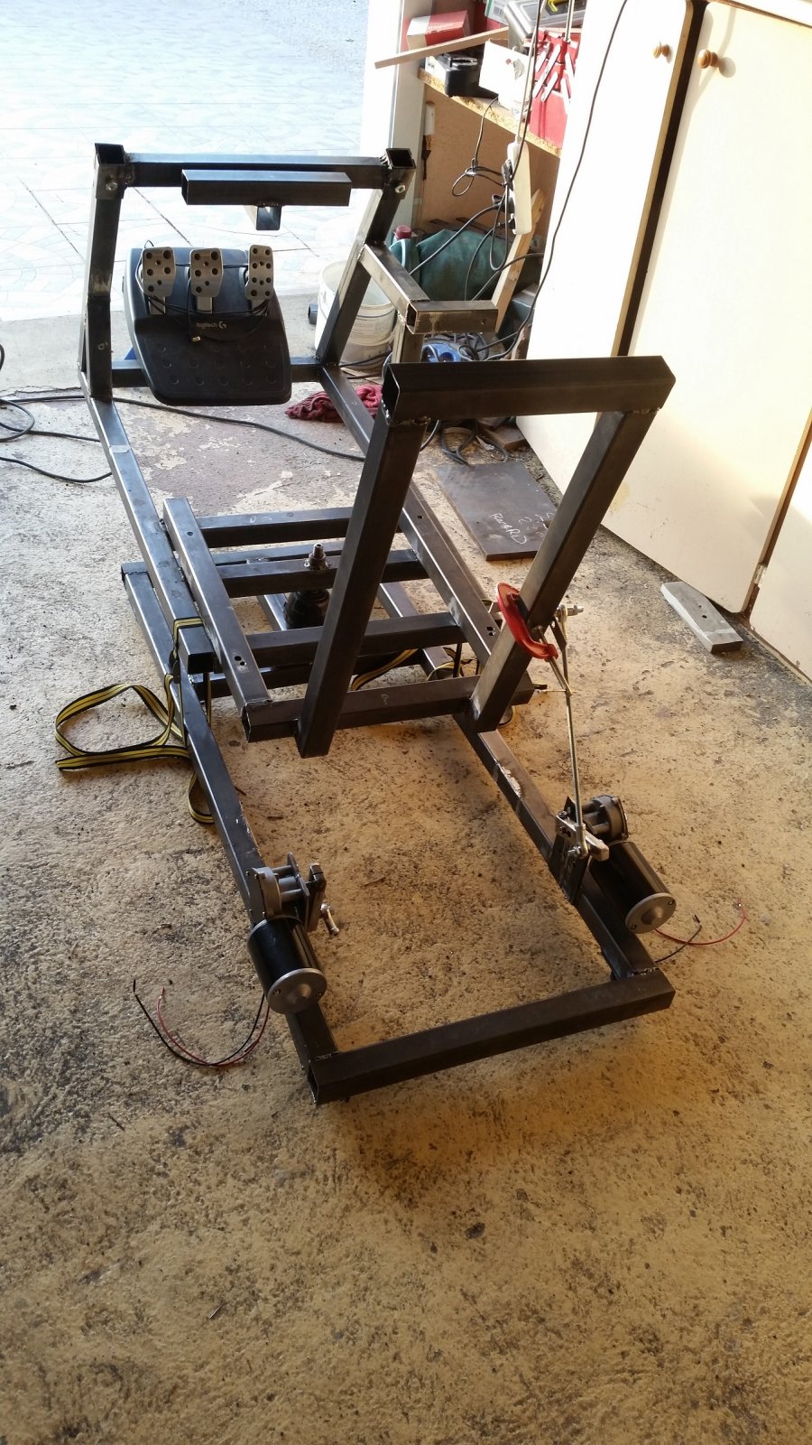

    how much dimension

    Here is the drawing

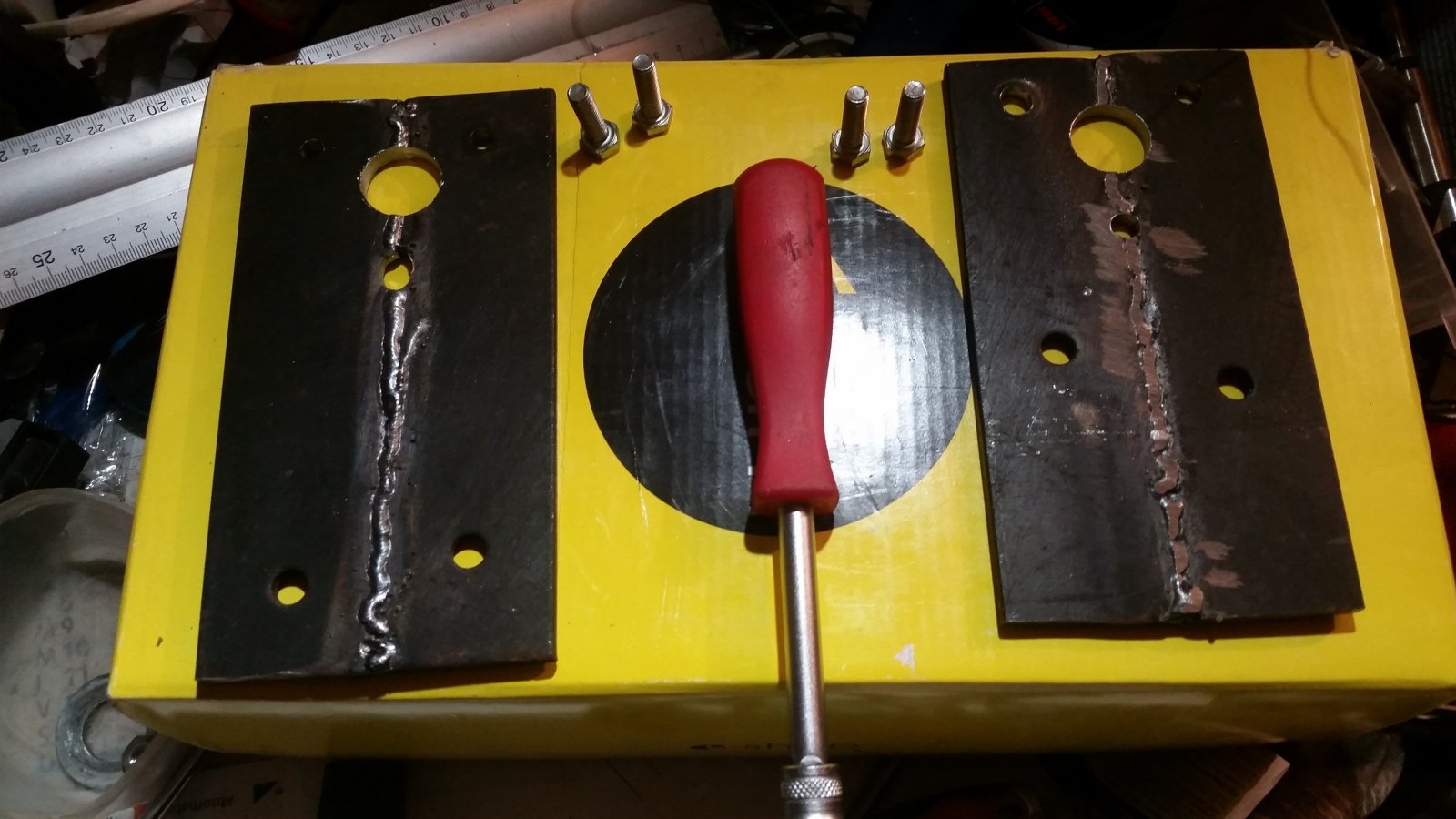

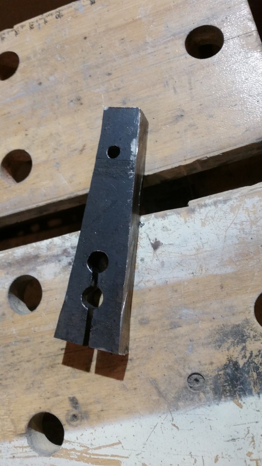

    The motors mount

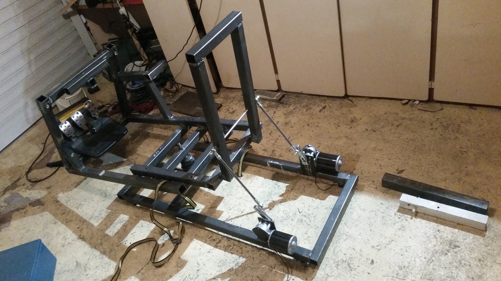

  10. creazyrider
    creazyrider Active Member
    Sep 12, 2017
    197
    france
    850Coins
    +56 / 1 / -0
    New
    Reinforcement of the U-joint in the both axis
  11. creazyrider
    Sep 12, 2017
    197
    france
    850Coins
    +56 / 1 / -0
    Adding feet reinforced with a 4mm metal plate

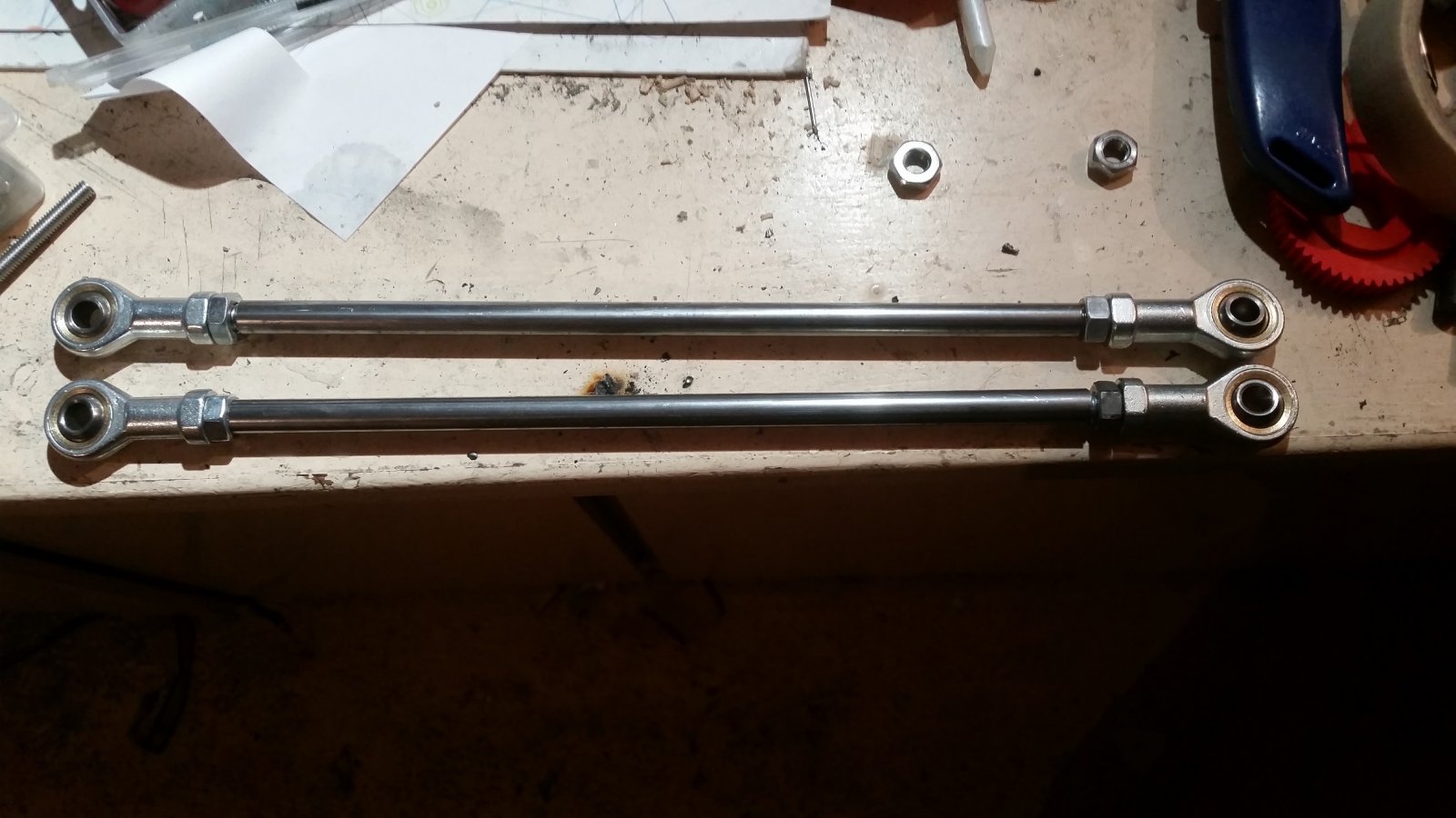

    Building the Rod mount

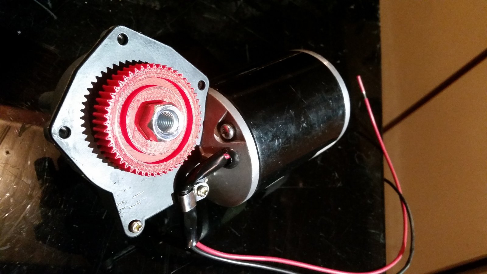

    Thanks to Simukit for the printed gears
