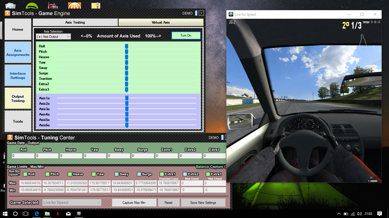

    i already try to do everything of this post, but i have no succes, the tuning centre don´t work

    no game response in tuning engine...
    21,584
    151,118Coins
    You are using SimTools 2 so instead of axis defined like this <Axis1> it is now like this to designate grouping for a or b <Axis1a>

    i still can not get telemetry data for tuning engine

    i have movemment in axis testing
    21,584
    151,118Coins
    Axis testing outcome is good, so it is just configuration issues to sort out.
    Did you run LFS before patching it?
    If not unpatch LFS, run a lap or two, then repatch it for motion.
    Have you created a motion profile for LFS?

    Great!!!! NOW IT WOORKS!!!!
    thank you guys!!!
