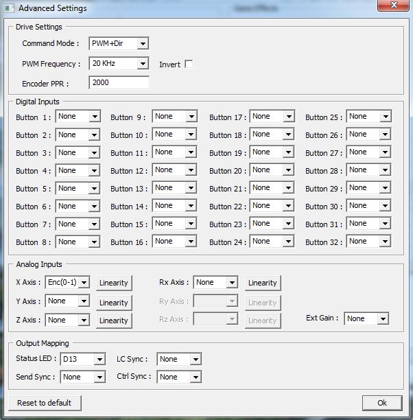

    Post up your settings for the advanced screen and the main screen
    Are you running the 'dev' mode of the software ?

    Leave the z channel disconnected and fit a resistor to gnd on channel 6
    Turn everything off and on again then connect the channel 6 to ground when you select calibrate.
    Look in your wheelconfig folder you should see a icon called dev - it displays the counts of the encoder

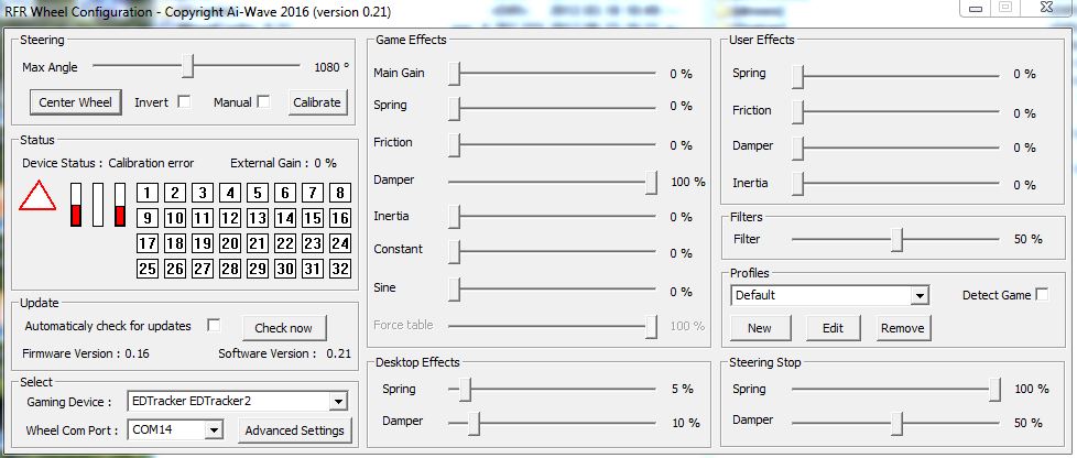

    The only problem is the calibration error message. It pops up as I open wheelconfig and can't make it go away even with the ch6 gnd switch.
    I use a leonardo.
    Earlier I flashed a pro micro with the EDtracker firmware, since then every leonardo I plug in has the EDtracker name in game controllers.

    I gave up on the pull-up resistor mess. Strangely when I connected Z index directly to ch6 on Leonardo, wheelconfig reported "Ready" state with no calib error, even the numbers were counting below on the dev panel. Only the triangle is dead, except when I reach index, then it moves a bit then snaps back to zero. That is because index is inverted.
    When I disconnect the index lead, the triangle starts working, but as soon as I hit calibrate it responds with error until I reconnect the index. Grounding ch6 or using switch does not help.

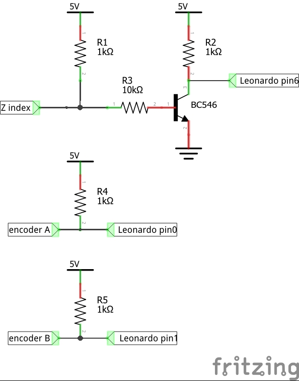

    I guess it won't affect them much, that is, if you give the pulse where it needs to be. Every pulse of the Z channel centers the wheel.
    Anyhow, I made some progress with the logic inverter. At this point, I can say it's all working, including the Z index.
    R1=10k
    R2=1k
    Q1: BC546 NPN transistor
    X is the input from encoder Z index, not shown on the picture there is the original 1k pull-up resistor to 5v
    Z is the output to Leo pin6
  20. Mbakos
    Mbakos Member
    Aug 30, 2017
    51
    Datacenter Technician
    Hungary
    545Coins
    +45 / 2 / -0
    Just for the record, this is the final result for OMRON E6B2-CWZ6C rotary encoder.
    Tested and working. Any other simple NPN transistor should work.
