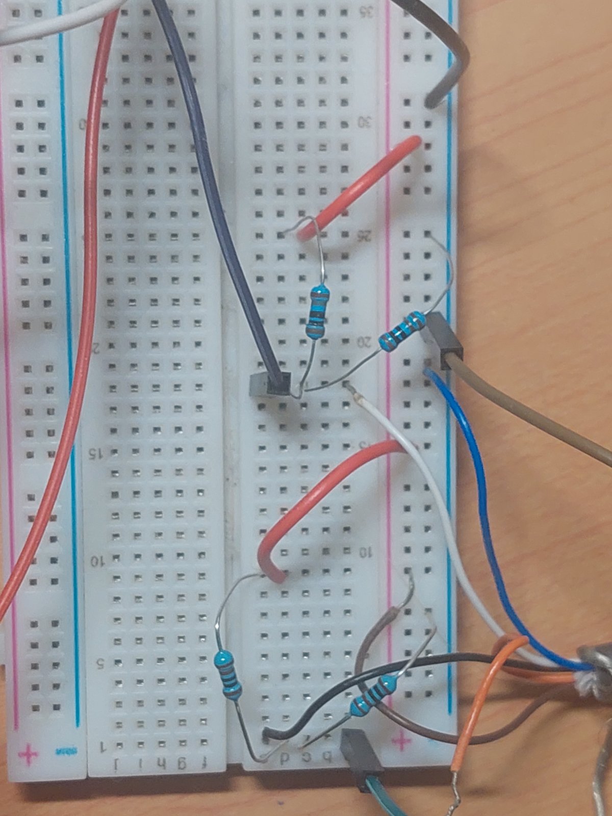

    Hi.
    I am using my1020 and when i rotate it manually (the power supply is not connected) it doesn't feel smooth and you can feel the magnets. I dont remember if it was like that in first place when i got it or maybe i screwed while disassembled it and put it back together.
    Any insights and suggestions?

  14. GaryG
    GaryG New Member
    Mar 30, 2021
    9
    112Coins
    You were right indeed.
    For some reason, I can't keep the steering wheel in the center, it keeps being thrown to the right or left. When i stop the car, the wheel just get crazy lol.
    I added a video to show this strange phenomenon:
    And i saw that if i steer the wheel fast it lose the right angel of the wheel.
    Any suggestions?
  15. Gadget999
    1,993
    12,162Coins
    +492 / 11 / -0
    Do you have pullup resistors on the encoder pins ?
    Do you have the correct number of pulses in the software ?
  16. GaryG
    GaryG New Member
    Mar 30, 2021
    9
    112Coins
    I use Omron E6B2-CWZ5B 2000P/R, well it seems i connected everything right with common ground(i took a picture of the wiring). The number of pulses in the software is correct (8000 as in the formula PPR x 4).
    Maybe the encoder is damaged because i remember the first time i used wrong resistors and i fried them, maybe it damaged the encoder but im not sure, it is working and working well but as i said, if you turn it fast you lose the correct angel.
    And of course the unexplained phenomenon which the steering wheel throwing to left or right and cant stay in center.
  17. Gadget999
    1,993
    12,162Coins
    +492 / 11 / -0
    have you got the motor direction correct ?
    try adding 2000 for the pulses
    are you using using LFS to test it ?
  18. GaryG
    GaryG New Member
    Mar 30, 2021
    9
    112Coins
    I tested it on AC. After that i tested on ACC and it worked well on ACC.
    I found that the motor was connected wrong. I still have have issues with the encoder.
    Edit:
    It seems i have problem with steering left. It just losing pulses and if i do it really fast it thinks i steer to the wrong direction. I think it is the encoder.
