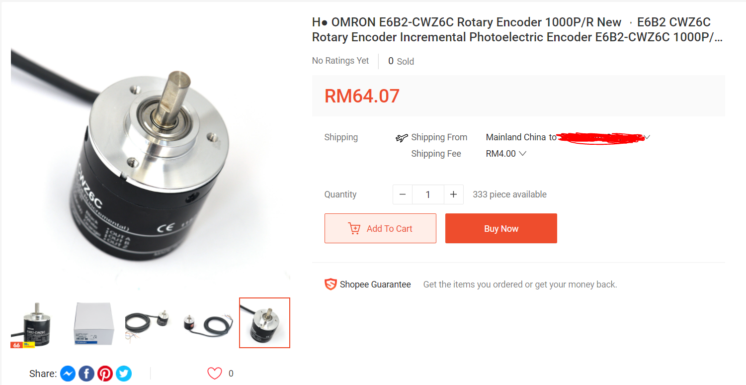

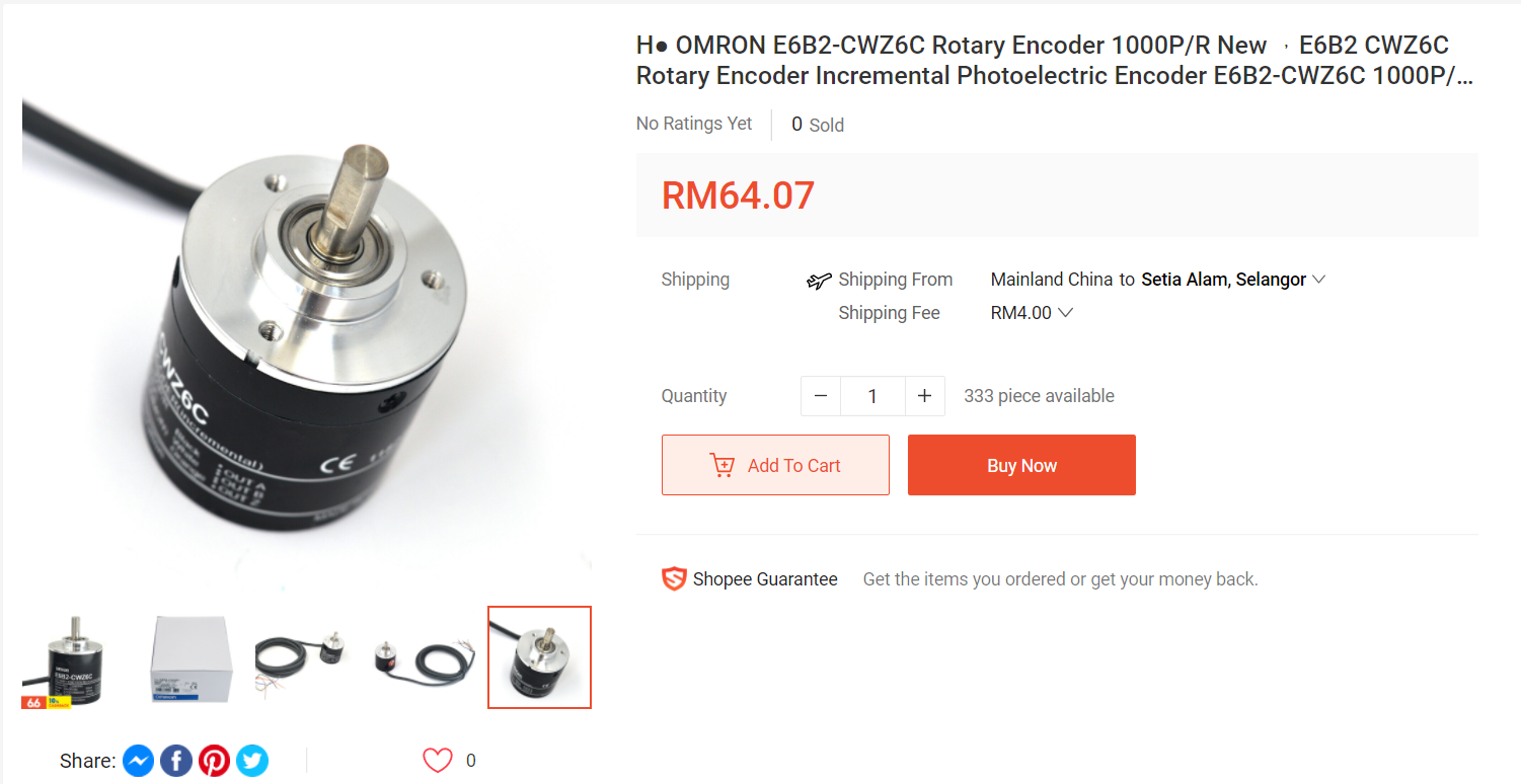

  3. Faisal Nyan
    Faisal Nyan Member
    Dec 10, 2019
    55
    Just a Maker
    375Coins
    DC motor
    Can I use a OMRON E6B2-CWZ6C with 1000P/R instead of 2500P/R like you did? I can't seem to afford the 2500 one, there was a cheap listing but the seller was unresponsive.
    Here's a photo: upload_2021-5-31_20-31-9.png
  4. danove_b
    danove_b Active Member
    Nov 11, 2017
    209
    Sweden
    1,782Coins
    +80 / 3 / -0
    Of course you can, that's up to you. It will give you a resolution of 0,36°.

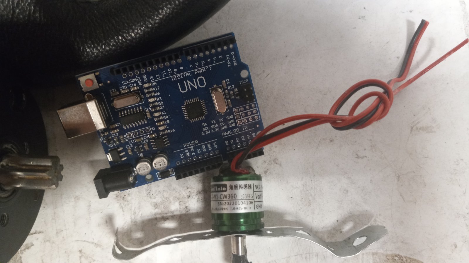

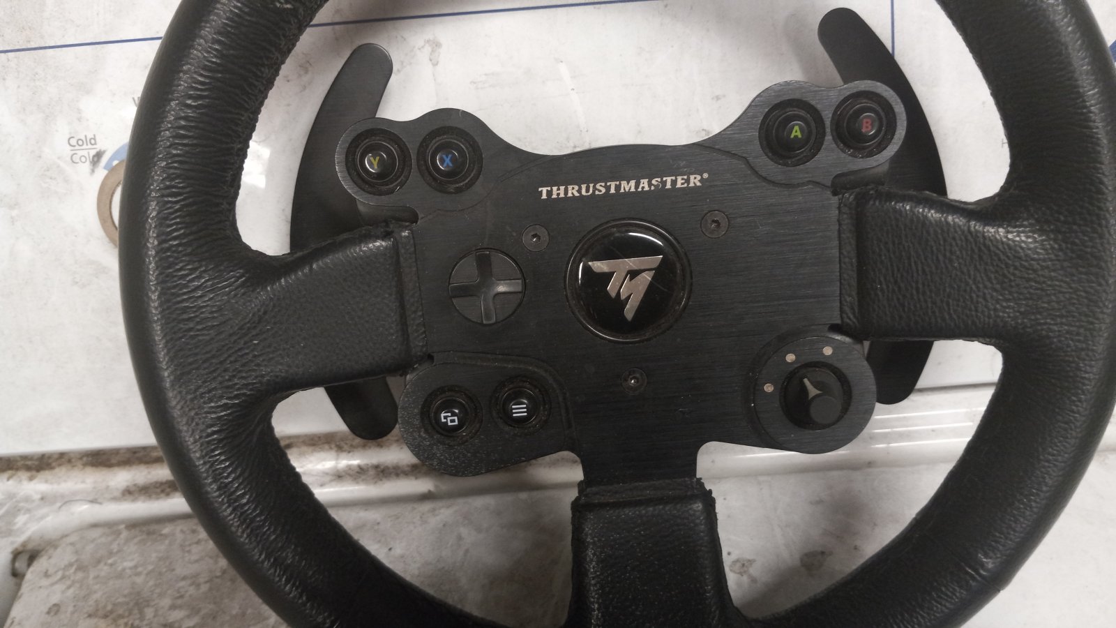

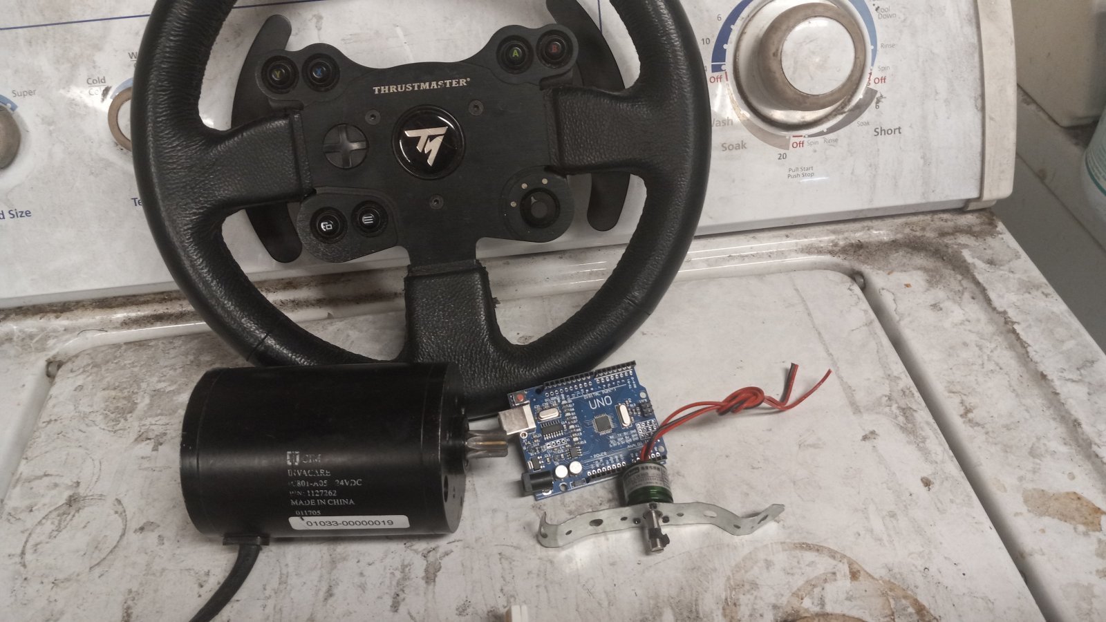

  14. Rodeo5150
    Mar 21, 2019
    222
    Antioch, CA, United States
    1,251Coins
    +55 / 0 / -0
    Arduino, 6DOF
    So are you saying that with these parts right here plus an Ibt-2 20220323_165003.jpg 20220323_165013.jpg 20220323_165018.jpg 20220323_165020.jpg that I can build a DD wheel
  15. elnino
    elnino Active Member
    Apr 1, 2010
    246
    Computer Geek
    Adelaide, Australia
    1,557Coins
    +139 / 1 / -0
    Almost - The Arduino UNO will not work, I would personally recommend the STM32 board and EMC firmware for the wheel as it is in active development still (Search EMC Developments, Ebolz Maggy on FB). You have to pay a few $ for it but it's well worth it and the STM32 board will likely be cheaper than an Arduino Leonardo to run the old crappy outdated firmware on.
    - You may find you need 2 of the IBT-2 h bridges to handle the current (Run in parallel)
    - The PPR on that encoder might not be fine enough but will be ok to start you off.
    Edit - On closer inspection, is that green thing an encoder? Looks more like a small brushless motor....

  17. elnino
    Apr 1, 2010
    246
    Computer Geek
    Adelaide, Australia
    1,557Coins
    +139 / 1 / -0
    Ok, looking closer - The green thing is not an encoder, it's just a 360 degree Hall sensor. That will not work.
    You need a rotary encoder
    So unfortunately, the only parts you have there you can use is the wheel and the motor.
    If you buy the EMC firmware, it comes with full wiring diagrams but it is STM32 only, not arduino. No affiliation, I have just tried all of them and the EMC firmware is lightyears ahead of anything else out there.

  18. Rodeo5150
    Mar 21, 2019
    222
    1,251Coins
    +55 / 0 / -0
    Arduino, 6DOF
    Ok thank you so you never mentioned what creates the torque though
  19. elnino
    Apr 1, 2010
    246
    Computer Geek
    Adelaide, Australia
    1,557Coins
    +139 / 1 / -0
    Specifically - The IBT-2 is a H Bridge which is just a module to drive a DC motor forwards and backwards (and in this case) with a PWM and direction signal. The power supply is connected to the IBT-2 and so is the motor. The controller then sends a PWM/FFB signal to the IBT-2 to *try* to turn the motor but you have your hands on it so it does not turn, but will be felt as torque.

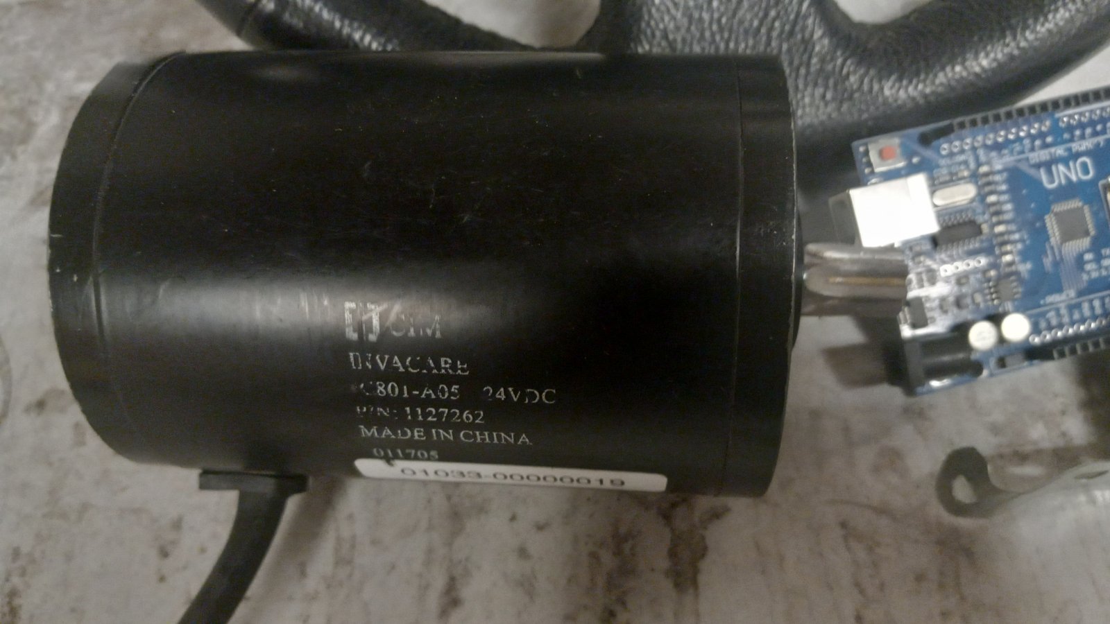

  20. Rodeo5150
    Mar 21, 2019
    222
    1,251Coins
    +55 / 0 / -0
    Arduino, 6DOF
    What I'm asking is there's no gearing or anything the motor provides all the torque it's just motor to the wheel nothing in between?
