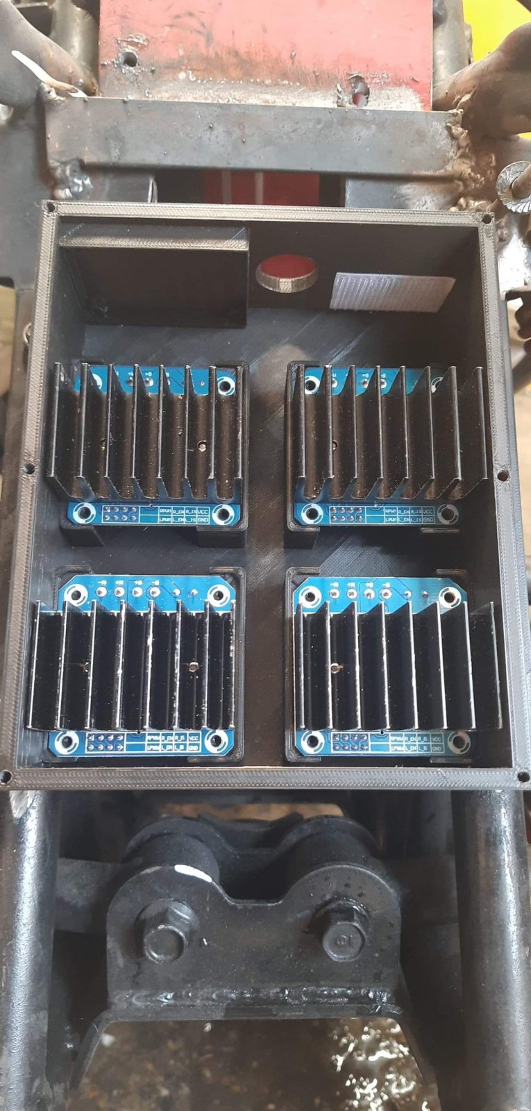

    Few photos of my ibt2 progress for you all.
    I decided to run 4 ibt2 my motor has a stall of 36 amps. Calculated by resistance of coils over 14.4v
    Backed up also by the fact of the fuse box that the motor come from being 40 amps.
    Box is 3d printed to hold 4 ibt 2 with a 92mm fan on top which isn't in the photo.
    I wrecked a few ibt 2 units trying to fill the vias so I have decided to now use artic 0.5mm thermal pads and leave the ibts alone. I figured 4 should happily handle the amps split.

    Hi all I wonder if anybody here can help me with an issue in regard to more than 2 ibt2.
    I tried to setup 4 units with ferrules and a custom track pcb for the ic controller lines. I made sure everything is connected correctly. However when I add power to the ibt. Nothing happens just the gnd starts getting warm on the 5v side.
    The units all work still but it seems any more than 2 units.
    It feels like the ibt units are shunting voltage to the gnd. Kindly can anybody who has setup ibts in 4 get in touch with there success please. Cheers

    Sorted now 4 ibt 2 work in parallel. Issue is poor grade connectors from amazon. Cheers everybody can confirm no issues.

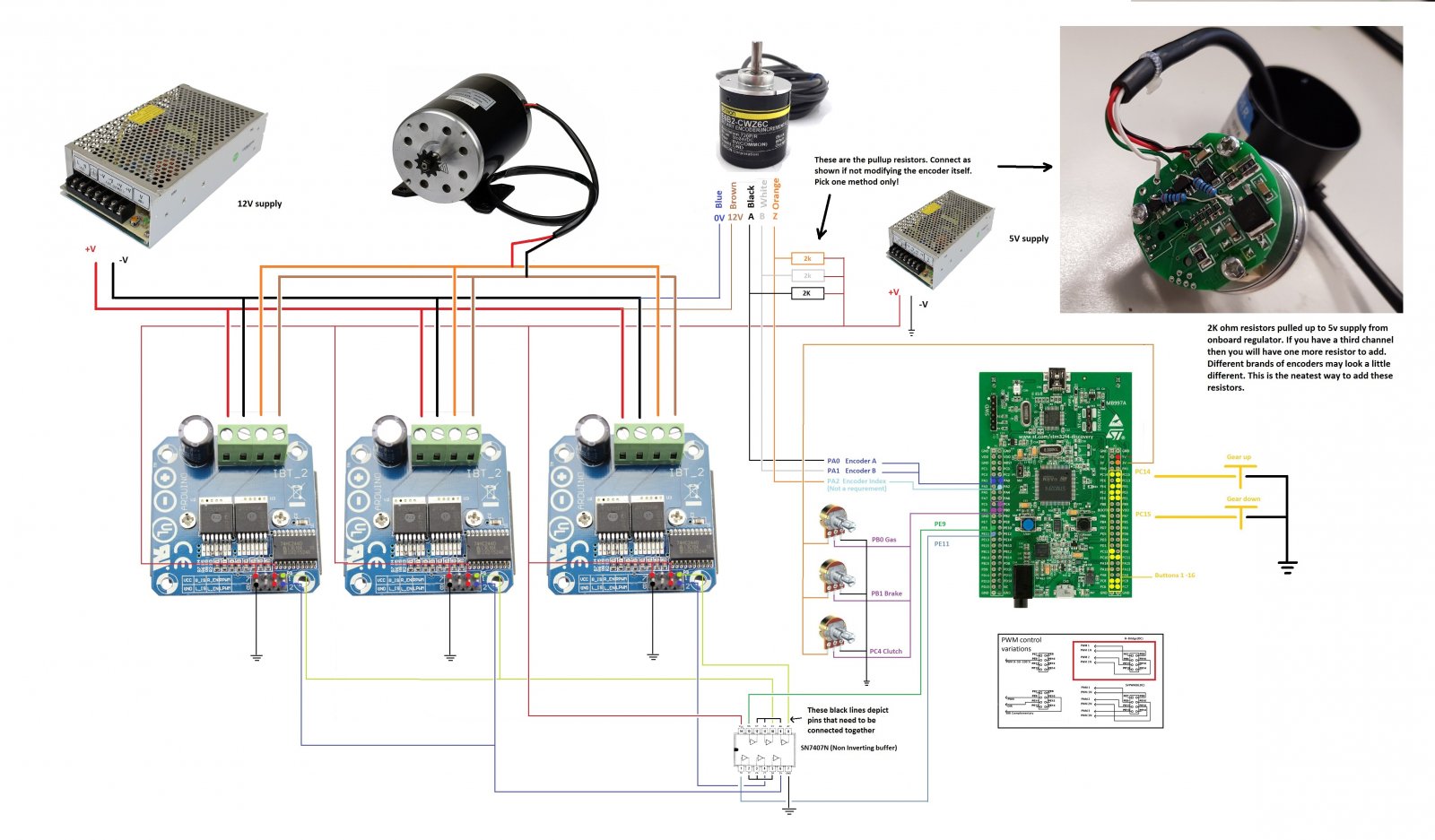

    Hey guys. I managed to get my direct drive wheel working with the stm32. I am now having trouble getting my g25 pedals working. I connected them like this diagram says. I also have it setup to 3 axis mode in the setup. I can get the gas pedal going sometimes but the other 2 pedals don't do anything.
    I made all the connections off of the factory g25 connector. I just attached to the pins I needed. Could that be a problem maybe?

    you may need a pull up / down resistor on the encoder signal wire
    take a 1k resistor and wire from the signal wire to ground - if that does not work wire it to 3.3v
