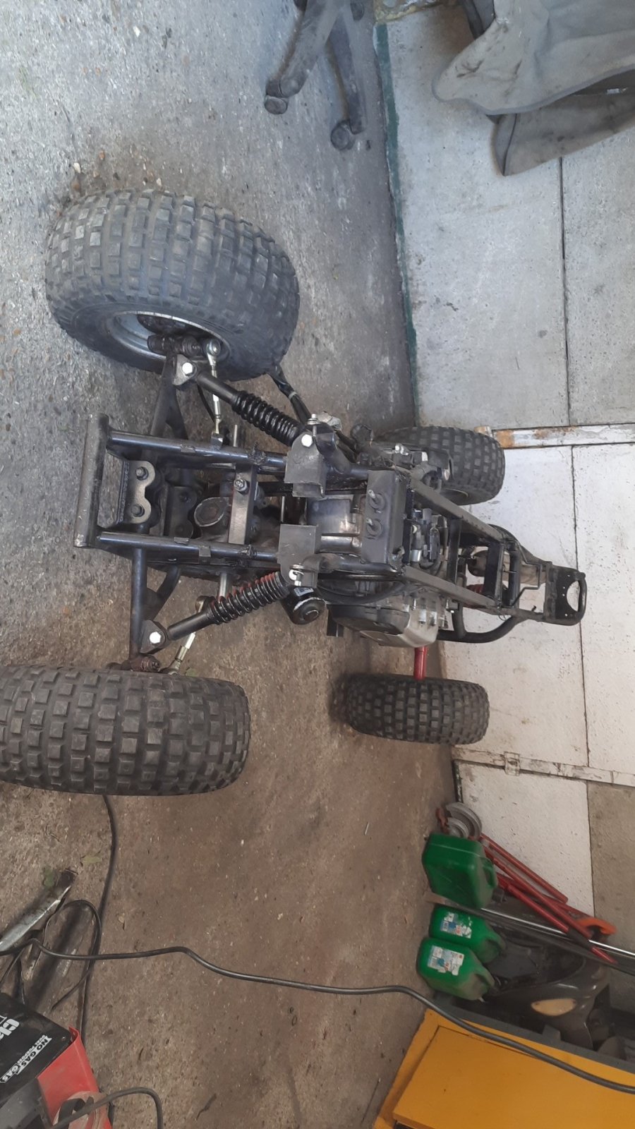

    Hi mate, i know i am bumping an old thread, but its still a widely used method and it seems that the solution you give here is really important,
    Can you help me and others for future how to cool the fet down, cheers.
    I am using ibt4 for driving my rc buggy but any source on the ibt 4 turns up a blank apart from here.
    Thank you

    Hi mate thank you for reply, even with a thermal pad on the ibt-4 it doesn't pass anywhere near enough heat dissipation to be of use, so I am heading down dual ibt-2 route, if anybody here can help with a schematic of linking 2 or more that would be great fully appreciated,
    I can offer a solution for a motor that is designed for low amp stall by nature using gearing but yet still moves fast enough for the steering wheel, in your builds
    It's an electric power steering rack from a car, mine is a Honda jazz rack, i chose this rack because the motor is to one side of the rack and that means I could cut the rack down and add tie rods to the rack directly driving the wheels without any loss of torque from servo arms or linkage!
    I did look for ages for a solution but nobody had ever used this method that i had found before so i was glad to share it with others for large scale steering.
    You can also use an electric power steering column, naturally these designs are made to stall when driving. NSK make newer brushless EPS units that are used on nearly all cars sold in the UK, but sadly I don't have the skills to speak to the modules (believe me I have asked NSK technical for a pinout, but they just ignored my request) they retail about £30 on eBay (look up Nissan Juke electric power steering) you will be able to buy the full column module motor for that price which I expect will be a solid contender for your designs.
    I hope to have given you all something back that may help with your builds.
    There is lots and lots of retro power steering on YouTube as it's a simple mod to do and pinouts for brushed motors as it's a drop in replacement Columb for pretty much most cars.
    If the ibt2 ends up being a no-go then I'm aiming to buy a programmable controller (i have attached photo) which will be a 60 AMP unit continuous with 120a burst (adjustable by programming).
    But first I want to try the ibt2 units as I feel there is value to be found,
    All the best
