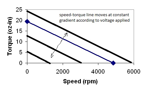

    To Benu:
    Correct. I misunderstand you thinking you meaning the feeding voltage not the nominal voltage of the motor.
    To Alexey:
    Of course voltage affect the torque, but again, the torque is proportional to the current, and if I can get the desired current with the lower voltage I see no use for more.... Theoretically if i feed my motor with 36 VDC at stall and had the required supply I should get 241 A and 21,6 Nm... maybe for 1 second...

    Yes if you only want to use a portion of the available torque then yes by all means lower the voltage. My response was in regards to Benu asking if the running the motor at lower voltage will still get maximum current, which it will not.

    Thanks @danove_b and @Alexey for the explanations. It seems to me, that you do not share the same opinion on this. Please correct me if I am wrong.
    I assumed that using the nominal voltage would give best performance as all the components are optimised for that. Using lower voltage should then lead to a performance loss in a specific area. Maybe this area is not relevant as in a DD-Wheel the motor is not used as intended by the manufacturer (spinning at some rpm -vs- stall).
    I still can't wrap my head around it. Doesn't the IBT-2 "translate" the PWM signal from the Arduino into pulses of input voltage to the motor? Even in stall mode these pulses still have maximum input voltage. Having an input voltage lesser than the nominal voltage would reduce performance of the motor. Doesn't higher voltage in this case correspond to better responsiveness of the wheel?

    Danove and myself have the same view, I am assuming there is a translation error in what we are trying to convey to each other. You are correct in what you have stated. What I was originally posting about was a statement that sounded like in a very basic description was that voltage would not affect the current draw, which is false.
    So yes a lower voltage will produce a lower torque, which means a lower current. Also when you hear someone saying that they need to control the current then really what they are saying is that they need to control the voltage. Current draw will always be I = V/R
    Just as a bit of a bonus to you, PWM is effectively controlling the voltage level. If you were to place a volt meter on a pwm signal then you would read the average voltage of that signal, which is what the motor effectively sees. So a lower %PWM corresponds to a lower average voltage = Lower torque/current/speed and the opposite is Higher %PWM = Higher voltage/torque/current/speed.

    The nominal voltage is perfect if you have plans to run the motor at a nominal speed, like 3000 rpm with my MY1020, but here we talking about 0 rpm...
    As an example when you fit this motor on a bike or whatever, it is very important that you have the correct gearing so it reaches it's nominal speed in a not to long time. Otherwise the current will be to high and the motor will fry.
    I could in theory feed my my H-bridges with 36 VDC (The BTS7960 are max 24 VDC though), but since I'm still are limited to about 85 A to not fry the motor, I must limit the PWM to about 33%.
    100% PWM would result in 36 VDC on the motor and should generate a current about 3 x 85 A if i had the supply that could deliver...
    By limit the PWM to 33%, I should have the same max torque as with my current voltage, 12 VDC, but with much lower resolution on the PWM.
    The Leonardo PWM have a resolution of 400 steps at 20 khz frequency (That's what you want, because your ears cannot hear it).
    So I will end up with a resolution of 0,33 * 400 = 132 steps instead of 400.
    If you find a motor that has a nominal speed at about 300 rpm, the nominal voltage should be fine i think...

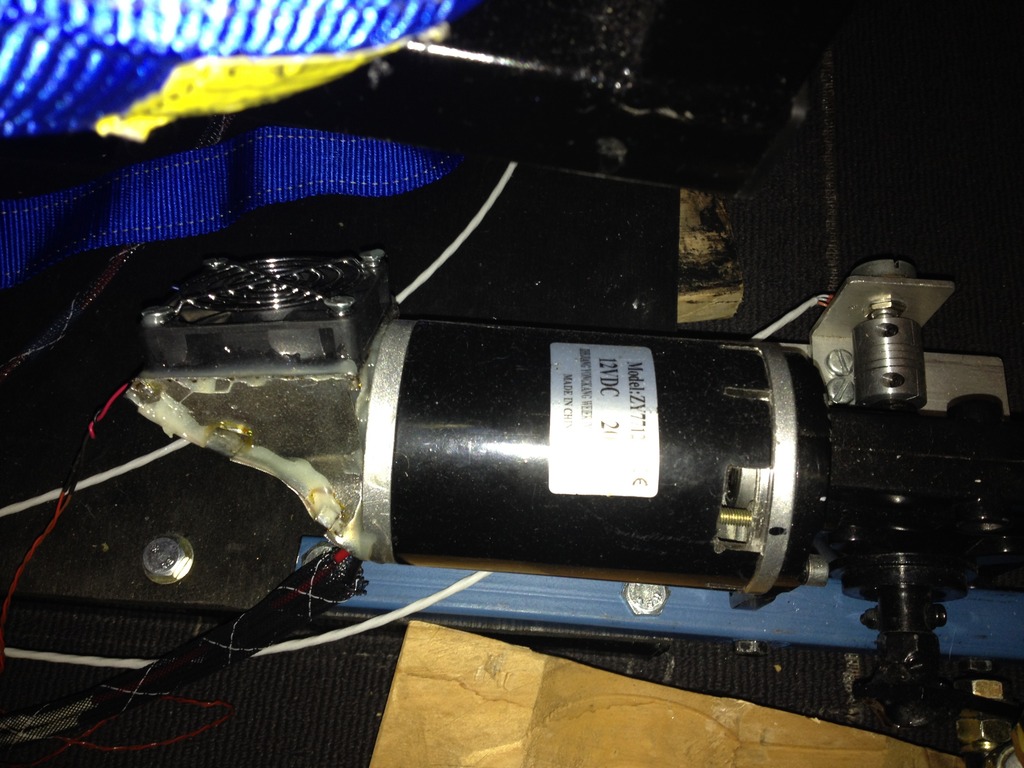

    You can run motors past the nominal current as long as you provide sufficient cooling directly to the motor windings. So drilling holes in the front and rear face plate and adding an enclosed fan over the face plate will keep the motor cool. I ran a 200W motor at 400W by doing this method.
    For this one I have used some tin sheet. I cutout the side walls, soldered tabs along the edges to make the shell and filled in the air gaps with epoxy. Slots were cut out of the body of the motor instead of the face plate because the gearbox was in the way. Always set the fan to pull air through the motor.
    I am currently making a DD FFB wheel and have come up with a far neater solution and will post when things progress.

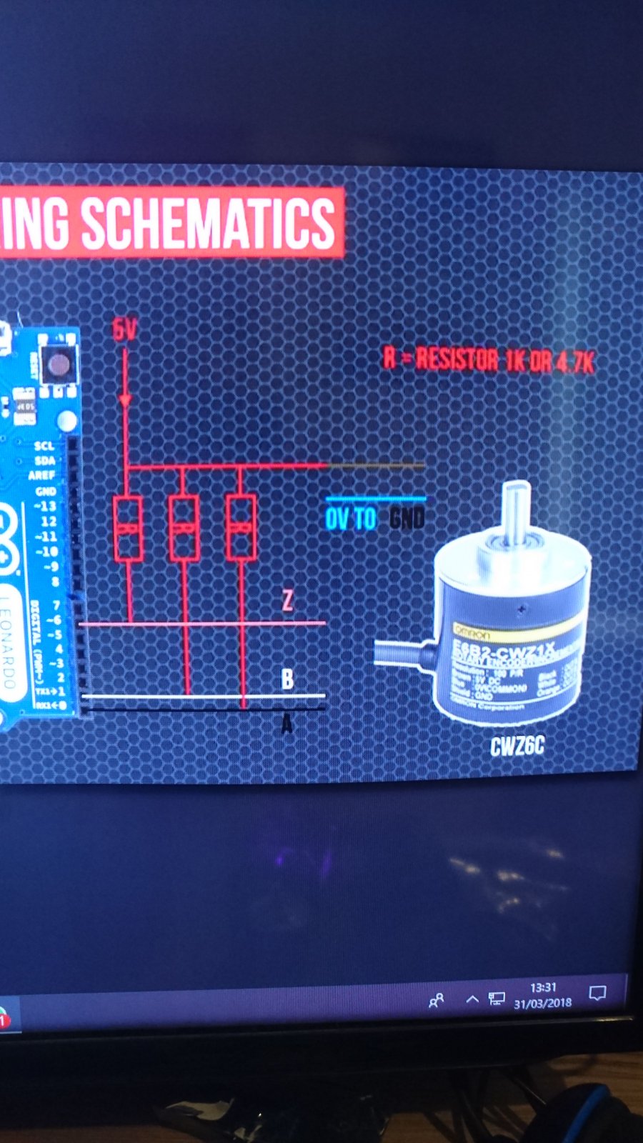

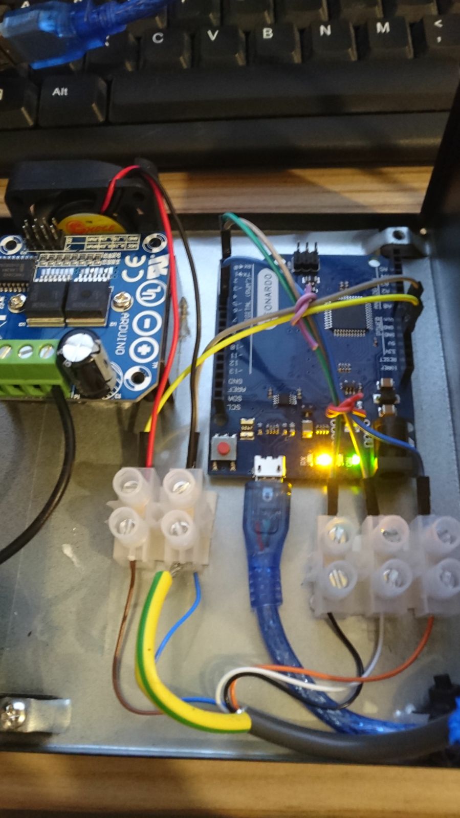

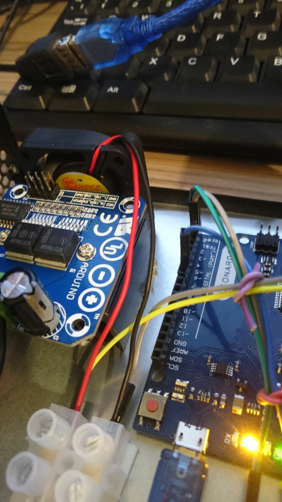

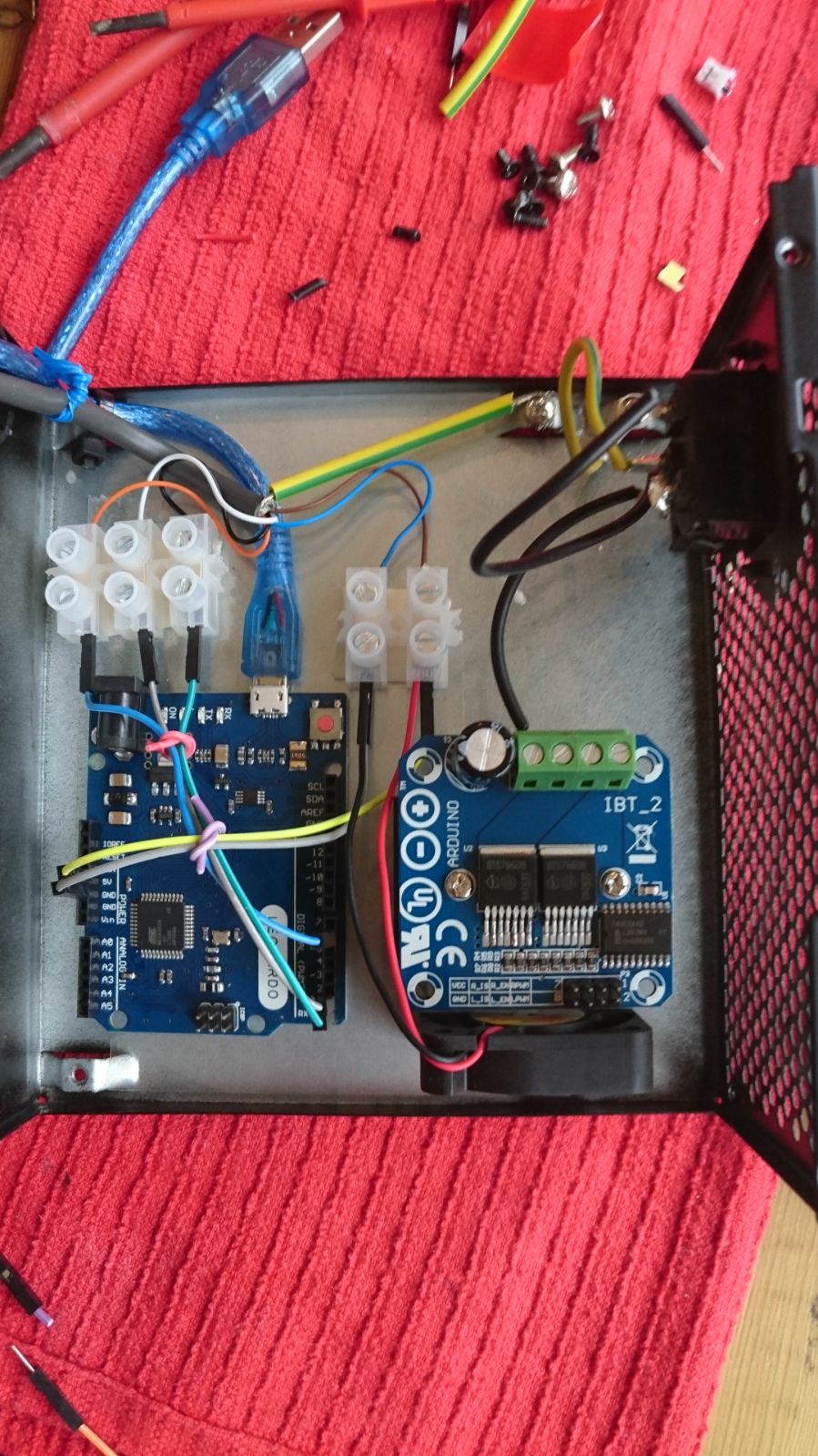

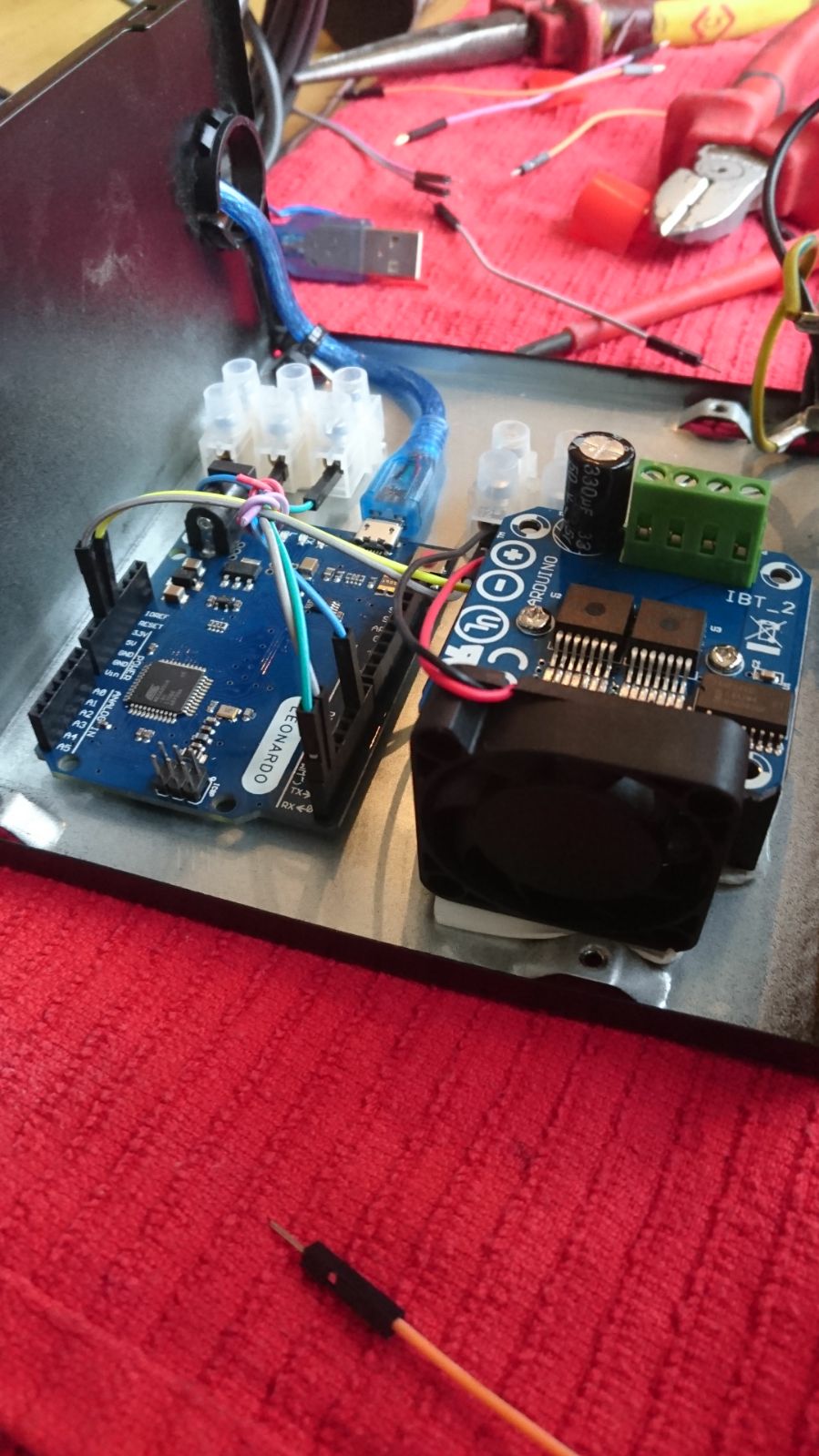

    Hi ive just started building mine but have some issues the the CWZ6C encoder, Dont seem to be active on the RFR wheel config, ive tested the buttons with the ard and they work but not the encoder, any ideas please.

    You may need a pullup/pulldown resistor

    Pull-up pull down what's that then lol is it right I need to add 5v to each signal wire to encoder with 4.7k resistor to get it working like this

    Like this one wired as above
  18. Gadget999
    1,998
    12,192Coins
    +493 / 11 / -0
    Yes for pull up use 5v to signal
    For pull down use gnd to signal

    What would u do on signal ground or 5v
  20. Gadget999
    1,998
    12,192Coins
    +493 / 11 / -0
    Use 5v if it does not work try gnd instead
    Your encoder will either send 5v or pull to gnd
