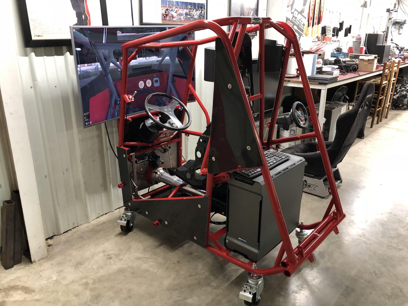

    I have some questions about the what I believe would be a 4DOF with traction loss sim.
    I am not computer savvy by any means, so although I have searched and followed many builds I am still in the dark on much of the process. I am a fabricator and have built many race cars and other things so my strong point will be the rig.
    My idea is to build a 5/8 scale dirt late model and place actuators where the shocks would be to have a scale movement. This will include the chassis having a four link as well as front suspension mount points and arms. There will be tires on it but the contact points to the concrete will be fixed. The rear axle tube will be affixed to a roller plate for traction loss. My thought process is to get immersion with the chassis cockpit as well as similar hike and movement of the car. I probably won't be doing VR until some more advancements are made do to my vision and sensitivity to light.
    So onto my question's
    Who if anyone sells or could program a controller to run the 4dof as well as the TL. I am not a programmer and this is the part that scares me. Is there anyone that offers a lower priced controller to run this type of setup for iracing where all it would need is tuning to get the rates correct? Also what would be the recommendation for actuators that have eylets or heims on both ends? I want the placement to be where a shock would normally best as I want to wrap them in decals to appear as shocks.
    Any help or suggestions would be greatly appreciated.

    I would like to do some sort of a scale body on it, and to have it moving in scale from the outside is my though process. I think it would look great sitting in the man cave. After further reading it looks like this may only be 2DOF using 4 actuators? My idea is to build something like this mini late model, or a sprint car setup. I don't want the sim to just pivot on a u-joint in the middle as from a scale side the middle also rises and falls with the suspension. The dirt cars have a lot of lift and drop in and out of the corners and I would like to replicate that feeling.

    I guess the trade off is how you want it to look Vs motion performance and cost.
    Adding mass to a motion sim is much like it is with a race car, it impacts on performance and cost, and you don't do it unless you have to.
    For what you want you would scale it differently than this video, and instead place the actuators closer to where wheels would be, but the video does give an idea of what a 3DOF Dbox style rig would look like with traction loss.
