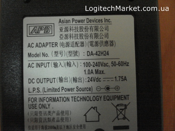

    Let's make it simple. Again.
    The PSU for Logitech G25/27. Motor kinda of you favorite RS550.
    No 85a stall current + safe amps for PSU capacity. No current limiting resistors, or whatever else etc etc.
    http://www.banebots.com/product/M5-RS550-12.html
    There are two motors in the wheel base in addition.
    If you expect mature wheel base build, don't expect it from rs550.
    1000w MY1020 for your psu should be good. People are happy with this motor for many reasons.
    https://www.motiondynamics.com.au/unite-my1020-1000w-3000-rpm-48v-dc-motor.html
