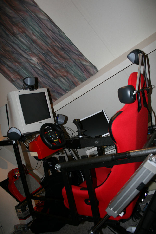

    I have an old RnR motion chair which has been extensively modded. I am considering up grading with SCN actuators.
    Is this realistic? Has anyone tried bolting on SCNs to a Rock N Ride?
    This is the rig. (Some of you may recognize Renoboss' fine metalwork.)
    bvillersjr commented that much depends on the leverage the actuators can get from their mounting positions. Currently, the chair uses two pneumatic cylinders for pitch and one for roll. The chair balances fairly well despite the extra weight as much of the burden is borne by the central pillar. When seated, I balance out the nose weight of monitor, instrument panels, etc. Balance might be further improved if trimmed with tail weights.
    Given a reasonably well balanced chair, how strong does the actuator need to be? bvillersjr suggested a SNC6 model pushing 60kgf and moving at 100mm/sec. I am an IL-2 flyer not a driver. Do you think the movement will be satisfactory for fliers?
    I am also concerned about the SCN actuators physically matching the shape of the old SMC pneumos. They would have to be mounted on the same Clevis and U-bolt posts as the SMCs. The model number for the old pistons is CP95SDB-50-270 GX DE. They have a 50mm bore and 270mm stroke. The girth of the rod is 2cm. The length of the entire unit, when retracted, is roughly half a meter.
    Unfortunately, an SCN6-60kgf-300mm costs dearly. Is there some way to buy an actuator with a shorter stroke and sacrifice some degrees of movement? Right now the chair will move 50-60 degrees in pitch and roll.
    All better ideas, caveats and inspirations welcome.

    Judging from Nima's post, I think you should give it a try. The starter kit requires no hassle, you only need to modify the cylinder mounts.
    How much stroke do the air cylinders have? The range of movement / leverage will change depending on the geometry and travel of the actuators.

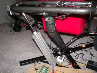

    As you can see from this picture, the piston arm of X axis cylinder does not fully retract. In neutral position, 150mm of piston is exposed. With a 200mm SCN6 actuator, the X axis cylinder would only have 50mm of useful extension (-20% for safety buffer.) Maybe less X axis travel is the penalty to pay for an easy fix.
    Do you know if there is a standard girth for piston arms? The air SMCs I have are 20mm. Can I reuse the Clevis mounts and U-bolt brackets, that screw onto the base of the pneumatic cylinders, for the SCN6s?
