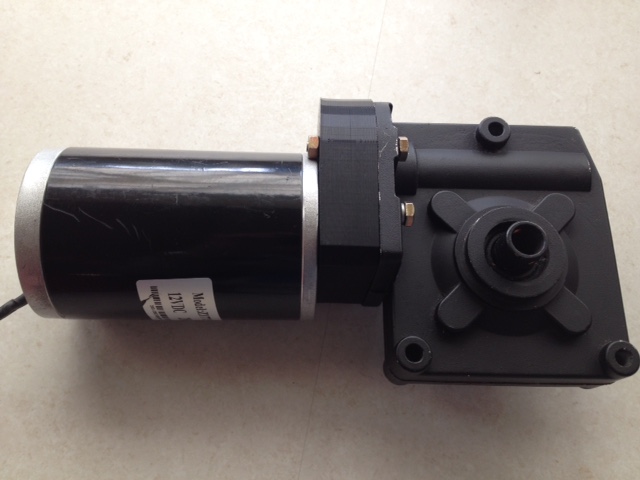

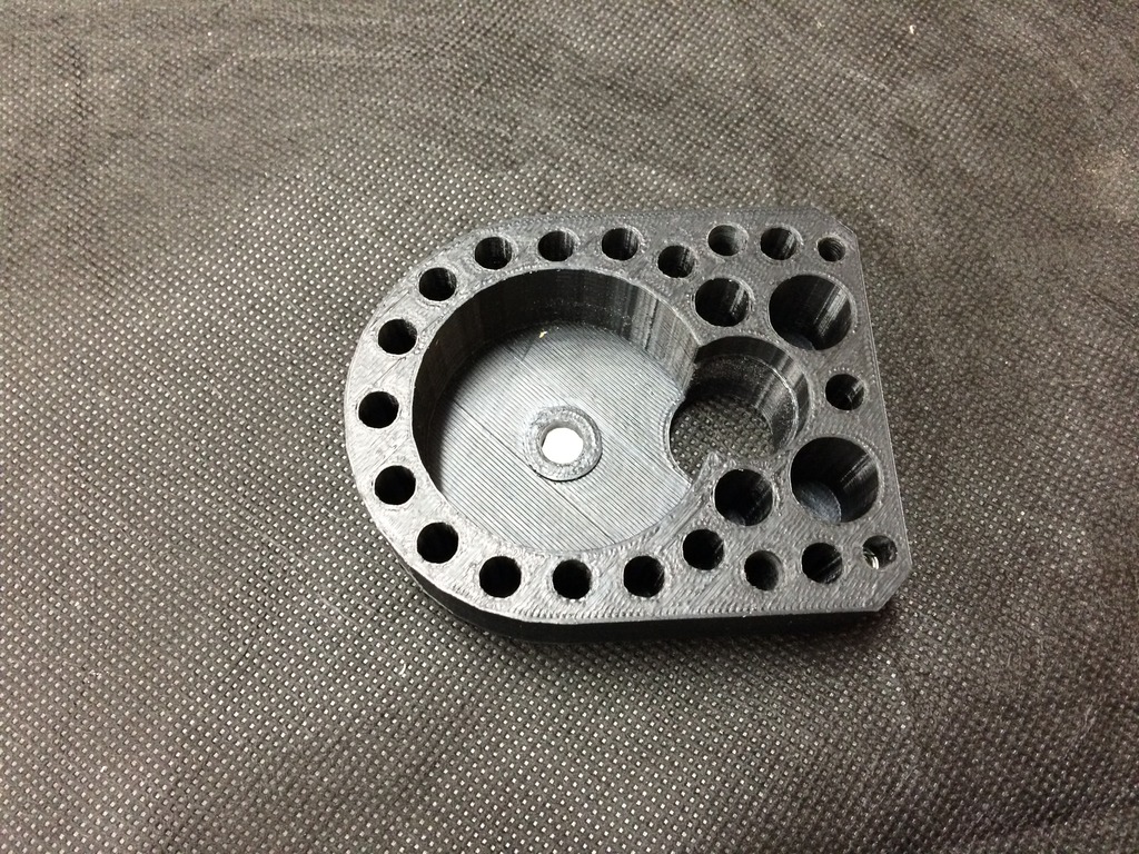

    I decided to try and convert the existing one to a 75:1 reduction using 3D printed parts, here's what I came up with. It's an addittional 3:1 reduction that fits between the motor and existing 25:1 gearbox.
    For comparison the output shaft speed of the original motor with 25:1 reduction...
    And the output shaft speed with the additional 3:1 reduction stage (3D printed parts)...
    It is somewhat noisier however I had forgotten to add any lubricant to the gears at this time so I need to pull it apart and do that to see if it makes much difference.

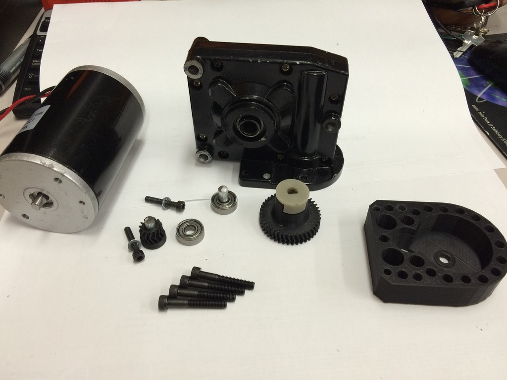

    Here is how it all fit together...

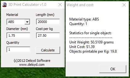

    I estimate the total cost around AU $5 to $10 depending on how cheap you get the bearings and bolts. All up it used about 20m of 3d printer filament at $27.50 a Kg which works out to be under $1.50 for those parts.

    I have no idea how it will wear or last or if it will now be too slow for traction loss so all that testing is still ahead, but so far it seems good and I think it should be fast enough and provide a more snappy response due to less load on the motor.
    STL files in attached .zip
