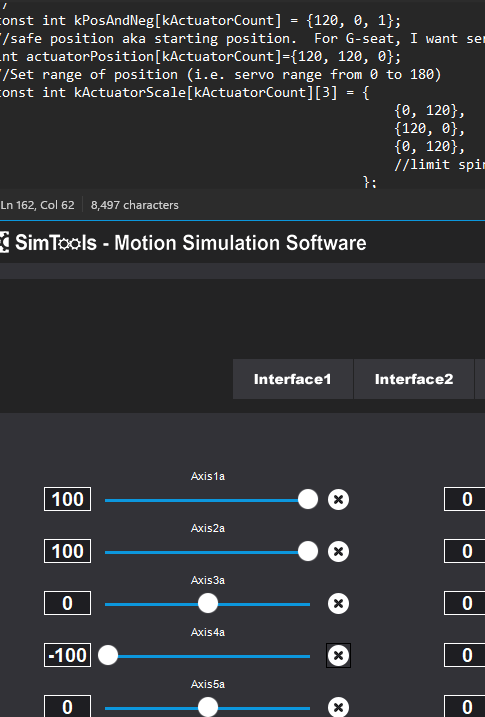

    Ok, so I tested the left one and it's most tight at 93. Where do I enter that 93 number, is that in the Arduino code or in the simtool software? Currently have 0,120 in the code. Or should I be physically taking off the arm and aligning it with 100?

    It should be tightest at the end of the spectrum, i.e. 100 or -100. If it's not, then consider either:
    1) repositioning the physical servo arm so that you take advantage of the full 180 degrees (even though it's a 270 degree servo, only 180 are useful for this use case)
    or
    2) change the 0, 120 range in the Arduino code so that the arm stops where it provides maximum pull. The begin and end points should still have about 120 difference between them, although sometimes it might be slightly less or more depending on the servo's built-in accuracy. (This is where 270 degree servos are useful; with a 180 degree servo, you'd only have option 1, since a 180 degree servo would already be operating at full range. With a 270 degree servo, you have more wiggle room, literally, lol.)

    I'm physically moving the arm - my left is maximized at 0, while right is maximed at 100.
    Would I just swap the numbers in the ardino code like this?
    //Set range of position (i.e. servo range from 0 to 180)
    const int kActuatorScale[kActuatorCount][3] = {
    {0, 120},
    {120, 0},
    {0, 120},
    //limit spin scale to ensure uniformity for left and right based on position relative to seat

    I think so, but the only way to be sure is to experiment with it, and see how it goes. Good luck!

    Still working on alignment, do these numbers look correct for starting positions? Axis1, 2, and 4 are all at maximum slack with the test settings simtools.
