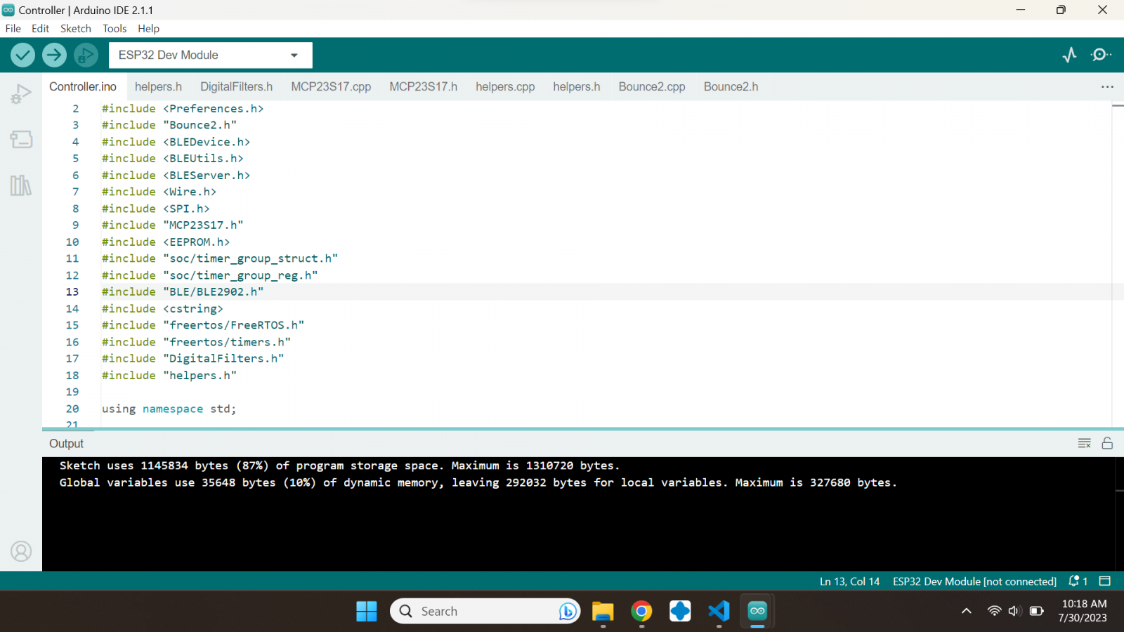

    To late, curiosity got to me,... using the latest arduino IDE 2.1.1,and updated libraries, I was able to compile without issue. do you have the correct/same esp32 dev module at the top as I do?
    it only uses the BLE for bluetooth, but its not really used for anything unless you wanted to use the phone app,.. which is not very useful... I was just bored one day so I made it work at the bare minimum. the filter was a proof of concept, that I never implemented in actual released code, so no reason to include it in the #include's

    Lol, PMSL. That's interesting, and good to know. I'll have to checkout what libraries are actually being used.
    I explored the ESP option first and opened a can of worms.
    The board I have has the following specs:
    Ebay listing....
    ESP32 NodeMcu Development Board WROOM 32 30 pinsDual Core WLAN WiFi Bluetooth
    ESP NodeMCU 32
    WROOM 32
    30 pins
    Dual LX6 cores
    I have just changed the IDE board setting to the same as yours and got
    Code:
    Sketch uses 1322145 bytes (100%) of program storage space. Maximum is 1310720 bytes.
    Global variables use 44484 bytes (13%) of dynamic memory, leaving 283196 bytes for local variables. Maximum is 327680 bytes.

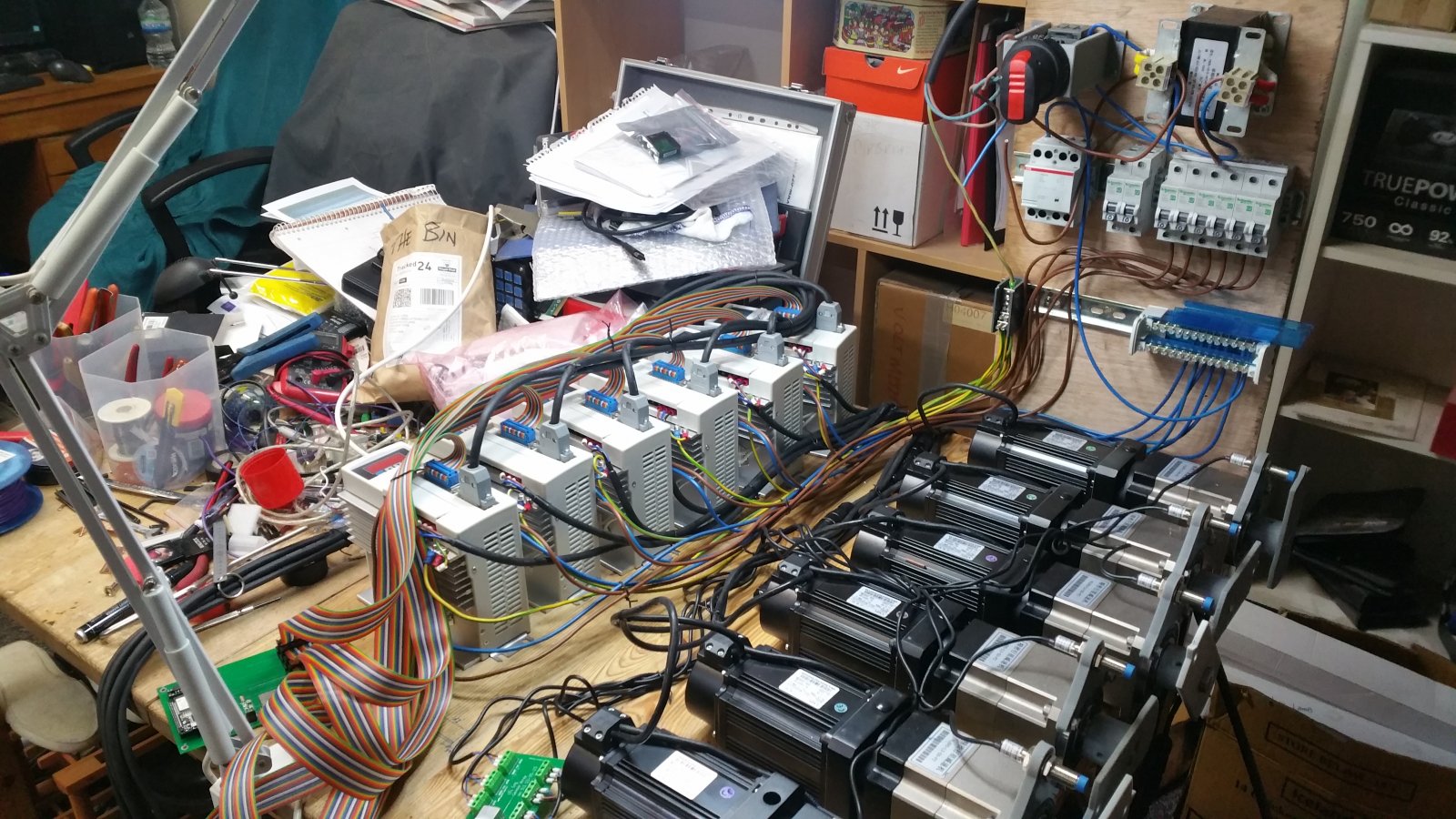

    Well, we're getting there, removed all the BLE stuff for now.
    Compiled & uploaded.
    But hit another obstacle. The Pololu step-up Vout was only 5V, so it seems I've managed to buy the wrong ones. New ones now on order. No biggie....
    Will get on with cabling for power-up.

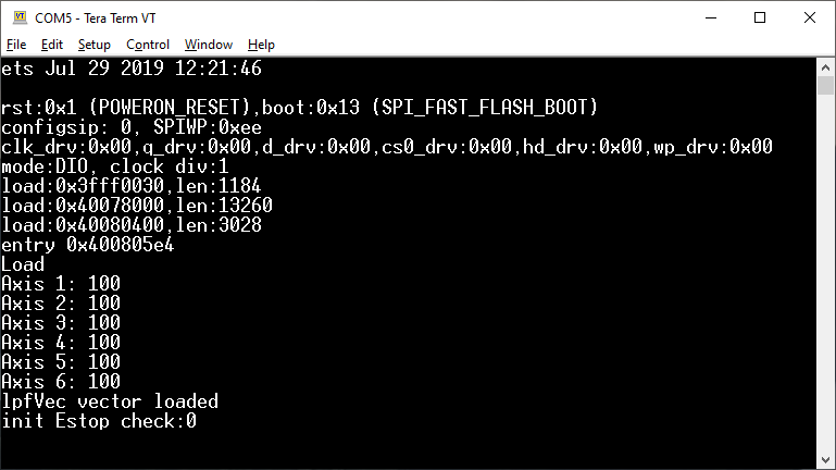

    Wahoo....
    Well we put the 12V step-up supply in and run the PC test, that showed up a error in connections, not solder joints but the method I used to secure the MCP23S17 to the board. I used the same standoffs as the ESP32. Nope, pins didn't connect properly, anyway sorted it... got pins 2 & 9 going from 0 to ~5V.
    Oh those ESP32 dev kits turned up, still can't get it to compile and fit with BLE??
    So used the version without BLE, pugged all in ....nothing..
    Went through the servo drive looking for paras I hadn't set properly... & found one.
    Powered up again and voila.. we have motion. It (oh yeah, did I mention I'd only connected one motor up :D) went through referencing, then I set all to zero in the "6DOF tester" hit 'Set Position' and Pow! shot to position, hit the reset (2047) and sp again and it returned.
    So Next step is to clamp them down, and connect the rest up, still waiting on buss connectors, so it'll be a week or two. But hey, making progress :D

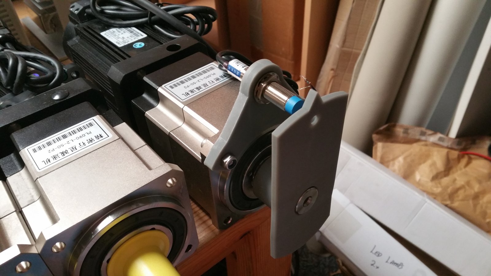

    Just to confirm, I have today finally got my system (i.e. photo as previous post) connected to Assetto Corsa via simtools with some sensible intended movement. One of the main reasons for connection issues was not realising there was an 'X' at the end of this (<Axis1a>,<Axis2a>,<Axis3a>,<Axis4a>,<Axis5a>,<Axis6a>X) and it wasn't untill I looked closer at the .ino files, that realised it was needed to signify end of data block. But hey ho, all part of the game. So I can now progress with the platform/etc design and tweak the setting to my own. I've decided to 3D CAD the design.....
    Never did manage to get the full prog compiled to the ESP32, but my controller_minus_BLE.ino seems to work ok.
    It took a bit longer than anticipated as other projects (new car & bike) and real life chores get in the way.
    Appreciate all the help, not sure I would've done it if you hadn't made it so easy. I will post progress in due course.

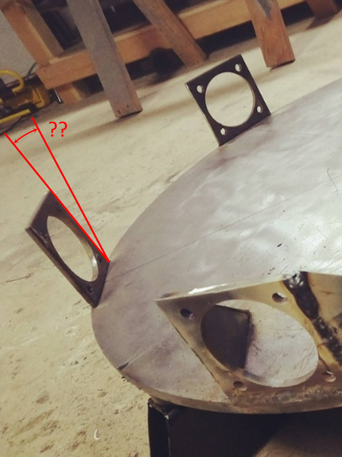

    Hey mate! @knaufinator
    I'm in the process of building a 6DOF sim rig like yours and I wanted to confirm something odd I found: On your build pictures I've noticed the brackets holding the gearboxes look like they're slightly angled down, somewhere around 10 degrees but I could be wrong... Might be a visual effect since the gussets themselves are angled.
    Bottom line I was assuming that all motors axis were to lay on the same plane and just wanted to confirm if that was indeed the case. The gearboxes look indeed like they're all on the same plane, thus the confusion... Pretty much everything else is sorted out (for the time being ;) )
    By the way, thank you very much for this project and the time you put into it! I'm currently ordering/receiving the main components and I can't wait to get something going.
    Cheers from Quebec, Canada!

    Good day my inspired friend. The motor/gear is indeed parallel with the plane of the ground. Good luck in the build. Strength and rigidity are key.

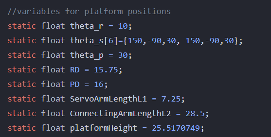

    I am reading all of your information on building this platform. Could you please share how you did the analysis of the geometry and what the final dimensions are?
    Thanks,
    Rick
  20. knaufinator
    knaufinator Active Member
    Nov 16, 2017
    222
    Simulation Engineer
    akron,ohio
    1,941Coins
    +254 / 1 / -0
    AC motor, 6DOF
    in the helper.h file, this defines the most significant dimensions to make the inverse kinematic algorithm function for my rig.
    the size and layout, i was going for small form factor, so i started building around the seat with that idea. i ensured the algorithm would be happy before building anything as I had a (rudimentary 3d tester/ the excel file in technical folder) , after that the goals are simple, light weight and balanced, and EXTREMEMLY STURDY
    the thetas are angles for motor placement/orientation, id have to dig into specifically what angles,.. its been years... its based on the excel file in the technical folder, these values indicate my specific angle orientation around the base
    rd/pd are the diameter, for the base and chassis platform respectively 15.75 and 16 inches
    servo arm length is the length for the arms connected to the motors, 7.25 inches
    connecting arm length is the length of the arms from the chassis to the servo arms 28.5 inches
    platform height is the height above the plane of the motors, 25.5 inches
