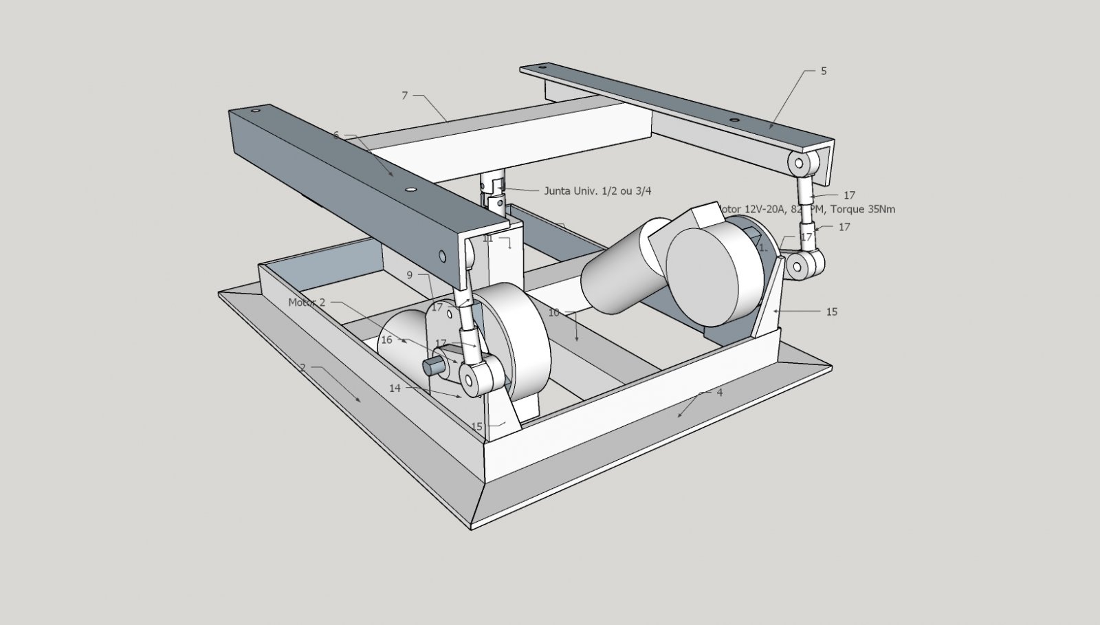

    Hi evebody.
    I start my 2dof project, with cheap components. I will post here my project.

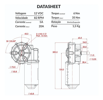

    Yes, I know about the torque. I will use an motor with 35Nm and 70rpm, i believe 50:1. I try to use de sincalc, but not accept small size of measurement.
    You know how much angle of pitch and roll is good value? 10 deg?

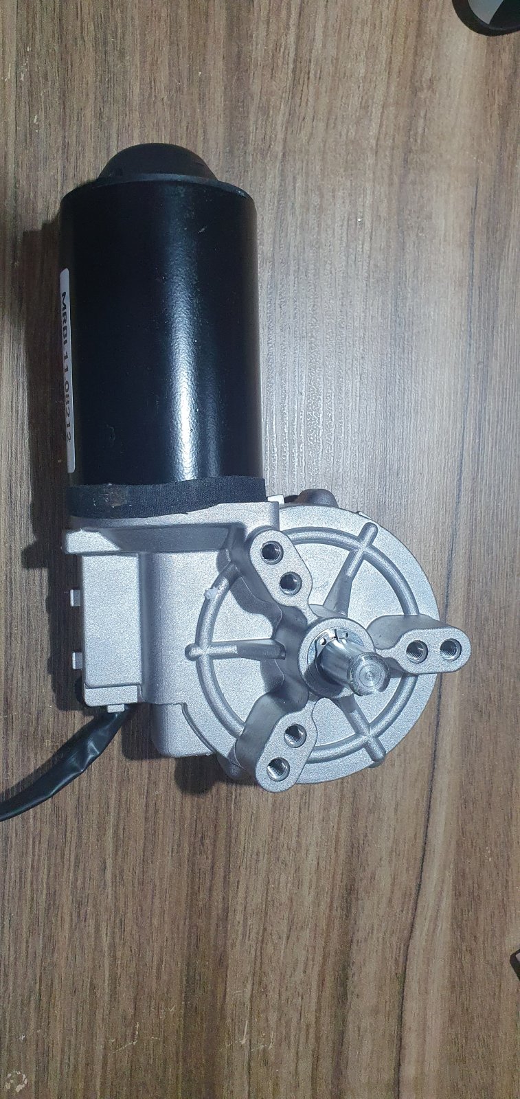

    Today I receive some part's and begin to work!

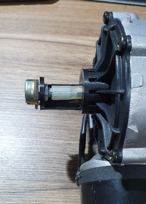

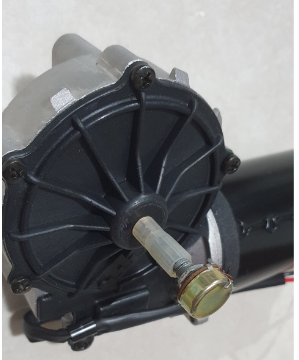

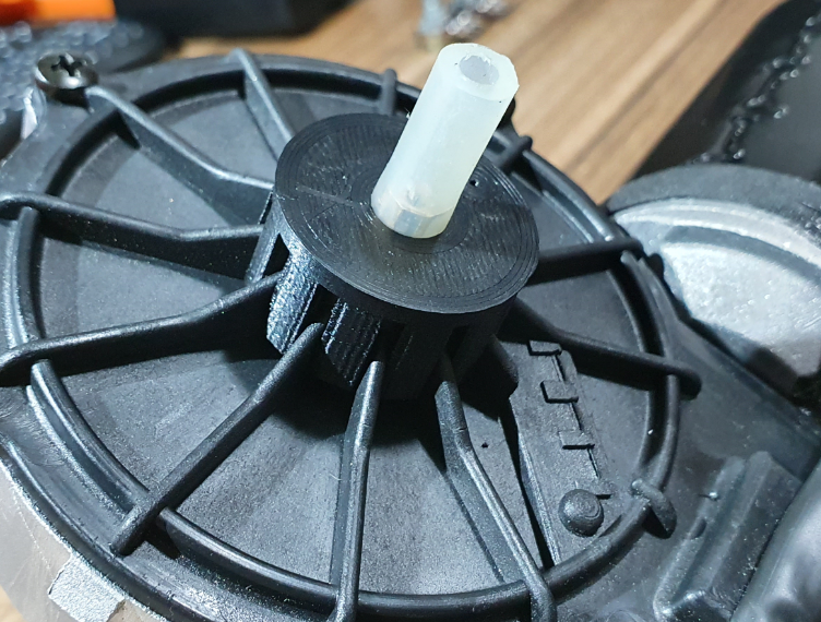

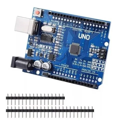

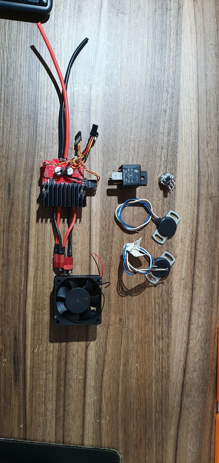

    H Monster assemble with some mod's. I will integrate to arduino and H Monster an bluetooth module to make a direct commnication to PC wireless without a second Pc. The speed of usb-serial of arduino Uno, is 115k and bluetooth is 115k too, and I believe that work without no lag. Feedback of position will be hall sensors
    20200501_213924.jpg motor support's
    I find this tutorial:
    https://create.arduino.cc/projecthub/millerman4487/view-serial-monitor-over-bluetooth-fbb0e5

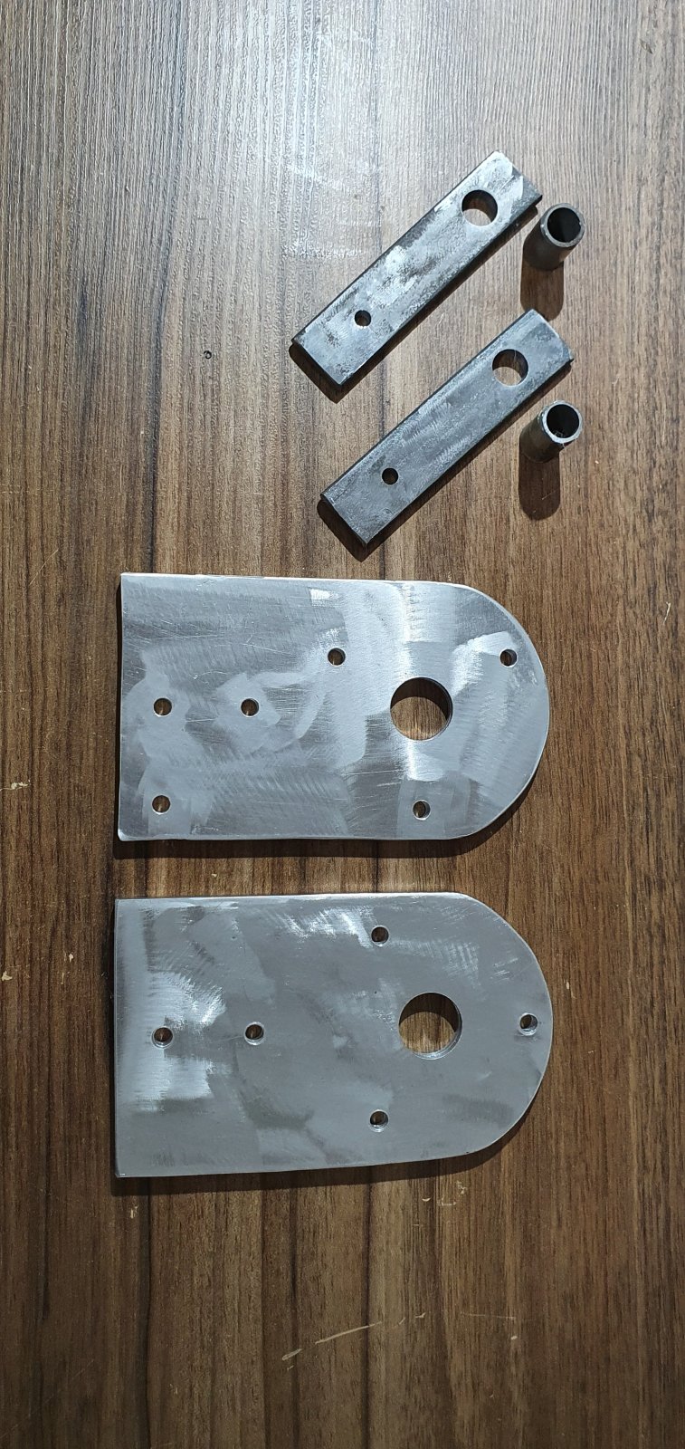

    More part's!
    Motor:

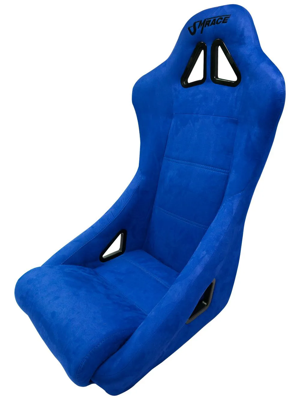

    More part's of the project:
    image-1.png Seat

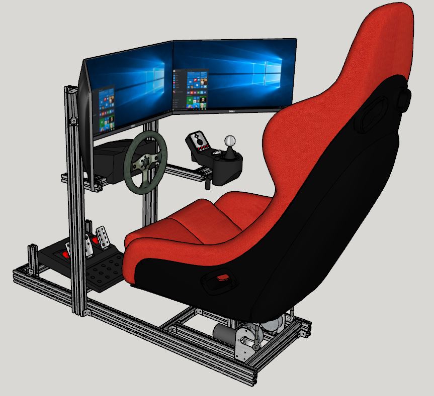

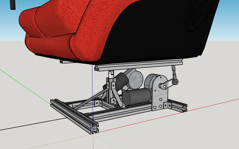

    Final design:

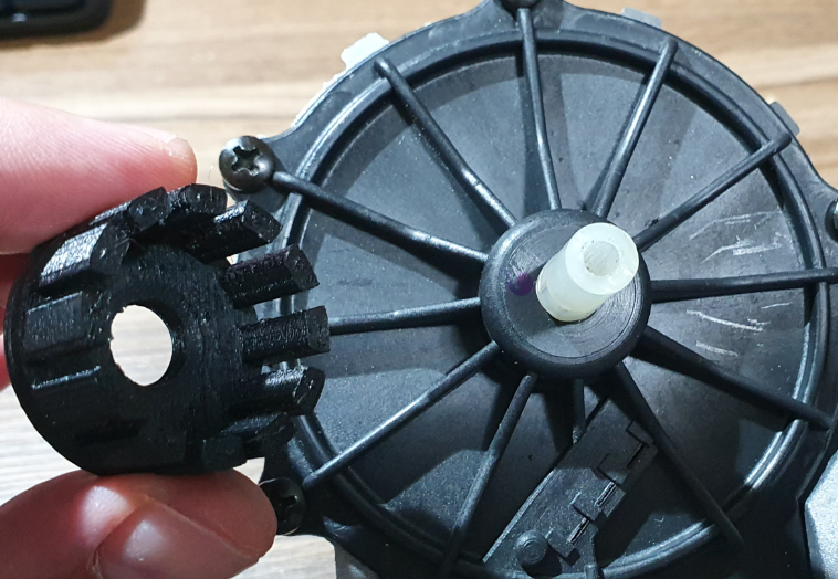

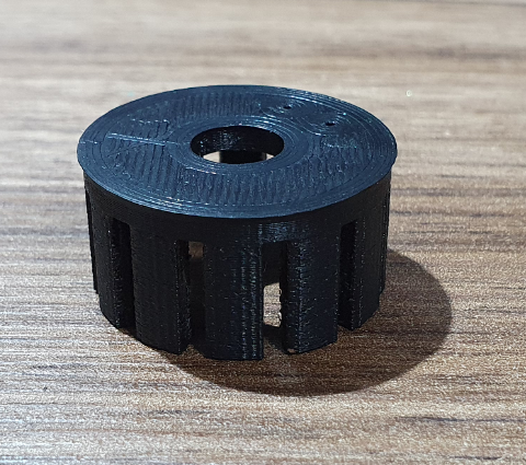

    Position feedback 3D Printed:

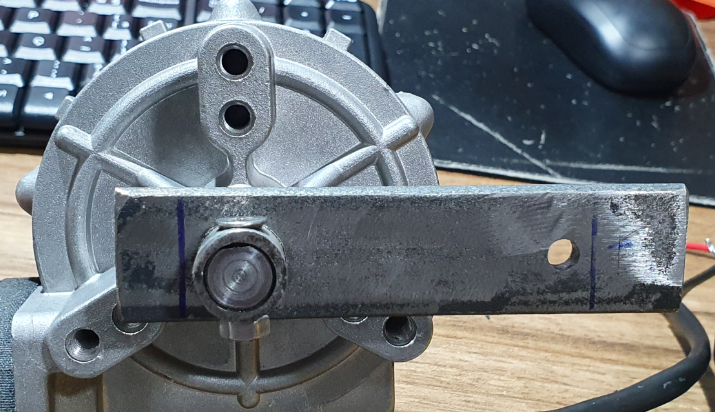

    Arm of the motors:

    I noticed that he is Brazilian too. I am using similar engines in my project. I bought the 70rpm 35nm but found it weak (for my purpose). Then I bought the 30rpm 50nm and it worked!

    I will try with the 82rpm motor, if not work well, I change to the motors that you inform.

    Hi, thanks for sharing. I will follow your project with interest
    Do you have the characteristics and the reference of the electrical elements? (engine, engine control card)

    Yes!
    Arduino Uno R3
    Power Supply 12v 50A 600W
    Motor:
    H Monster

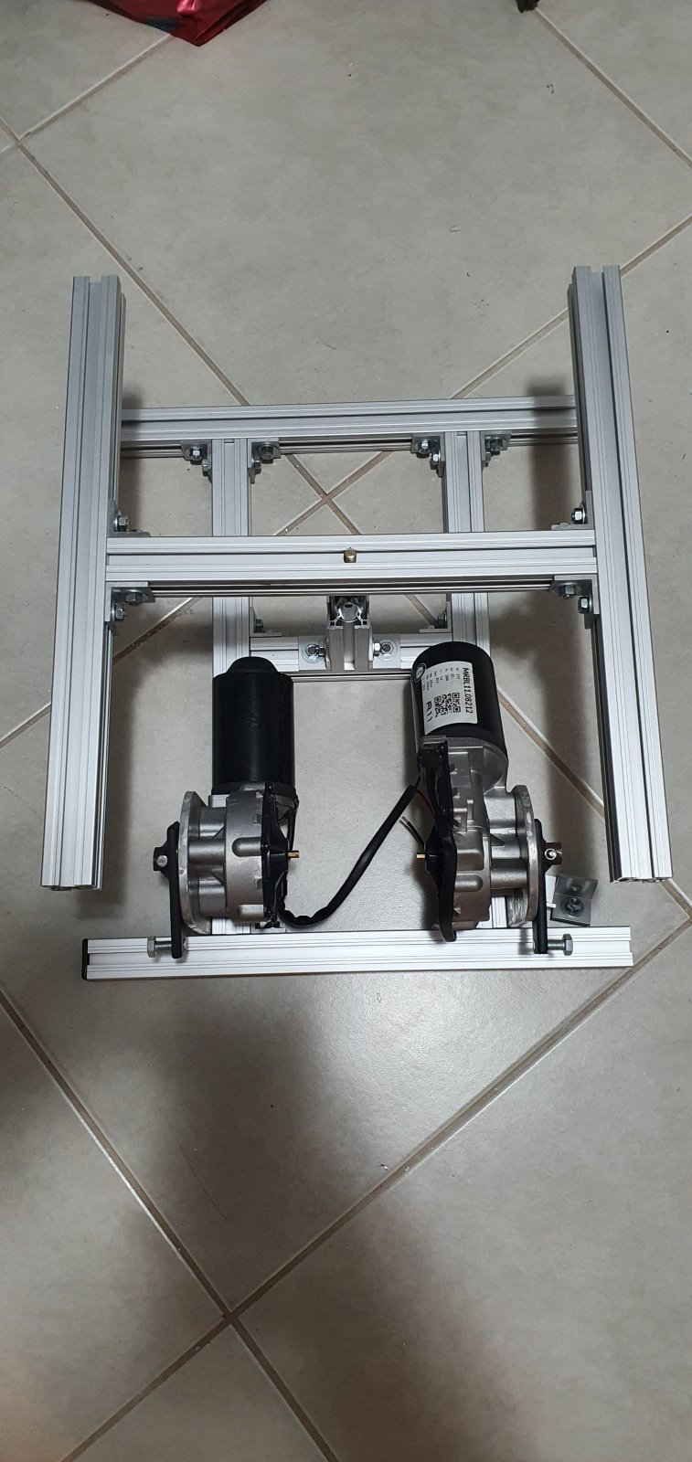

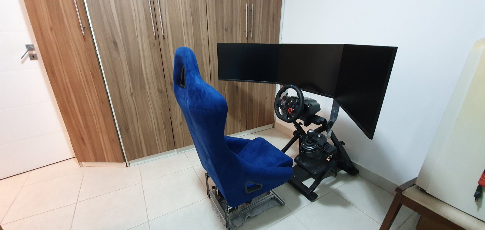

    More progress!
  18. p00ky
    p00ky Active Member
    May 4, 2020
    117
    Self Employed Laser Cutter
    Wales
    392Coins
    +66 / 2 / -0
    Wow that is sleek. I hope the Alu extrusion can cope & that no one needs to get into the closet :D Makes me wonder if I've gone a little over bvoard for my first build.

    :grin! The final position of the rig I don't know were, but is not in front to the closet!

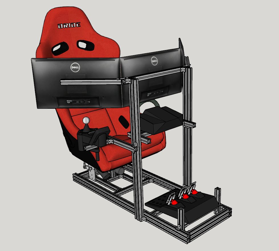

    I will do all the rig with alu, to get a nice view. I order de part's today.
    Will be moreless like this:

    117
    Wales
    392Coins
    +66 / 2 / -0
    Looking good :) The thing I just made weighs a ton, I should have thought of Aluminium Extrusion. It makes for a nice neat and probably quite quick build. I shall be watching with interest.
