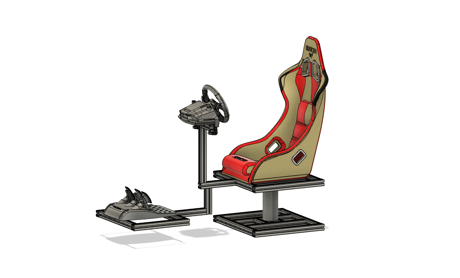

    Hey All
    Having spent the past few years on and off thinking about building a motion rig, I decided the time is right to bite the bullet and start.
    Due to space restrictions at home, the plan is to create a very compact 2DOF Full Frame, similar to noorbeast's beauty (but probably significantly worse build quality), that can be split apart for storage.
    The base, motors, controllers, PSU, UJ and Top section will always remain one piece, with the idea that I will make the wheel & pedal mount removable.
    I plan on re-using my office chair for the actual seat to begin with, which will screw and unscrew with some thumbscrews, and upgrade to a better seat once I have more room (will probably buy a new place later this year and plan to have a dedicated room!)
    I have started the frame design, but I am still trying to decide on motors and controllers. I will use server PSUs as I can get plenty from work gratis.
    For motors, I am leaning towards one of the offerings from motiondynamics (although shipping isn't cheap to the UK), at present I am looking at the Worm Drive 12V 200W 180 RPM motors.
    I would appreciate some thoughts on the motor controllers though. Are JRKs still the go to, or do people prefer a newer different offering?
    Looking forward to getting some parts ordered and starting the build!
    Anton

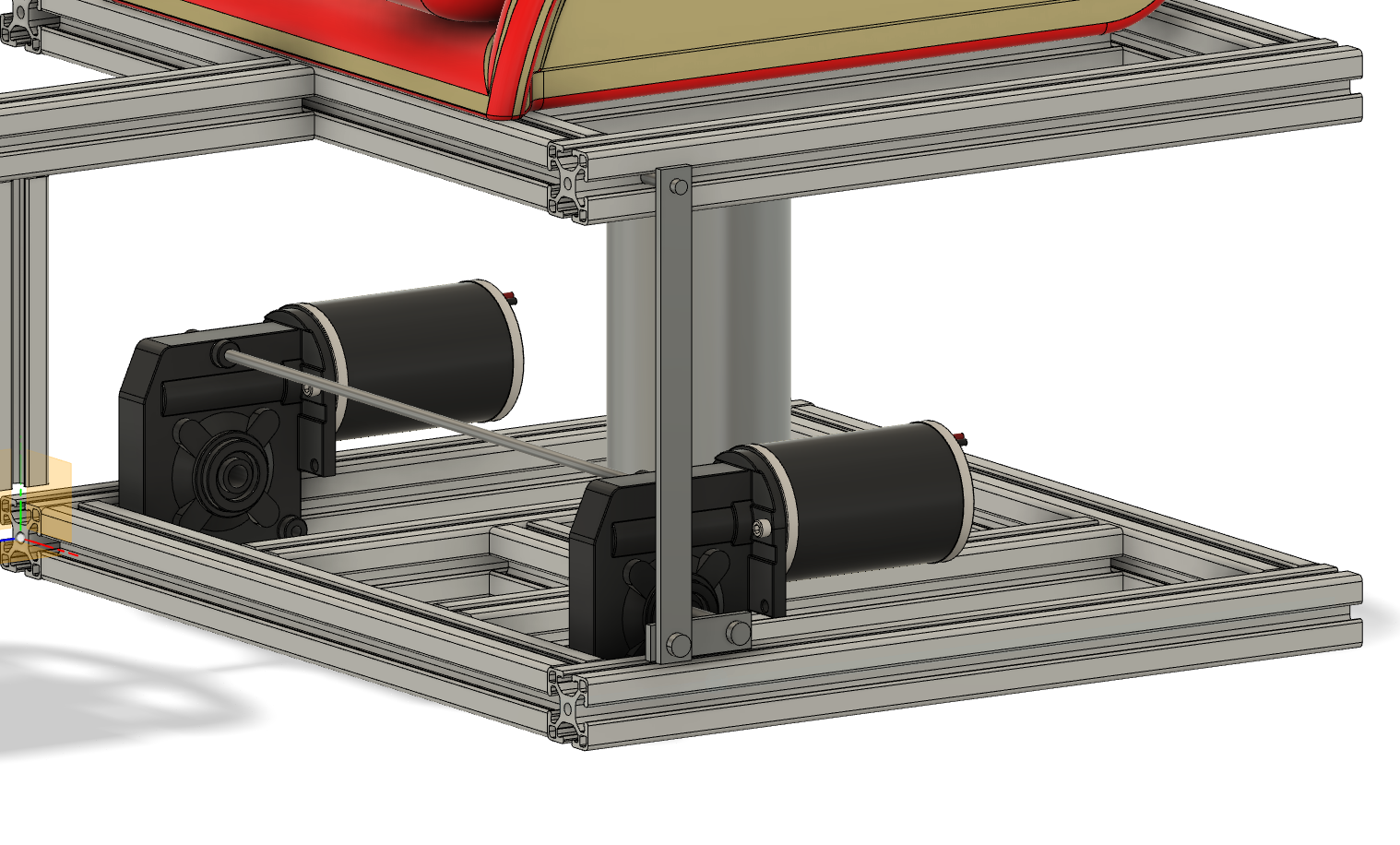

    So I have made a bit more progress on the planning, looking at how to mount the motor and and the arms...
    (I just modelled with metal bar, but the arms would be rose joints and turnbuckles/threaded rod, and I think maybe I need to push the arm out further, so that it can't interfere with one of the bottom tubes).
    Once I have finalised a few things, I will be running the numbers through the SimCalc application.
    I am currently trying to source the UJ. I am currently thinking:
    2X https://rimmerbros.com/Item--i-600656P (Flange Yolks)
    1 X https://rimmerbros.com/Item--i-GUJ108 (Universal Joint Bearing
    Does that look like the right thing? I have had car driveshafts built for me before, but never one with two flange yolks!
    Anton
