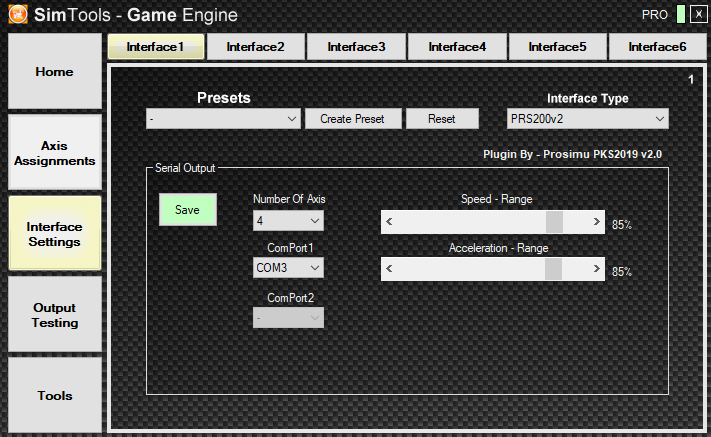

  3. gbdesai
    gbdesai New Member Gold Contributor
    May 28, 2019
    23
    84Coins
    +7 / 0 / -0
    Very good idea. So I'm away for the next two days. But I do know my settings....
    I have on Interface 1, COM 3 @ 115K, 8, N, 1 and it supports 4 axes (the actuators are PRS200 with 150mm travel).
    I need to be able to send a command to lower all 4 of those axes as far as they go.
    I have an XKeys XK40 to able to execute shortcuts or issue commands in Windows with a single button press. I guess I don't know the syntax of axis control commands. If you could help me with that I may have found the solution!
    Thanks for your time.
    G

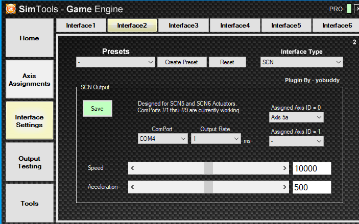

  5. gbdesai
    May 28, 2019
    23
    84Coins
    +7 / 0 / -0
    Here are my two interface screens...
    [​IMG] [​IMG][​IMG][​IMG]
    Let me know if you need anything else, both are running 115.2K baud, 8, N, 1
  6. yobuddy
    51,664Coins
    +5,204 / 19 / -0
    I'm guessing the scn is your traction loss actuator?
    If so then we don't need to do anything with that, correct?
    As for the top pic, unfortunately they are using a custom serial plugin, so we don't know how to send it data.
    Do you know how to setup your sim using the normal serial plugin?
