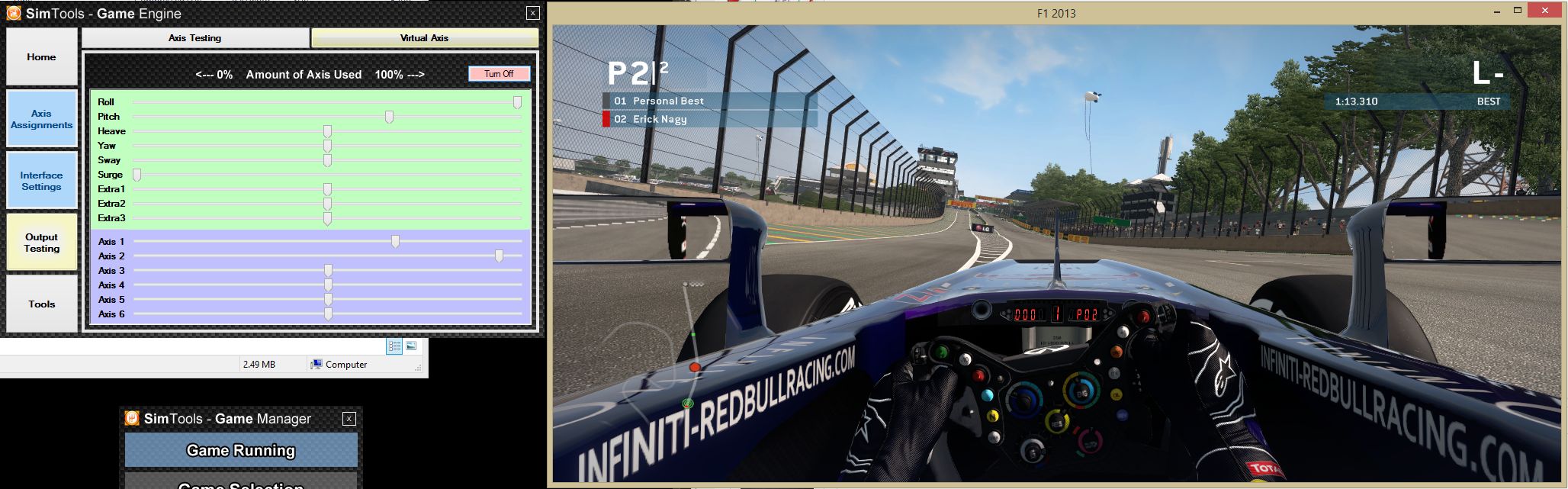

    Guys, looks like roll is inverted, with a car in a left bank, virtual axis slider is all the way to the right...
  3. eaorobbie
    20,400Coins
    +1,683 / 23 / -2
    Nice catch yes you are correct.

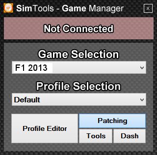

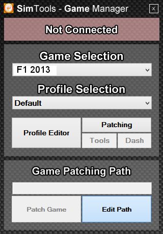

    Hi @husam
    There's no need for C# to run a plugin with SimTools:
    Start the SimTools Plugin Updater, that you can find in the SimTools installation directory.
    Drag'n'drop the F12013_Plugin.zip (no need to unzip!!!) into the Updater window
    Close the updater.
    Start the GameManager
    Select the Entry F1 2013 and click on Patching.
    A Game Patching Path drawer slides out.
    Click on Edith path and follow the instructions (essentially: select the save-game path of F1 2013 like C:\Users\…yourname…\Documents\My Games\FormulaOne2013\hardwaresettings
    There should be a confirmation that the game was patched.
    Start GameEngine and the game and enjoy!
    (Assuming the axis and interface settings have already been done. Otherwise check the SimTools Quickstart Guide.)

    Hi @value1, I just tried the new update and added extra1 to my 4th axis, then tried it but it reacted really crazy, like before the race start it puts the simulator to one side while I not even drive away, and when I loose traction it not reacts at all...maybe something wrong with the update ?
    also another question, should I invert the roll or is it changed already ?
    anyway I don't want to sound un gratefull at all, I am just a total noob at sim building and aspecially the setting up on PC, so I thank you for all your work :thumbs

    Thank you @Al.Bundy for your feedback. I don't have F1 2013 so this was somewhat a shot in the dark.
    I have updated Codemasters F1 2013 plugin with a new update entry:
    Traction Loss corrected
    Read the rest of this update entry...

    Hey @value1, tested f1 2013 today and put my 4th axis to 100% on extra1 and woahh it works fabulous !!!! Really cool and feels just like real, thanks so much :cheers:thumbs

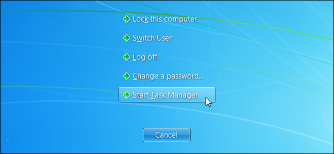

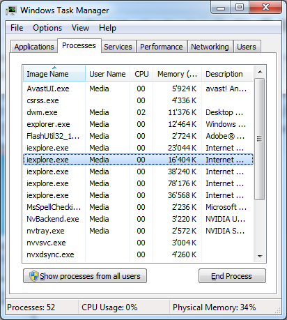

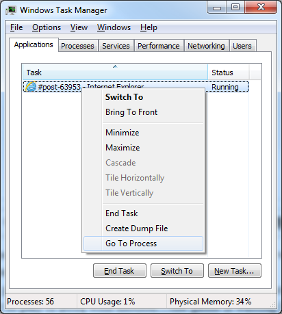

    Please run the program and check the .exe name by pressing Ctrl-Alt-Del – Start Task Manager
    Right-click on F1 2014 and select Go To Process
    Read and report here the name you see highlighted (in the example below "iexplorer.exe")
    That's all.
  18. Al.Bundy
    Al.Bundy Member
    Jul 14, 2014
    77
    mechanic
    belgium
    682Coins
    +50 / 1 / -0
    It says the following : F1_2014.exe *32
