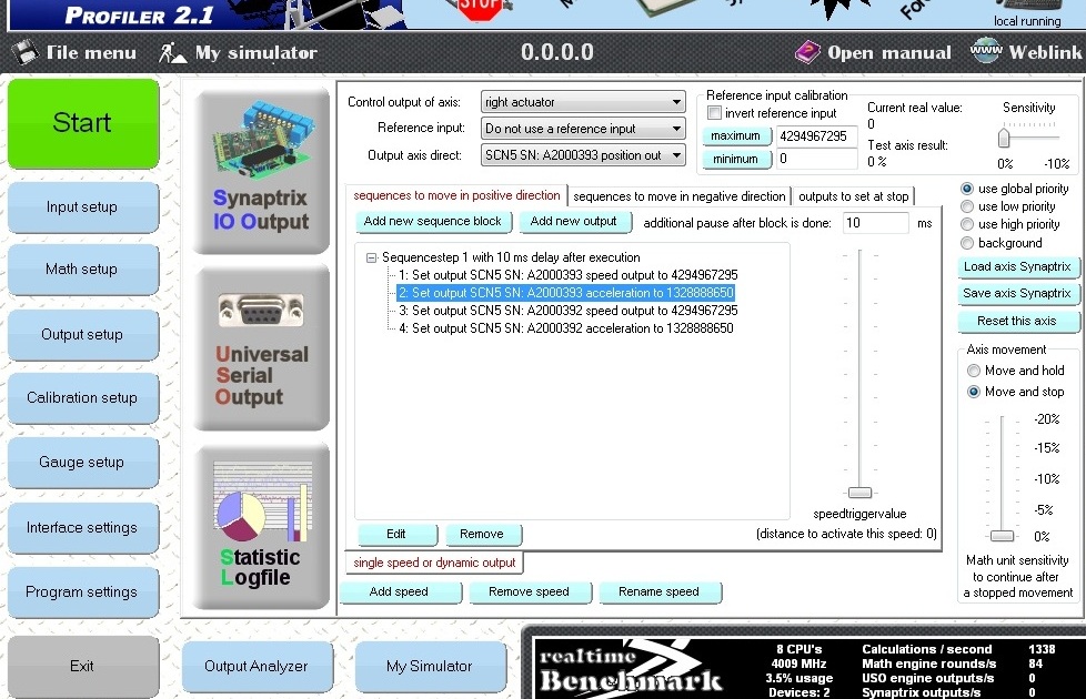

    Is this what you mean by synatrix. The values seem high here. This is after I loaded up your profile.

    hi
    this is right.you can delite this and than you can use the scn5 pluginsettings.

    Thanks, ill do this now.
    Edit: Yes speed and acc working good now thanks.
    Regarding the shudden shock when you change gear.
    I changed the gear rumble effect to 0% but when I change gear there is still so much fowward shock movement, is this impossible to change (make less movement when changing gear) from this profile.?

    hi
    the gear effect is in velue 27 to. but you can change the scn5 settings.
    i mean more speed and lower acc is better for you.
    test with speed on 22500 and acc between 200 and 400.
