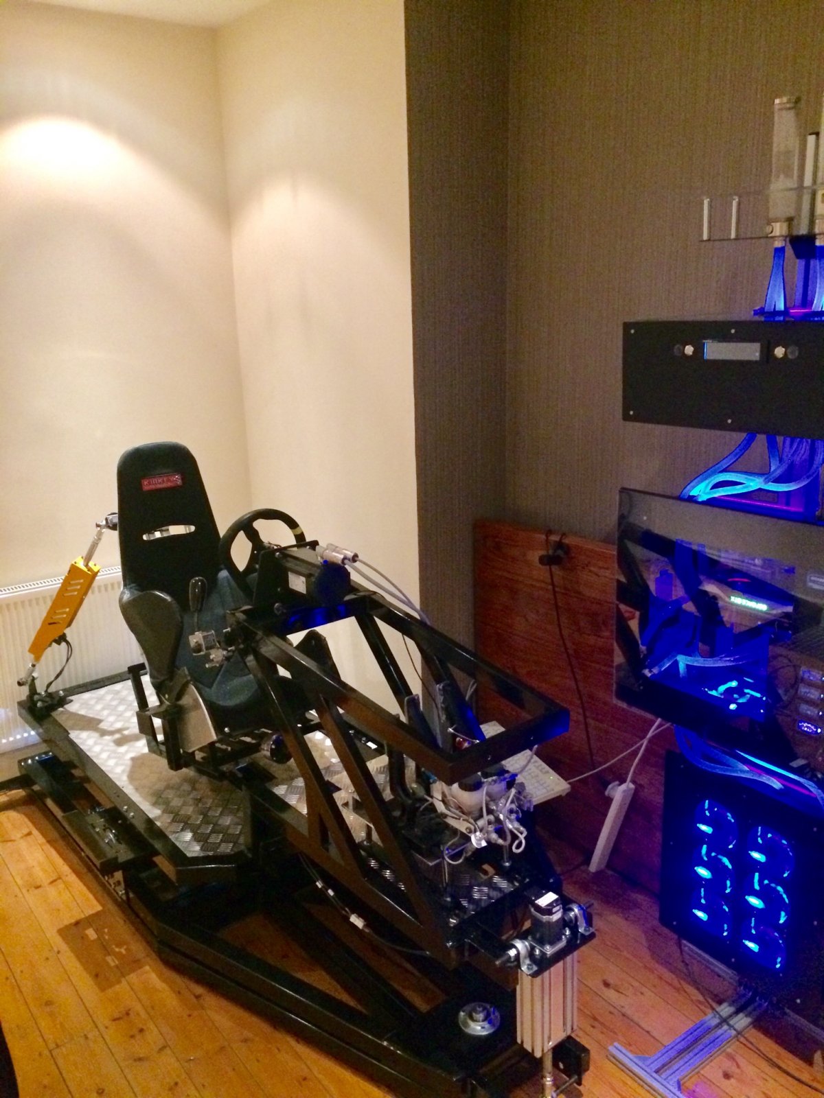

    Laser cutting is the way I went
    You do need to supply the CAD though
    I had many parts made
    -see my thread -I’m going up organise it & add some close shots of parts
    Cost varies a lot depending where you go
    but it’s not that expensive considering one is receiving high grade custom parts

    For my rear traction loss I had x4 metal sheets laser cut for this exact thing,
    6 bearing holes in each plate
    Those plates were welded to the frame
    Some small distortion due to heat ment I then had to use a few spacers to make sure each bearing was in contact with upper plate
    Laser cutting is very accurate it will do exactly what the CAD says

    no, clear straight through the metal, obviously allow for a very small bit of extra on the measurements,
    they can mill metal so not all the way through but for simplicity & cost best stick to straight laser cut
    e.g. if the bearing housing outer diameter is 40mm
    then hole needs to be around 40.5mm
    Ps because of minor metal destortion due to welding try to bolt on parts that have critical spacing if you can ,
    spacers are a good solid solution if needed though

    There’s lots of little metal fabrications & laser cutters in my home city ( Leicester , UK )
    I can send you details if you require
    -but if I were you I’d personally find a couple locally to you & go in to have a quick friendly chat & askif they’ll do a cash job , if you find a local friendly one they’ll be able to help you on other stuff too , they’ll surely have metal cutters / welders
    Water jet cutting is fine too for your requirement -they’ll maybe have both laser & water
    They should stock a selection of sheet metal,
    3mm to 5mm ( you don’t want flex but you also don’t want unnecessary weight )
    If you find a small helpful place then you’ve made a big step forward, if cash etc it should be quite cheap too , tell them your close by & you’ll personally collect & they can fit in between their other jobs to suit them
    In my case I supplied all the steel box tube
    -ordered it online & had it delivered directly to them , they the laser cutters supplied the sheet metal for the laser cut parts
    I obviously independently bought the bearings / joints & misc stuff for the final build
    I’m very very happy with mine it’s rock solid & never gave me any problems
    Only thing I’d change if re-doing it is I’d really try to make it smaller/more compact
    Pic above
