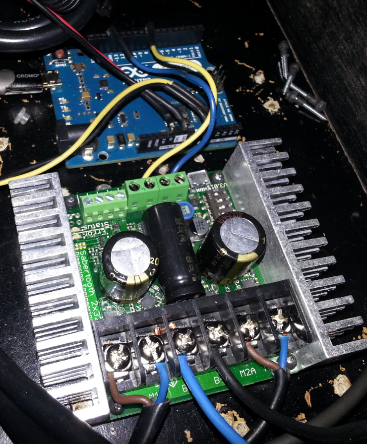

    wanegain excuse the trouble I run your step by step guide but do not get any movement in simtools
  8. dualclick76
    dualclick76 Active Member
    Mar 23, 2015
    163
    italia
    11Coins
    +40 / 0 / -2
    turning the pot does not get any movement as I see if it works?
  9. dualclick76
    Mar 23, 2015
    163
    italia
    11Coins
    +40 / 0 / -2
    guys help me I do not know what and how to try

    Can you post a link to the guide you mention so we at least have some idea of what you have done, along with pictures of settings and wiring. @Wanegain do you know what @dualclick76 means here?

    This is the procedure I used

    This is the cable

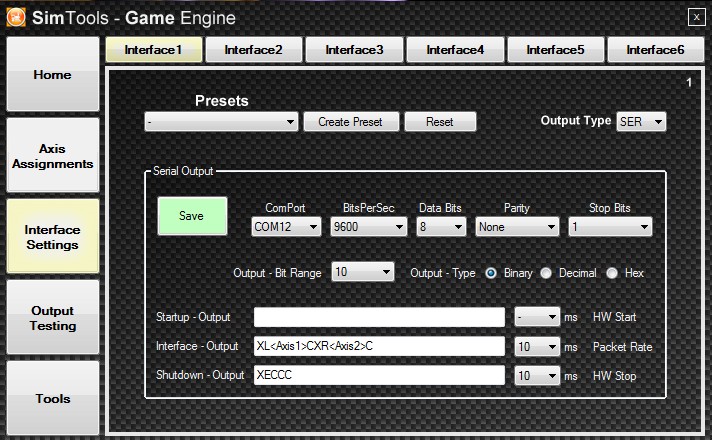

  17. dualclick76
    Mar 23, 2015
    163
    italia
    11Coins
    +40 / 0 / -2
    This is the setup simtools
  18. noorbeast
    21,740
    152,213Coins
    +11,065 / 56 / -2
    So can I confirm that you have checked the wiring and installed the Sabertooth libraries?

    I confirm that I have installed libraries sabertooth that there are on the page of winegain

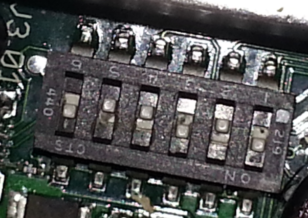

  20. dualclick76
    Mar 23, 2015
    163
    italia
    11Coins
    +40 / 0 / -2
    The DIP switches on the Sabertooth must be like that (2, 4 and 5 OFF) :
