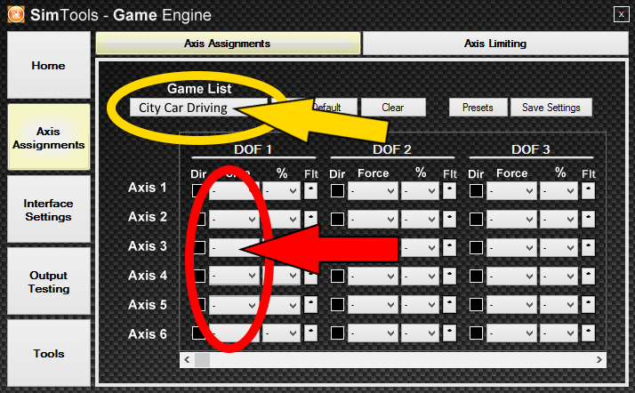

    Hi @leaedman
    These plugins (memory hooks) are extremely sensible to the game version.
    What exact version of City Car Driving are you running?
    (and please check, that there are no weird settings for City Car Driving in the Axis Assignment of GameEngine
    Axis Settings CCD.png )

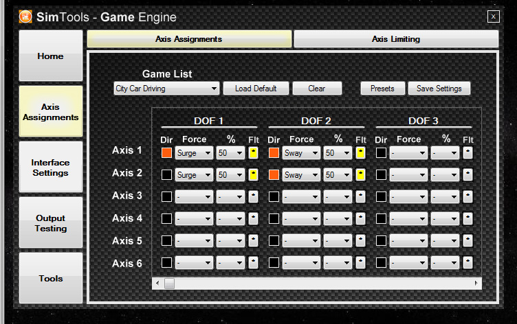

    I still can not. Here are my settings on Game Engine :
    For Game Manager I selected the "Forward Development" folder. I also tried the "City Car Driving Home Edition" folder. I made a mistake somewhere? :think

  18. noorbeast
    21,601
    151,263Coins
    I can confirm the City Car Driving plugin works.
    Sorry somehow I missed this earlier when you posted it @leaedman. Unlike most other driving simulators City Car Driving only supports pitch, roll and yaw axis, as per here: http://www.xsimulator.net/community/marketplace/city-car-driving-plugin.117/
    So what you have set below will not work, please try again with pitch, roll and yaw instead:
