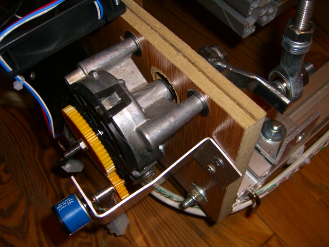

    macht das justieren deutlich einfacher
    man braucht die Potis nur ein Stück wegziehen und kann den Stuhl dann einstellen

    Good job! I like the way you placed the potentiometers!
    What gear ratio are you using?
    Where did you get the gears?
    what value are the potentiometers? they are multi-turn or simple 270 degrees?
    One more thing, how do you feed the motors? What kind of power supply are using? It is a transformer or a switching power?
    Thank you very much

    Excelent work!!! what value are the pots you are using? they are multi turn?
    And what relation are the gear pots?
    Thanks a lot!!!
