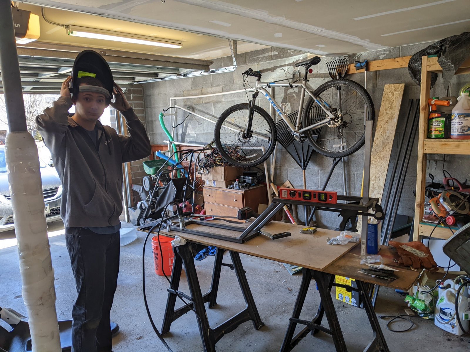

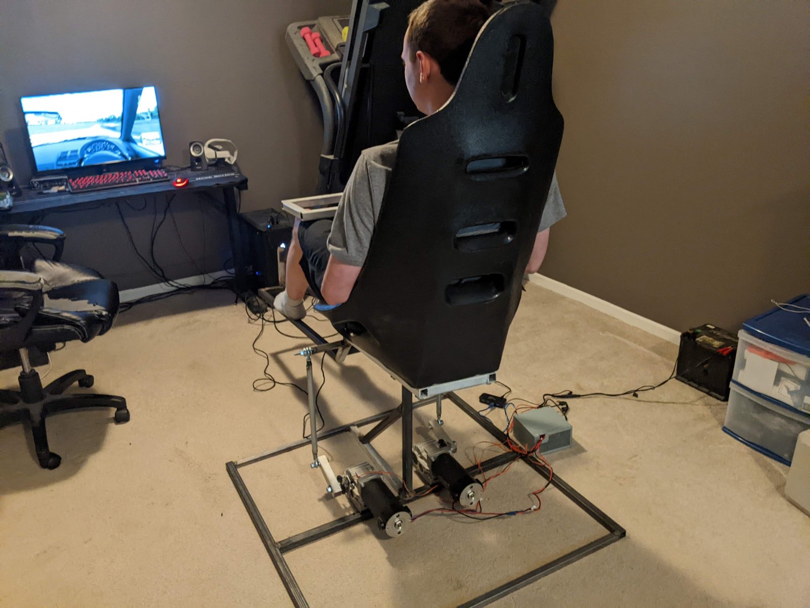

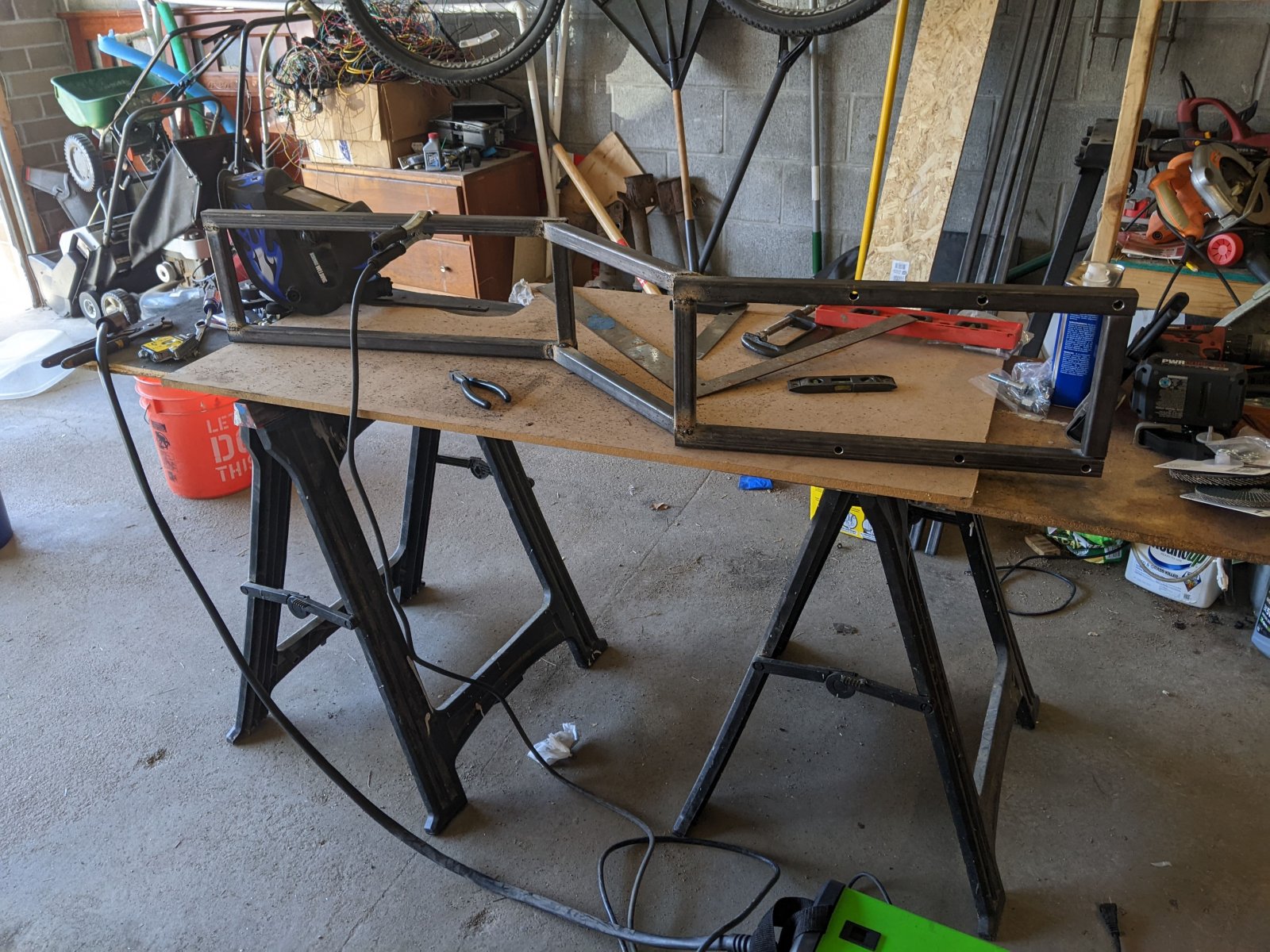

    Building a 2DOF sim with my sons. Specs so far are ibt2 controllers and jazzy wheelchair motors. Frame is built from 1 inch square tube and a steering u joint. The seat is from Summit Racing. I purchased a 24v LED power supply but smoked both IBT2s, working better with a 12v battery for now but still have not settled on a power supply or possibly different controllers.
    Just got to the point where everything is tack welded together enough to test motion and geometry. It will get a little more bracing but everything seems to work well already.

    Great to see your rig in action :thumbs
    You may need to re-balance your rig once all peripherals are added, particularly with a compact design, which has limited inherent design leverage.

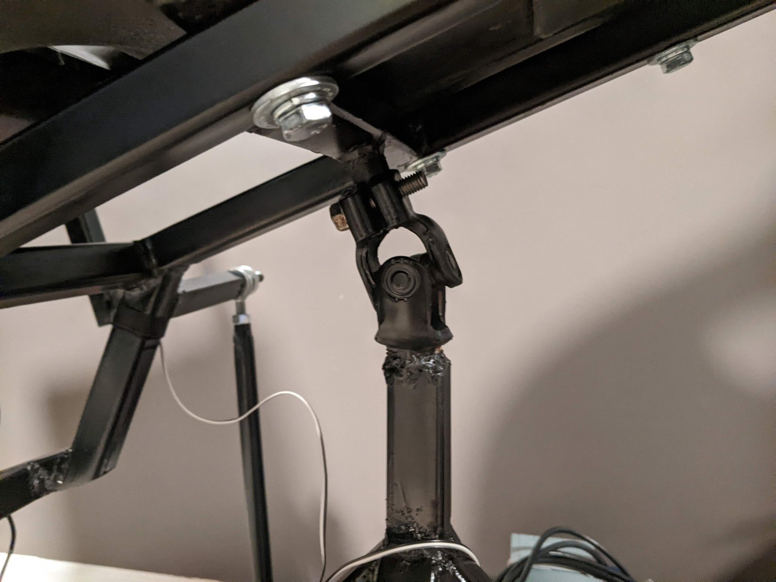

    What are you using as a uni-joint?
  3. ChrisOmaha
    ChrisOmaha New Member Gold Contributor
    Feb 23, 2022
    - 76Coins

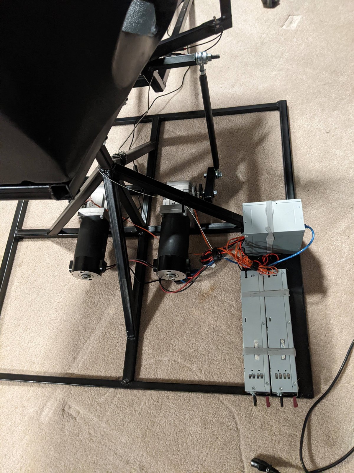

    The U joint is a steering linkage off some car at the junkyard. Didnt actually even see what the car was, just saw one what was in very good condition and was a little bigger then some others and easily accessible. I cut the bottom off of its shaft to weld onto the seat side, then use the pinch bolt to attach it to the seat frame while still being easily detachable. So far so good, no play in it at all.

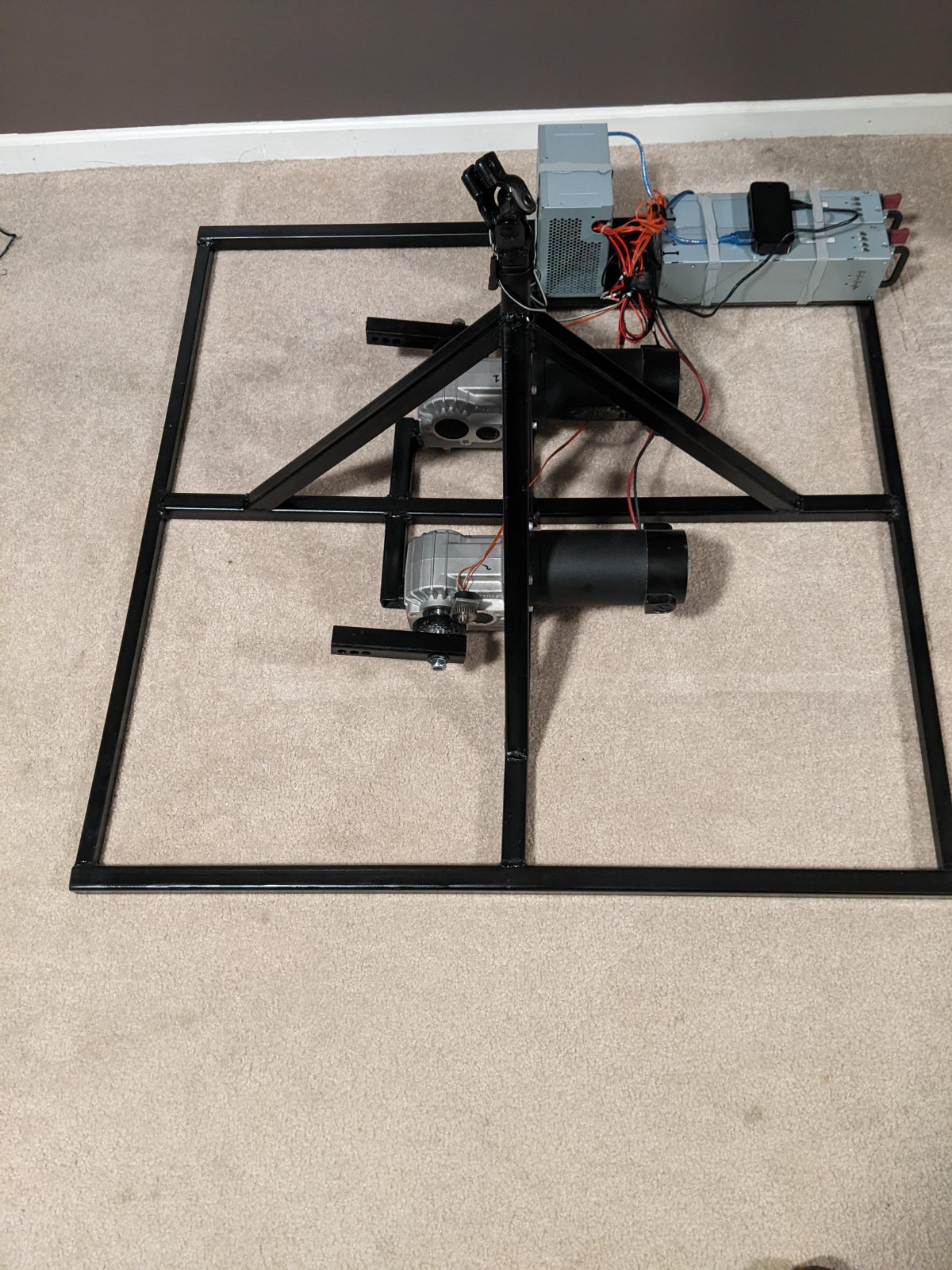

    This last week my eldest son completed all of the bracing and welding. Then my younger sons helped me paint and mount the pedals.

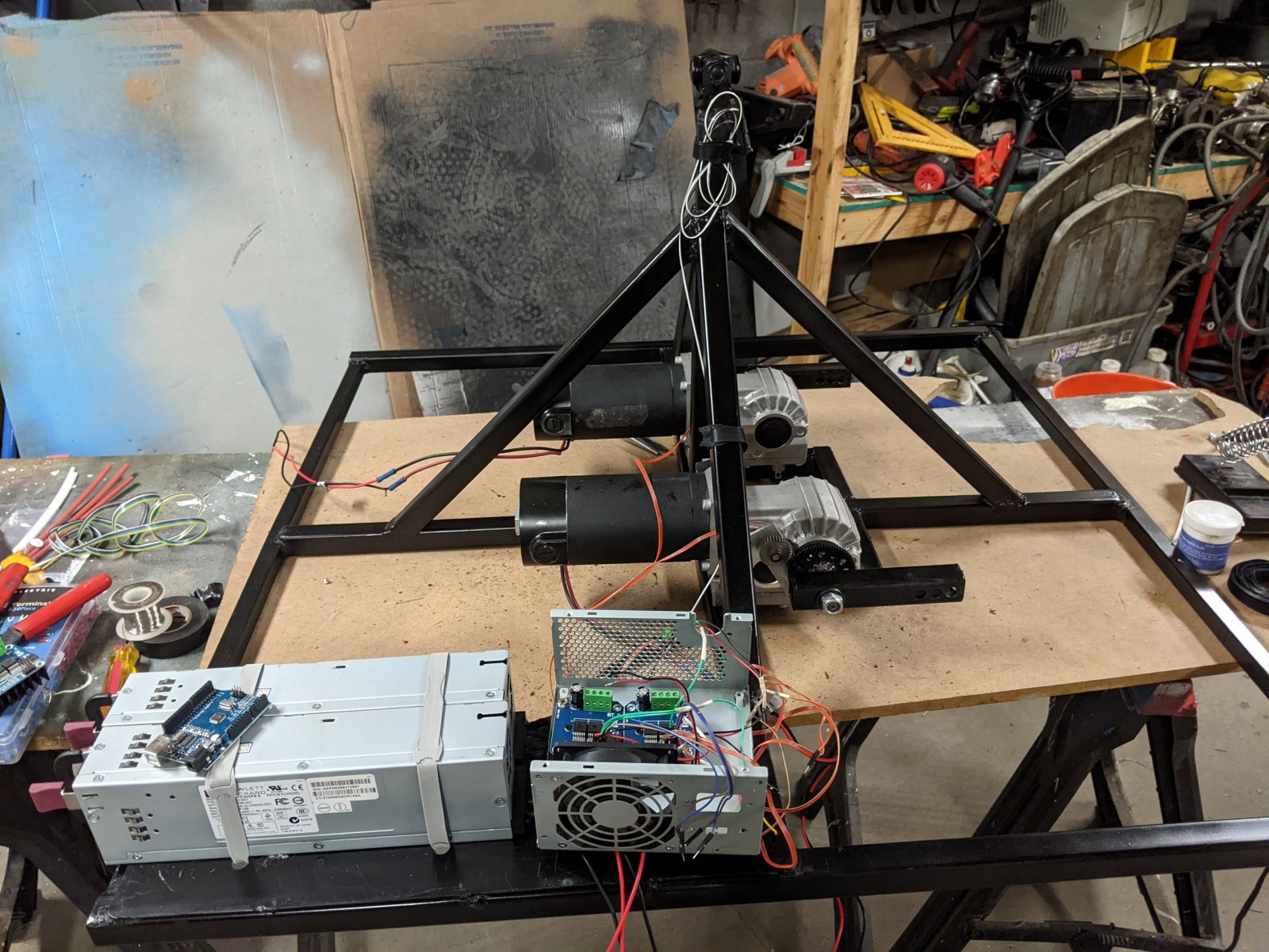

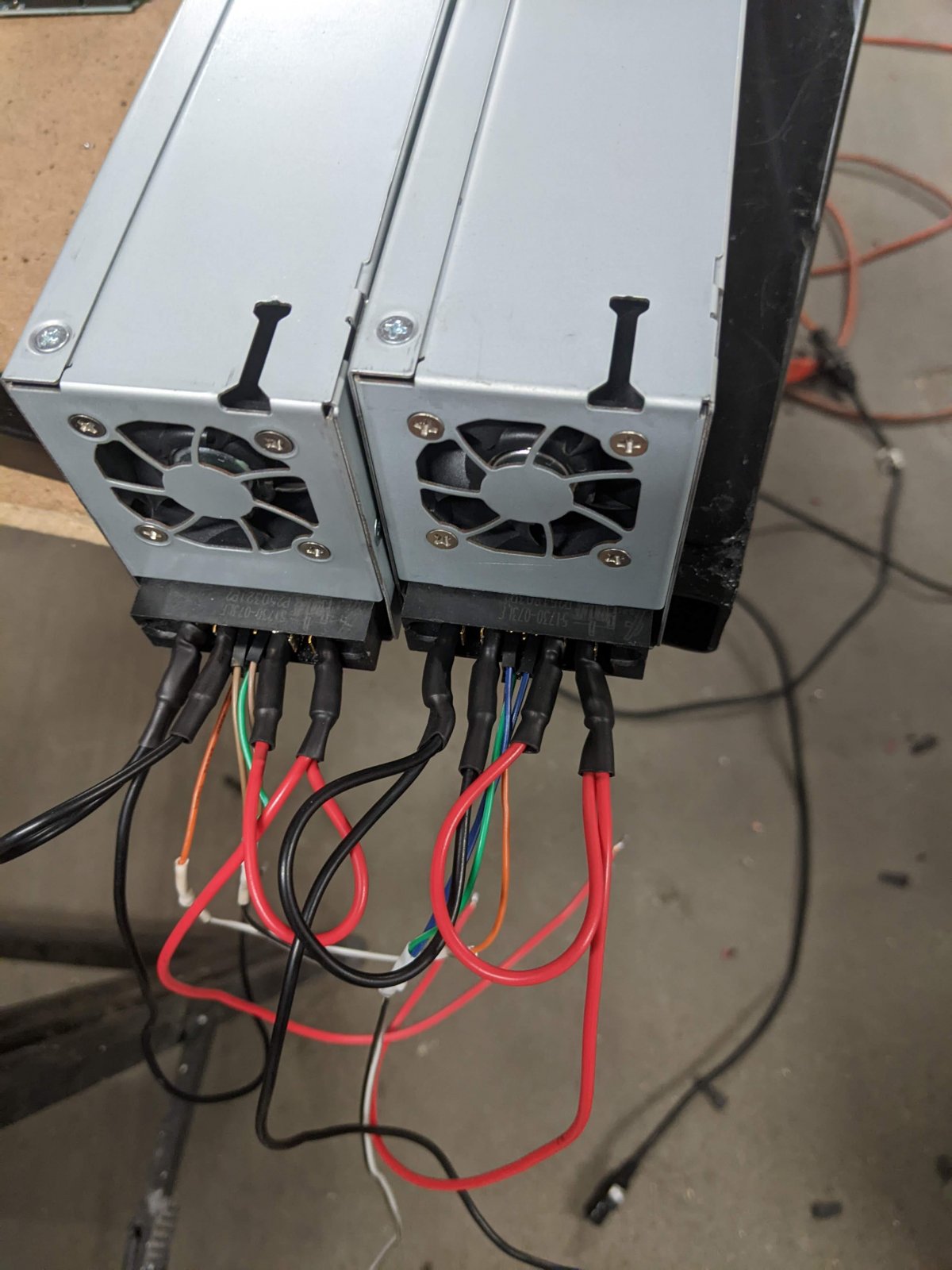

    I wired up some HP DPS-600pb power supplies to replace the car battery from the last test.

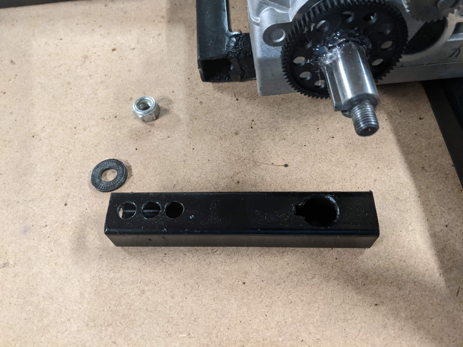

    Now it just needs more testing and tuning. May shorten the CTC arm a little more as the axis is currently limited by the nose hitting the ground so we could probably decrease backlash and increase resolution with a shorter arm. Otherwise its near ready to go.

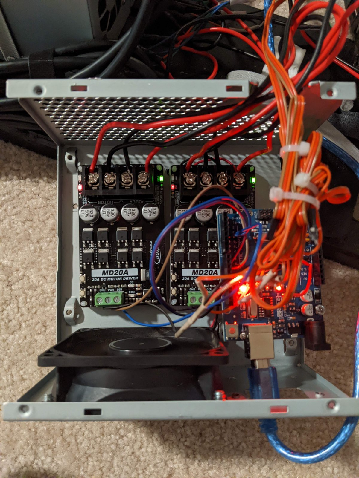

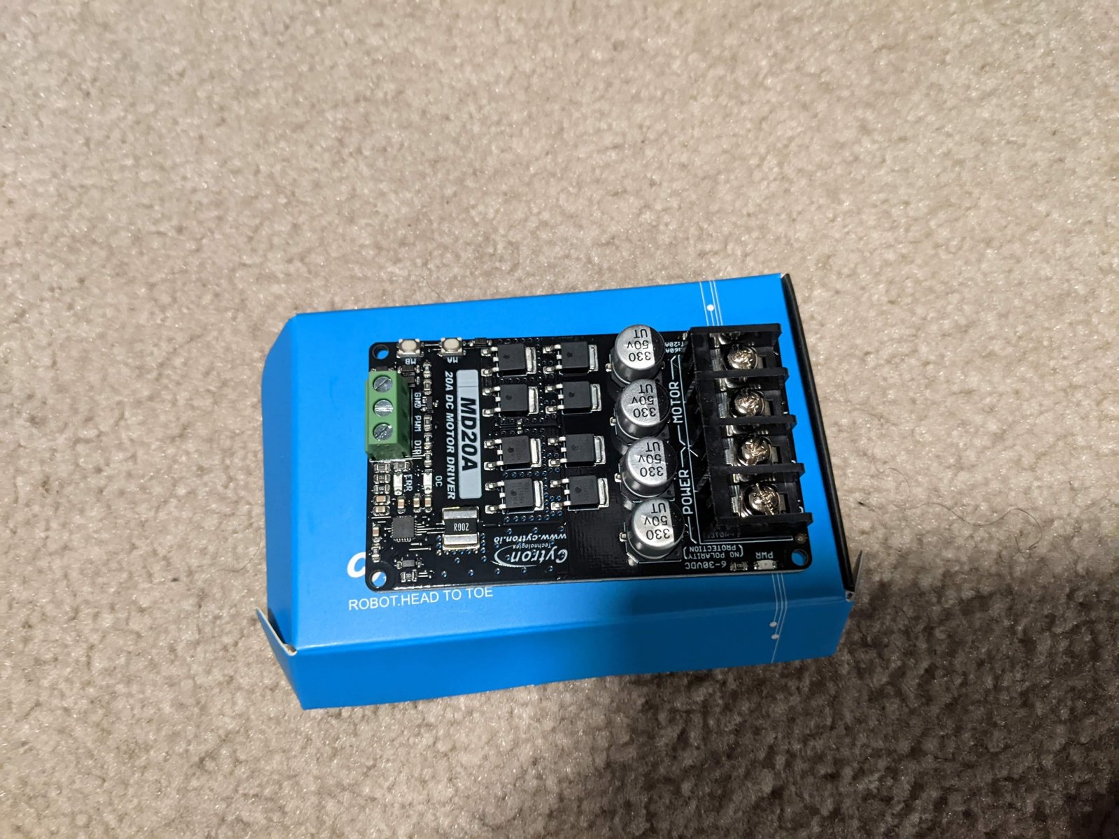

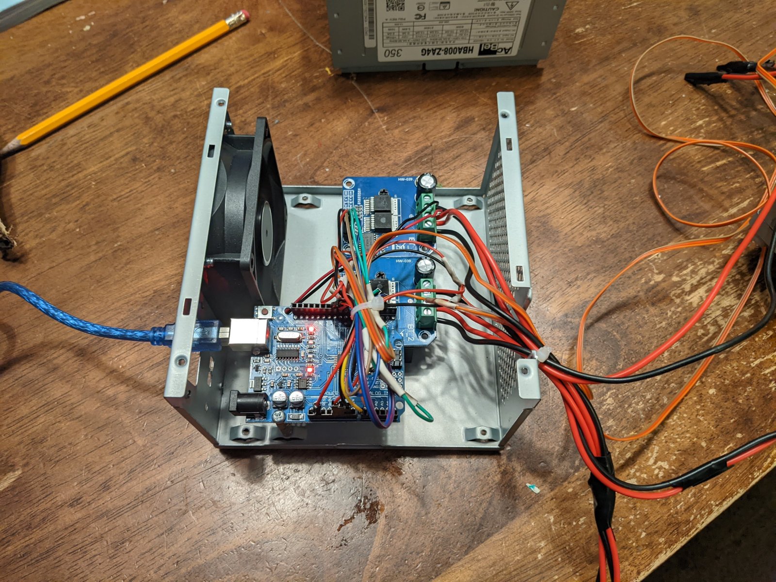

    Made a little more progress this weekend. The IBT2 controllers were regularly cutting out under aggressive loads such as crashes so I upgraded to two Cytron MD20A motor drivers which offer 20 amp continuous and 60 amp peak. So far these have been a great upgrade for the price. We put them through repeated violent crashes for a few hours and could not get them to trigger over current or raise their temp much above room temperature, even without heatsinks.
    I did manage to trip the HP power supplies a couple times but only with a smaller child and once when the chair was actually unloaded. I guessing its not actually load related but may be a regenerative spike during fast reversals that may be making them upset. I may try adding some large capacitors although it has not been a regular issue.

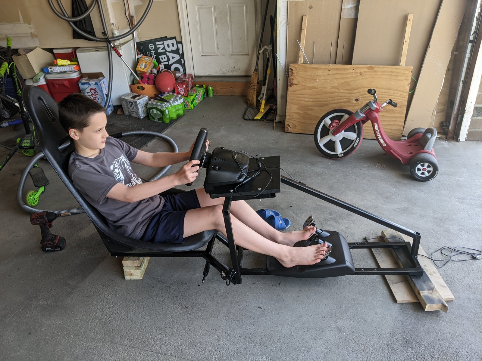

    I also played with monitor combinations. The quest headset makes me motion sick and limits games. I acquired a cheap 27" monitor and experimented with mounting to the frame but I feel like I may actually prefer the monitor not moving and actually liked it better on the desk. I may build a static stand that holds it just over the sim.

    Yes, I used mode 1 with the Cytron controller.
    I only used the pins below on the Arduino.
    9 Motor 1 PWM (PWM)
    2 ENA Motor 1 (Direction)
    10 Motor 2 PWM(PWM)
    4 ENA Motor 2 (Direction)​
    If its going away from the line you can reverse the motor + and - at the controller to reverse the motor direction. Or I believe you can also use ENB which is inverted in Mode 1.

    To solve the power supplies randomly tripping I added Pololu shunt regulators, specifically the 13.2V 15W.
    The shunt regulators with the Cytron/HP power supplies seems to be a reliable combination so far. I probably have a few dozens hours of use with no hiccups since adding them.
