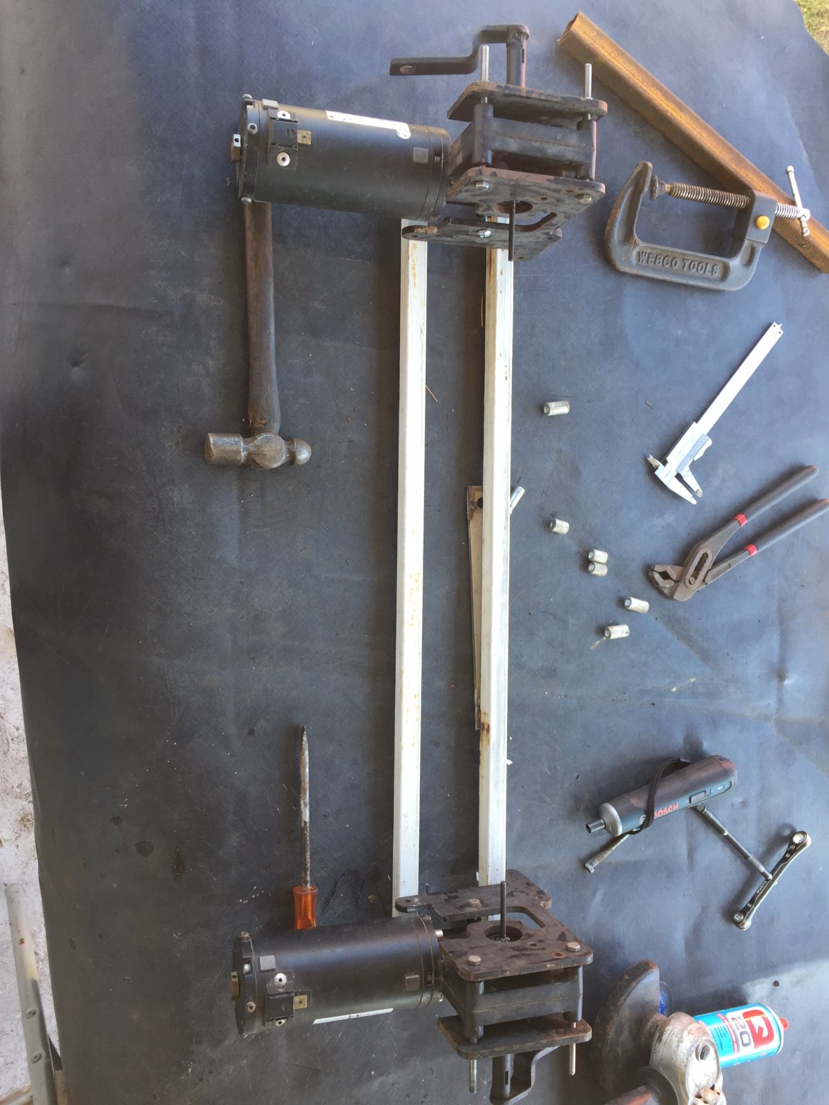

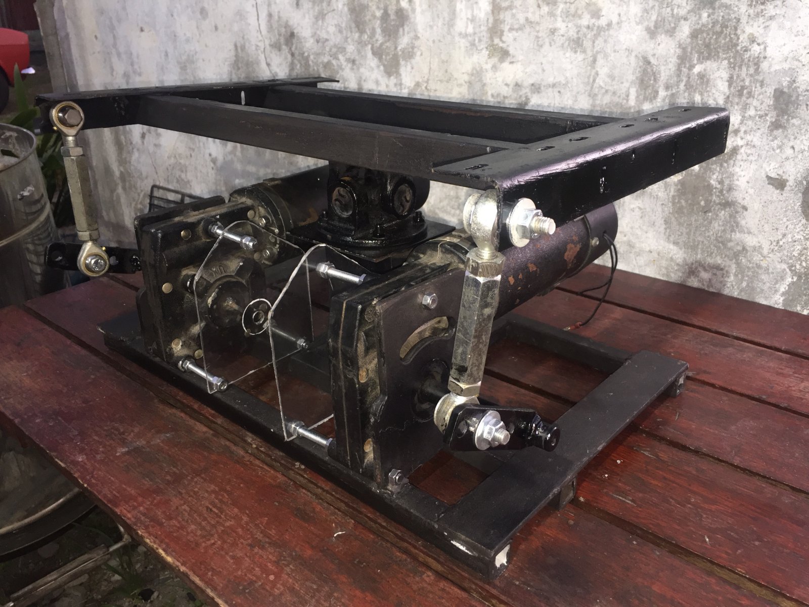

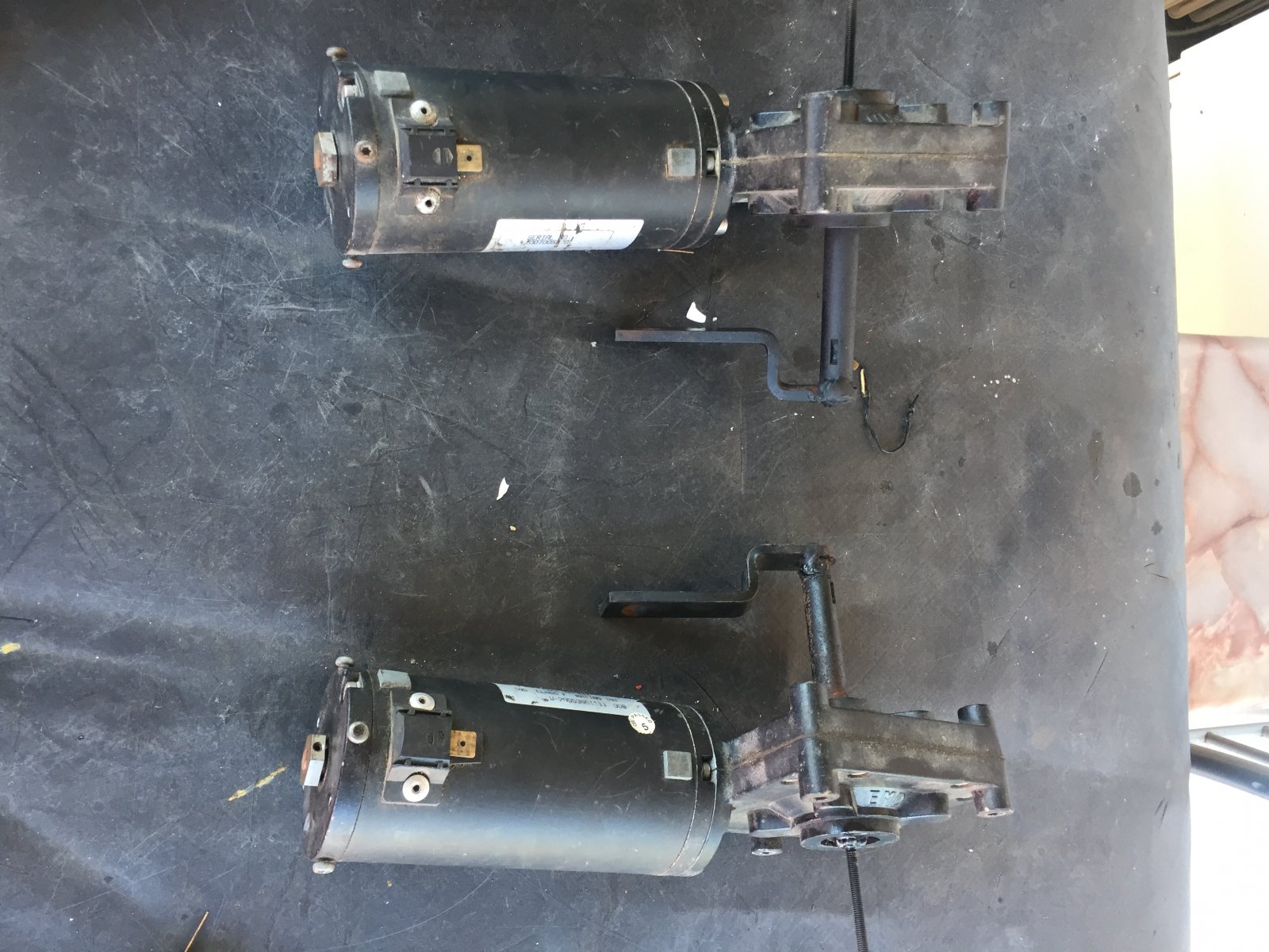

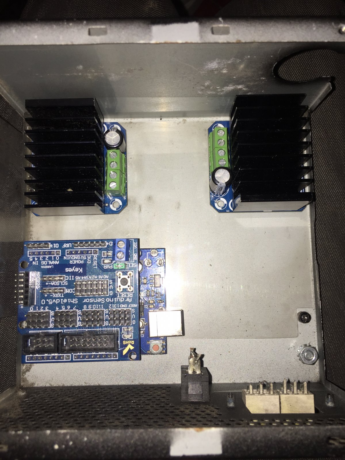

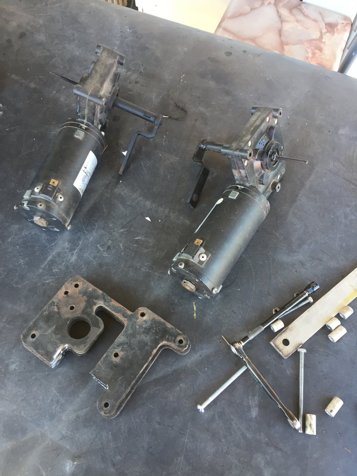

    Starting a new project with Wheel chair gearbox motors, using BTS motor Driver and Arduino Uno board something i wanted to tick off my list when started motion platform.
    1 x Arduino board with Sensor shield.
    2 X BTX 7960 might upgrade to JRK12V12 controller in a later stage.

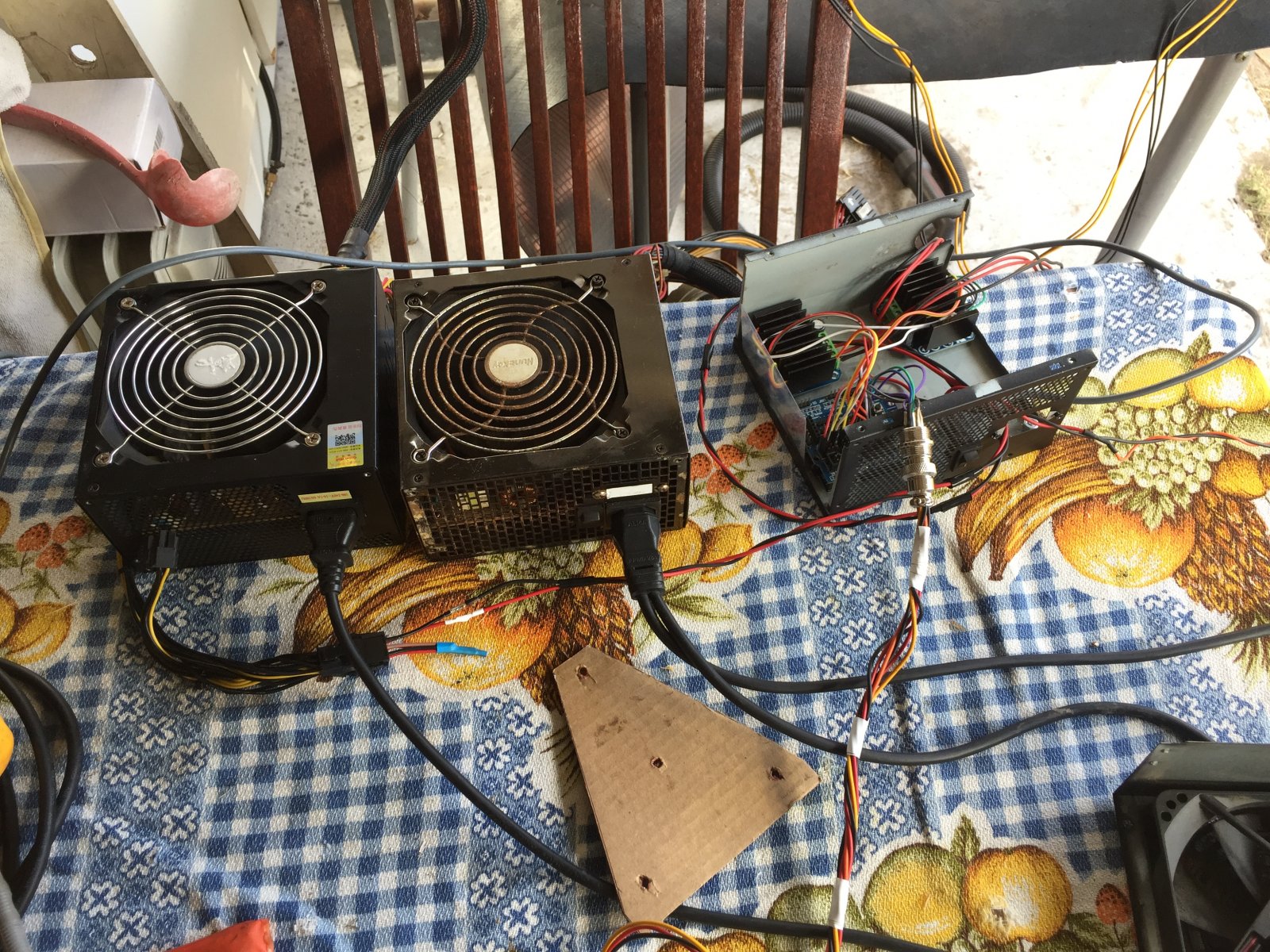

    2 x 500w desktop PSU.
    2 x Hall Sensor Pots.
    1 x USB Charger for 5v to sensor shield.

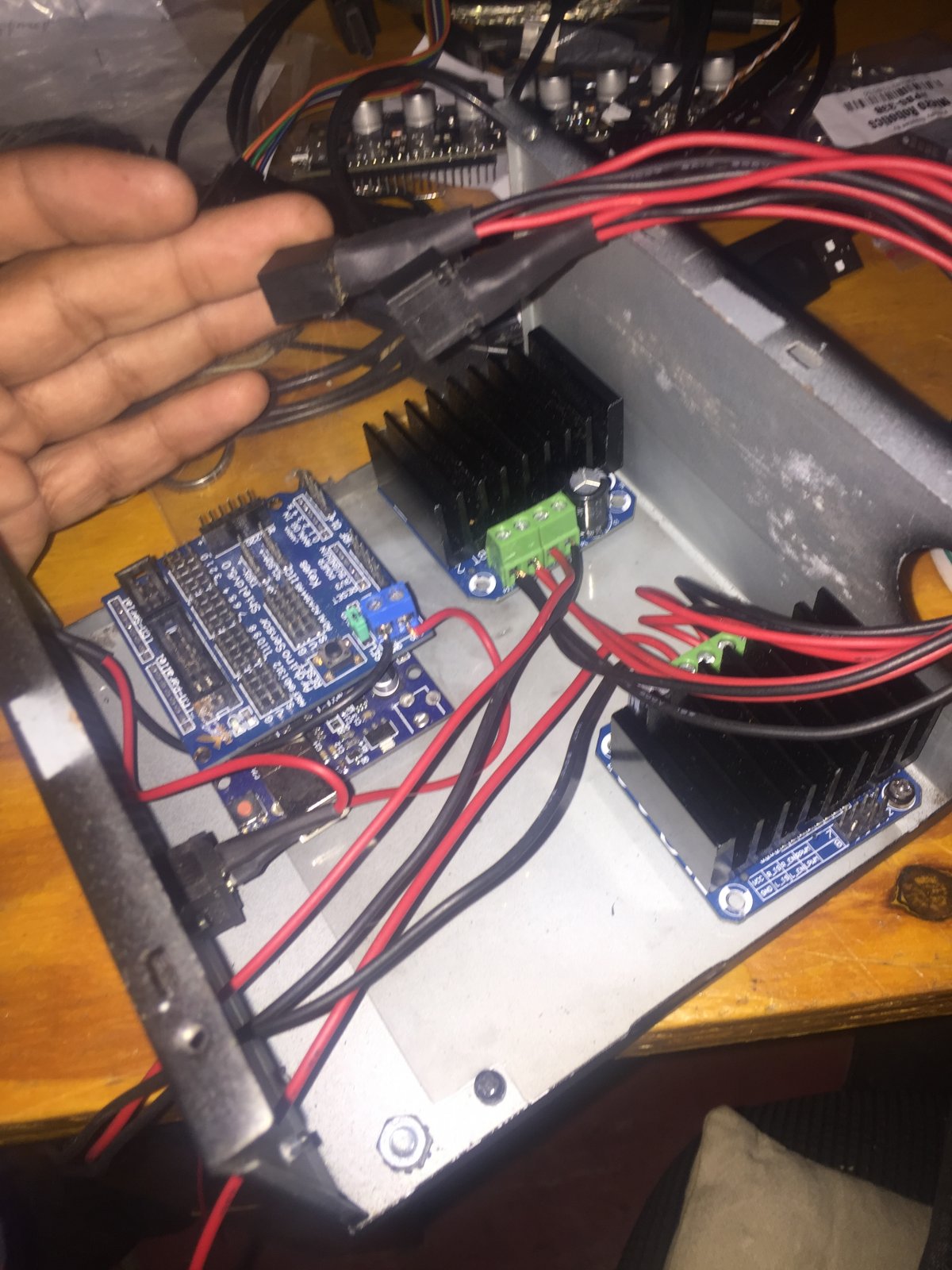

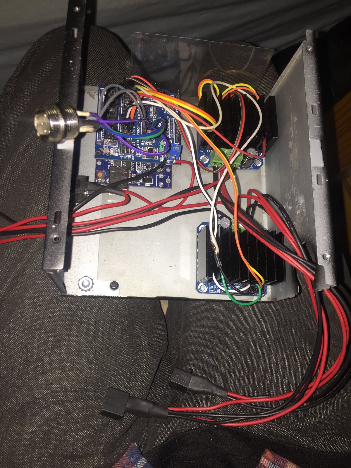

    Neatly packed in a PSU case.

    Congratulation to the start of your project.
    Wheel chair motors are really strong and in my opinion a good choice. I am also using them.
    Just one comment about your plan to switch to Jrk 12v12: I would not recommend this. All wheel chair motors I saw so far are meant for 24V, and these controllers only support 12V.
    I did it the other way: Started with Jrk 12V12 with some 12V motors and then switched to wheel chair motors, controlled by an Arduino and Sabertooth 2x32.

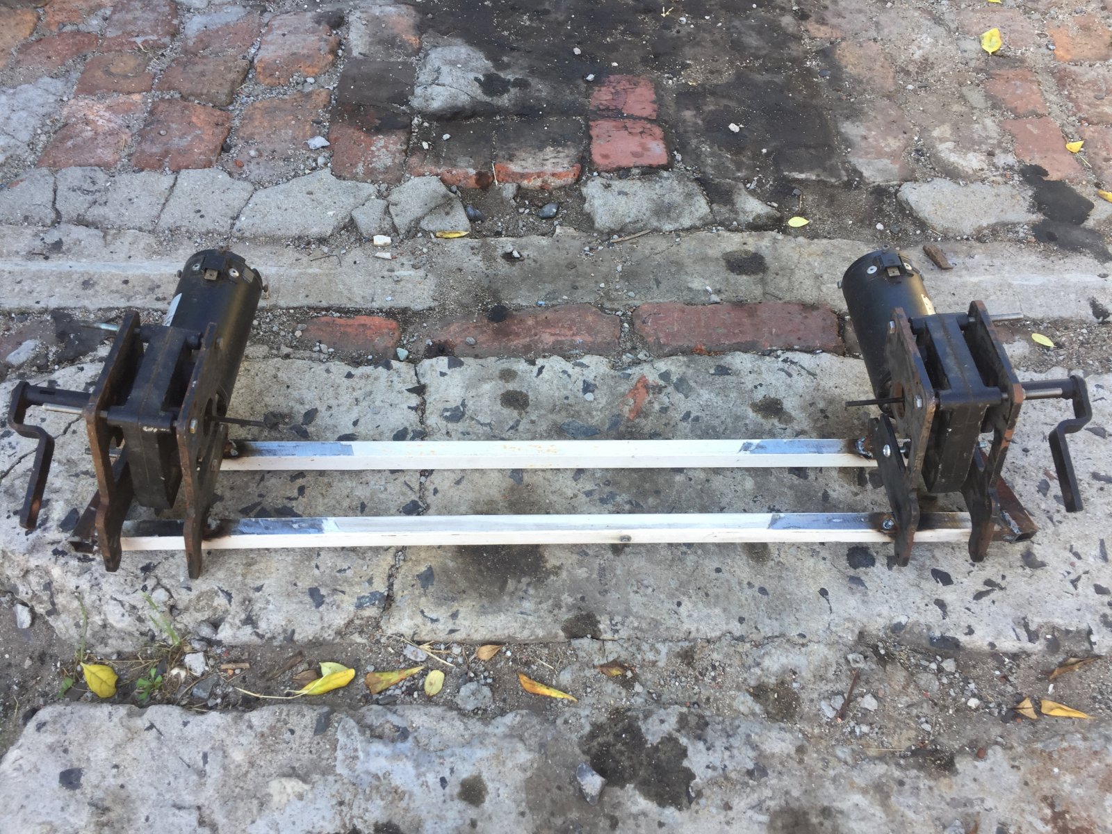

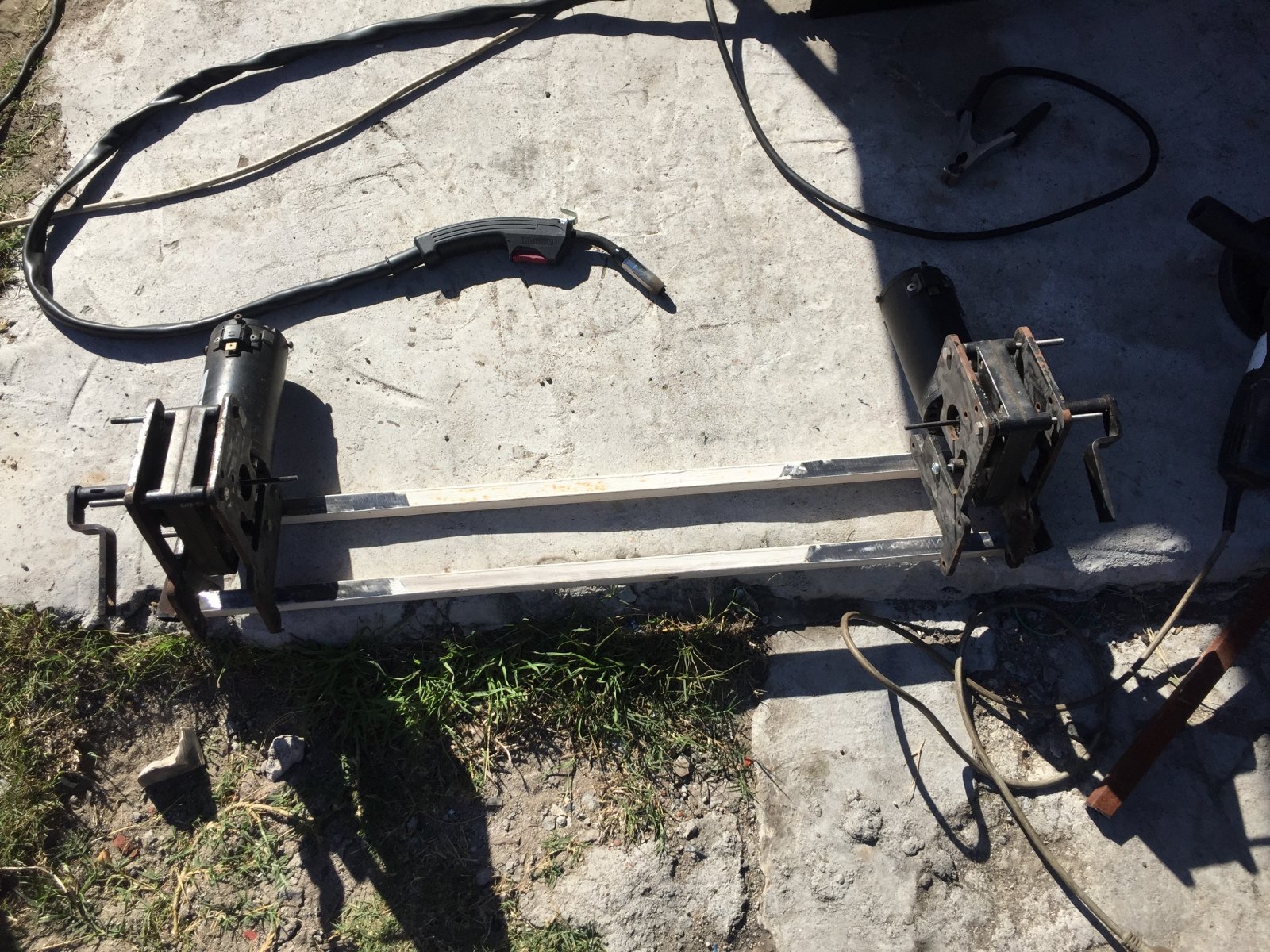

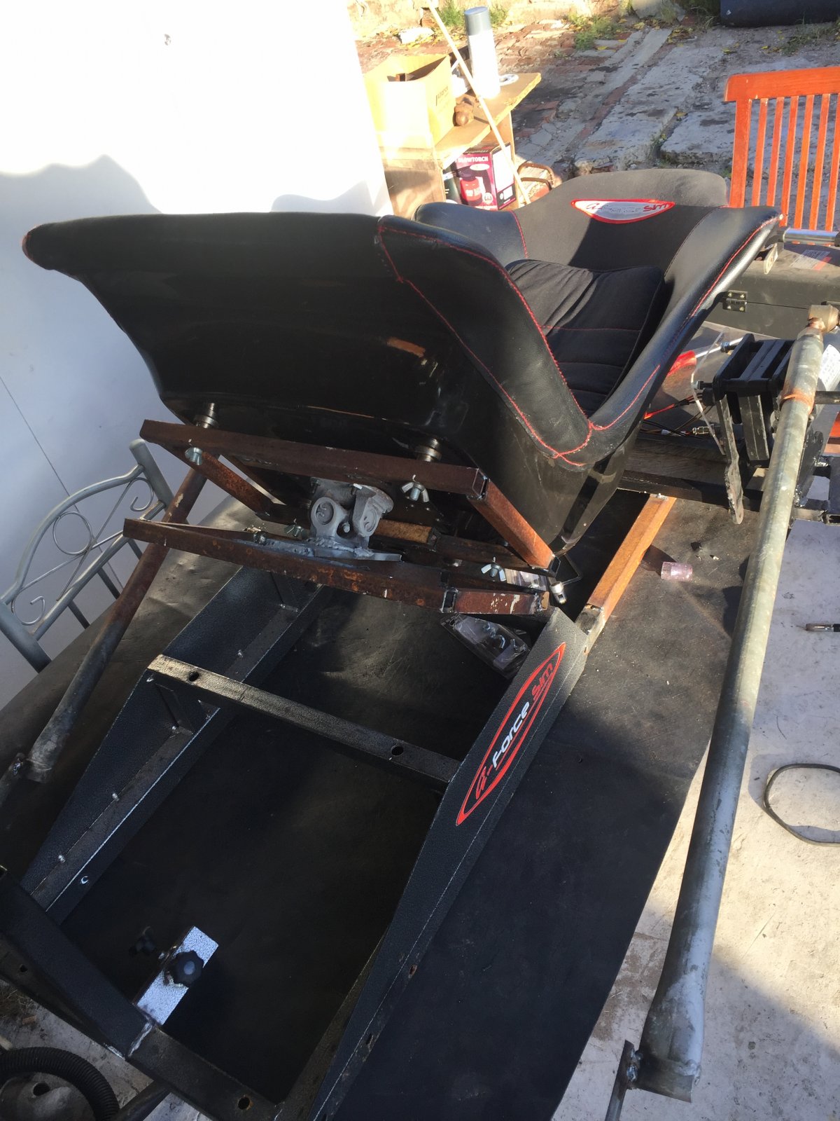

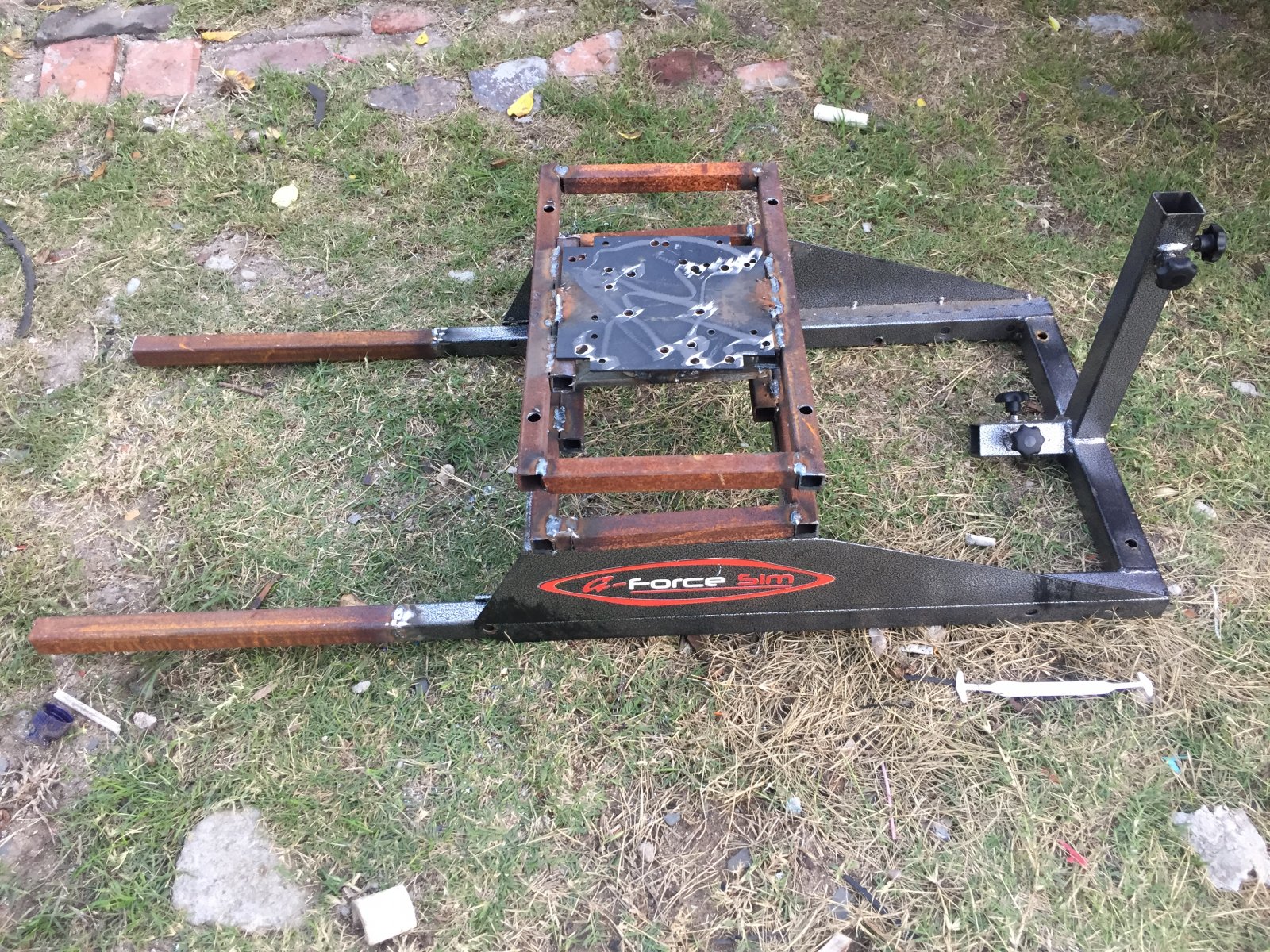

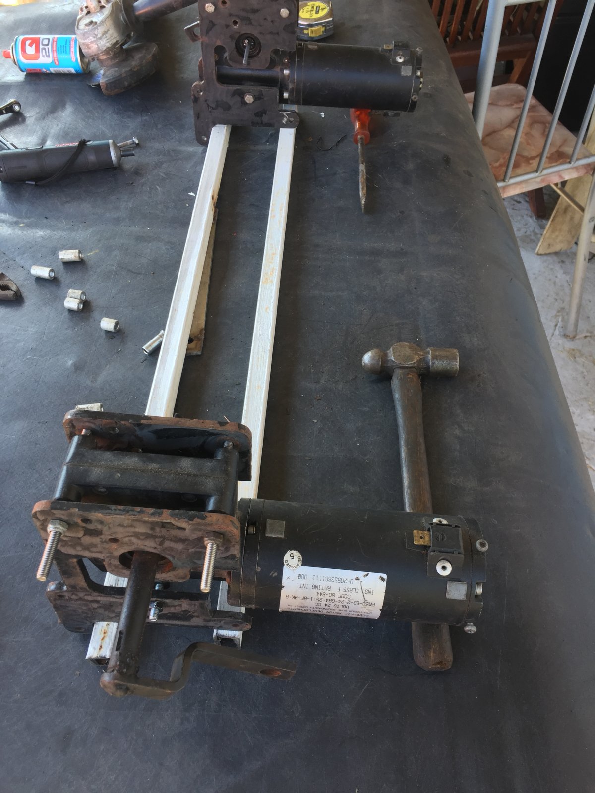

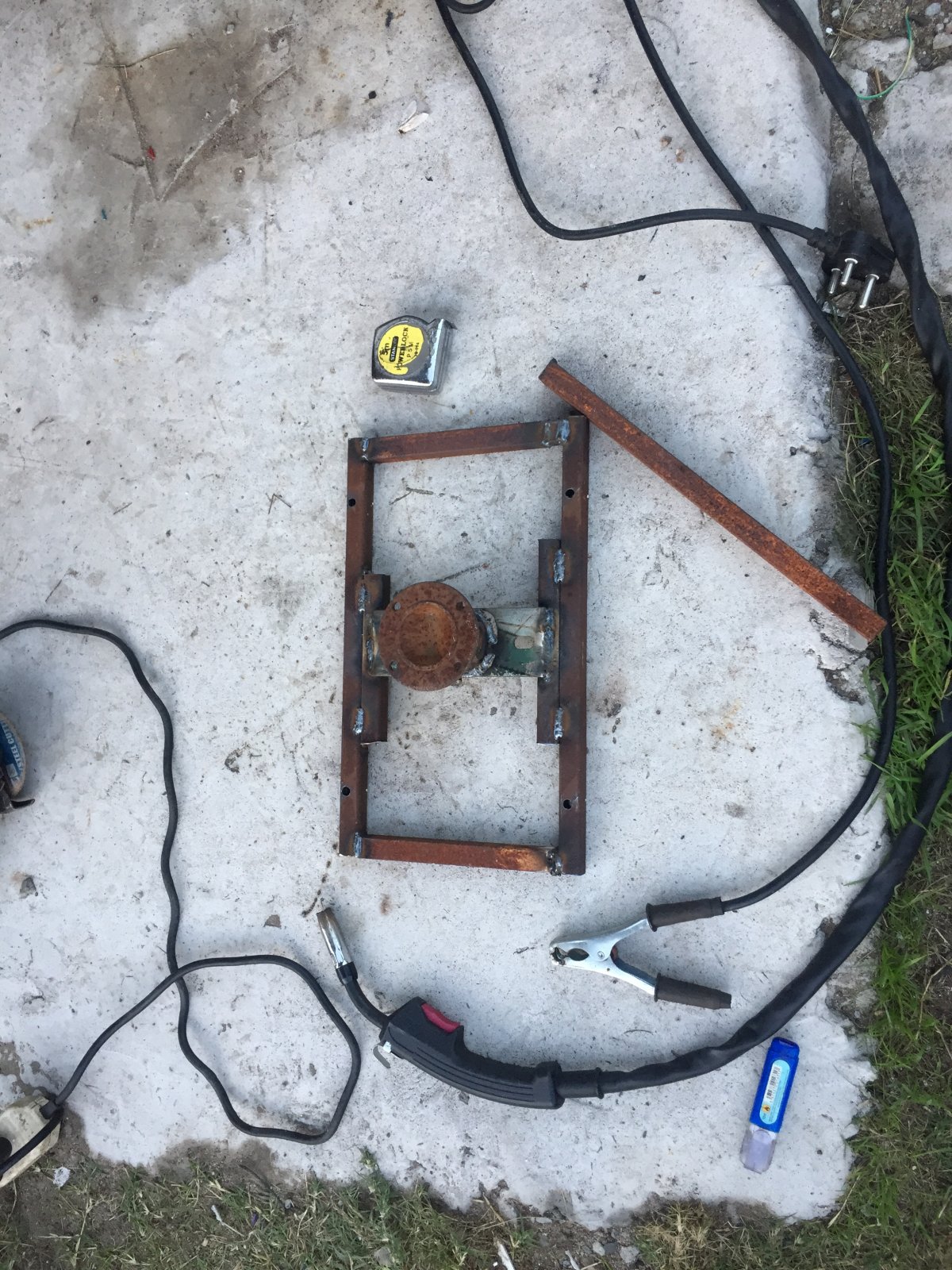

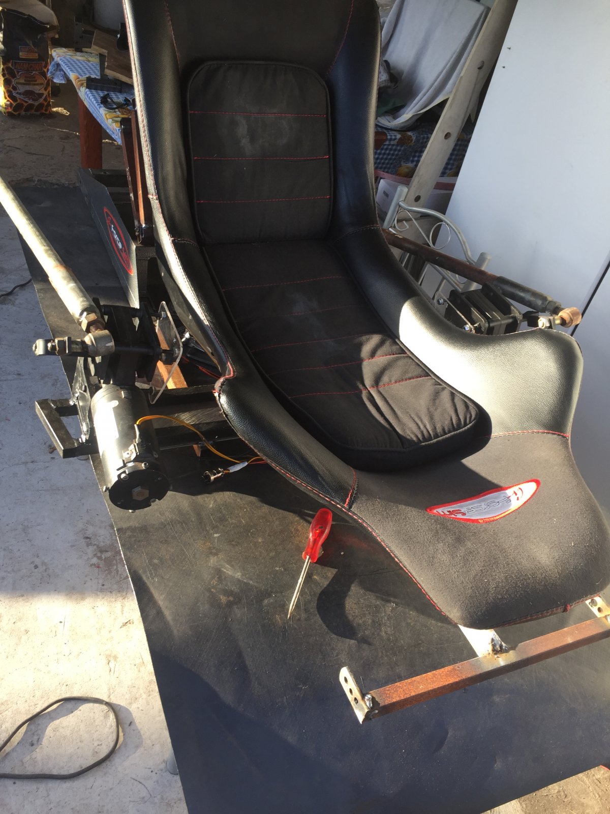

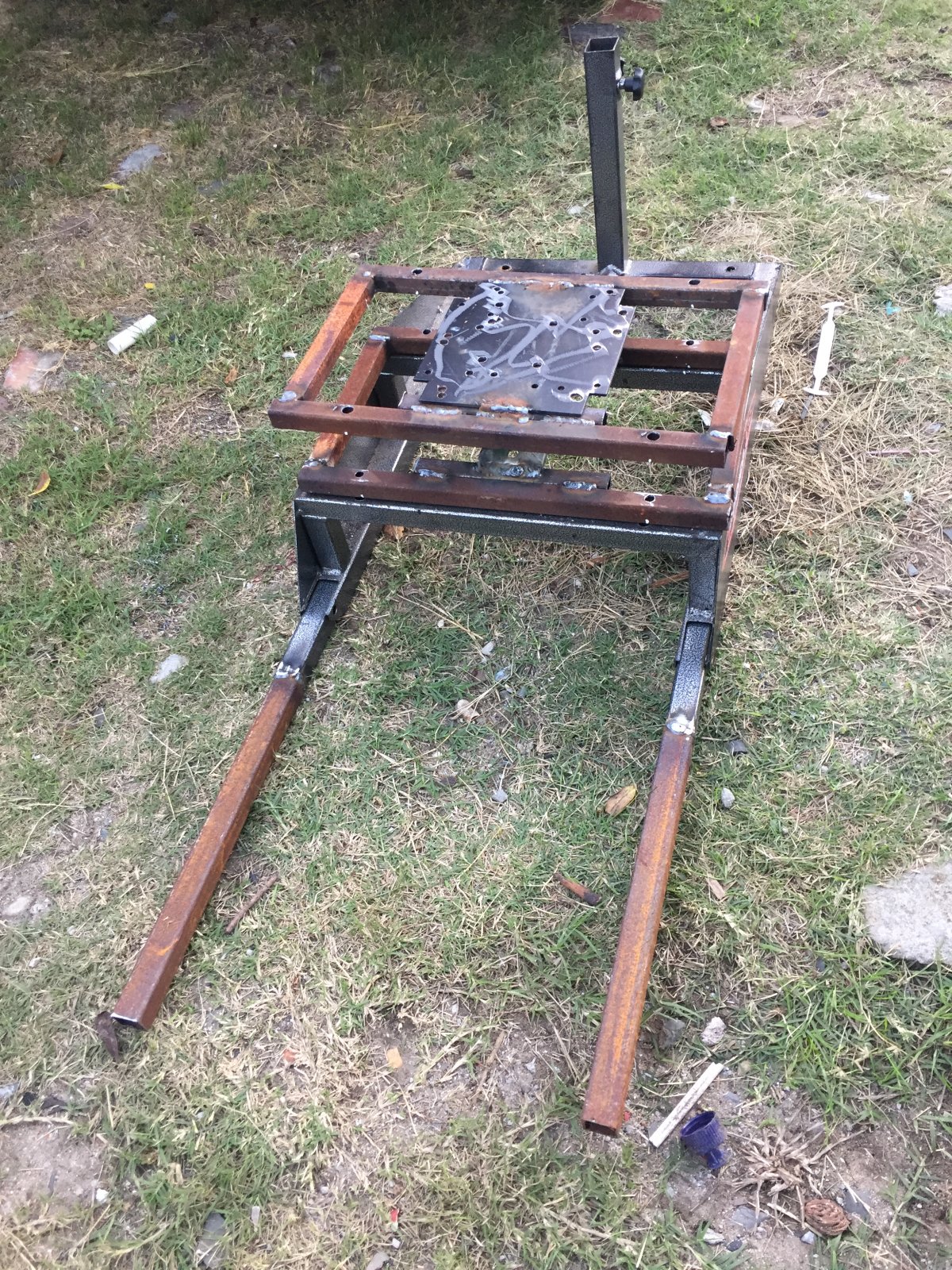

    Welding Works, making sure there a 10Deg angle on the gearbox's

    Wiring up the control box, salvaging Desktop PSU 6pin connectors

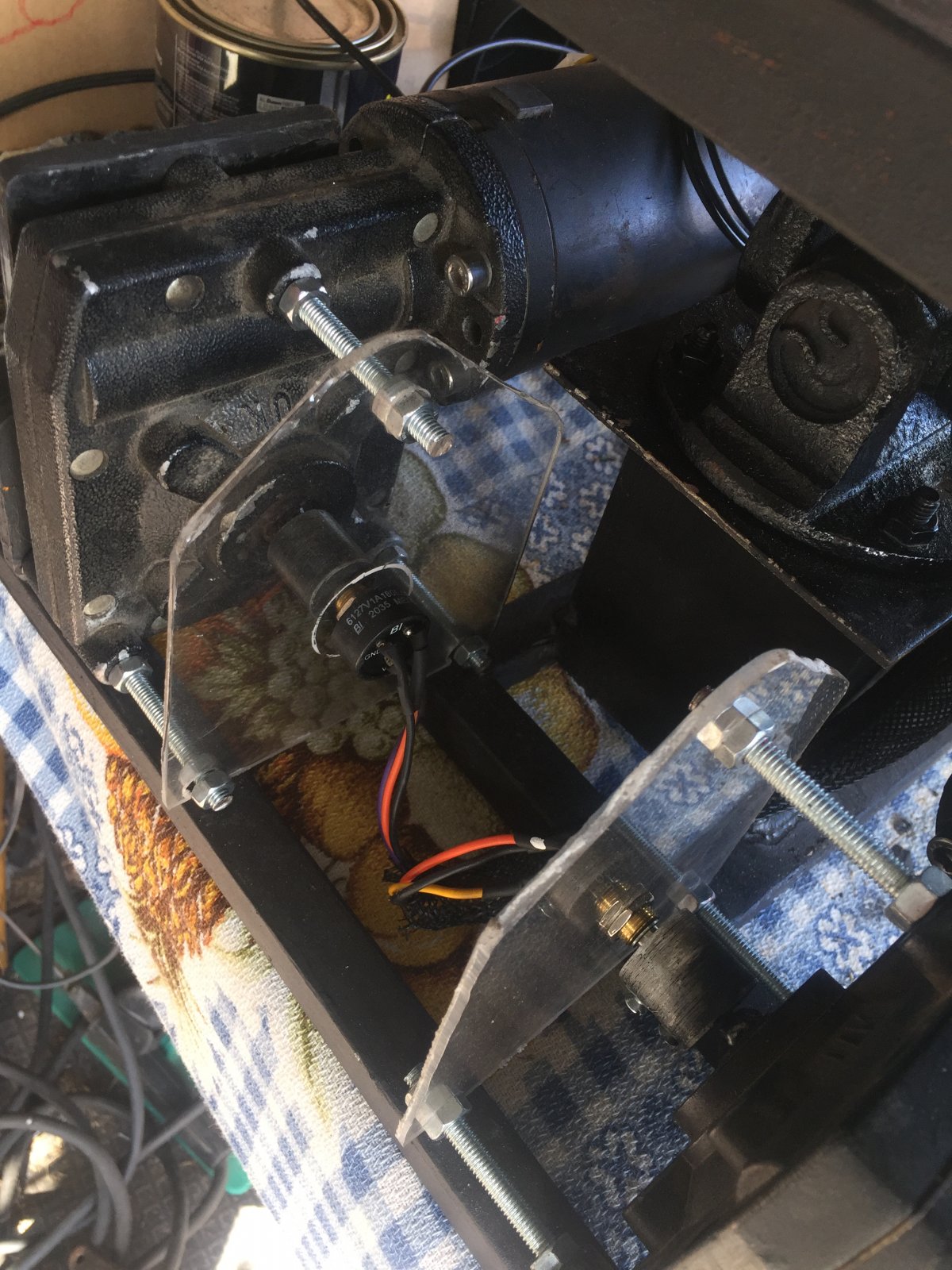

    Mounting the Encoder's

    2 x 500W PSU using the PCI Express to supply the power to each BTS Driver.

    5B312174-85DE-4632-83BA-2B79247B9084.jpeg AC1506C9-54B0-4853-A151-BAA1C977CE2F.jpeg 96B752C7-1239-4E32-AC9C-09CAE8AF6972.jpeg AC23E626-0487-4ACC-9823-EF1E5774A541.jpeg

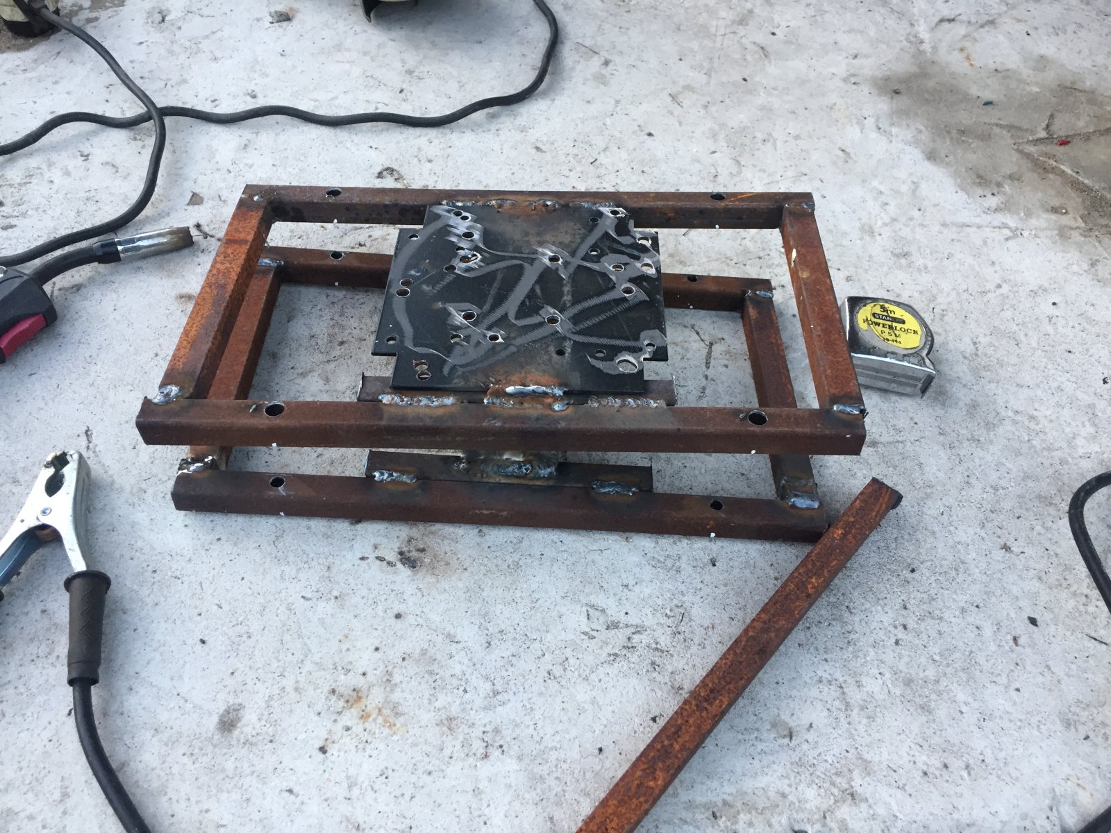

    Base mount for the static frame

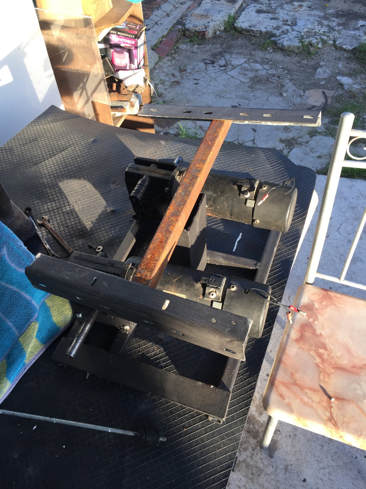

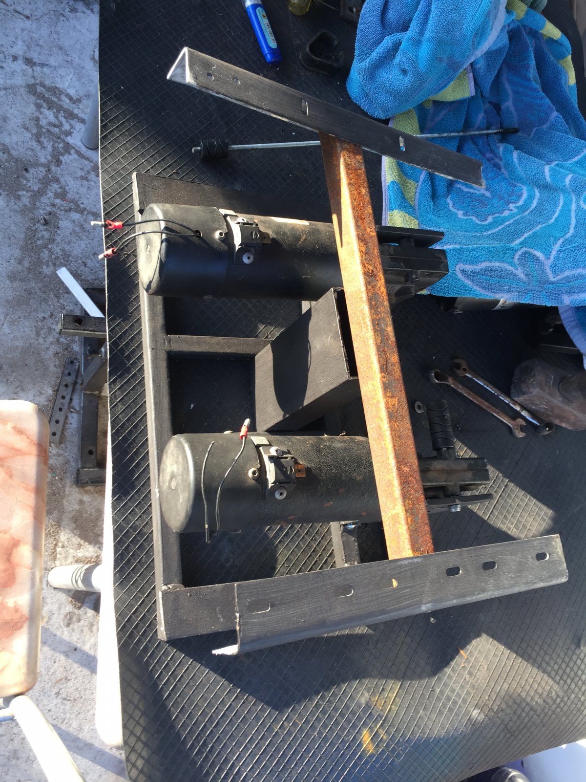

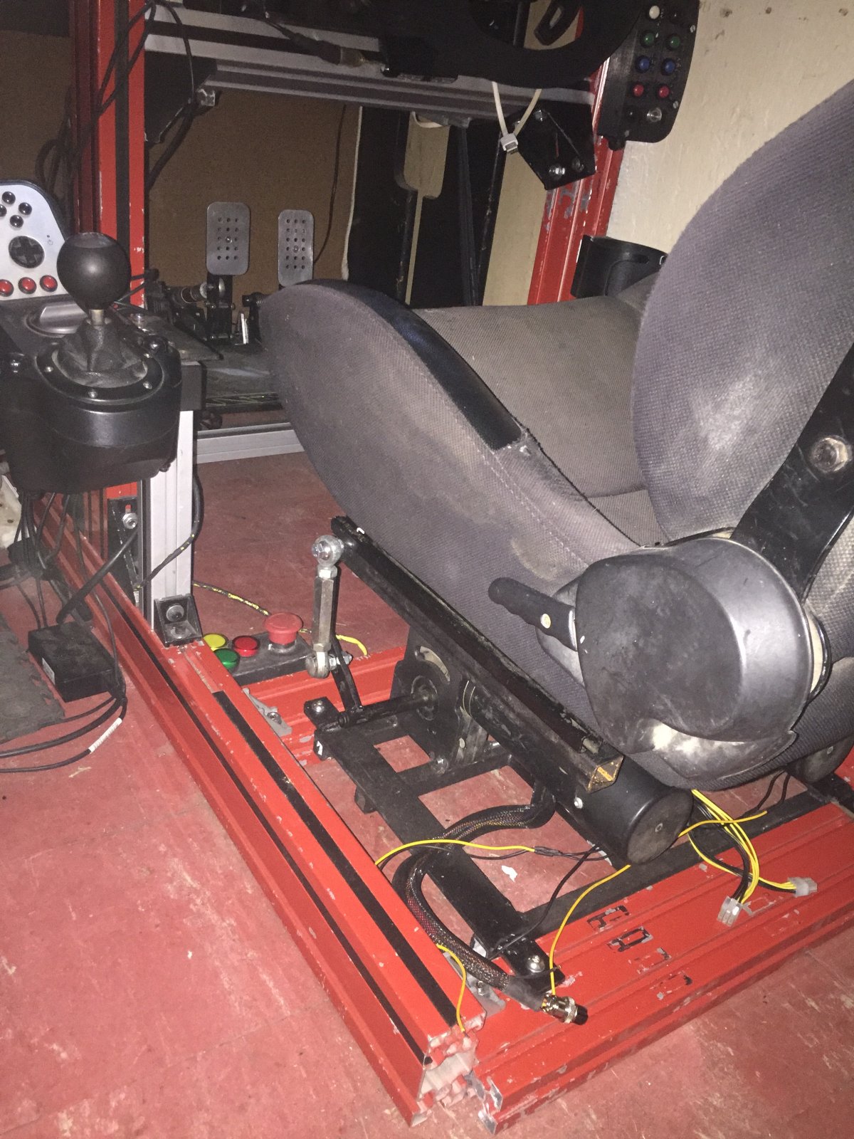

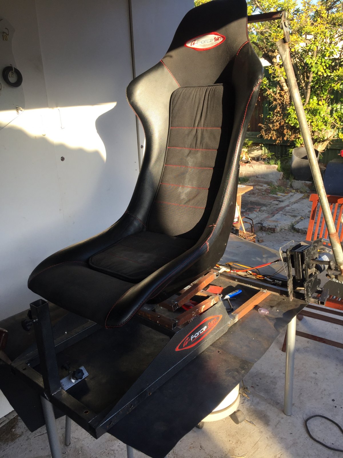

    79E6832D-973F-437D-9DC0-DCDC8E6A6D42.jpeg 0809C521-2389-4292-A475-560664907398.jpeg Got another set of wheel motors, currently building under the seat mover for my personal rig.

    Fitted the encoders ‍

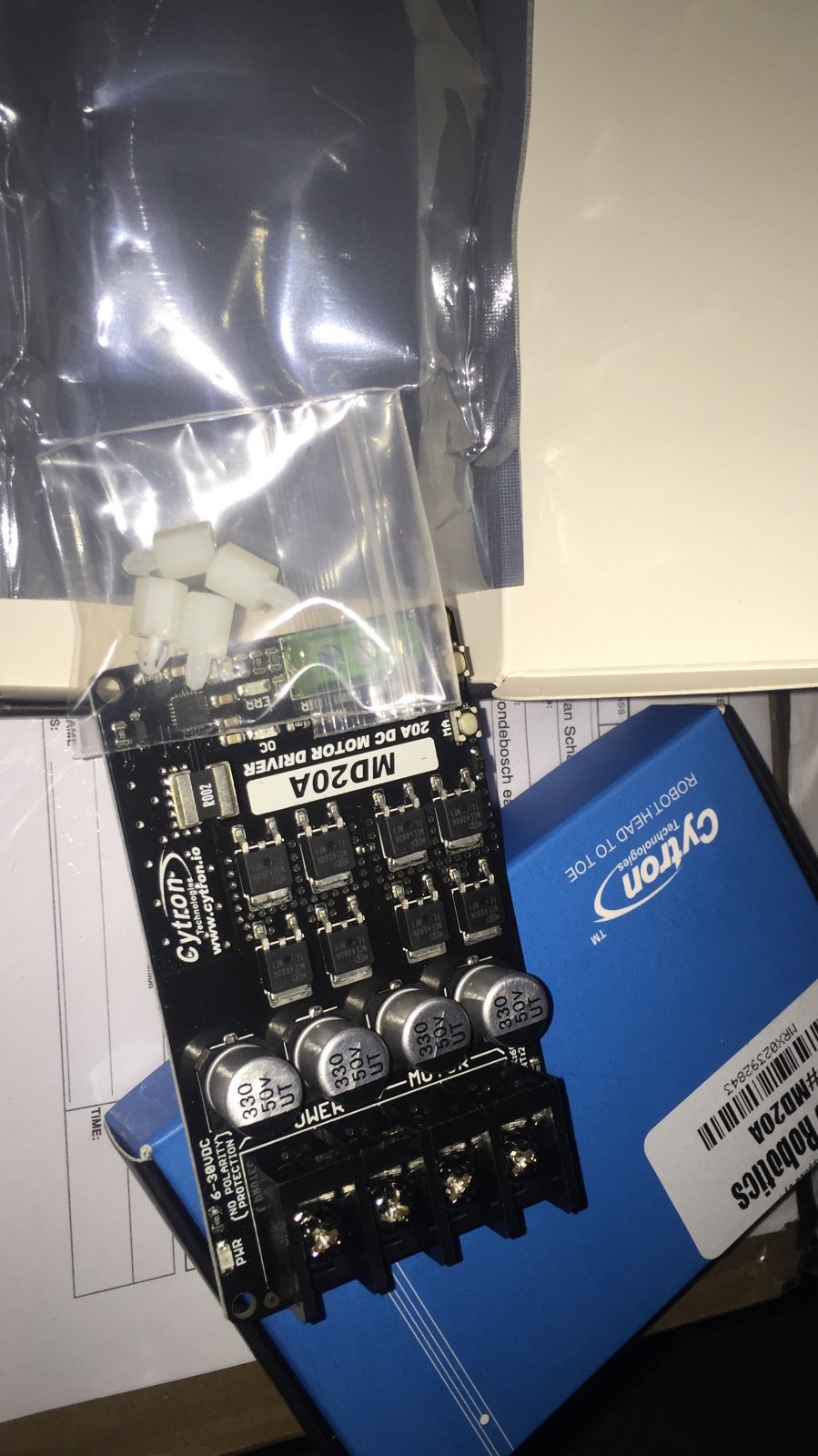

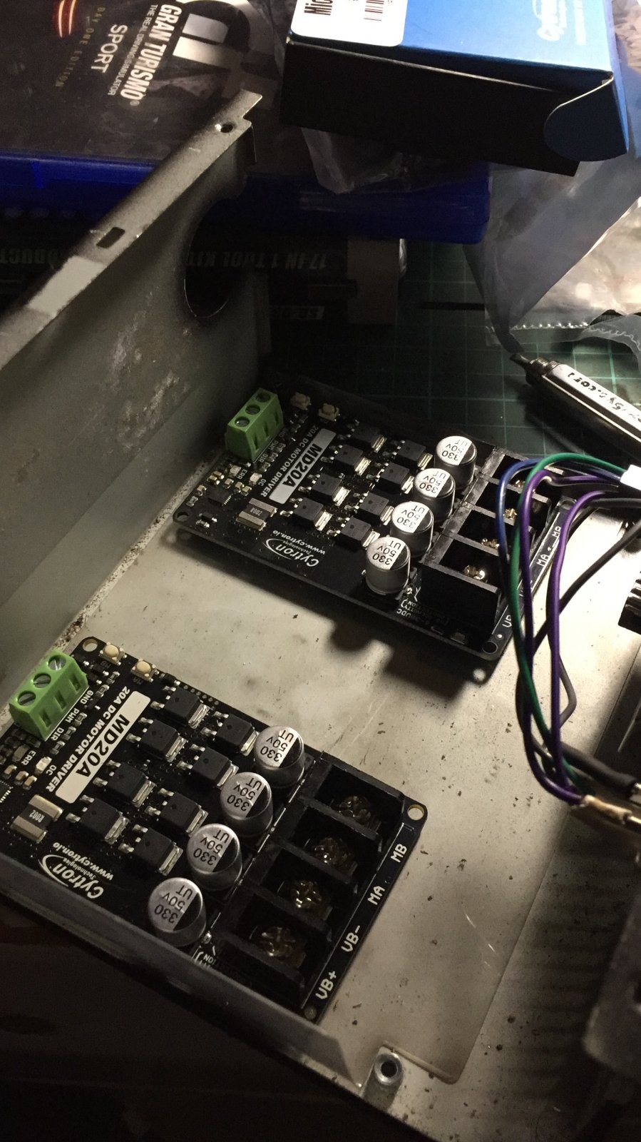

    With current motor positioning the BTS driver arent the best, popped two so far so i ordered 2 Cytron MD20A drivers that should be sufficient for the these motors having Spec 60Amps Peak with 20Amps continues

    I was lucky to a company locally that had a set in stock, saving me import times. Super ampt 657B9F3E-8471-448B-8948-9C987ADA7BEE.jpeg

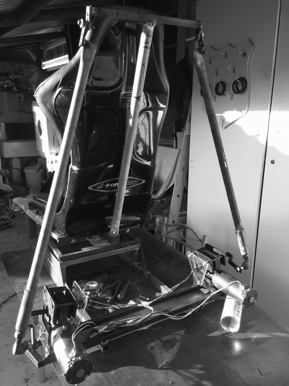

    Upgrade been done so far, is replace psu with 24v 25A, motor controllers Cytron MD20A but kept everything else the same.
