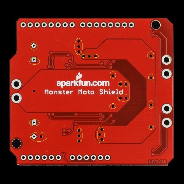

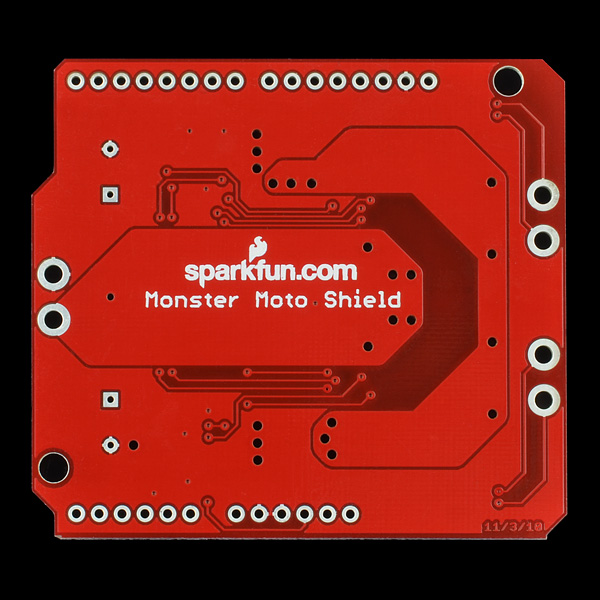

    In doing the research to see if there was any benefit to cooling the JRKs from below (there is), I read the data sheet for the VNH2SP30 H-bridge that the JRK and Monstor Moto both use.
    (http://www.st.com/content/ccc/resou...df/jcr:content/translations/en.CD00043711.pdf)
    In there they discuss the thermal pads on the bottoms of the chip that are designed to remove the lion's share of the heat developed in the chips.

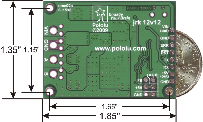

    I'm not in any way knocking the MM's but if you compare the circuit boards used in those with the JRK's you can see the Polulu takes full advantage of the thermal pads and vias the heat out to the bottom of the circuit board. The MM's do not.
    Cooling the VNH2SP30 through the plastic overmold with a heat sink and fan certainly helps, but the MM's probably need to have more care and attention paid to setting them up than the JRK's do even though their board area is probably greater (see the section on power dissipation vs. board area in the VNH2SP30 data sheet).
    Edit - @OZHEAT pointed out that MM's do indeed have thermal vias though not directly under the pads. They would be better if under the pads and filled with solder but better than not having them.

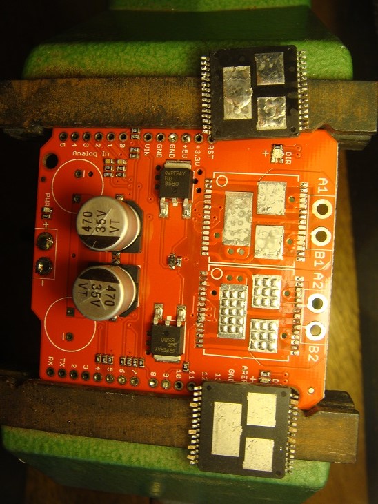

    @Zed
    Is this what you are looking for?
    MMS chips not attached.jpg SeatTime had a pic of a desoldered board.
  6. Zed
    Apr 4, 2017
    1,040
    USA
    5,845Coins
    +1,043 / 4 / -0
    @OZHEAT - yep, that is it exactly! Thanks! I had not seen those. So the MM's do have vias. Still not as many as the JRK's and not directly under the bridge pads, but they are indeed there. I'll correct my posts.

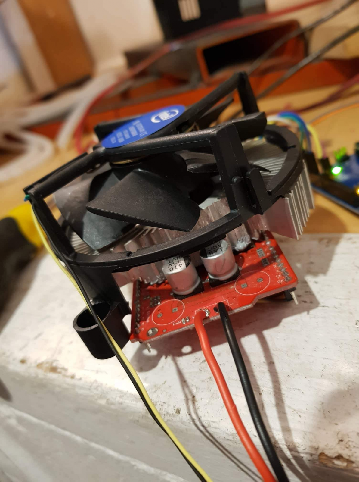

    If you give the clones enough cooling - they seem to last ok. I've hacked an old intel CPU cooling fan. Keeps them nice and cool.
