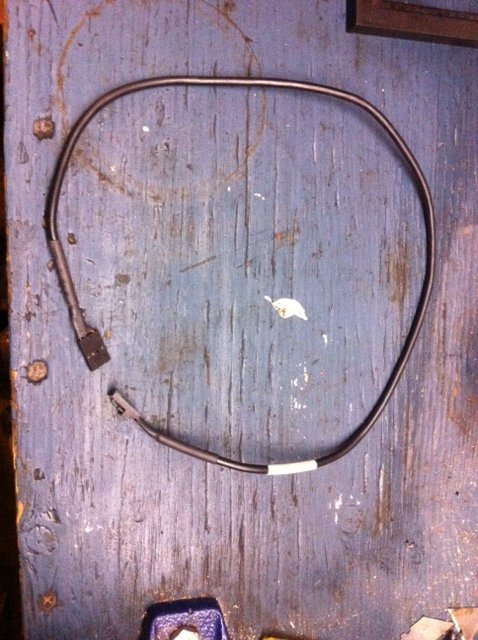

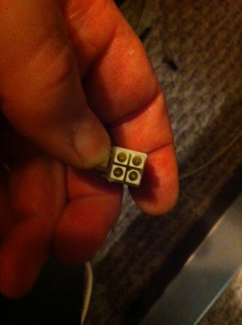

    Looking through my drawer of misc cables I happened upon a CD-ROM audio cable. I had a couple of these leftover from builds years ago.
    I realized the connectors on each end were female and about the right size to fit over the cable pins. First I cut the cable in half. This would give me 2 cables for 2 actuators (axis).

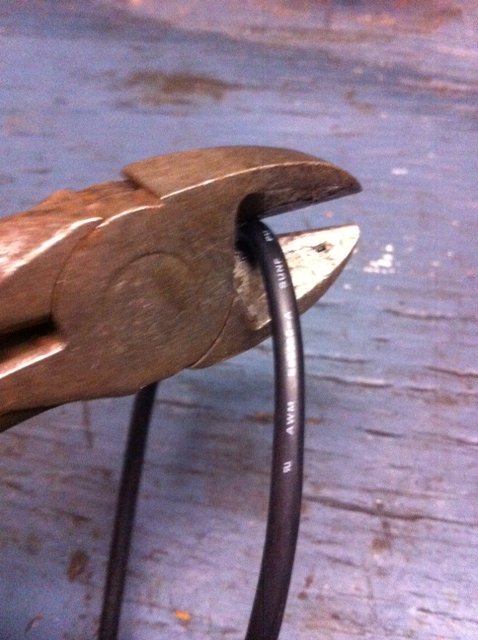

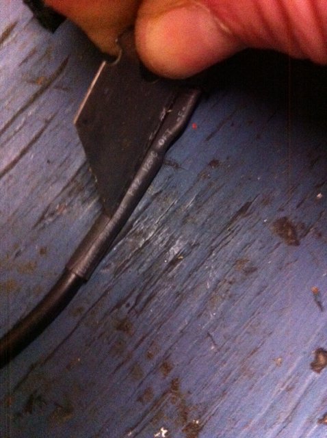

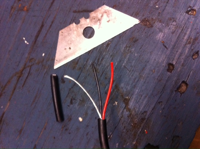

    I would then need to strip off the old shrink wrap. Some cables might not need this step.

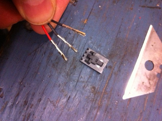

    On the 'cut end' of each cable, remove about an inch of the outer insulation to expose the wires inside.
    Trim about 1/3 of an inch off the RED and BLACK wires. The GND cable is bare and doesn't require trimming.

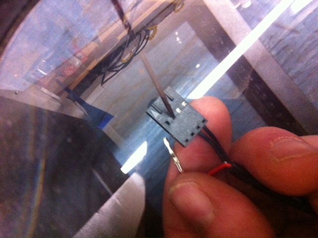

    Next it's time to remove the female connectors from the plastic plug. I used a magnifying glass and a darning needle to push the tabs in on each connector. After doing this for each wire they slide right out of the plastic plug.
    NOTE: Some gentle pressure is required however don't pull too hard. If you have to it means the release tab isn't pressed enough. Pulling hard on the cable could damage it. Try pressing the tab down again while pulling gently.

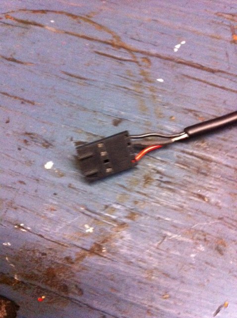

    You will end up with 2 cables like this.

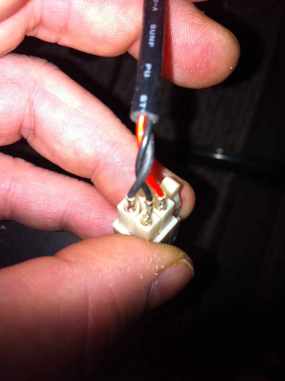

    Next attach the wires to the pins on the actuator cable by gently pressing the female connectors over each corresponding pin. They should fit snugly. If one feels too loose you can always GENTLY crimp the female end a little and try again until it feels snug. Do not over-crimp as you won't be able to get the female connector over the pin making the whole cable useless!
    You should end up with this:
    To make this connection even more secure you could try a dab of hot glue and some shrink tubing or tape.

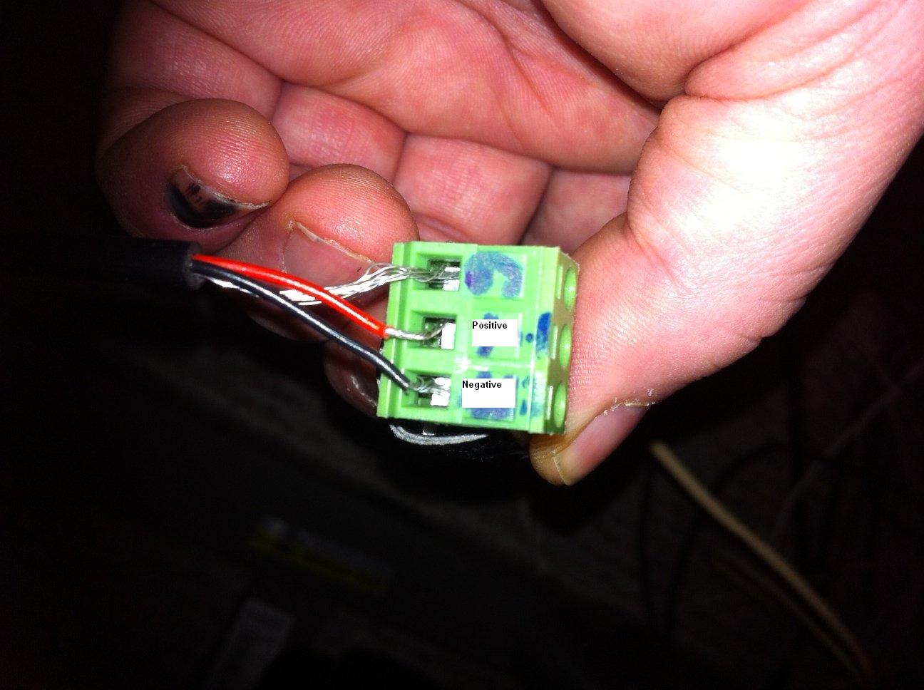

    Next wire the other end of the cable to the rs485 adapter. Most of these adapters have screw down terminals making the connections very secure.
    Connect the rs485 adapter to your PC with a USB cable and you're done. You've wired an actuator with something you just had lying around :) For each actuator (axis) rinse and repeat.

    FYI......Not sure if it makes any difference in what your doing but it might confuse some. I was taught that red was always positive and in the last pic illustration you have the plug marked for a ground wire, and then you have red to -, and a black to + which is backwards I beleive.

    :grin Lol You are right. I was wondering when someone was going to notice that! Actually, I initially labelled the RS485 module wrong. Red is in fact positive and black negative. The wiring is correct but my labelling is wrong in the pic. The others I did were labelled correctly but of course I took a photo of the mislabelled one :blush
    Hopefully this will clear up any confusion. Of course it doesn't matter what color wire is connected to what, as long as they connected to the same polarity on both ends, but your point is a 'best practice' for sure.

    Lol....I kinda figured it was one or the other.....just thought I would bring it to your attention. Maybe you could just edit the +,- signs on the pic. :)

    I finally got around to editing the pic in question. The polarities show correct now. I'm really glad some folks are finding this useful!
