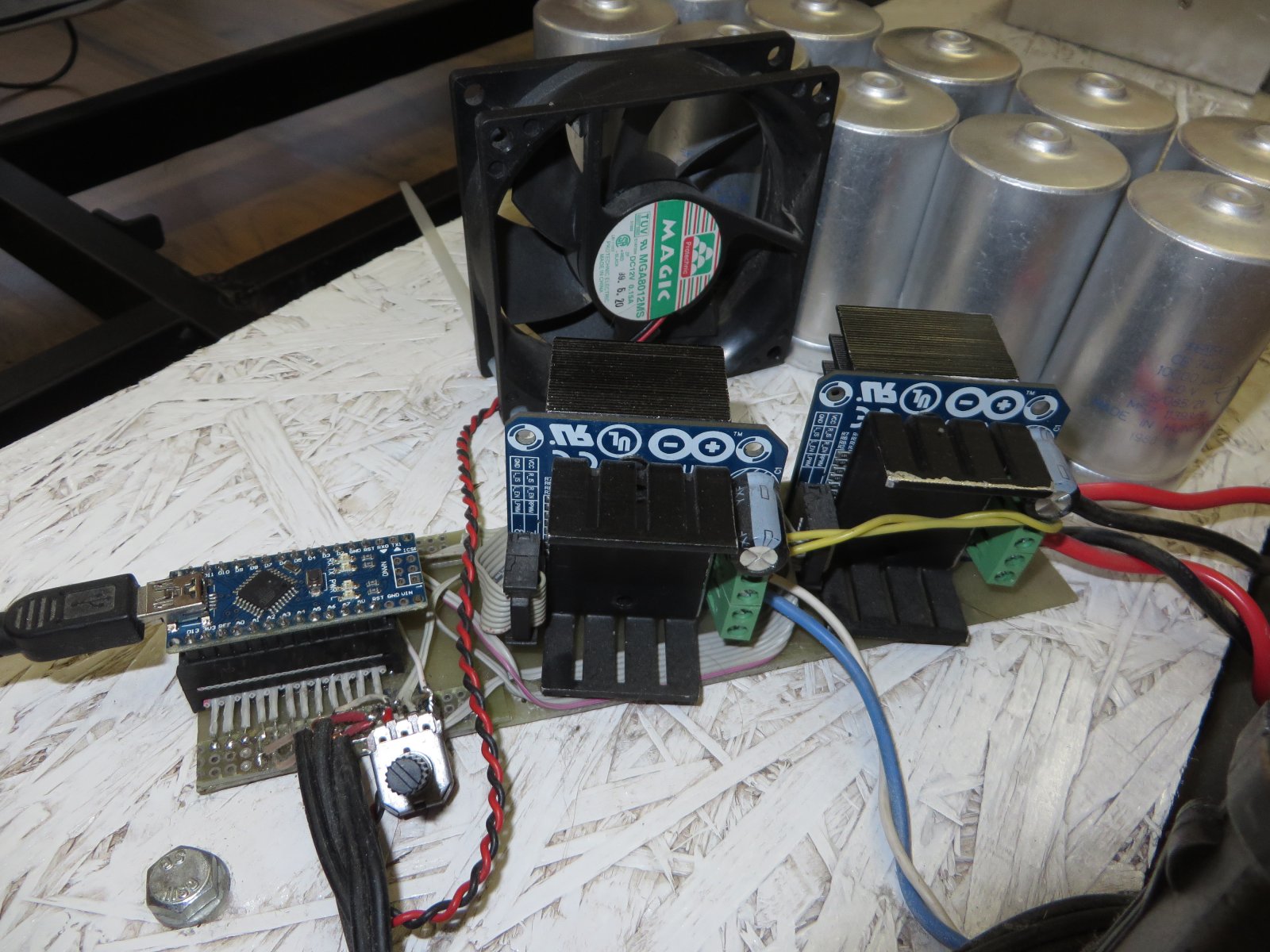

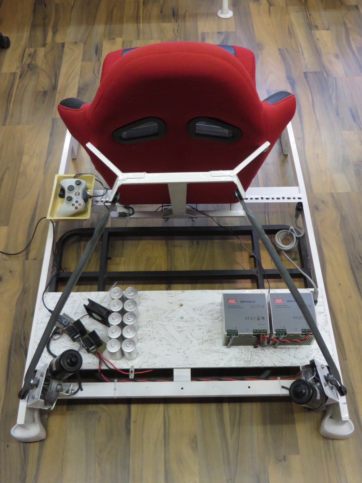

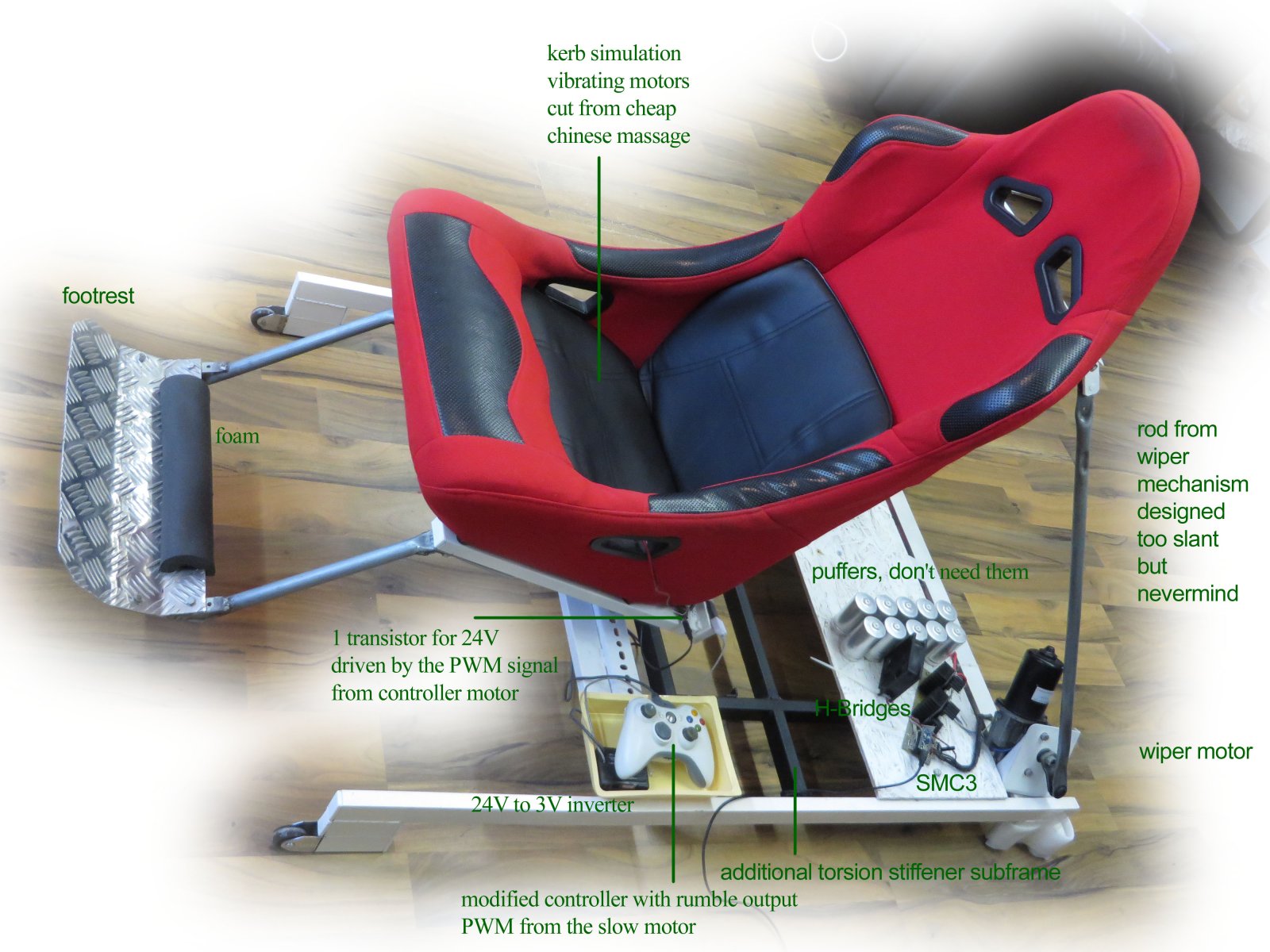

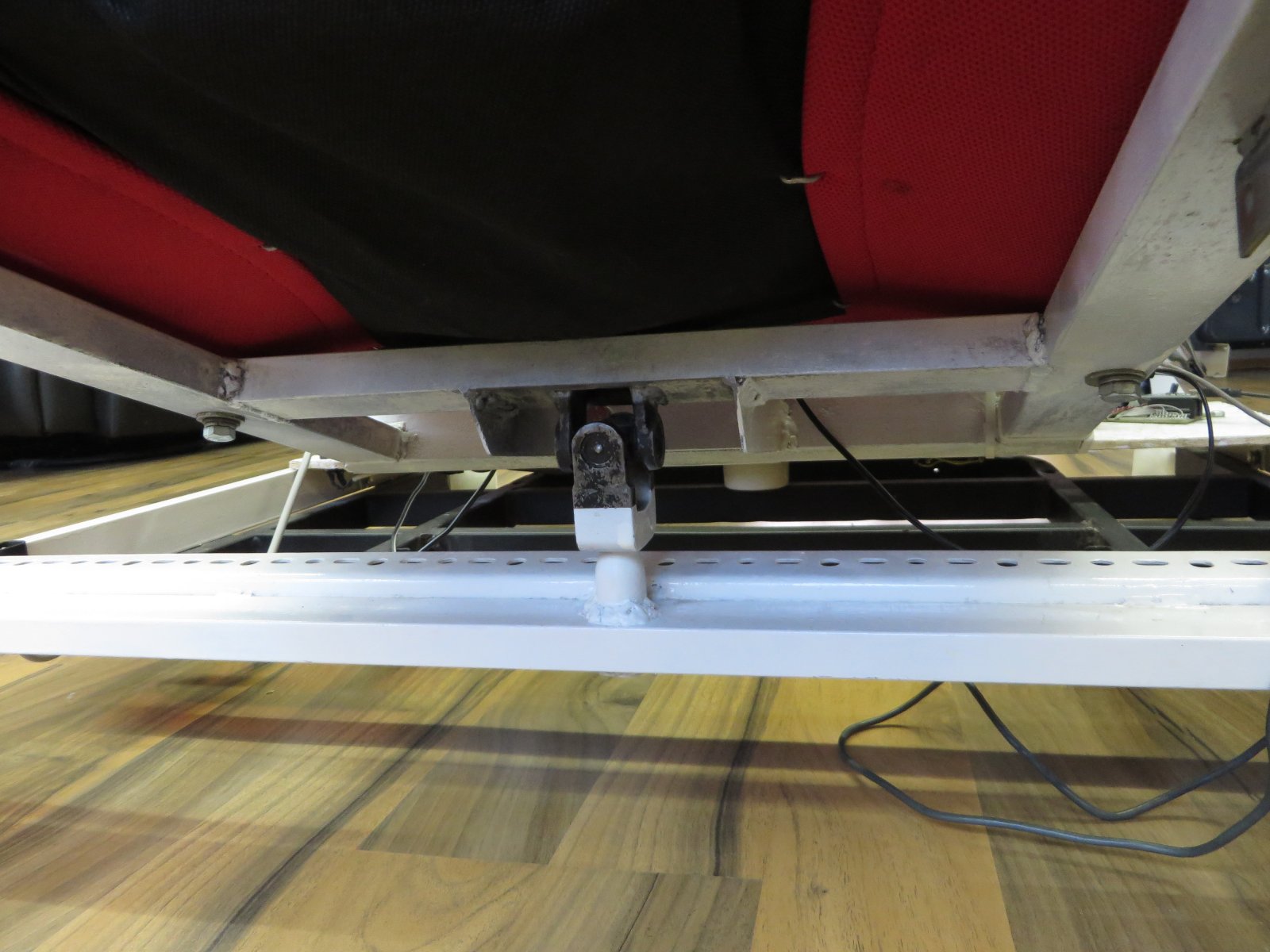

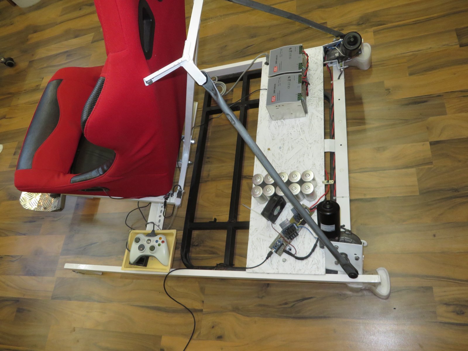

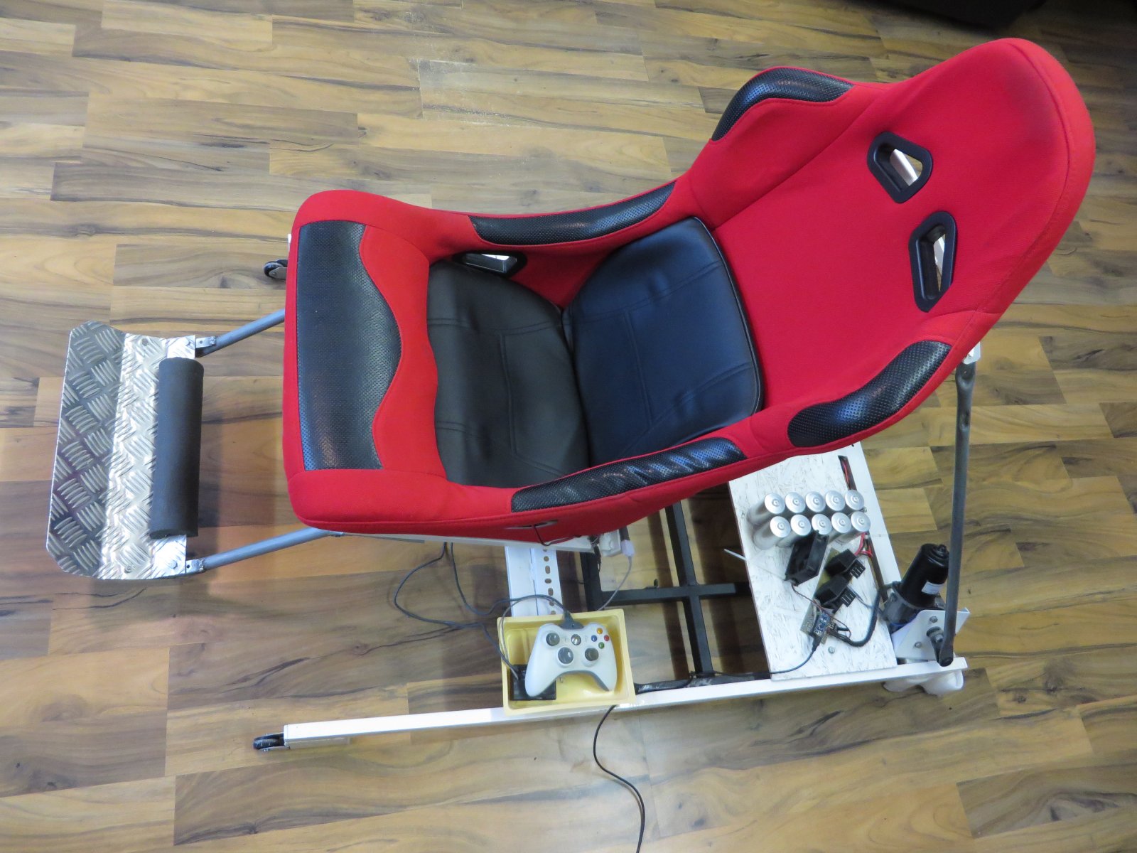

    A different approach from the mainstream, my preference is moving the whole frame, not resting my feet [on the pedals] on the ground. For simplicity, i use a controller.
    Kerb simulation is done by vibrating motors, from the rumble signal.
    24V 20A power
    43A chinese H-Bridges
    Arduino nano with SMC3
    wiper motors and rods from old Citroen
    XBOX360 controller, modified
    racing seat
    leg pieces of chinese massage cushions

    I did not make any.
    It does it's job as the other ones, but there is no wheel and pedals, that would be too heavy to move, and i want the whole frame moving.
    The rig in the pictures is in the "parking" position, where the seat is in the highest position, easy to move around with the help of the "front wheels".
    The H-Bridges got additional heatsinks, glued to them.
