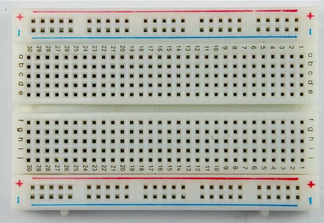

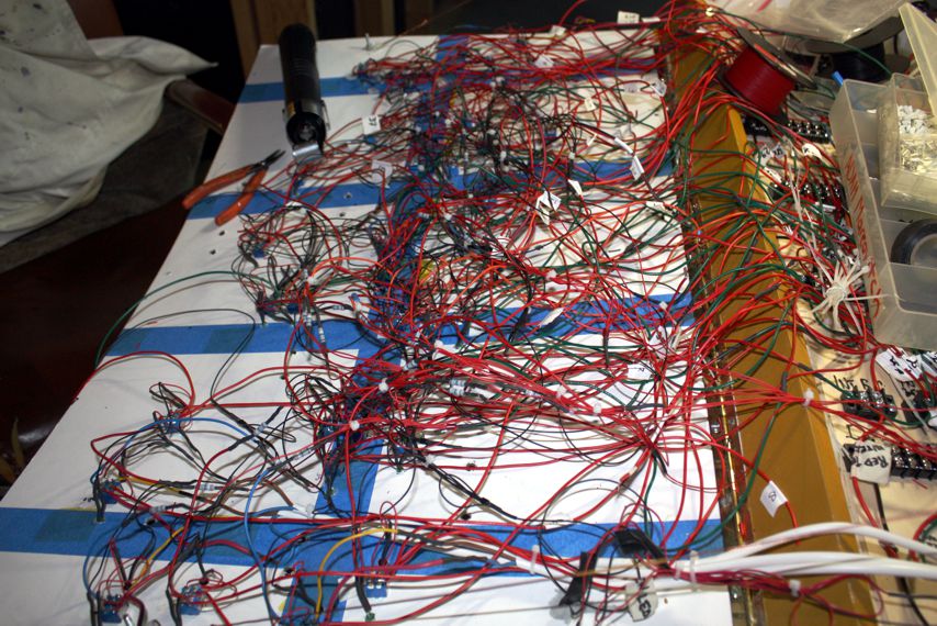

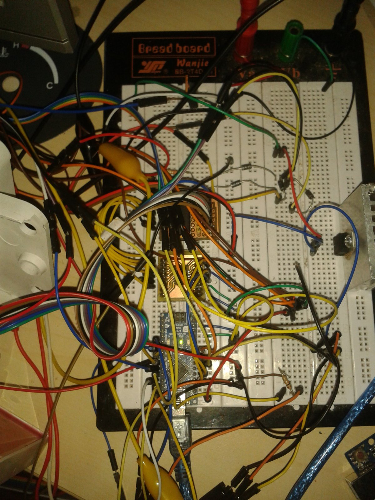

    If YOU think, you have all under control, in this case you can miss this thread. If your wiring looks like the picture below:

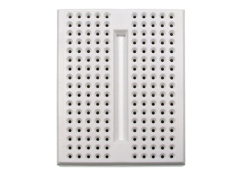

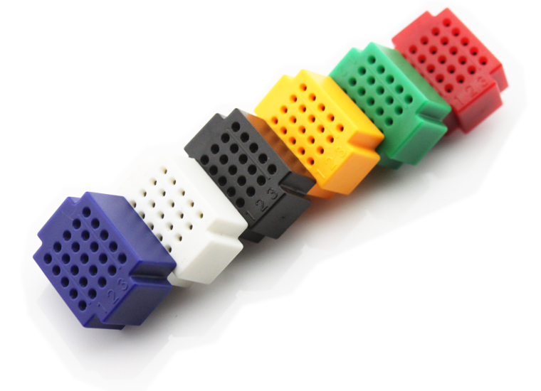

    you should have this:
    or this:
    or this:
    If YOU do not know, what it is - it is called a
    BREADBOARD
    http://en.wikipedia.org/wiki/Breadboard
    Happy building!

    OCD, OCD OCD!!!!!
    (obsessive compulsive disorder)
    :grin

    What a nice wiring, very clear and so easy to sort :D
    Now, find this short !

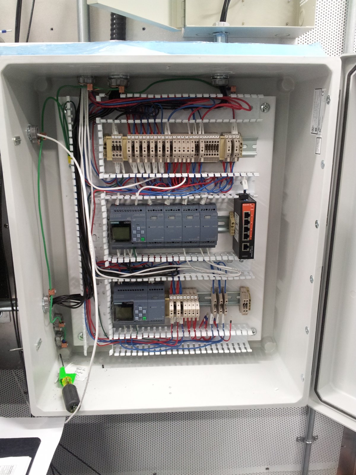

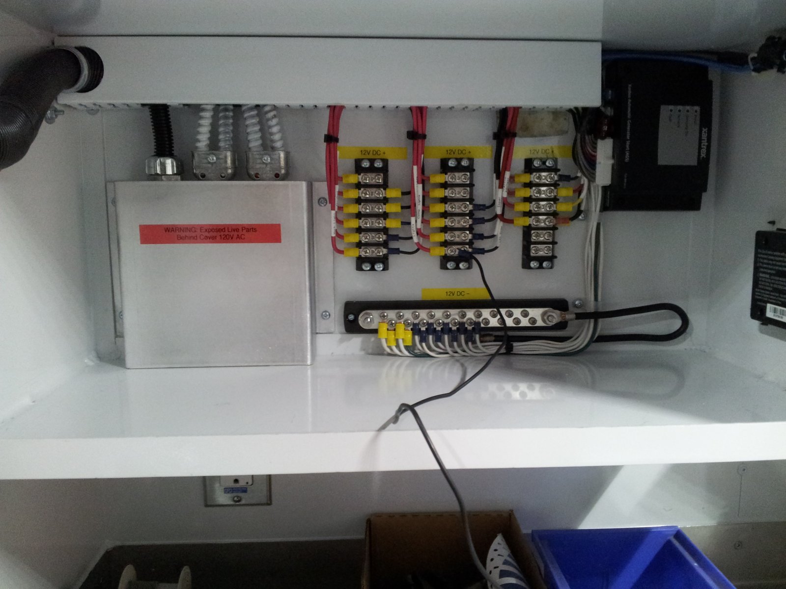

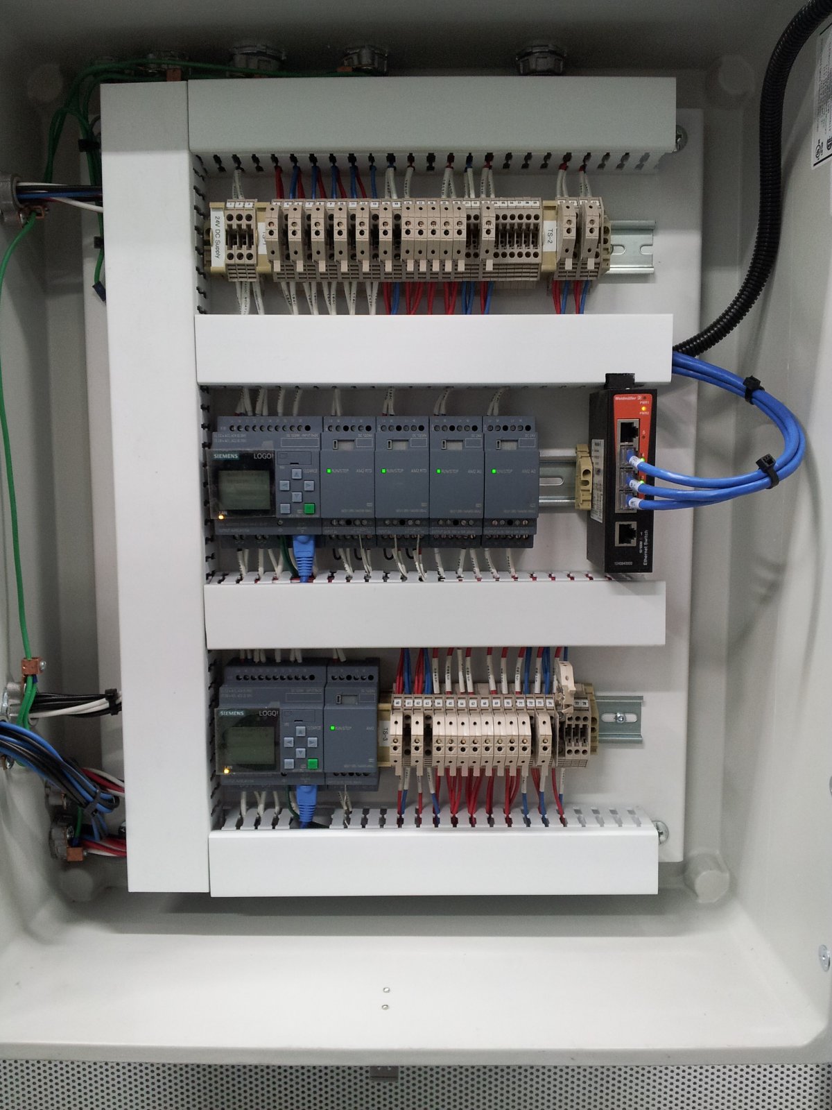

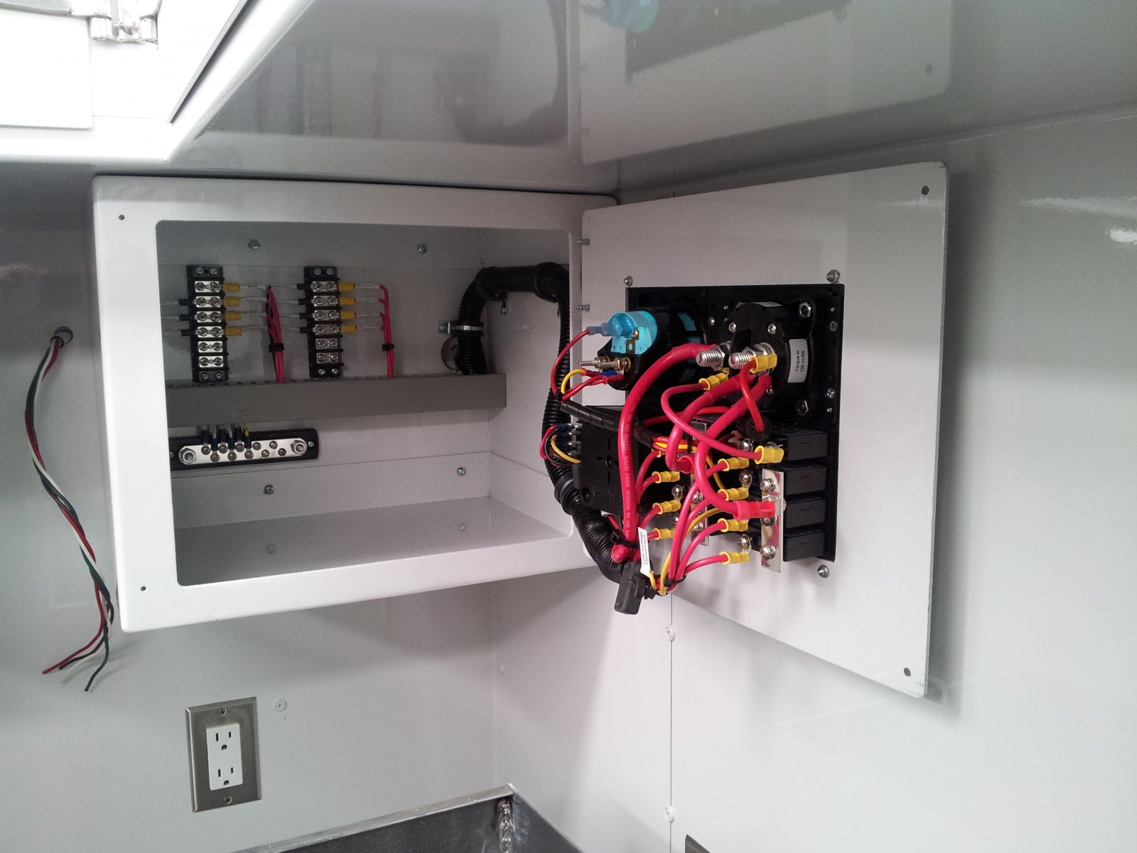

    As a professional Electrician, I've become a big fan of a product we call wire ducting. It's available in a wide variety of colors and sizes to suit the job at hand.
    Most wires can just be routed out the slots already in the sides. For larger wire sizes, the "tabs" can be snapped off quite easily if you flex them to the outside. I usually leave a little bit of extra wire in a zig-zag shape inside the ducting, so if you want to move a wire to a different terminal later on, you don't have to extend or shorten it.
    Here are a couple examples of panels I've done with wire ducting:
    PLCs in a control cabinet.
    12V & 120V Marine style breaker panel interconnects

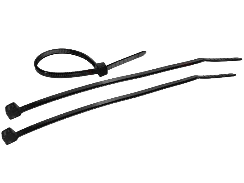

    Neat, cheap, effective.
    Self adhesive sticky tie bases and cable ties.

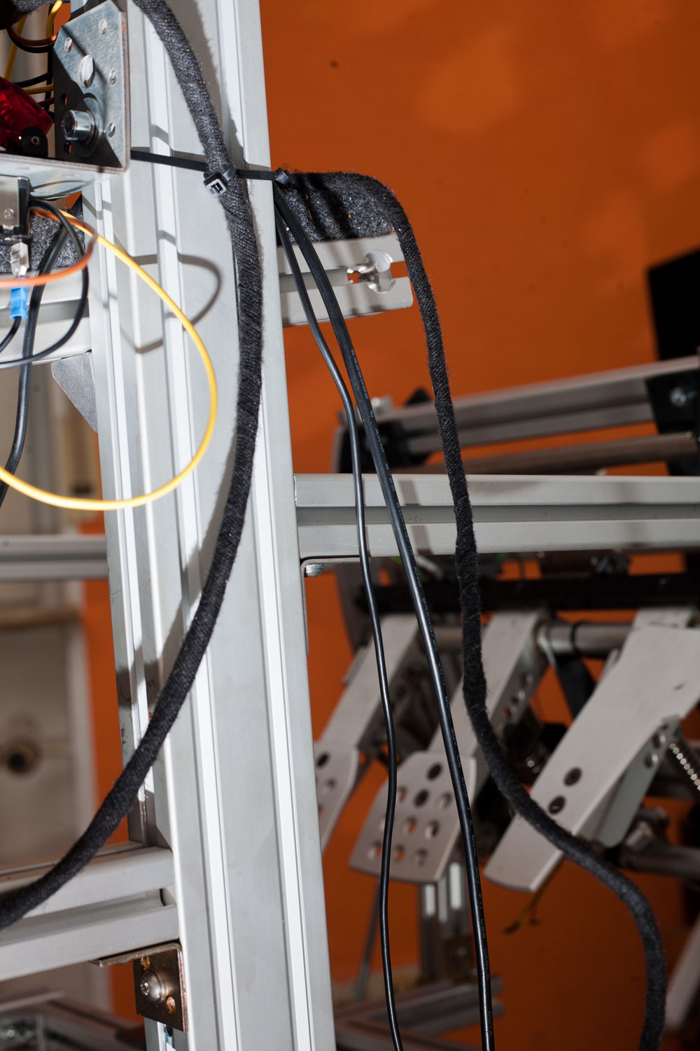

    For my finished cables I always use this
    I don't know the name. But it's wrapped around cables in automobiles and it gives a very good look.
    Here is a picture of two cables I made with this. (make shure to inlarge so you can zoom in ;))
    For me the Breadboard didn't help to reduce the wiremess :p

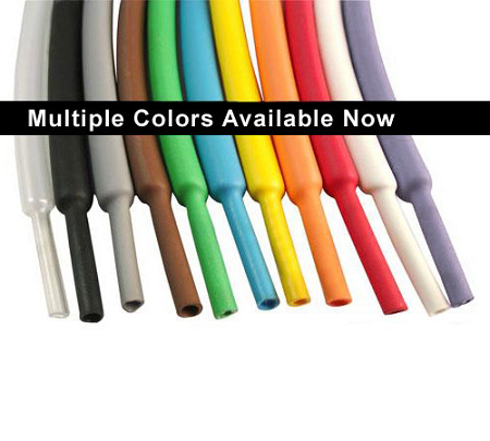

    To isolate you can also use Heat Shrink tubing:
