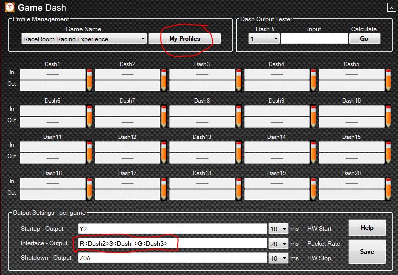

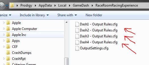

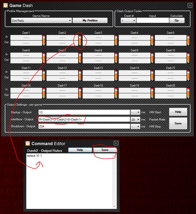

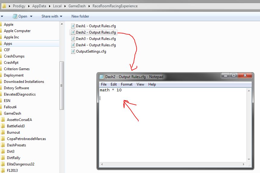

  10. prodigy
    prodigy Burning revs
    Oct 27, 2013
    459
    Croatia
    6,698Coins
    +399 / 4 / -0
    @zigzag49
    Check my post on previous page, what to do for different games:
    CarDashX : TM1638 sketch for GameDash
    For Dirt Rally, you need to multiply Speed value with 3.6, you can do that by pressing Button 3 on the dashboard. You also need to change some Output code, because RPM and Gear is on different dash. See my Interface-Output line.
    For RaceRoom, I had the same problem with speed and because I used another Arduino code, some settings (TOHEX, PAD 4 0) in the Dash1, Dash2.. was still there, even though I deleted them and save the empty boxes. I think this is a bug with GameDash. So the best thing is to open "My Profiles", then open each Dash.cfg file separately with Notepad, delete everything you find inside and save files. Don't change OutputSetting.cfg file, just Dash.cfg files.
    In Dash2 Output file write: Math * 10.
    All other Dash.cfg files should be empty, and don't change OutputSetting.cfg file.
    If your RPM leds are not full, you can reset Max RPM with Button 6 on your dashboard.
