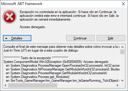

    Hi, can't get work simtools and simvibe at same time in LFS.
    Thanks in advance

    I got this message:

    Sorry, other games work fine:
    Consulte el final de este mensaje para obtener más detalles sobre cómo invocar a la depuración
    Just-In-Time (JIT) en lugar de a este cuadro de diálogo.
    ************** Texto de la excepción **************
    System.ComponentModel.Win32Exception (0x80004005): Acceso denegado
    en System.Diagnostics.ProcessManager.OpenProcess(Int32 processId, Int32 access, Boolean throwIfExited)
    en System.Diagnostics.NtProcessManager.GetModuleInfos(Int32 processId, Boolean firstModuleOnly)
    en System.Diagnostics.ProcessManager.GetModuleInfos(Int32 processId)
    en System.Diagnostics.Process.get_Modules()
    en SimTools_GameManager.frm_GameManager.tmr_IsGameRunning_Tick(Object sender, EventArgs e)
    en System.Windows.Forms.Timer.OnTick(EventArgs e)
    en System.Windows.Forms.Timer.TimerNativeWindow.WndProc(Message& m)
    en System.Windows.Forms.NativeWindow.Callback(IntPtr hWnd, Int32 msg, IntPtr wparam, IntPtr lparam)
    ************** Ensamblados cargados **************
    mscorlib
    Versión del ensamblado: 4.0.0.0
    Versión Win32: 4.7.3163.0 built by: NET472REL1LAST_C
    Código base: file:///C:/Windows/Microsoft.NET/Framework/v4.0.30319/mscorlib.dll
    Versión del ensamblado: 0.2.2.0
    Versión Win32: 0.2.2.0
    Código base: file:///C:/Program%20Files%20(x86)/SimTools/SimTools_GameManager.exe

    It seems that the problem is that both simtools and simvibe modify the cfg file, deleting the previous configuration.
    Anyway, I'm not clear on what values I should insert
    Values with simtools patch:
    OutSim Mode 2
    OutSim Delay 1
    OutSim IP 127.0.0.1
    OutSim Port 4123
    OutSim ID 1
    After run simvibe:
    OutSim Mode 1
    OutSim Delay 1
    OutSim IP 127.0.0.1
    OutSim Port 10001
    OutSim ID 1
    Try put both values in same file, but the error persist
  8. yobuddy
    5,408
    50,690Coins
    +5,166 / 19 / -0
    It's not an error thou, the problem is the game outputs its data thru UDP to a one given IP/Port.
    You have 2 apps that both want the data, so which ever one you patch last will work.
    Options would be to use some sort of packet relay to catch the packets and send them to both places.
    Or possibly give GameVibe a shot.
    https://www.xsimulator.net/community/marketplace/simtools-v2-game-vibe.201/
    Take care,
