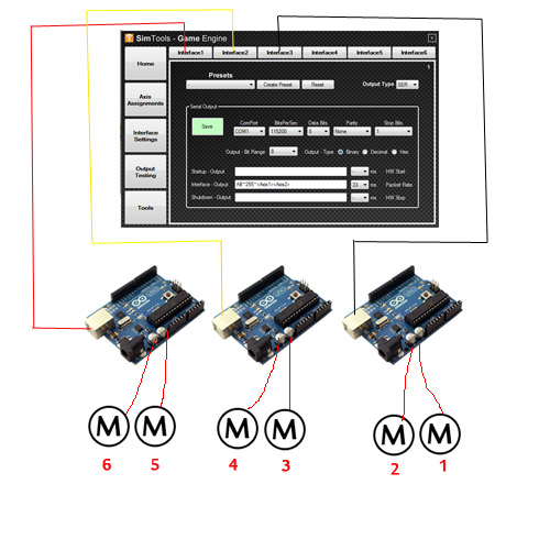

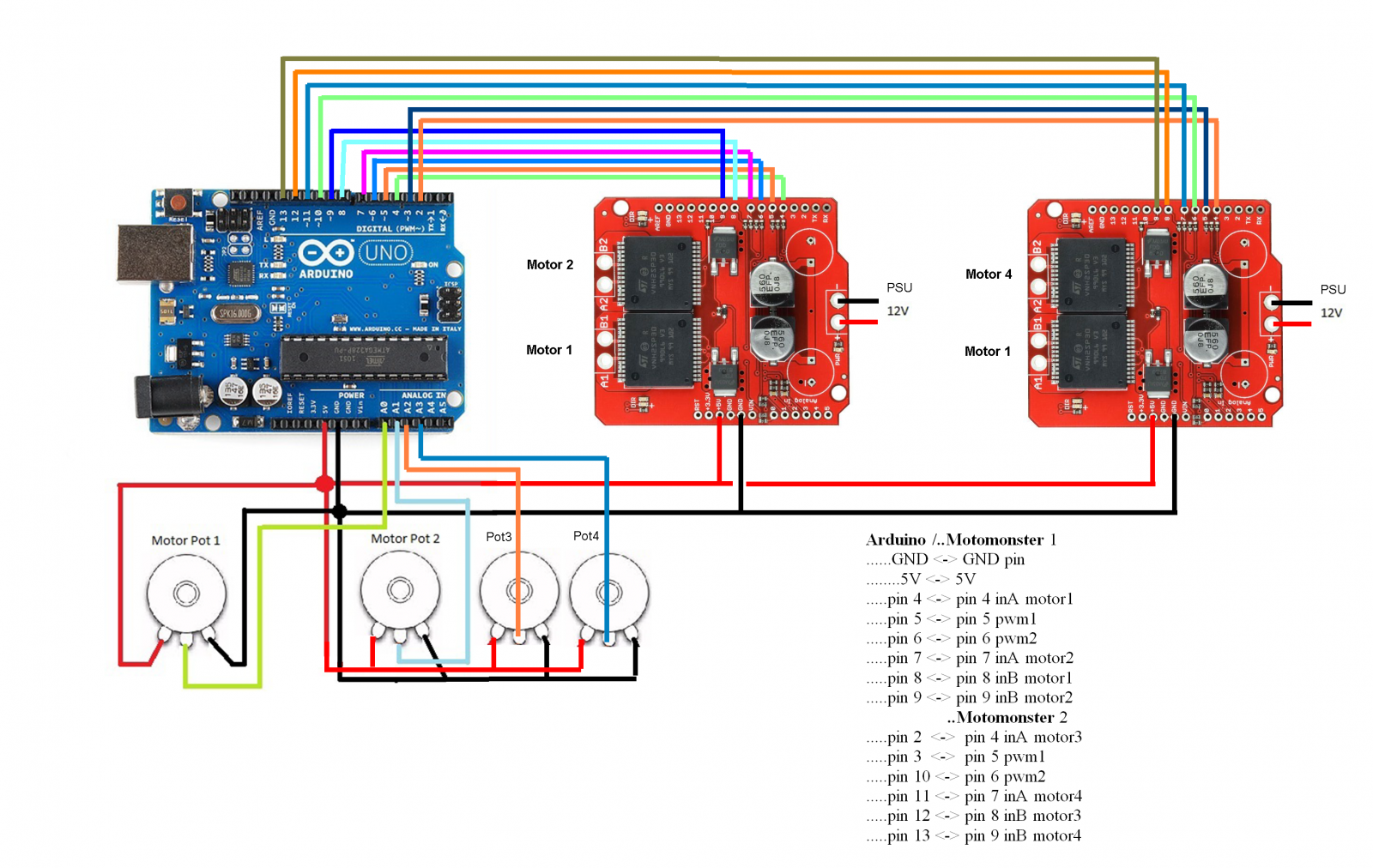

    i thinking to do the idea. using 3 arduino board so that take me 6 axis.
    and the simtools support more than one interface .
    That possibly or not?

    SimTools supports up to 6 individual interfaces. This will not be the limitation.

    this simple diagram to my idea

    @aboodix5 Yes this is correct. You can have one Ard per Interface Tab in the Game Engine.

    Also concerned about the tie, it uses 3 arduino uno board, but you can use one Arduino Mega board however I do not know how to load firmware into it. But thanks for the reply, that even when using only three Arduino Uno its possible.​

    One Motomonster can drive 2 motomonster for example: hence 4 DOF
