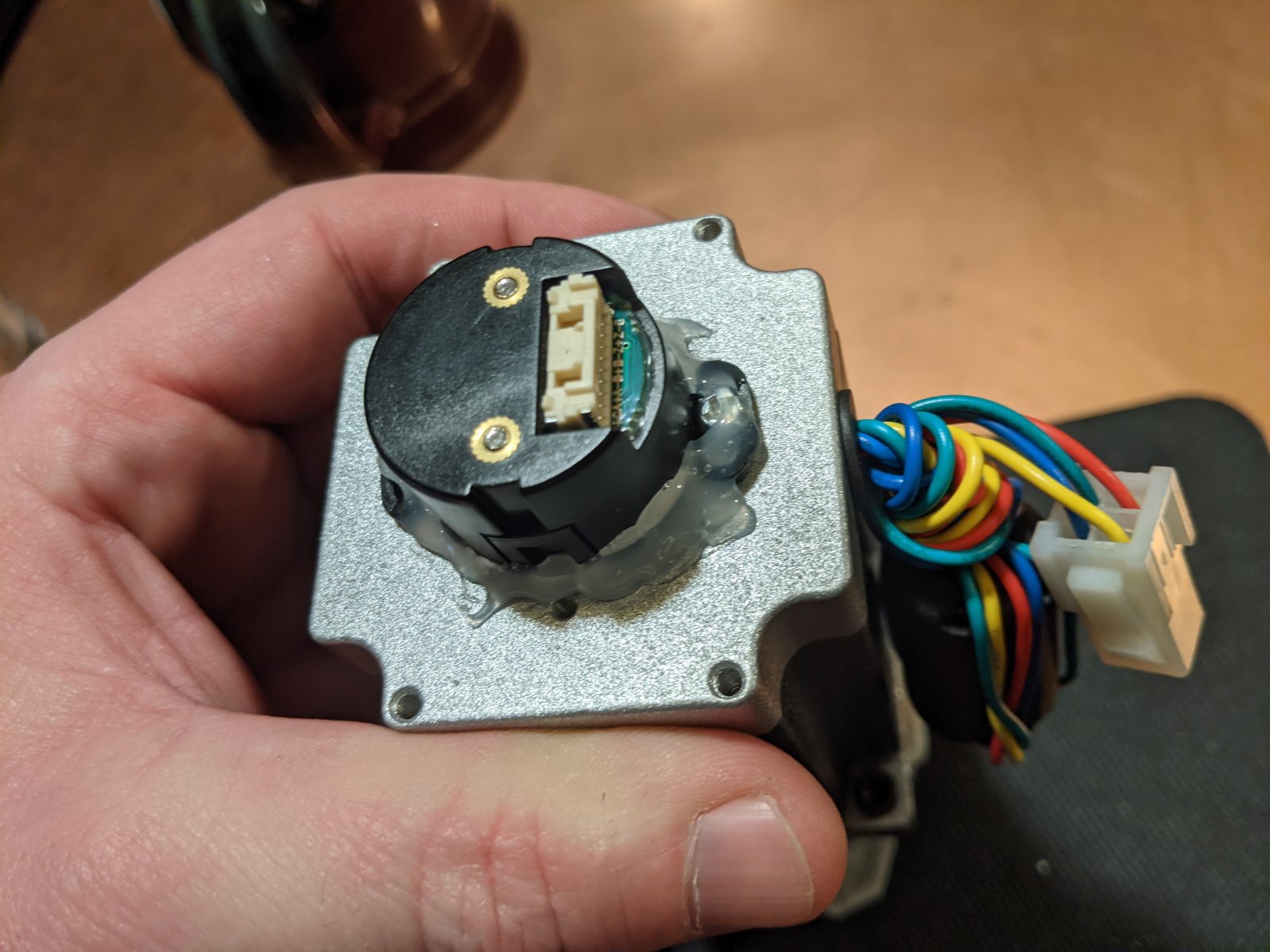

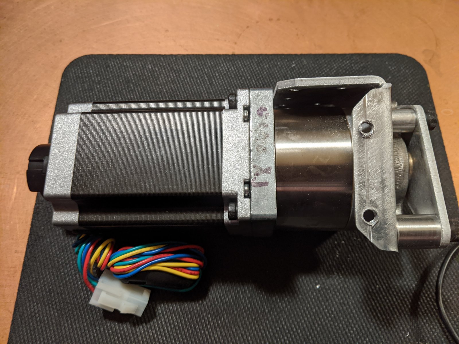

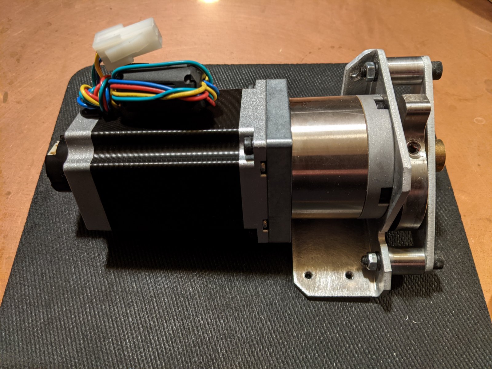

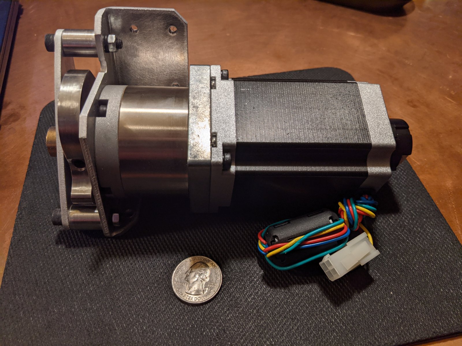

    I've got 4 of these motors that I salvaged from another project. They have no markings on them, but I'd like to use them to build a G seat.
    I've currently got a 5dof using SCN60s that I scratch built, but I know nothing about stepper motors. I've done some poking around, but not really sure where to start here. How can I find out what I need to power and drive them?
    The fabrication end of it will be no problem, but controlling the motors I'm clueless.
    TIA

    they look like stepper motors with built in encoder and gearbox
    you wont be able to control them using a normal pid controller so they will have to step small amounts one at a time to travel from a to b
    however there may be a way to make them step faster - i know some guys have tried using them on DD wheels and power the coils differently

    Sorry I had a typo up there, I'm using them to build a G seat. Not looking for crazy speed, just high holding torque. ..

    Heya,
    looks like a NEMA 23 sized stepper with a Trinamic TMCS-28 style 9pin encoder in the back (I hope it's held on there with more than just hot snot). Gearbox is probably somewhere in the range of 12:1 to 20:1 judging by the size.
    If you just want to drive it as a normal stepper, every stepper motor controller should do. If you want to drive it in a closed loop config like a servo you need a controller (e.g. a board with a Trinamic 4361A controller) that can interpret the signal of that encoder.
    Can't add links yet, but Trinamic has some blogposts how to do it with an Arduino and one of their controller boards. There is also a standalone board with USB (TMCM-1316).
    Edit: Ha! I knew I had a datasheet (see attachement) for a controller of this style on my HDD somewhere. Even looks like the one you have with those ears for the screws.
    Unfortunately that's as far as my knowledge goes. I have a very similar motor somewhere in a box in the basement that I wanted to use for a CNC, but never really started on that project aside from buying two steppers ...

    Thank you, I was wondering what that thing on the back did. I assumed it was some type of senor that reports the shaft position. So what does it do? I have the controllers encased in a plain black box, I'm gonna open that up and take a peek when I get a min.
    I need to drive 6 of these, 4 for the G-Seat, and 2 for the belt tensioner.

    Here is a stepper motor simple project using this sensor/encoder. Maybe not the same model encoder but...
