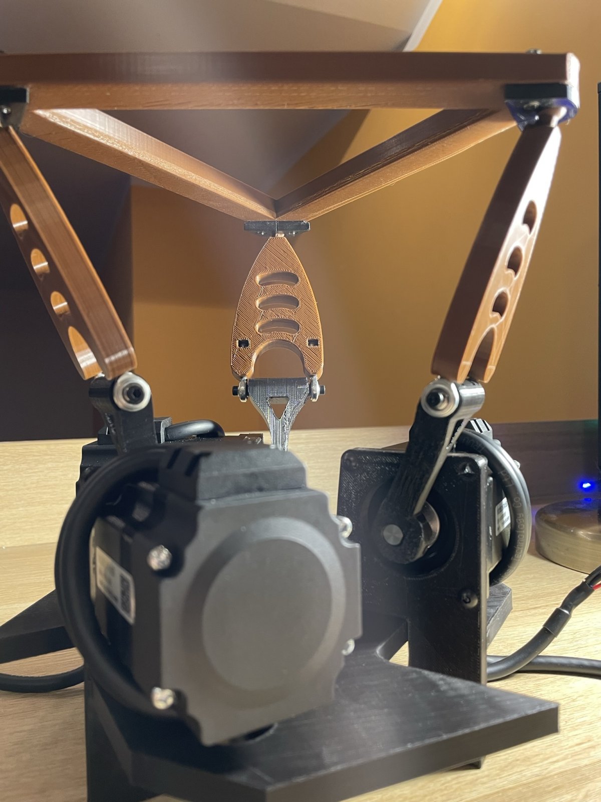

    First I would like to say that I am trying to make a Motion sim prototype and I'm giving myself a deadline of next summer. I have already assembled all the parts with my own Solidworks designed 3d printed parts. All of the electrical components are connected as well. All that is left is my big gray zone - Arduino programing with Simtools. I have no idea whatsoever how to get Simtools working and what kind of Arduino code I should write because I'm rather new to Arduino programming.
    Does anybody care to give me some advice?
    I am also attaching all of my progress so far.
    https://youtu.be/JZKs8c9ofkE - Mechanical construction test
    https://youtu.be/LyNRWqrxfJU - Electrical wiring test
    If I understood correctly I need to get a full license Simtools version in order to get this working? Is it possible to get the DIY package discount?
    I found some Arduino code in the forum :
    https://www.xsimulator.net/community/threads/arduino-code-for-steppers.5434/
    But I don't know how to test it out with Simtools...
