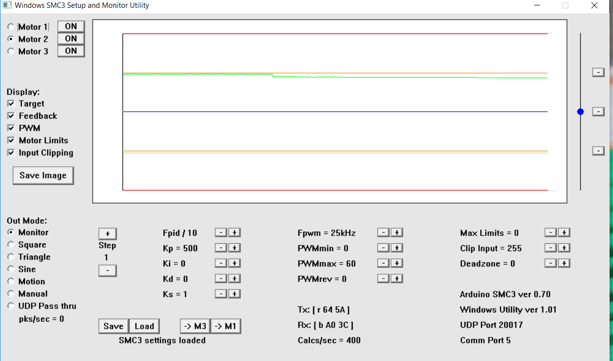

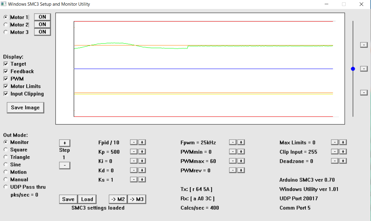

    I am having some issues with motor 2 cutting out, motor 1 seems to work fine. I believe the issues are to do with my feedback values. In SMC3 utils there is a noticeable difference
    Motor 1 seems to be working well. Has relatively flat green feedback line
    Motor 2 works intermittently and cuts out feedback line peaks & troughs at the limits

    Ok this is the frustrating part. The feedback results seem to be inconsistent for motor 2. I have taken some screen shots and both feedback lines appear quite flat now.
    Hoping someone out there can provide some steps I can follow to troubleshoot. I suspect the answer may be in @RufusDufus's doco but its a bit technical for me to comprehend atm.
    Let me know if you need any more info screenshots etc. Any help would be appreciated.
    NB I am at the stage of trying to control the motors via simtools and smc3utils (i think i need to configure more in SMC3, although motor 1 seems to work well and all hardware and settings are indentical as far as I can see)
    No load to chair mounted either (cant wait ;))

    The reason why I said you need to check your SMC3 settings was that I saw some unusual values, like Max Limits set to 0, while both instructions (the one from RufusDufus as well as the one from @BlazinH) say you should set it to 255 in order to give the motors enough moving range.

    I believe SMC3 settings are correct based on:
    "Clip Input Used to create a band at either limit of the target range beyond which any values sent to the SMC3 are clipped. In addition to this clipping, if the motor feedback does move beyond this range (typically through inertia), the SMC3 will attempt to brake the motors hard by driving them in reverse until they are back out of this limit zone. The value can be anything from 0-255 (however can’t be less than the current limit setting). Reverse braking is applied in the band between the Clip Input and the Max Limit settings. Reverse braking can be disabled - refer to PWMrev.
    Max Limits Used to create a band at either limit of the feedback range beyond which if the motors move (typically through inertia) the SMC3 will automatically shutdown the drivers and keep them disabled until reset. This is essentially a safety mechanism if something goes wrong. The value can be between 0-255 (however can’t be greater than the current clip setting)."
    Its confusing because he states, "can’t be greater than the current clip setting" for max limits. So I think the max limits setting is based on the bottom end of the graph in SMC3 utilities and the clip input setting is based from the top since clip input, "can’t be less than the current limit setting" also.
    Unless you have already narrowed the problem down further I would swap IBT's in order to test the one you have now on motor 2. Once its established they are both good then go on to test other things.
    And if need more info about SMC3 utilities here SMC3 Arduino 3DOF Motor Driver and Windows Utilities

    1. I dont see it stated anymore which output mode to use the SMC3 utility and have left it on the default of Monitor. Is this ok?
    2. I thought I read somewhere that the SMC Utility can be used to test/drive the motors as opposed to just providing diagnostics, is this true?
    3. Step 9 in the guide above mentions the green feedback line moving towards the blue line. In my results for one of my motors the blue line is fairly straight in the middle and my green line is peaking and troughing (substantially) above and below the blue line

    One other question is what does the green feedback represent I am assuming this is the value from the potentiometer that is providing feedback on the position of the motor/shaft, is this correct?

    Correct, and when increasing the PWMAX value slowly the green line should be approaching the blue line little by little, if not it exchanges +5 and gnd in the pot or reverses the rotation of the engine, never both at the same time that you will have the same problem

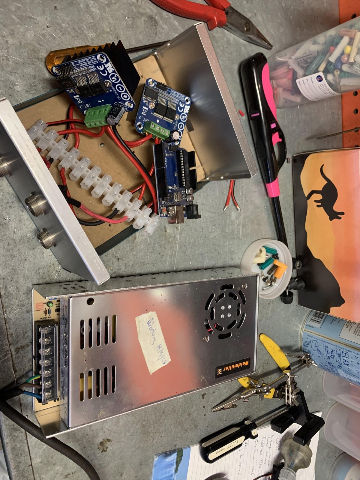

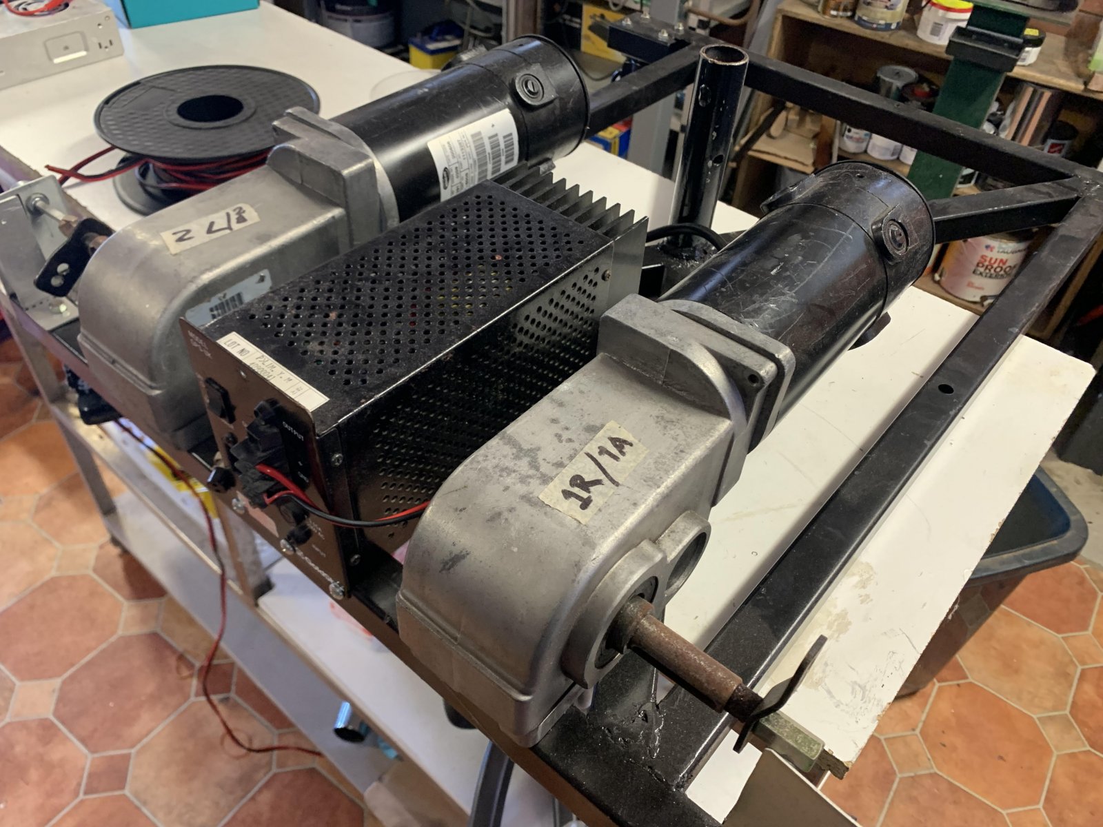

    So I'm finally getting my build off the back burner.
    I've decided to strip down all the electronics, do some unit testing and rewiring. I'm hoping this combined with some lessons learnt on other projects and a 3d printer which have distracted me will lead me to a successful outcome this time around. Also seen some great videos for 2DOF IBT2 builds ...
    Also running 2x 24 10.5amp PSUs this time. hopefully they are sufficient I stupidly blew up my 20amp... lessons learnt
    Check out my build photos :)
