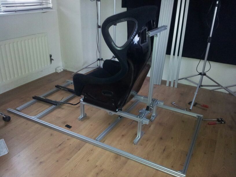

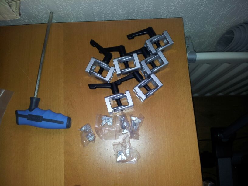

    The idee off building myself a simrig is a wish I had for a couple of years but for some reason I'll never started building. Till a friend of mine Erwin (Levi) who has a modified frex simulator gave me the leftover alu profiles as a starter kit.

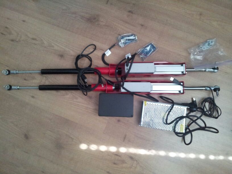

    Simxperience actuators and red damper dust caps, a power supply and rs485 adapters,

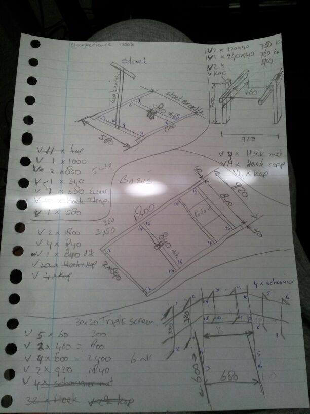

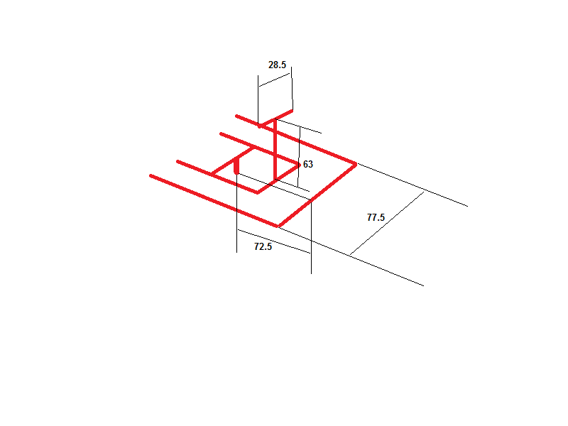

    then I made a cat drawing with the exact measures of the rig. I included the measures and angles for the seat pivot and actuators,

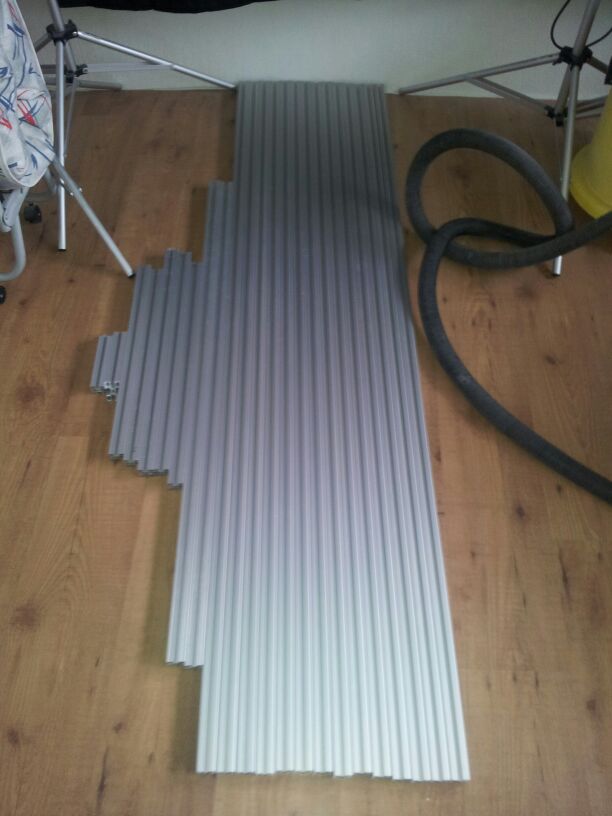

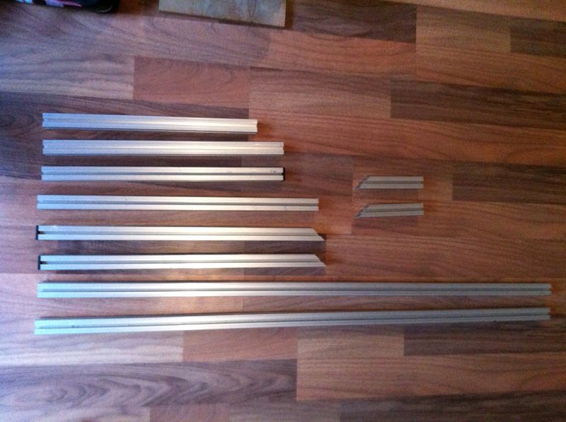

    To complete the needed materials I ordered lots of aluminium from Germany,
    Profiles.jpg IMG-20130621-WA0003.jpg IMG-20130621-WA0004.jpg IMG-20130621-WA0005.jpg Rubbers.jpg

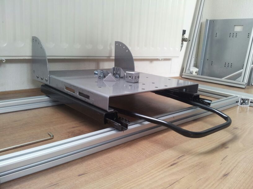

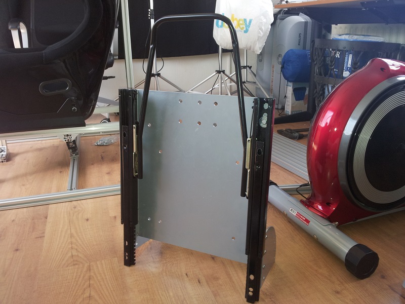

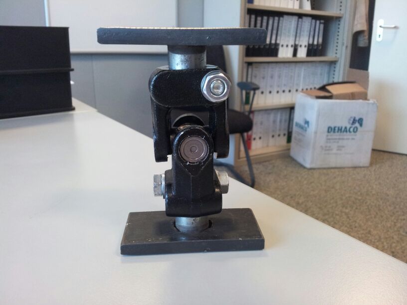

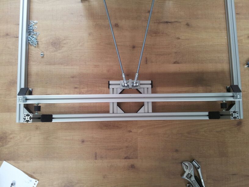

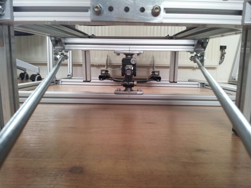

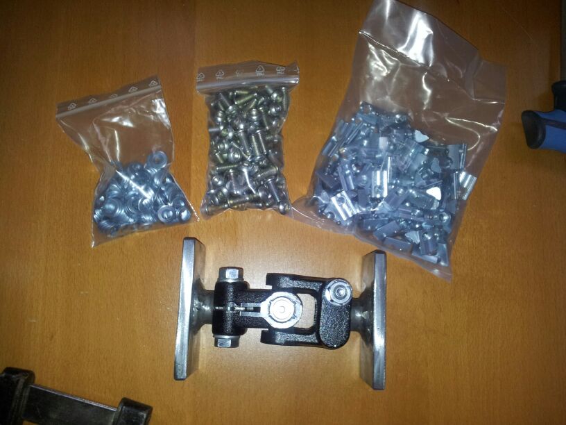

    The pivot was made by a colleague ad my at work,

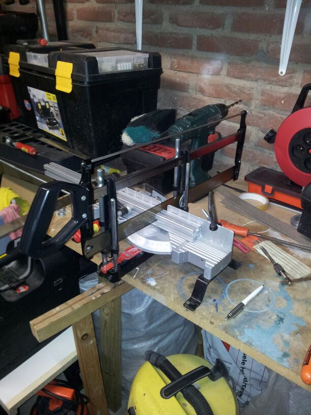

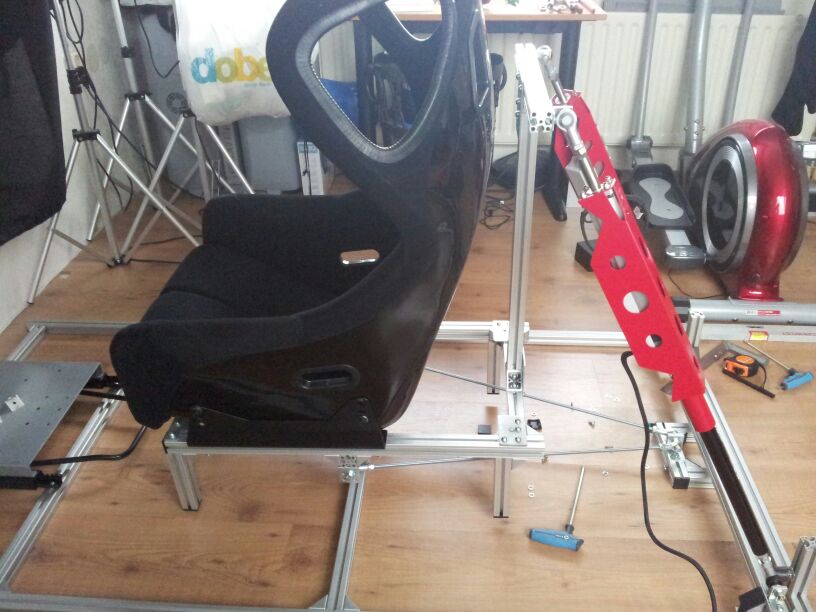

    After I got all the materials together I started sawing al the aluminium in the right lengths in my workshop,

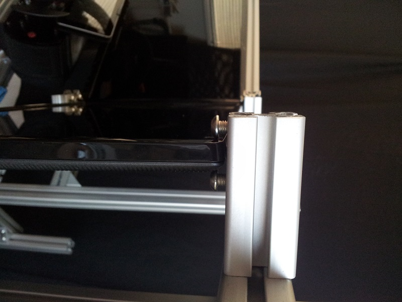

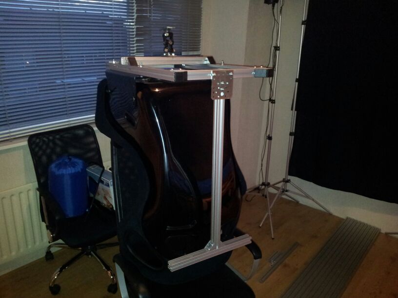

    Afther two days off sawing I started to put everything together starting with the crown of the rig,

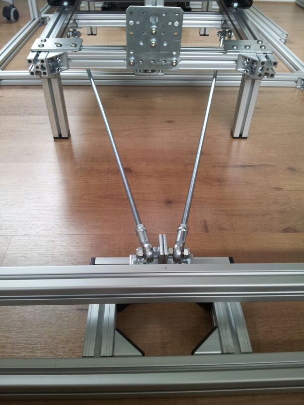

    Mounted the rot ends, just to be sure
    To make it possible that other people can have a comfortable seat I mounted a slider under pedals so they are adjustable,

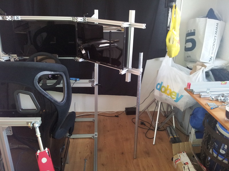

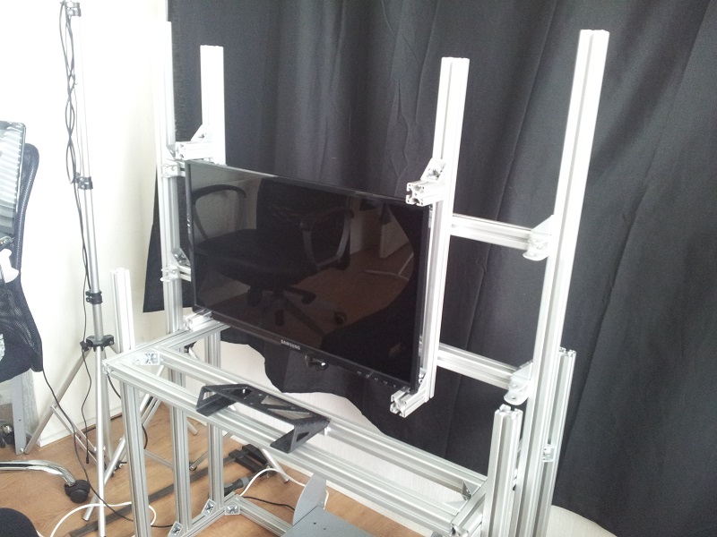

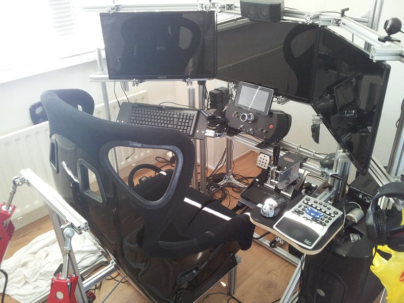

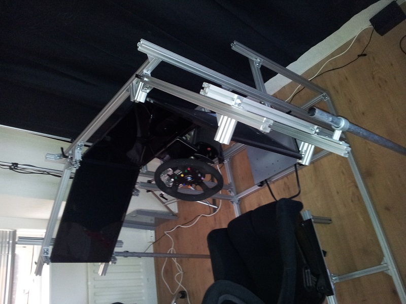

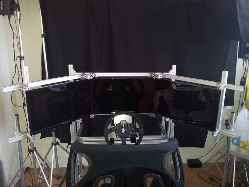

    Then I had another problem to overcome, my screen don't have a vesa mounting so I build a triplescreen standaard on the fly,
    Tripple screen 1.jpg Tripple screen 2.jpg Tripple screen 3.jpg Tripple screen 4.jpg Tripple screen 5.jpg

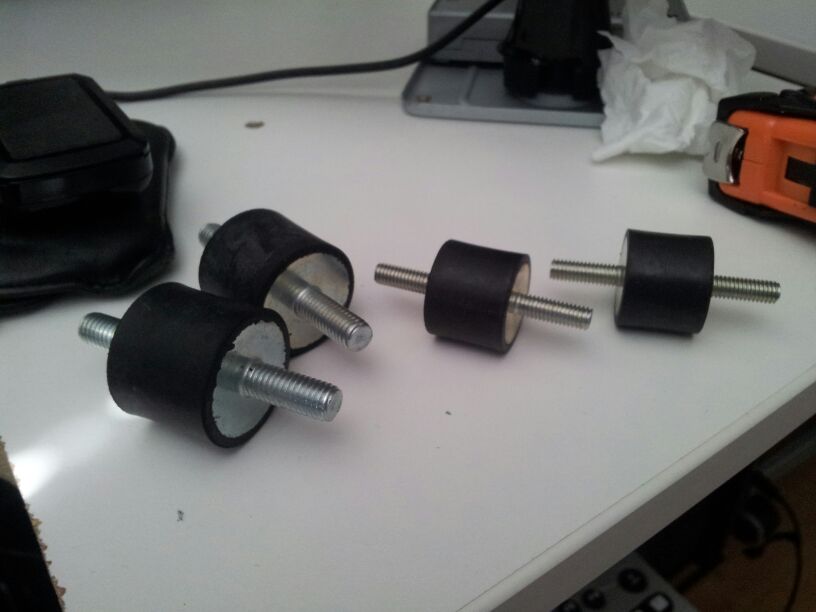

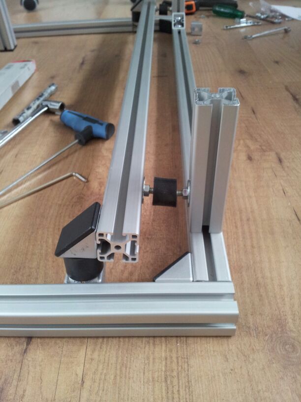

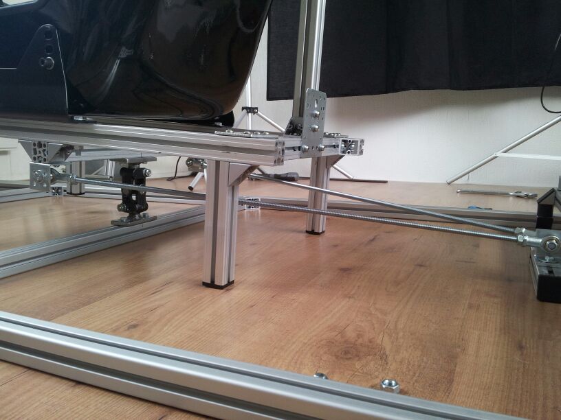

    Time for the suspension from the actuators and rig,

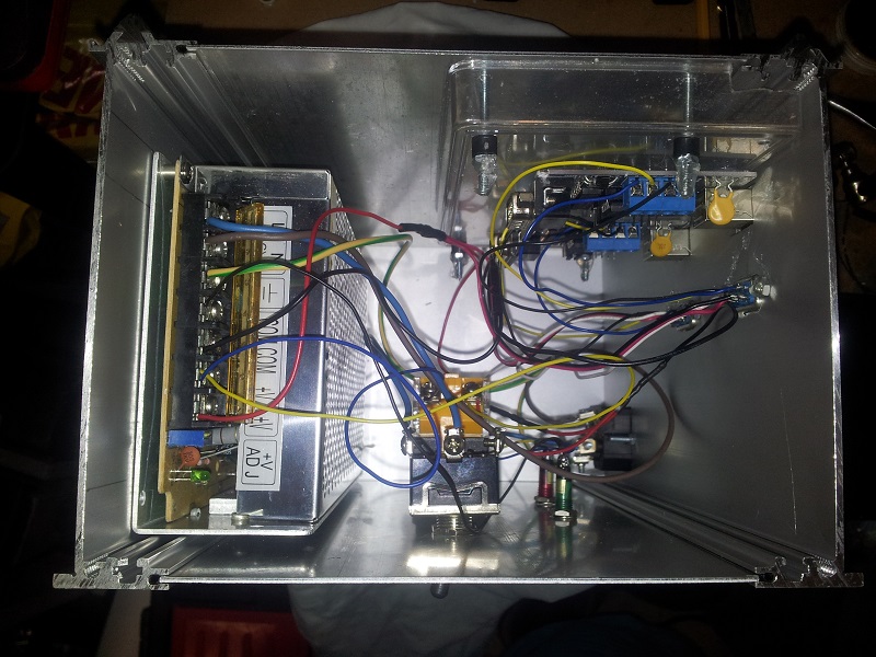

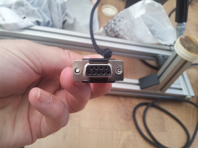

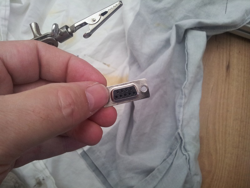

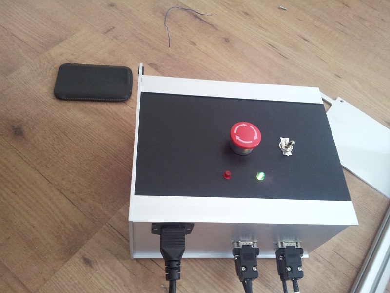

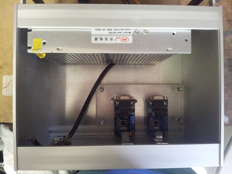

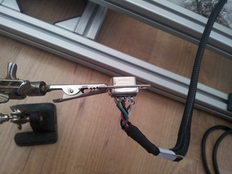

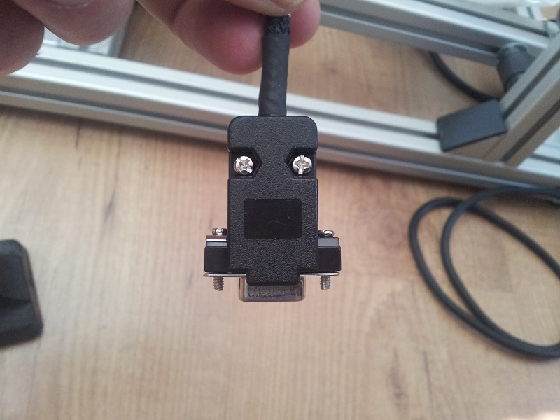

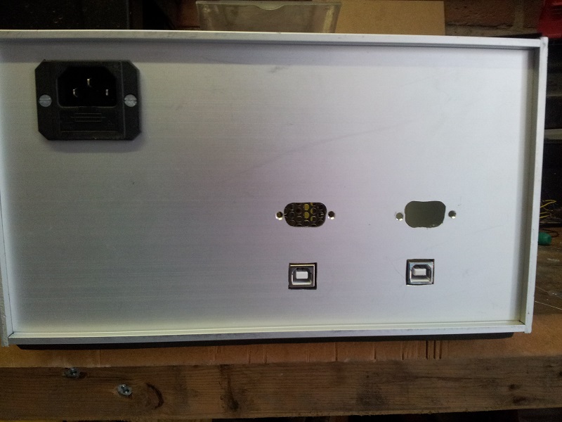

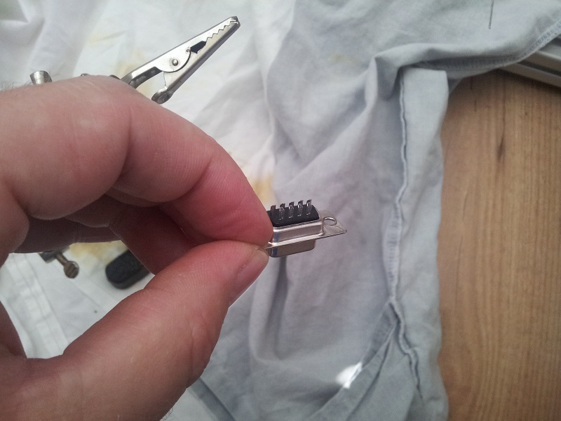

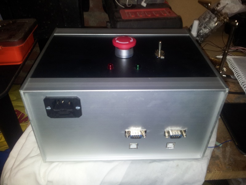

    Making the xRinulator box and the connection with the actuators. I used comports to make this connection and I used this
    SCN5 connection diagram with killswitch and ilk protection.GIF scheme to connect everythim
    Making Box 1.jpg Making Box 2.jpg Making Box 3.jpg com female.jpg 20130715_171159.jpg Making Box ready.jpg box in axtion.jpg 20130715_171204.jpg 20130715_171041.jpg Com Male 2.jpg

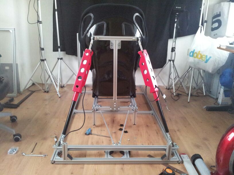

    Then mounted the SCN5 actuators,

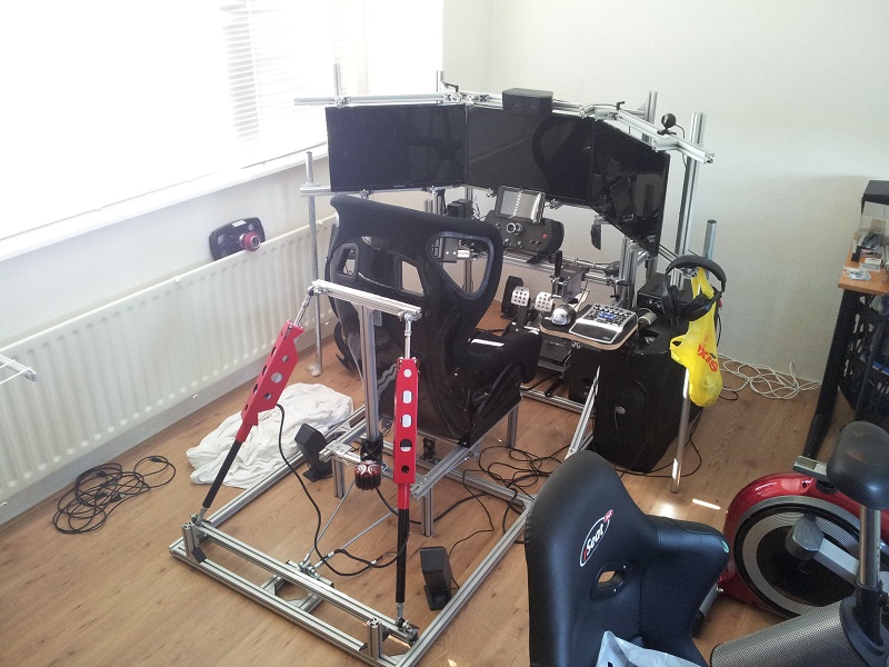

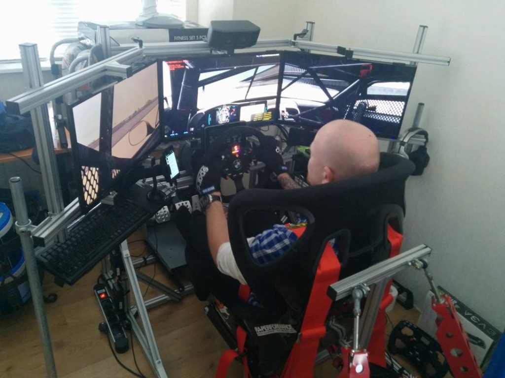

    In the meantime I had a 24 our race at Racedepartment so "ll finished the seat without the movement,
    A few days later I connected everything and made a first run with it.

  6. Erwin levasier
    Erwin levasier Rare Endurance Team
    Oct 13, 2012
    9
    Ijmuiden netherlands
    390Coins
    2DOF, SCN5
    And i can say: it's a blast :)
    Jarno a team member behind the wheels :)
    And myself in Rinus his motionsimulator :)
  7. Erwin levasier
    Oct 13, 2012
    9
    390Coins
    2DOF, SCN5
    And the builder himself behind the wheels :)

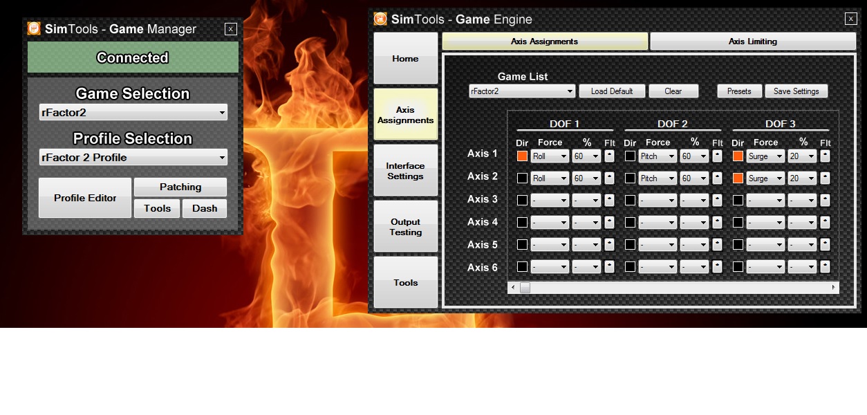

    @Rinus janssens When you post screenshots of your GameEngine and GameManager settings i bet we find the proper settings.
    Probably its only a small setting which has to be fixed.

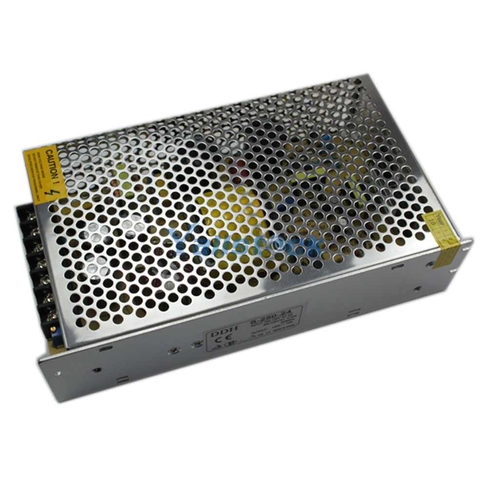

    $(KGrHqV,!rkFJUWf7Y1sBSej4I8qHg~~60_57.JPG $T2eC16d,!zcFIdw)qLYKBSej4OE2Qg~~60_57.JPG

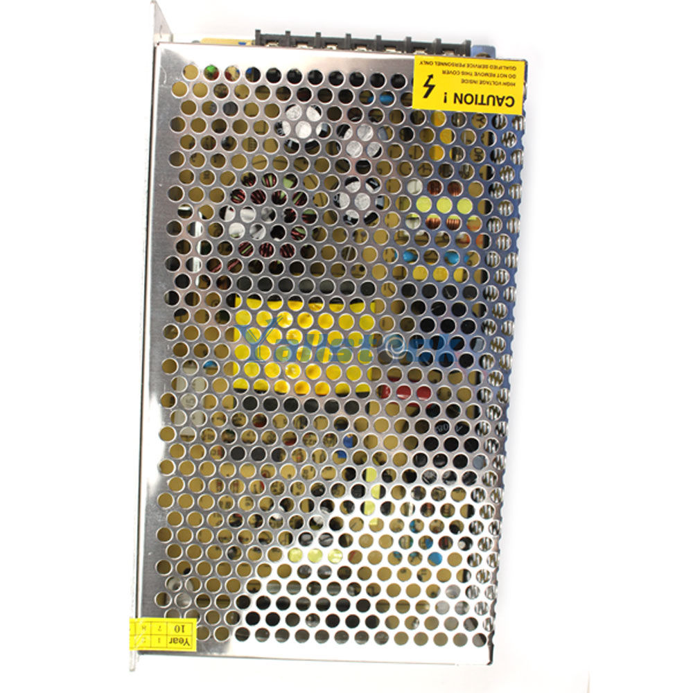

    It took a bit for me to reply because my cheap ass power sup blew up on me with a big bang when I turned it on last Thursday.
    I tried to repair it but it wouldn't work anymore and I don't wont to take any risk with my actuators so I ordered a new one and installed it yesterday. I'll hoop it's of a better build quality then the one above.
    Its a Mean Well
    http://www.omvormer.nu/content/voed..._dc/300_watt_-_230v_ac_naar_24v_dc_-_12,5_amp

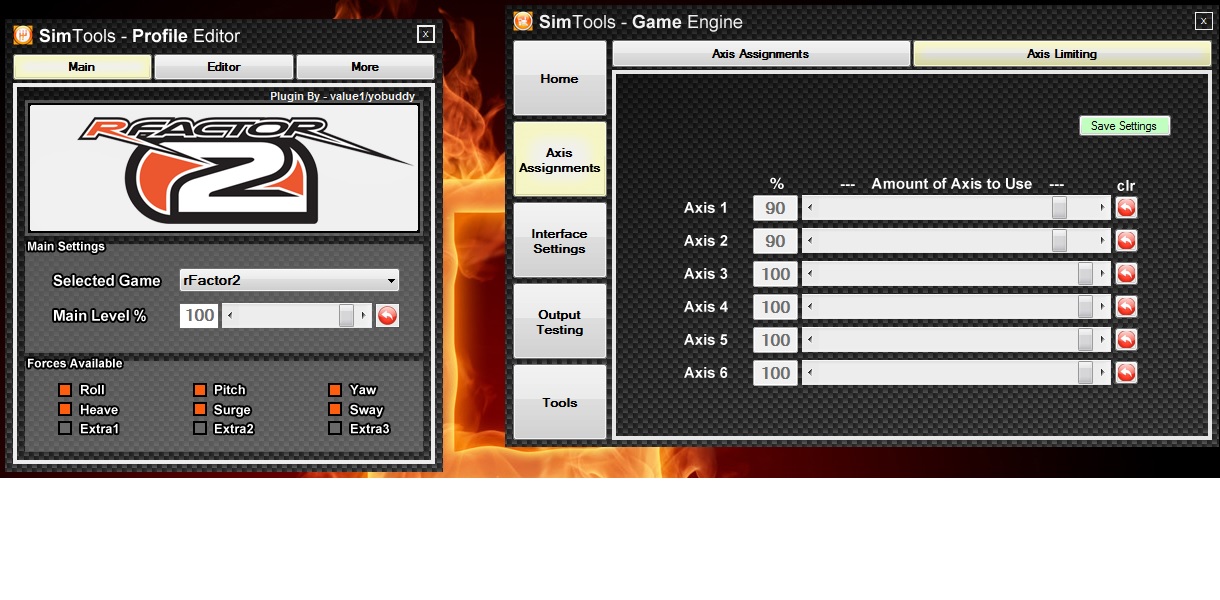

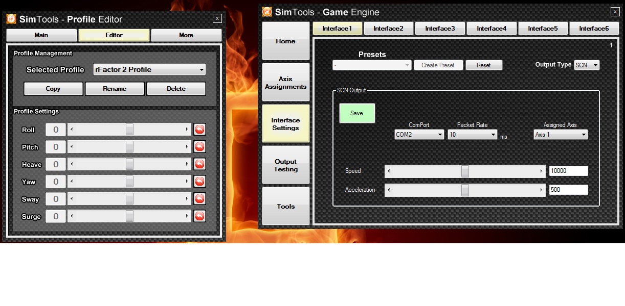

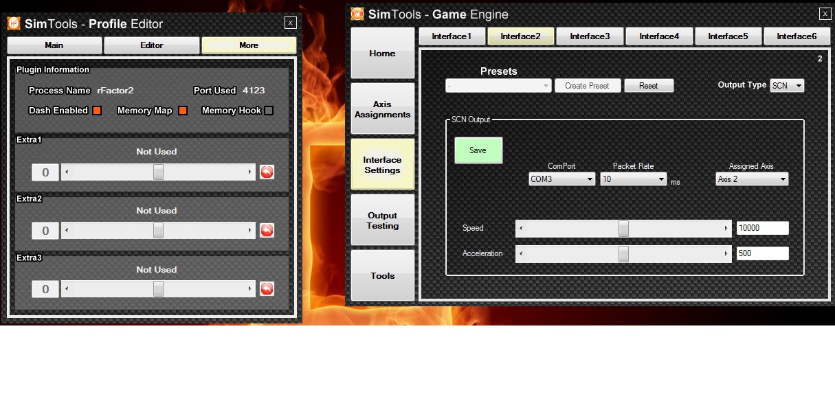

    So and now for my simtools settings.... :)
  20. Rinus janssens
    Rinus janssens Active Member
    Oct 11, 2012
    159
    environmental construction
    Holland
    2,153Coins
    +87 / 0 / -0
    SCN5
    The problem is:
    The car drives like a plane lol
    When I go uphill the chair leans all the way back en when I go downhill it leans maximal forwards.
    When there is a flat piece of road in the middle and I am driving half way it's like I cross a line. The seat go's from max back to max forward ?
    I don't feel any acceleration or decellaration.
    The shift feeling is much better then with all the other software. You where right about that eaorobbie.
    The feeling when I'm riding over curbs are fantastic I really feel the car lift on one side.
    It feels that its got lots of potential. so maybe one of you guys have some tips or game file.
    And maybe can tell me what I should do with it ?
