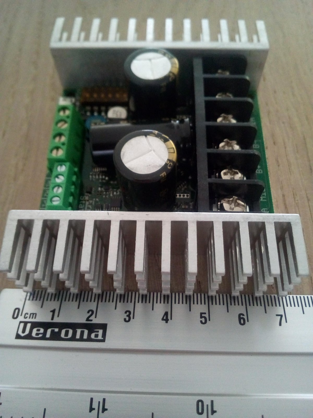

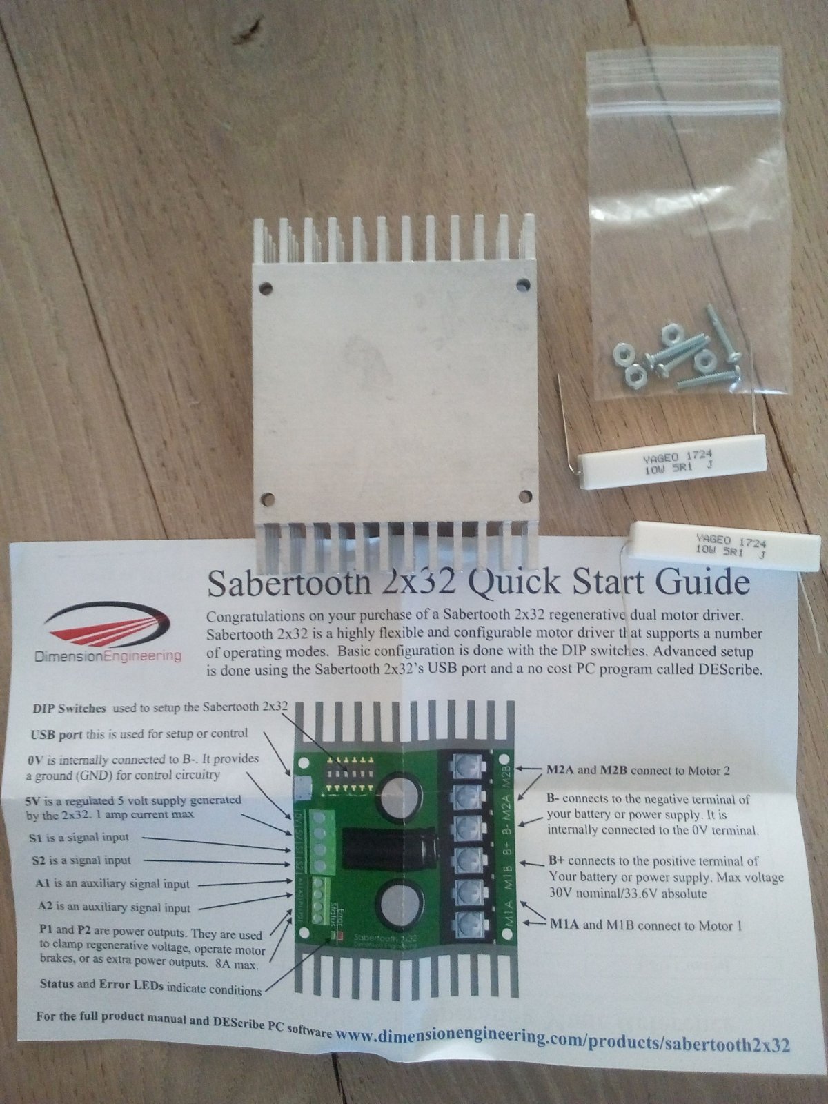

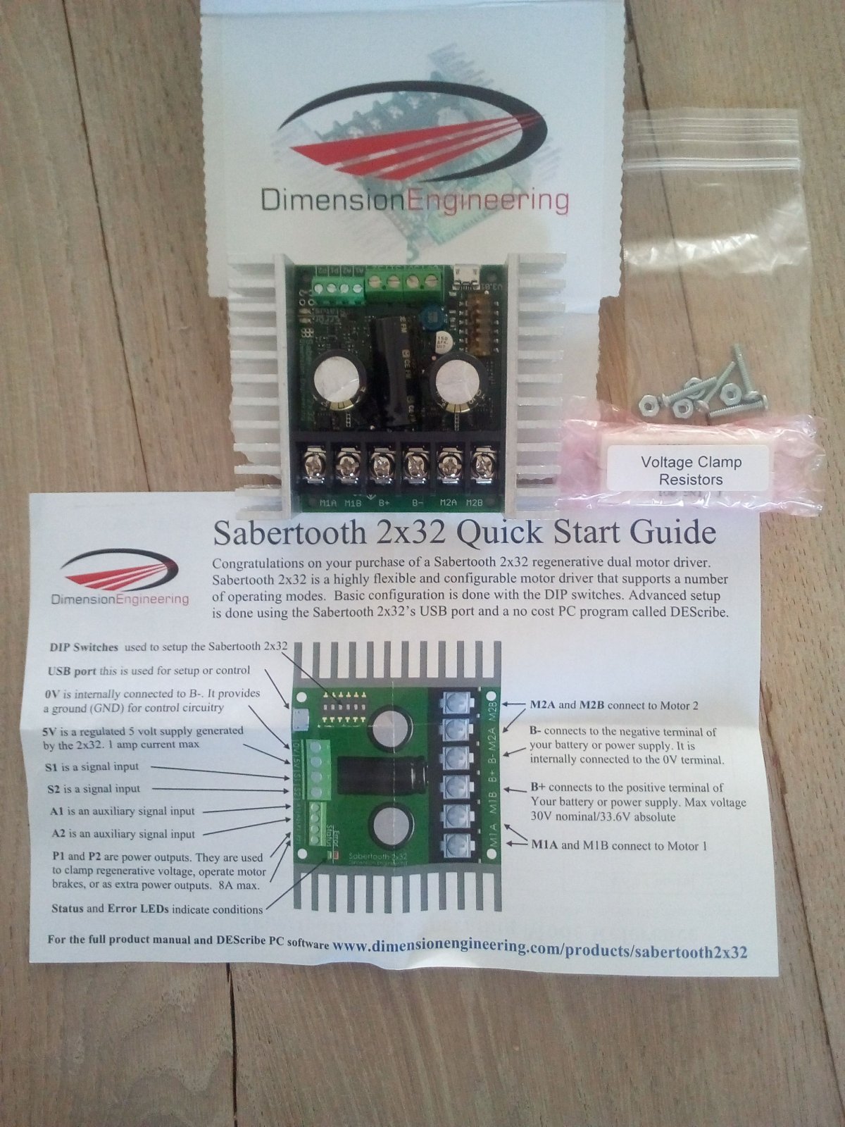

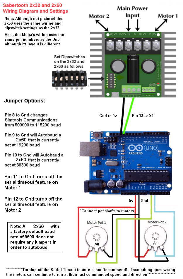

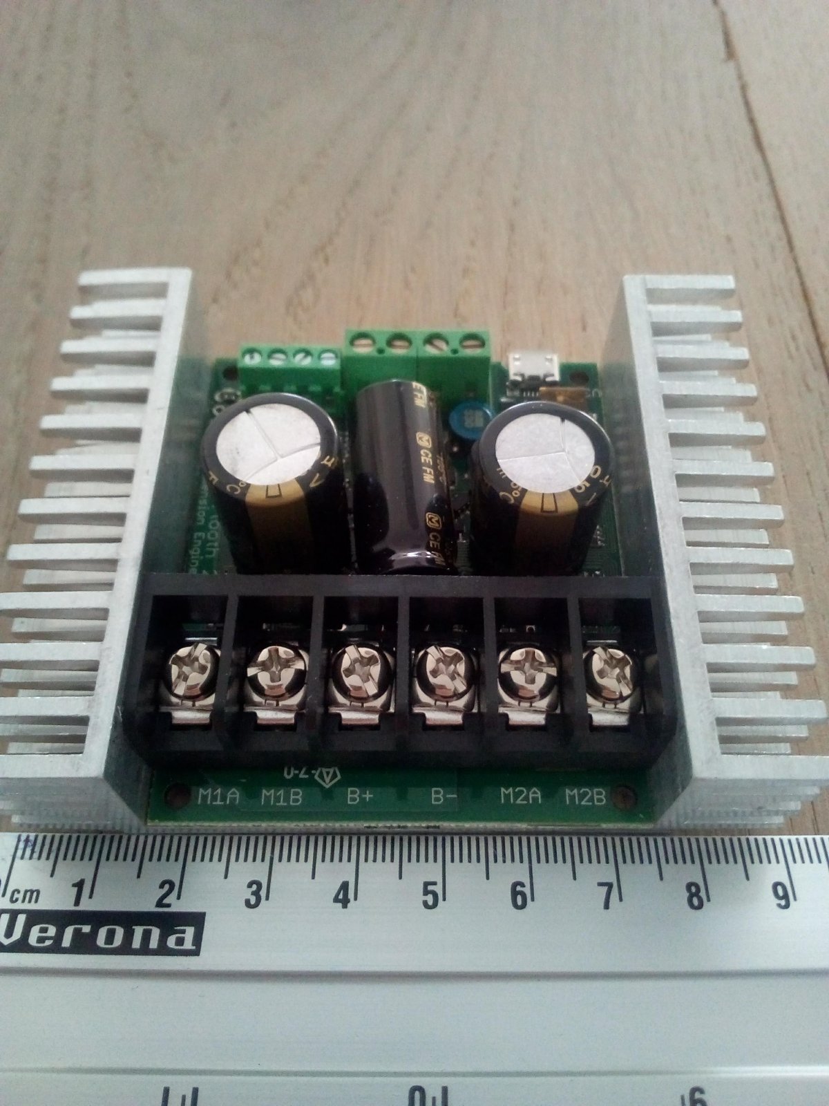

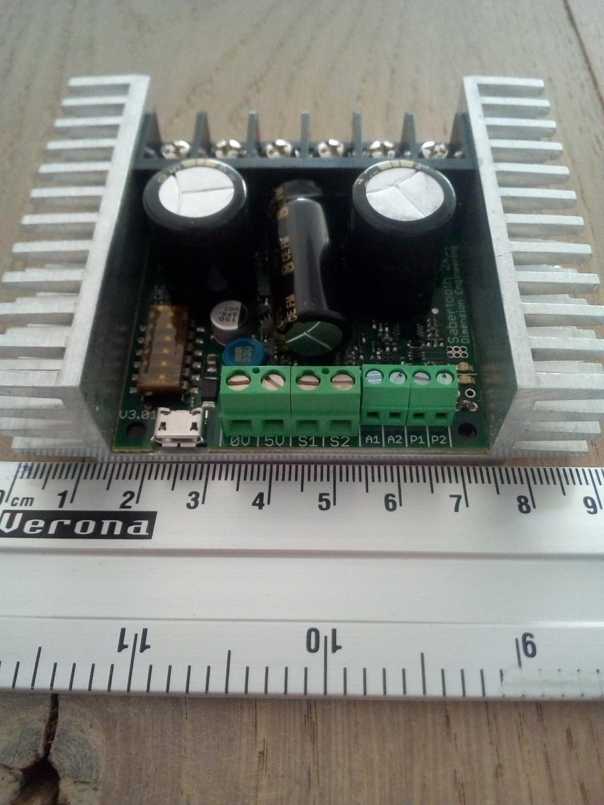

    For those who want to know the exact dimensions of a Sabertooth 2x32A.
    Here are some pictures:

    Good morning, @Brie69,
    now that you have everything you need, I guess this will become a busy building weekend. :thumbs
    The SMC3 setup instructions you mentioned in your last post is great. Just follow the steps carefully.
    And note that with wheelchair motors you will probably need a smaller Kp value than recommended in this thread.
    You will recognize it when you get jerky motor movements. I had this problem, and another member had it as well, see here: https://www.xsimulator.net/community/threads/first-build-no-joy.12644/#post-165779
    See also @BlazinH‘s explanation below this post.
    Oh, one more thing: Don‘t forget to connect the voltage clamp resistors. You should have 2 of them in your Sabertooth package. You can find the wiring further below in the SMC3 tutorial.

    Right now I noticed that you mentioned Sabertooth 2x35. I hope you actually meant 2x32 (and not something else like 2x25, which does also exist and currently causes lots of trouble for another forum member, because it is not supported by SMC3.)

    Sorry, fixed it...it's a 2x32 like in the photo's I posted.

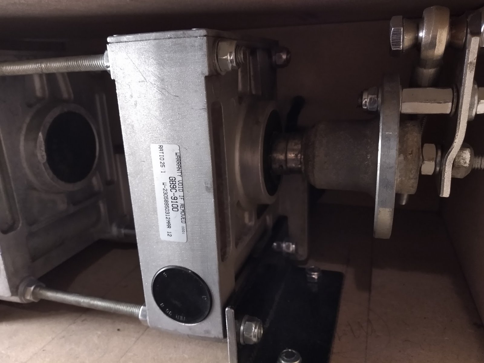

    Thanks for this positive feedback @MarkusB . At first I started with the batteries that were with the wheelchair when I bought it. Yes, indeed I had bought a whole wheelchair for 75 euros.
    This weekend I will first determine the balance point of the top of the simulator and make a working drawing so that the base, the bottom of the simulator, is well thought out first. I myself had devised to use the heavy weight of the battery pack to keep the base small.
    But first some drawing and calculation, not to mention SimCal.
    Cheers,
    Bryan

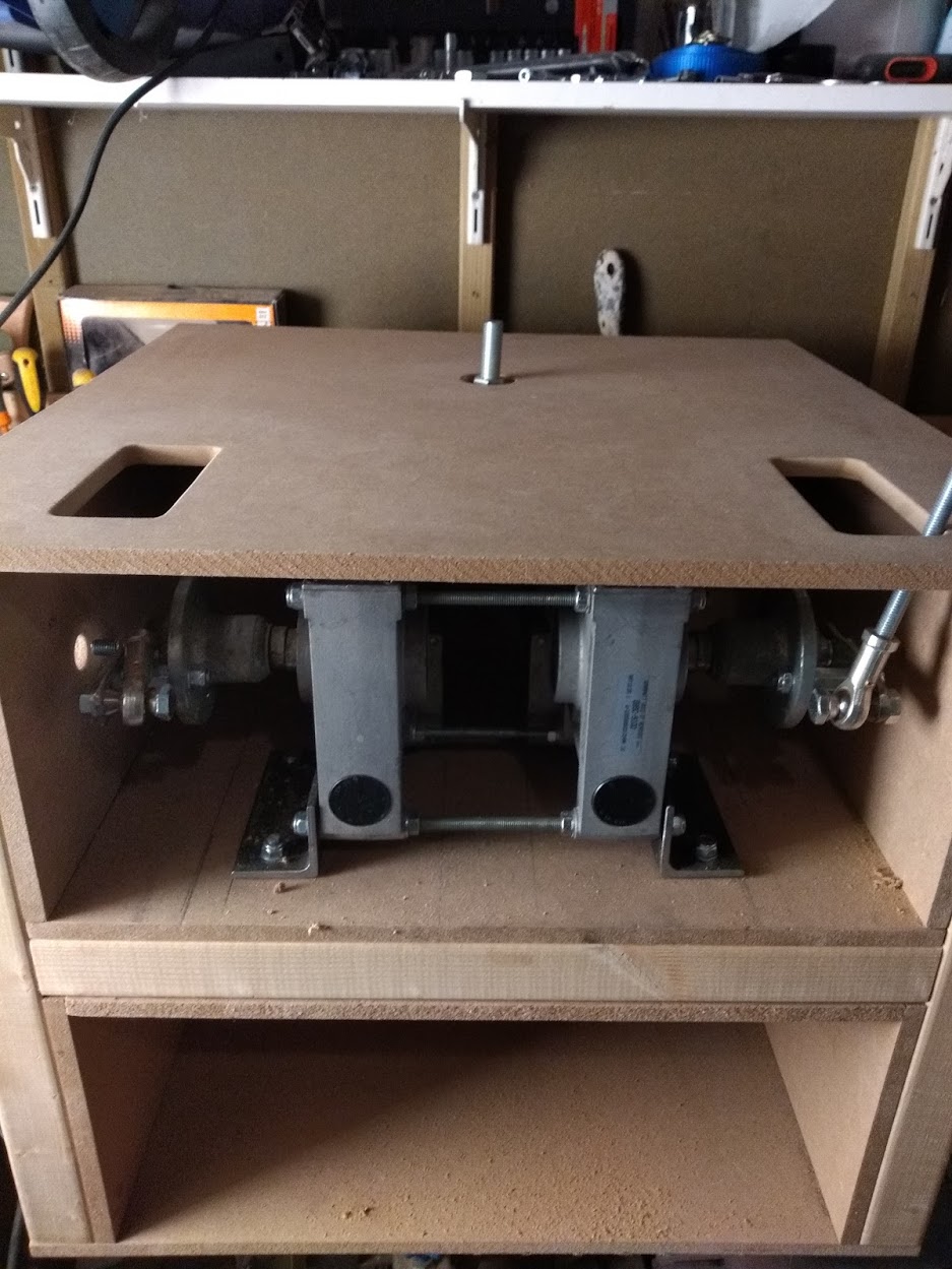

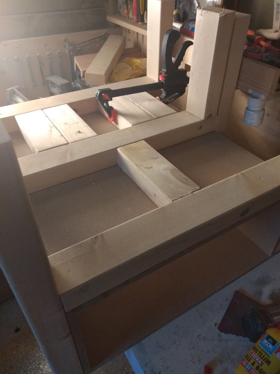

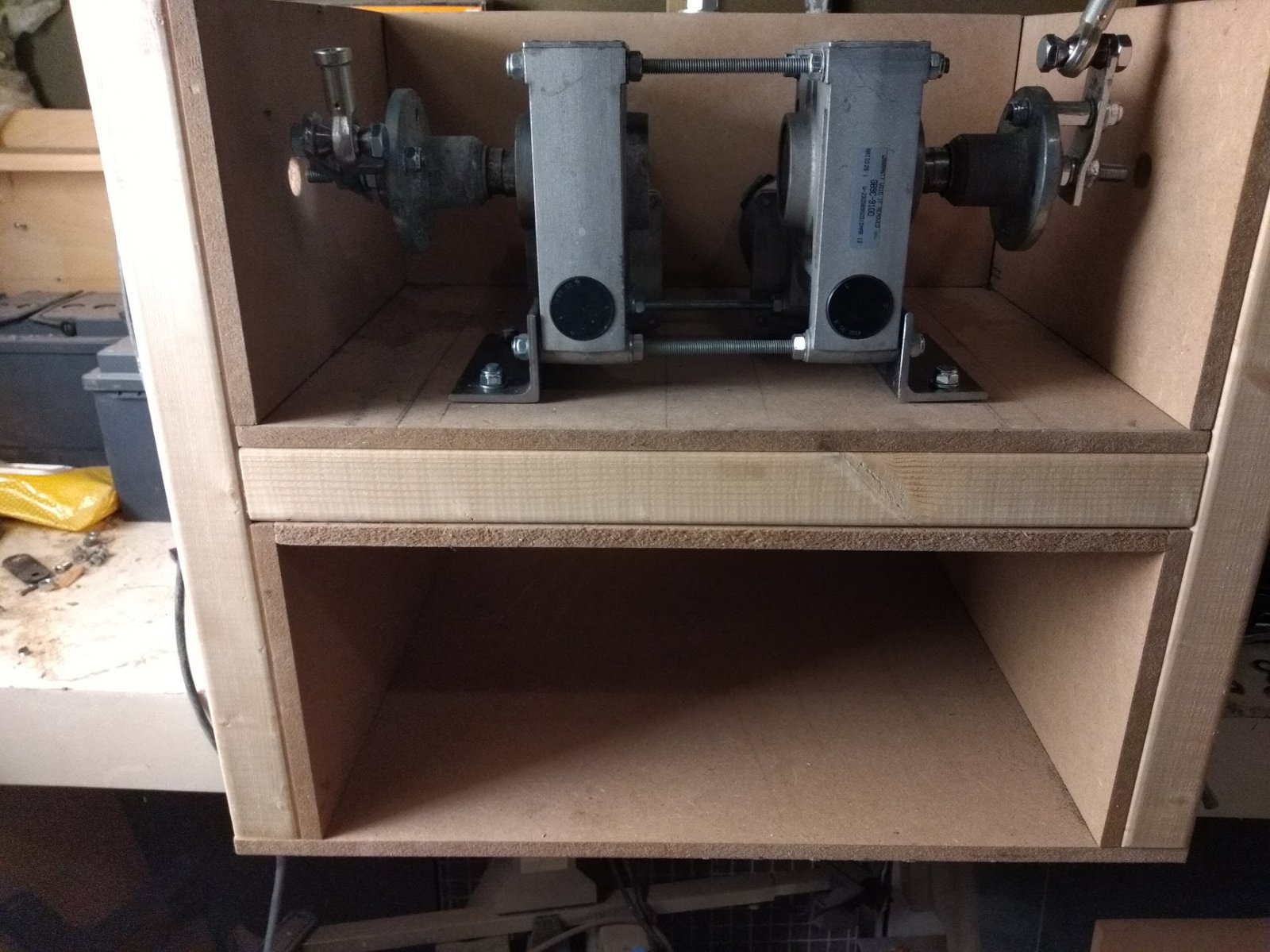

    Working on the new base

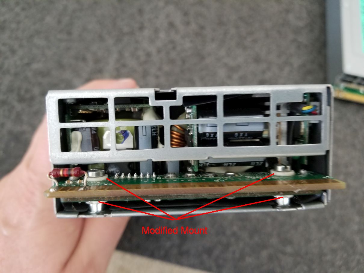

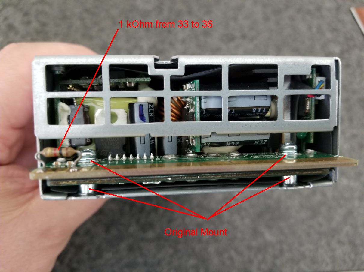

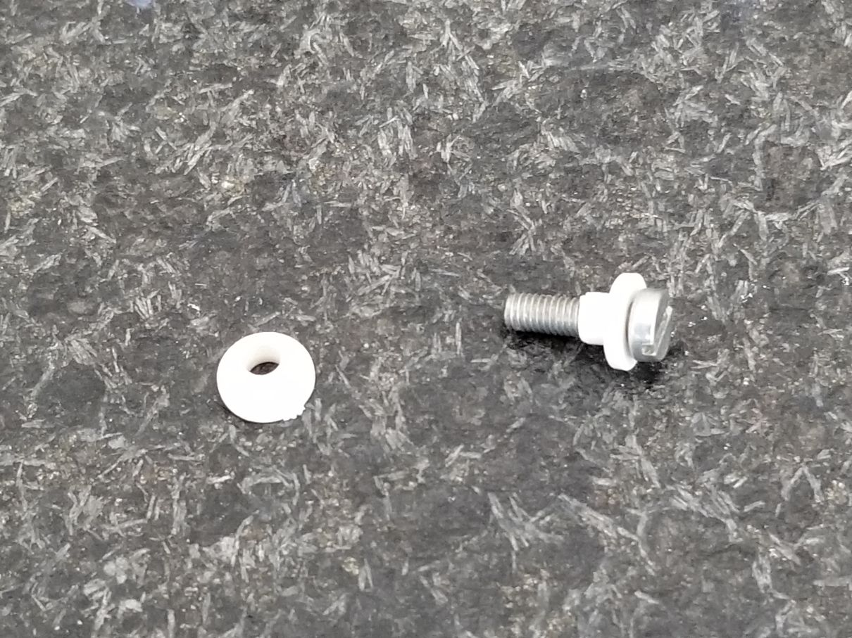

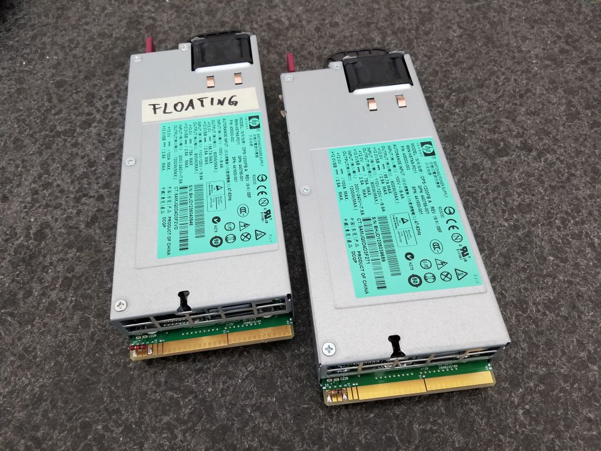

    In case you are still looking for a 24V power supply, I used 2 x 12 V server power supplies to power my wheelchair motors. There are several used ones available on Ebay and they have sufficient capacity to power wheel chair motors under load. Just make sure to float one of the supplies if you connect them in series.

    +88 / 0 / -0
    Thanks for that @GTexas I'll will order two of those later on.

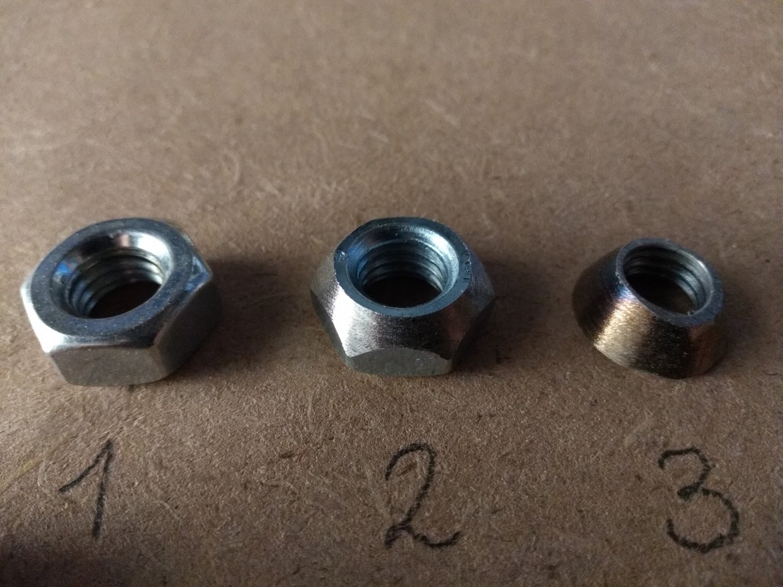

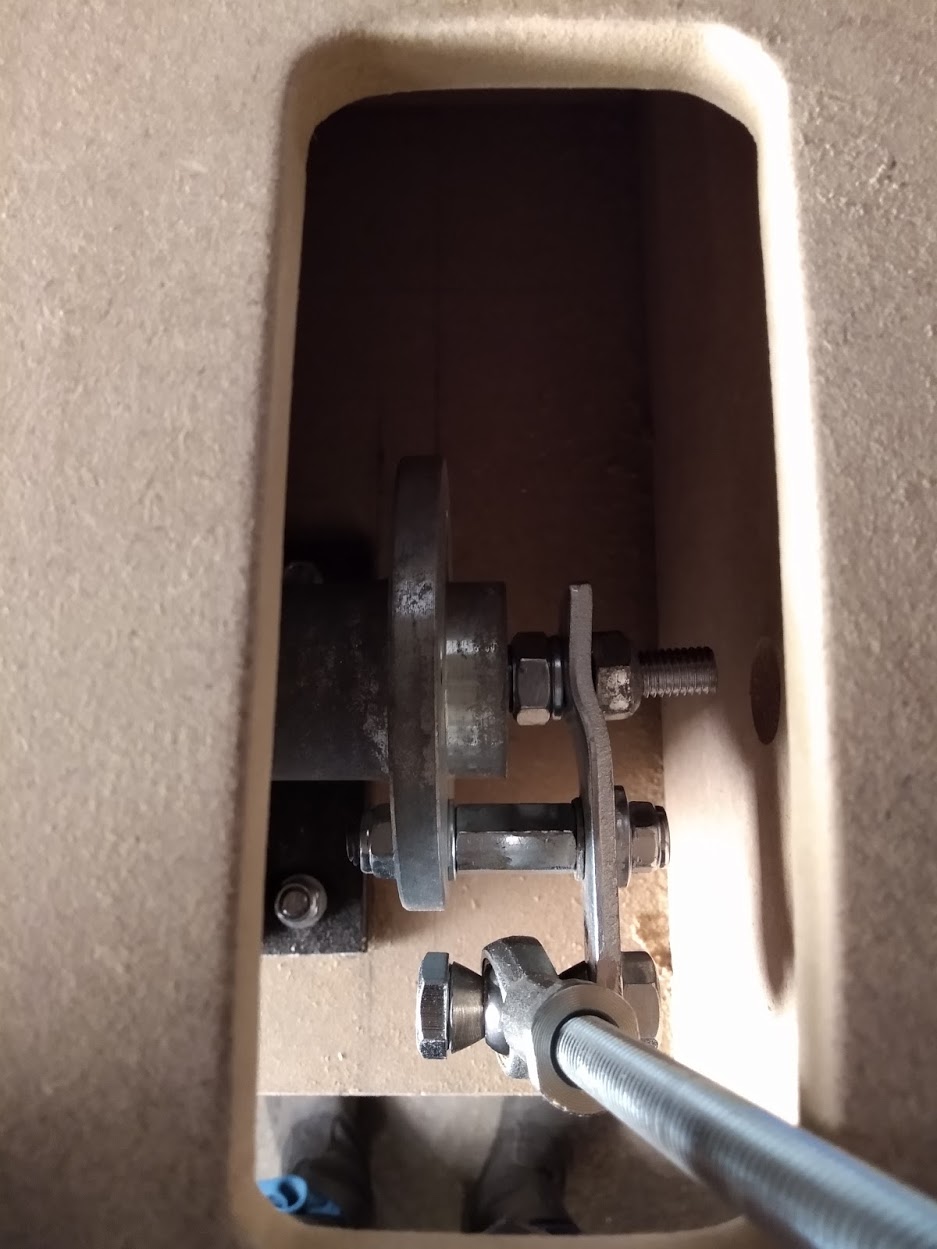

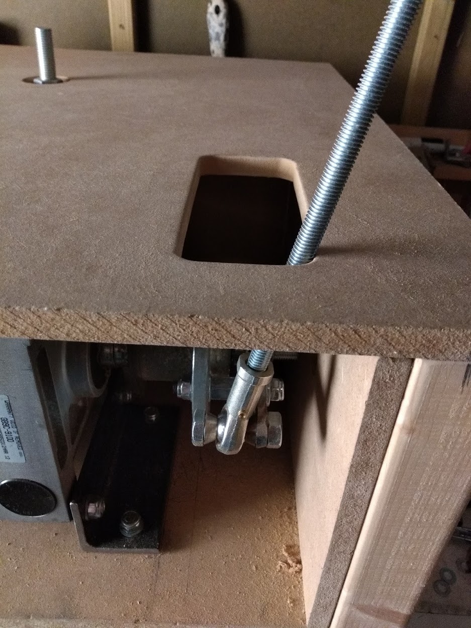

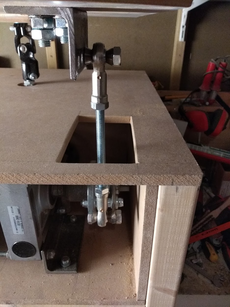

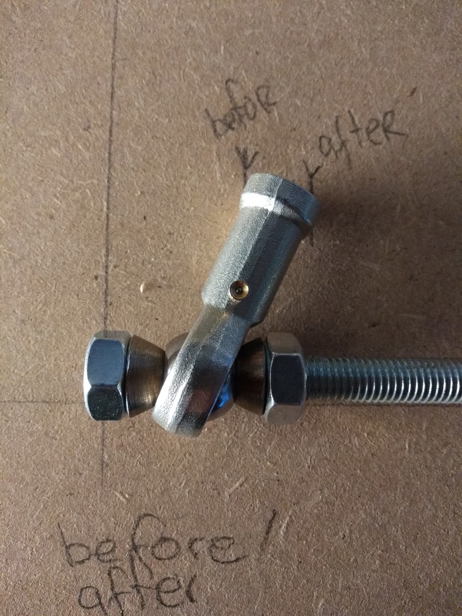

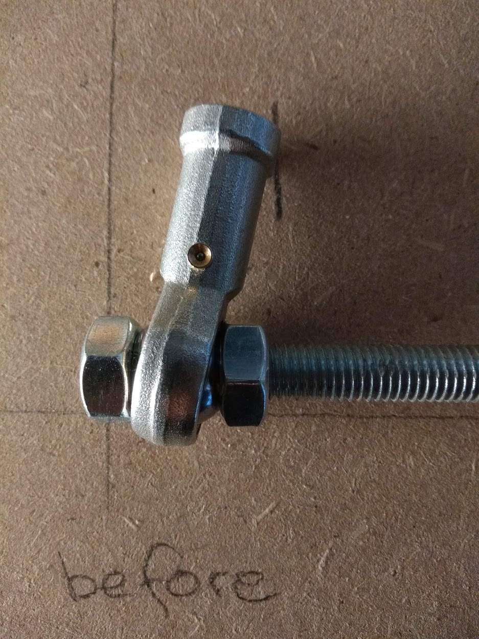

    Working on the bracket

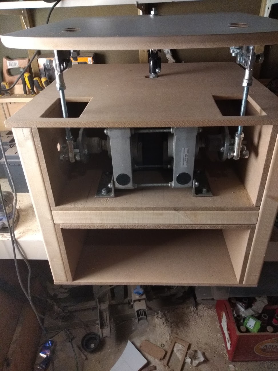

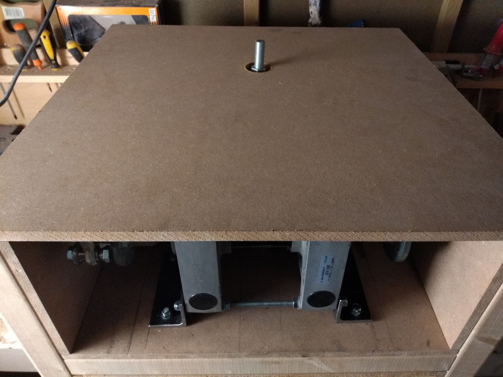

    Working on the top cover
