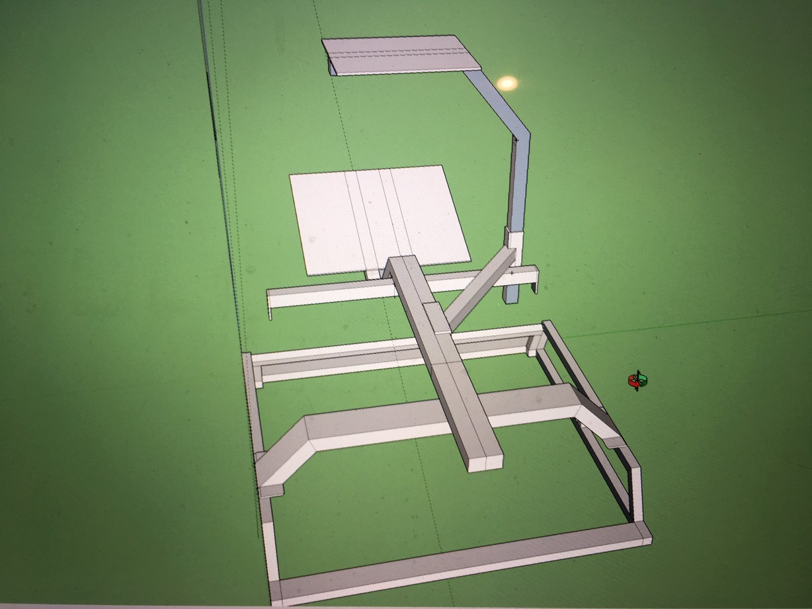

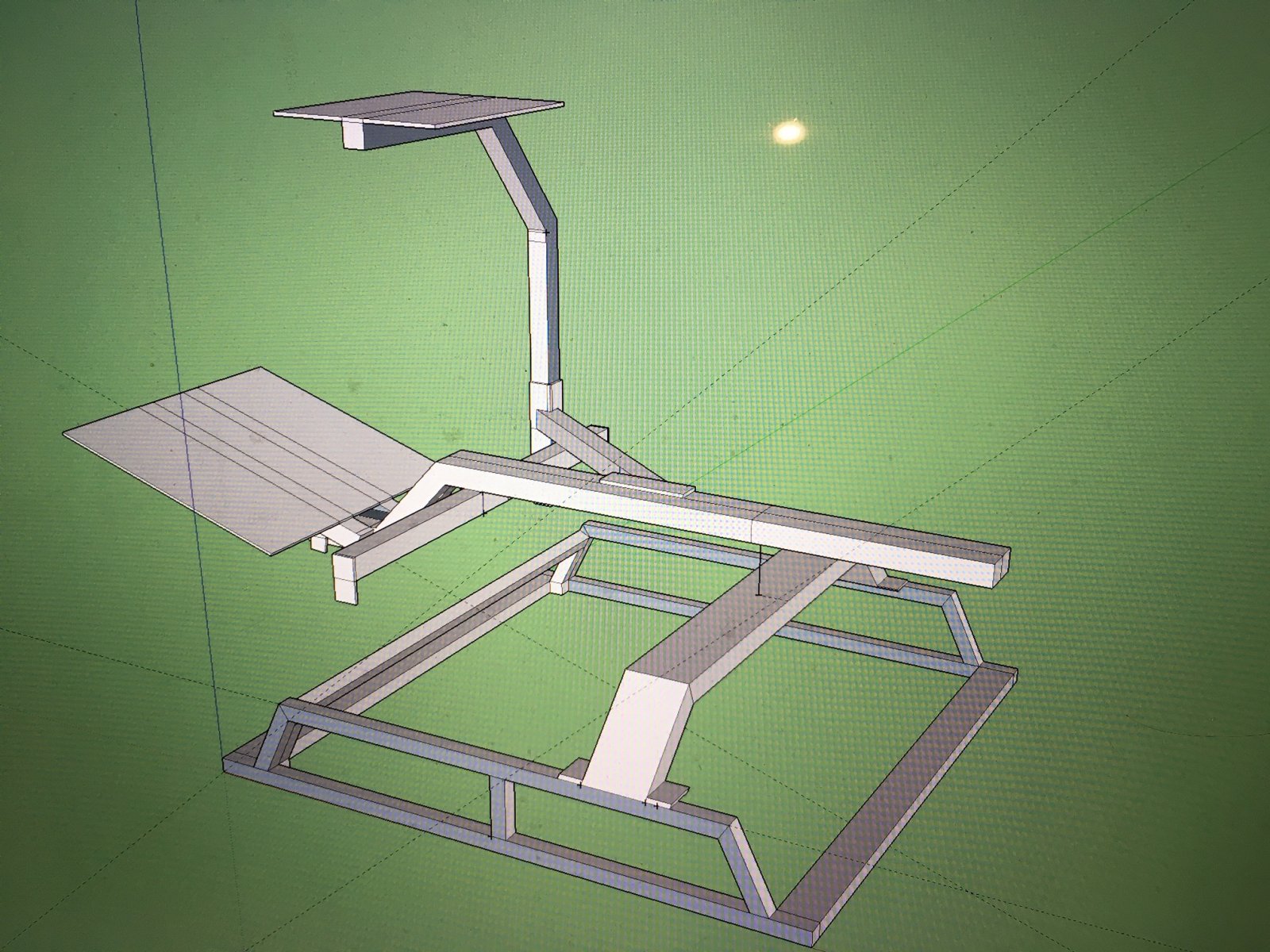

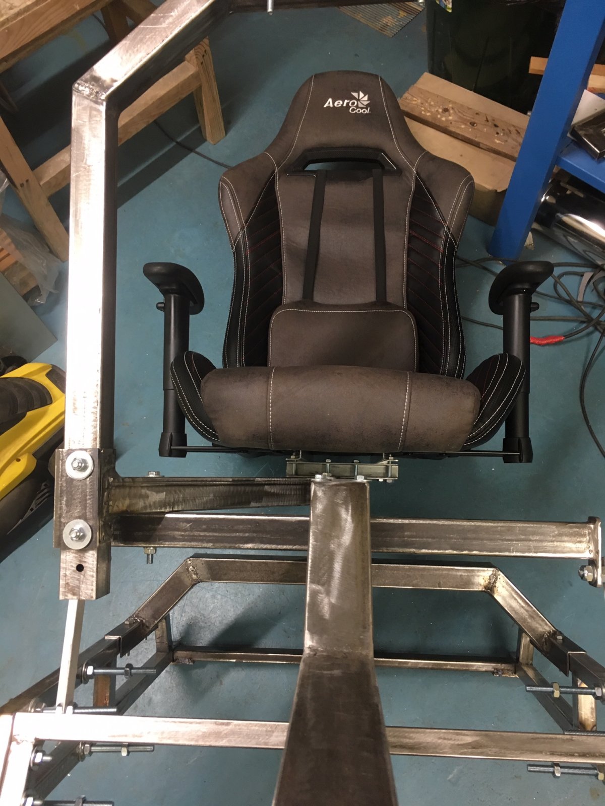

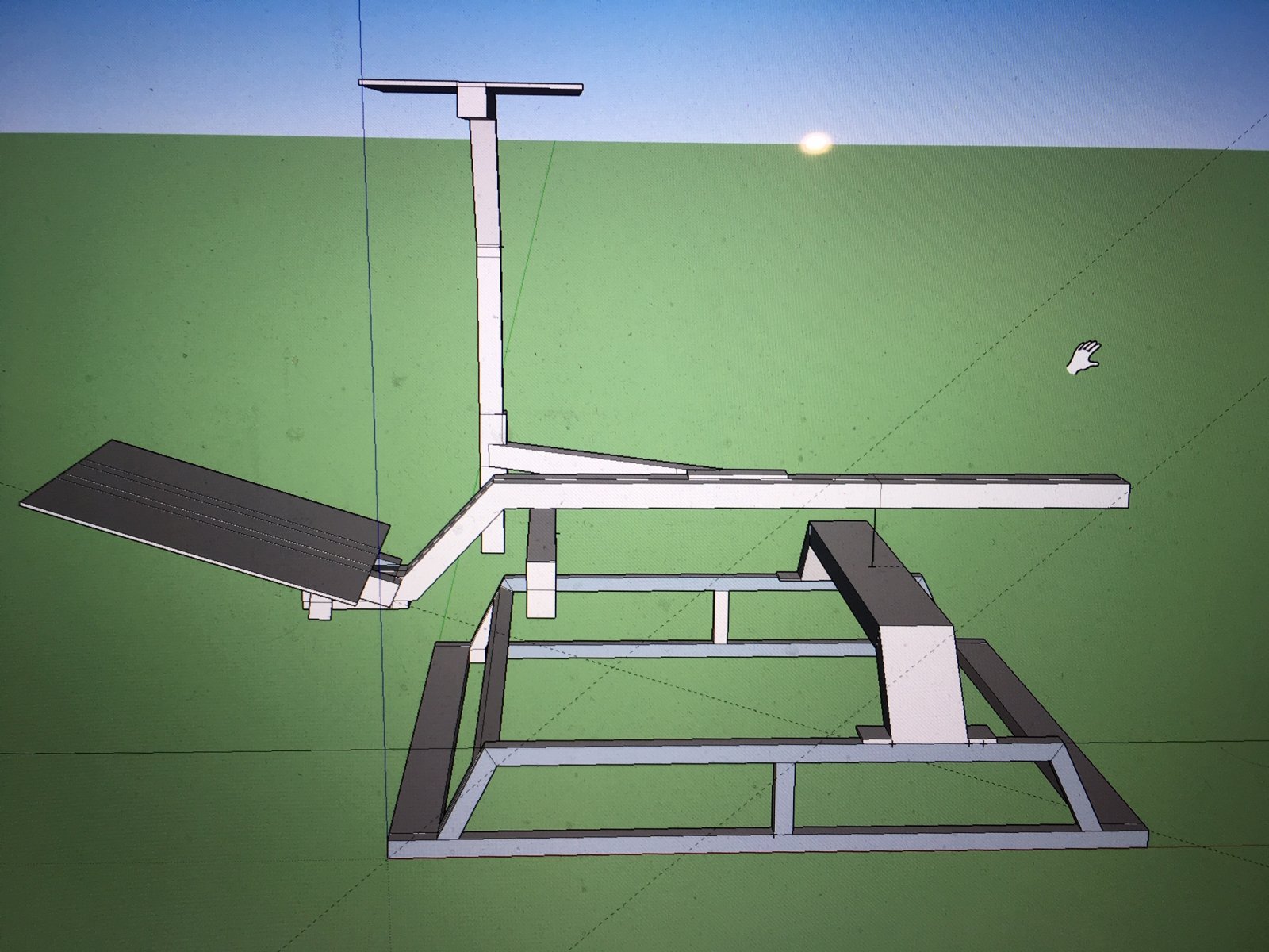

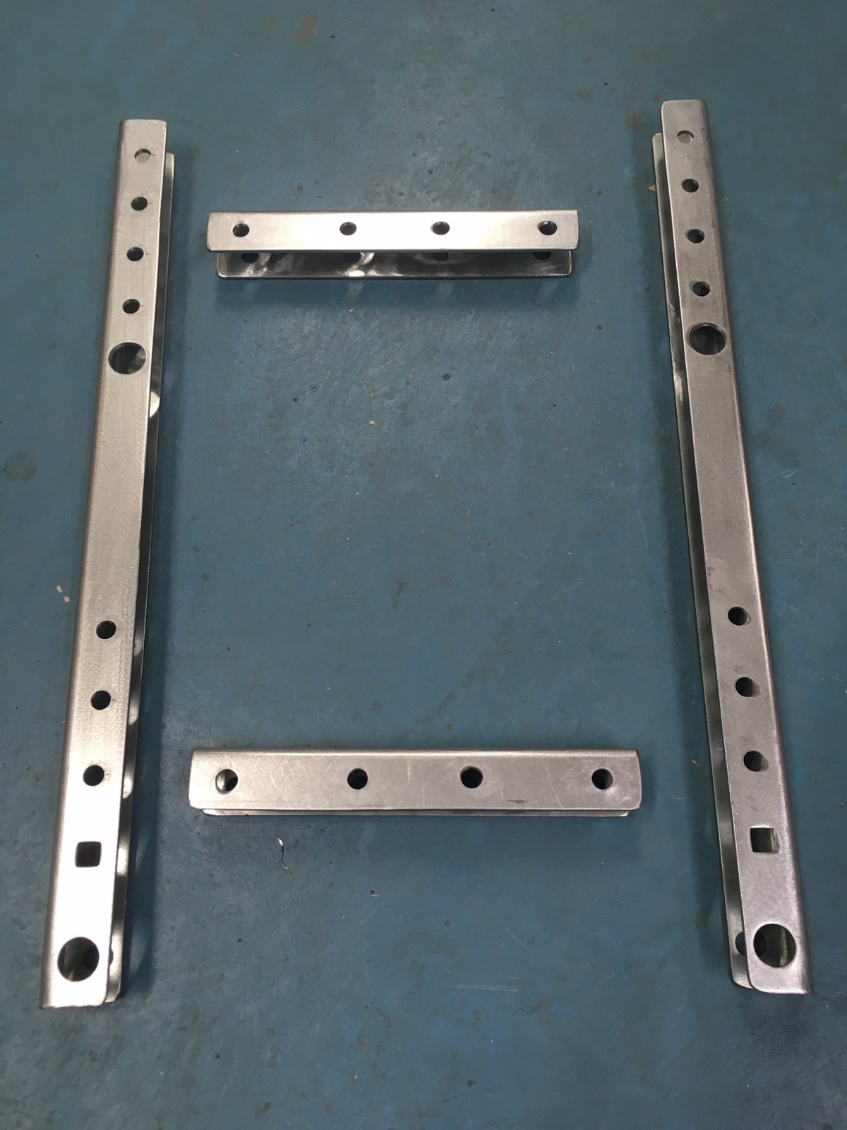

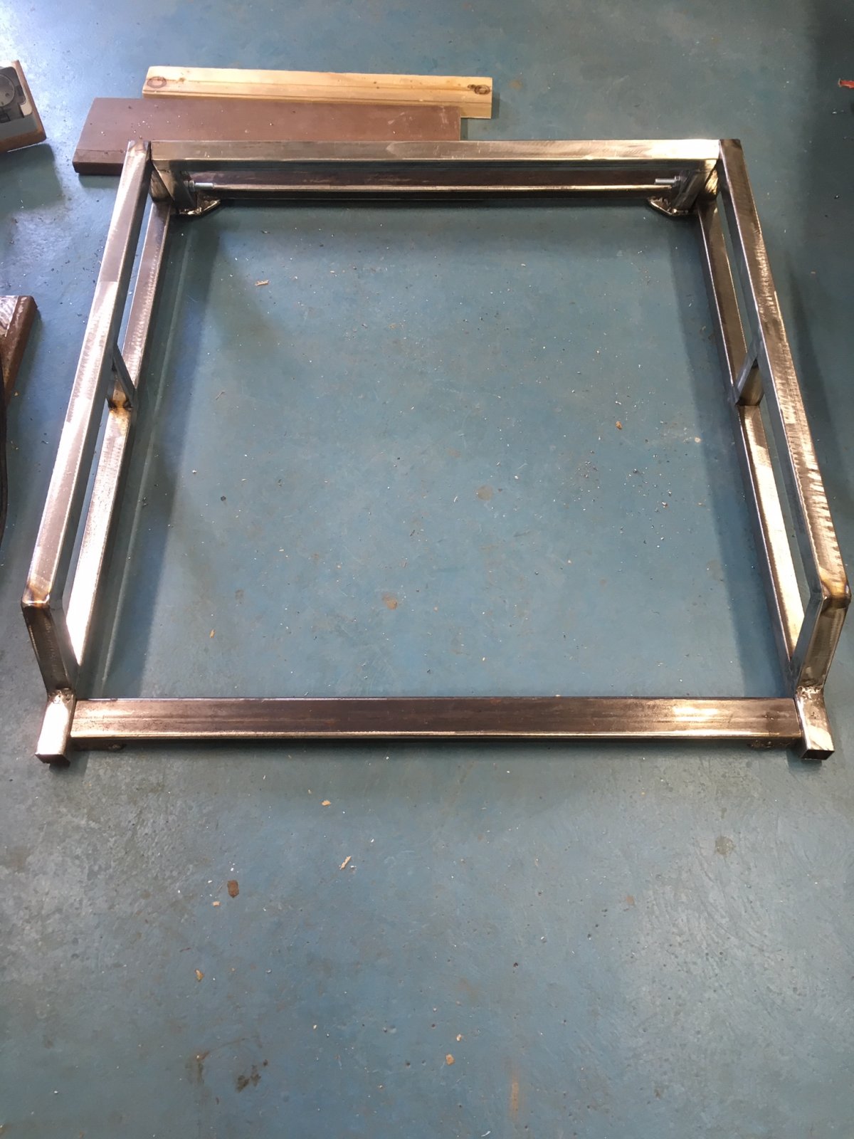

    Hi
    Begin to building my 2DOF. In my view, the structure should be compact and demountable. Having looked through many options drawing it in a sketchup.

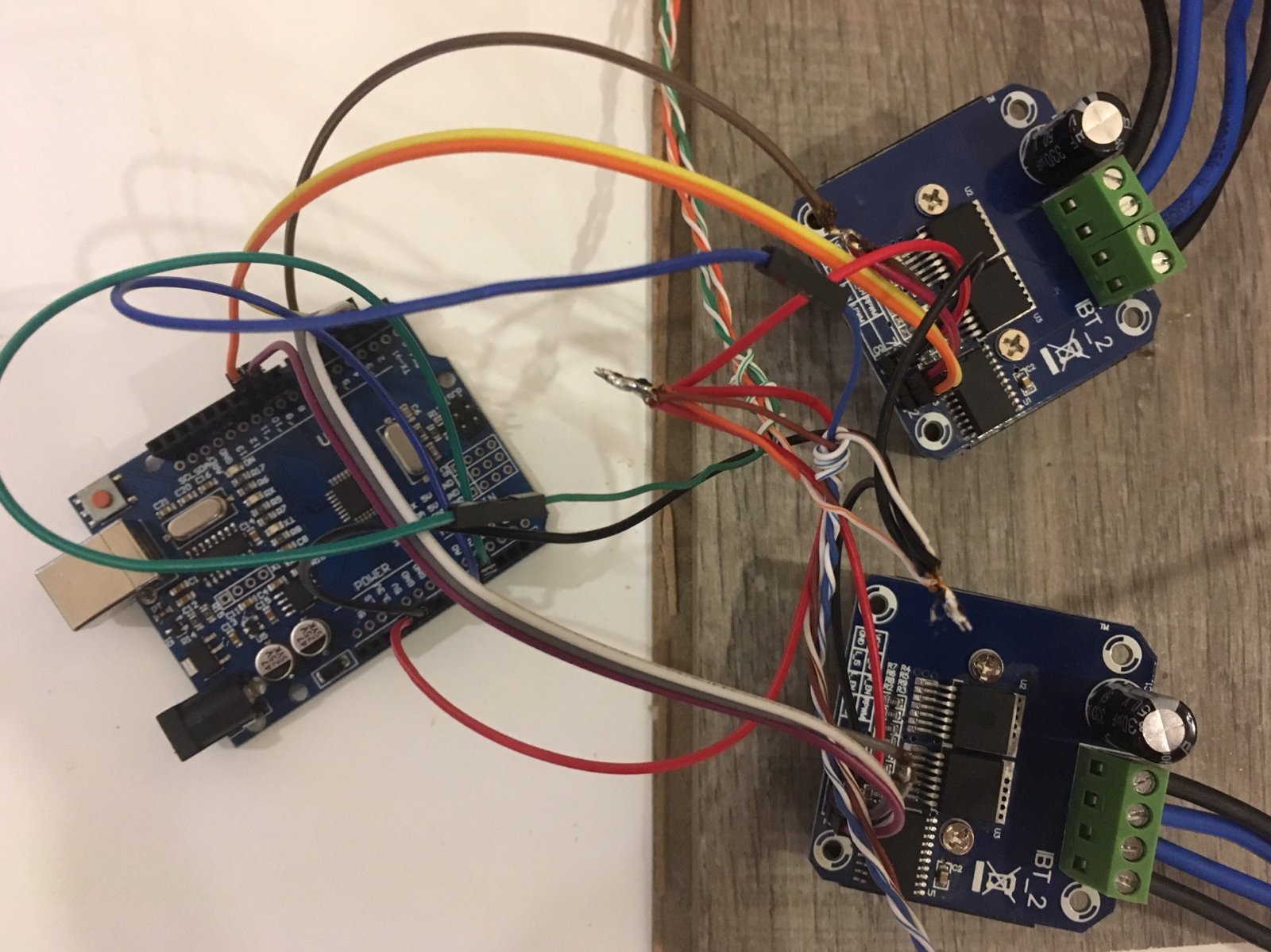

    - 98Coins

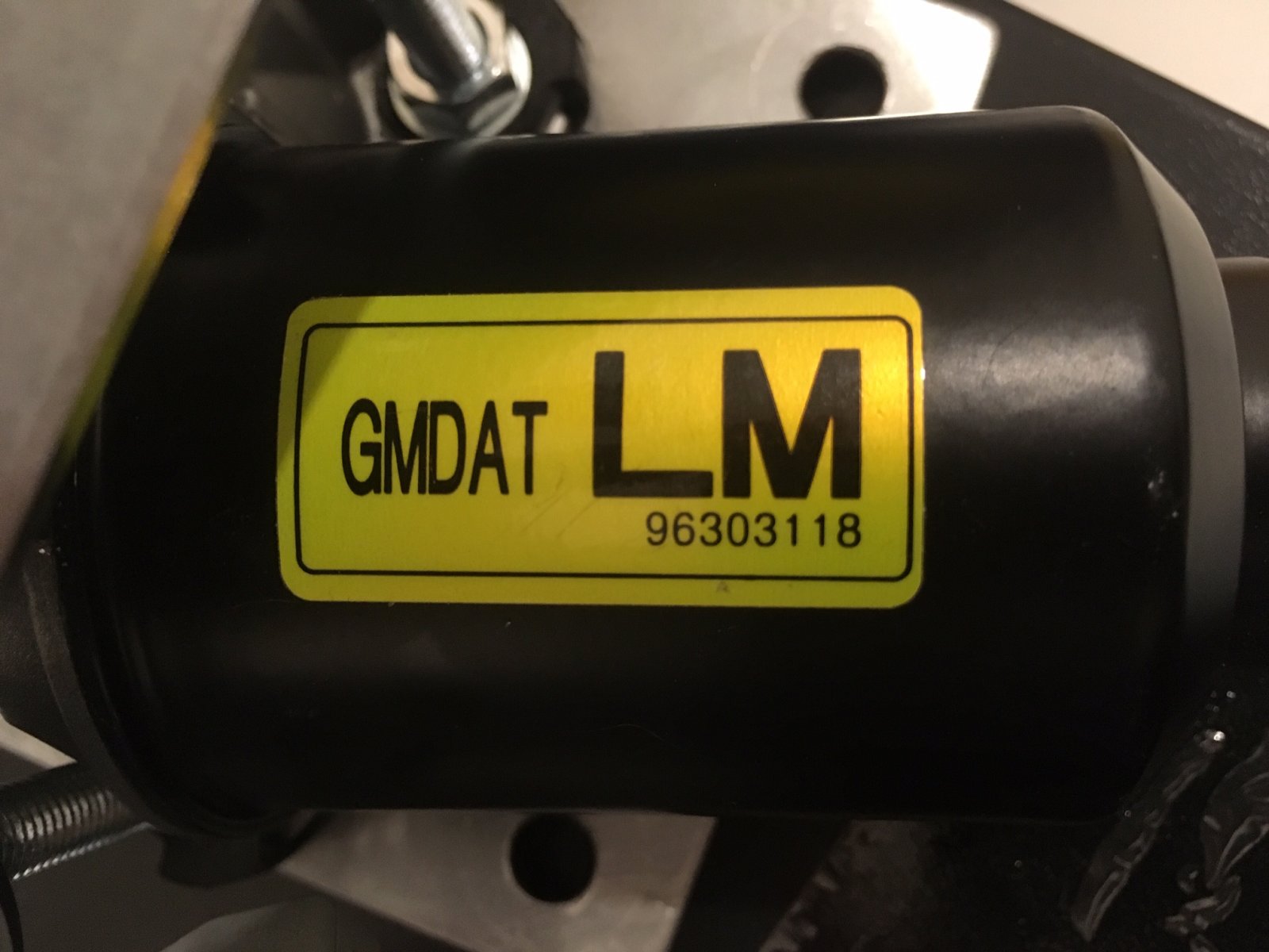

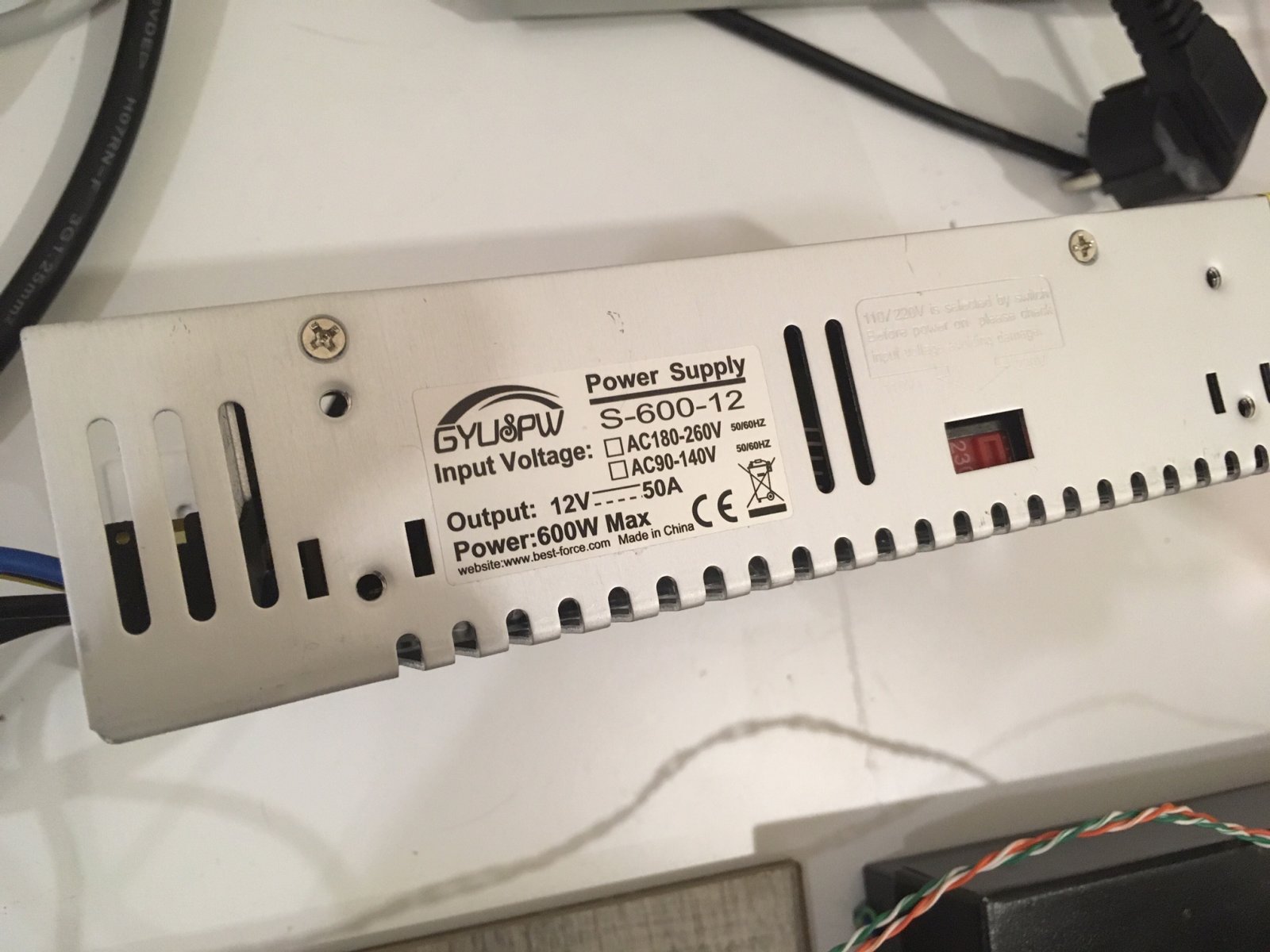

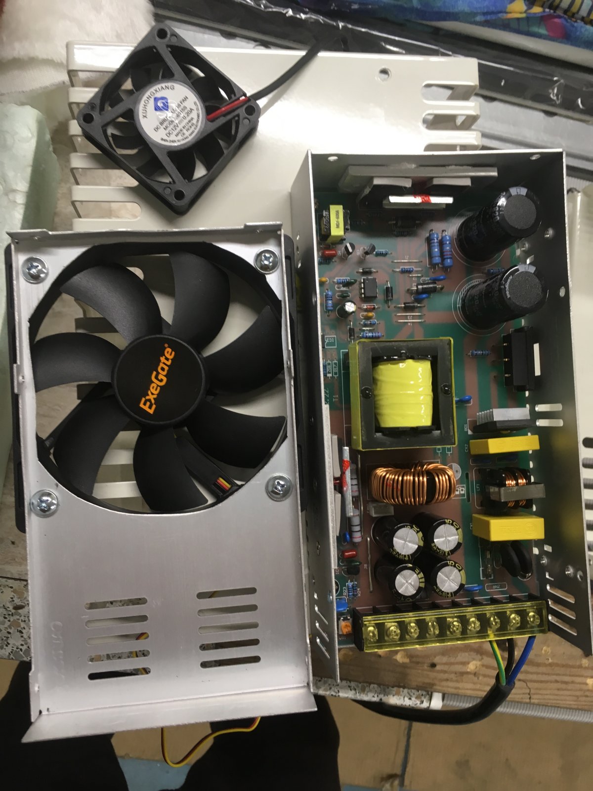

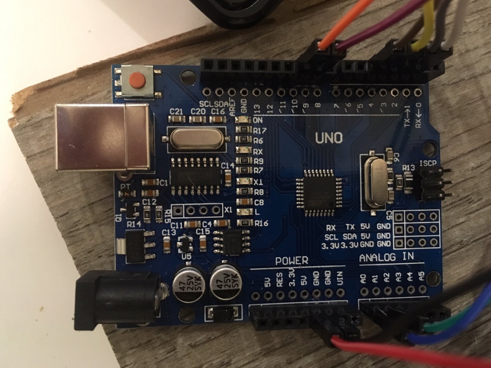

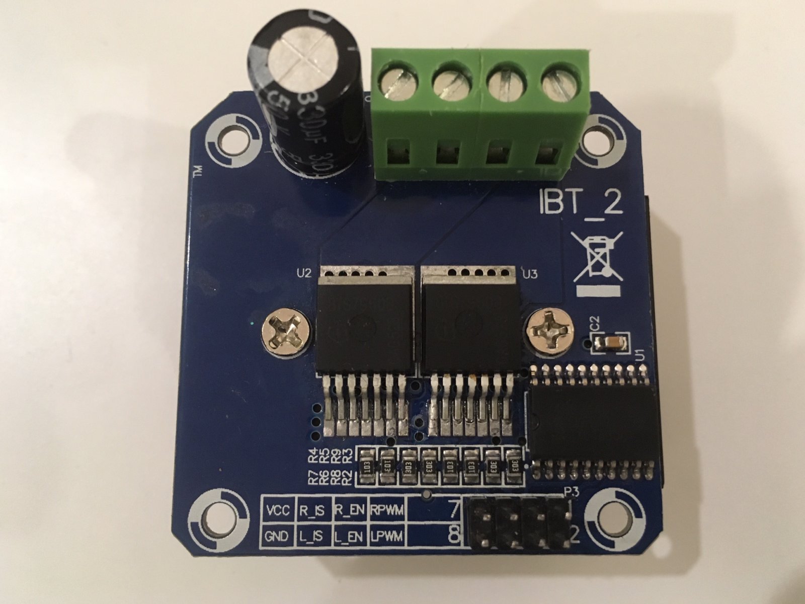

    Standart components:
    Arduino Uno x1
    Driver IBT-2 x2
    Power supply 12V 50A x1
    Gear Motors GM96303118 x2
    small components
    I really hope that the power of the motors will be enough for this project, the main thing is to balanced the weight.

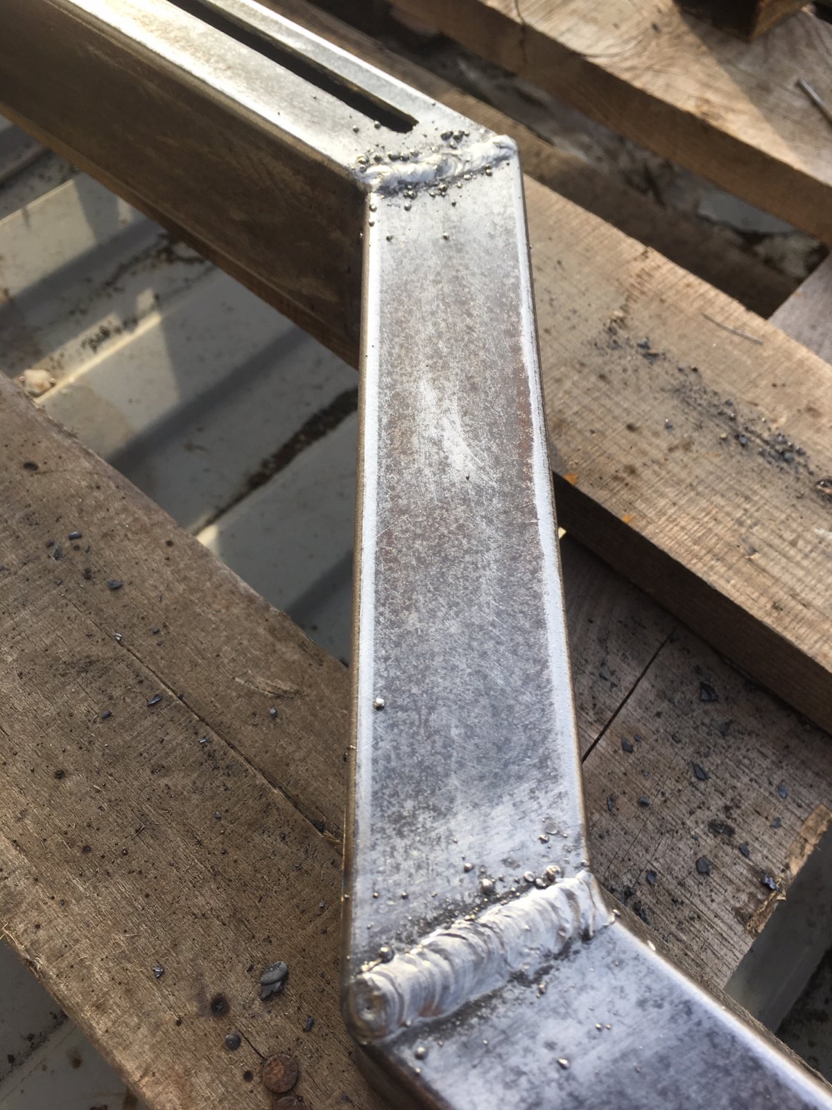

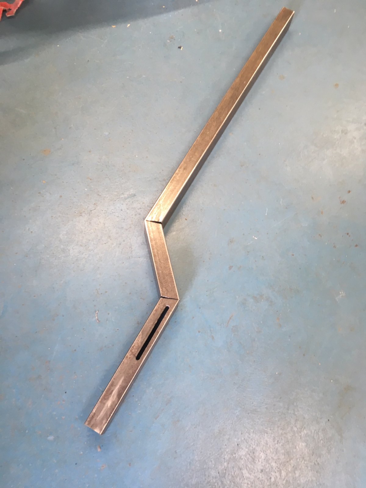

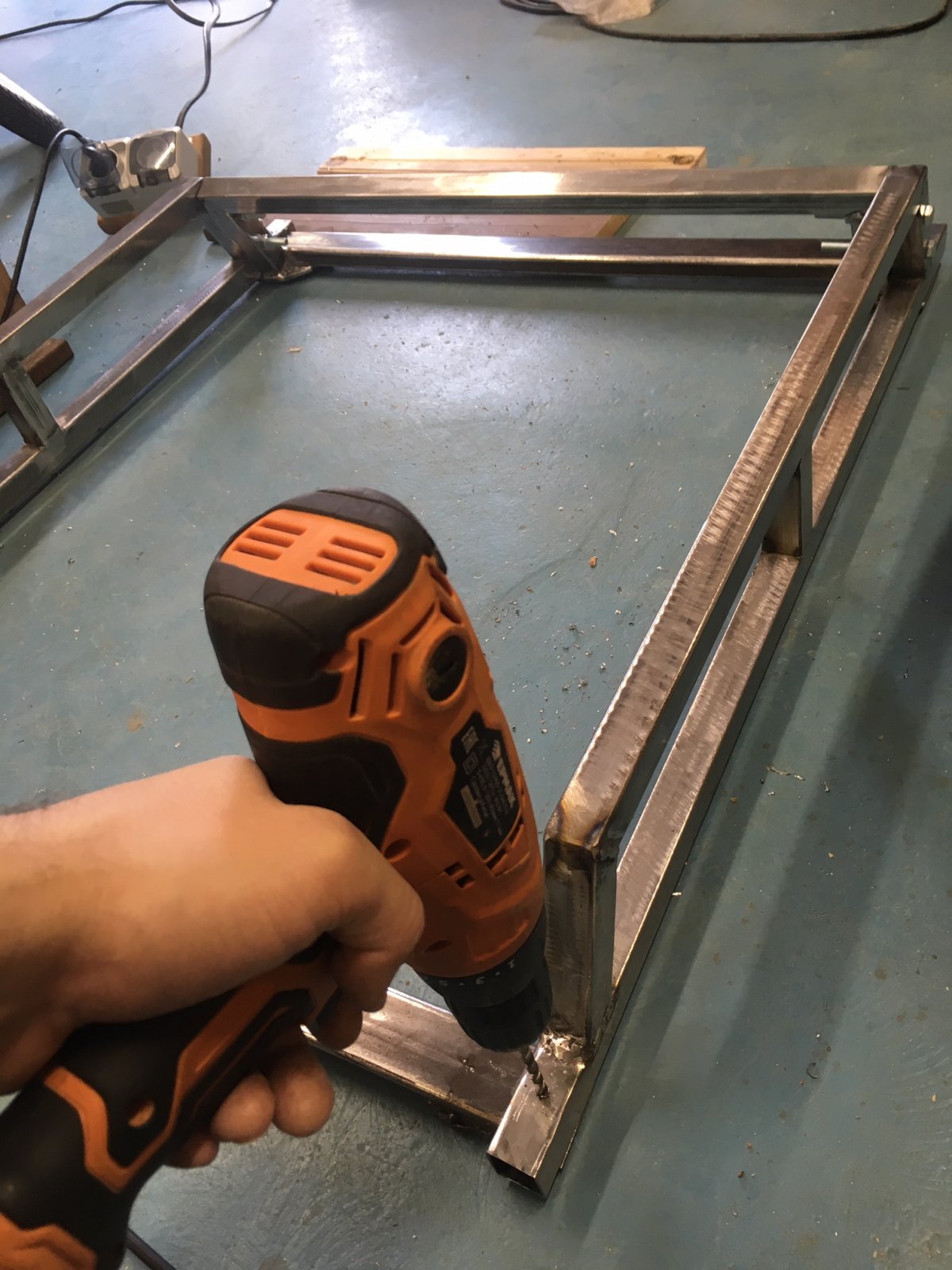

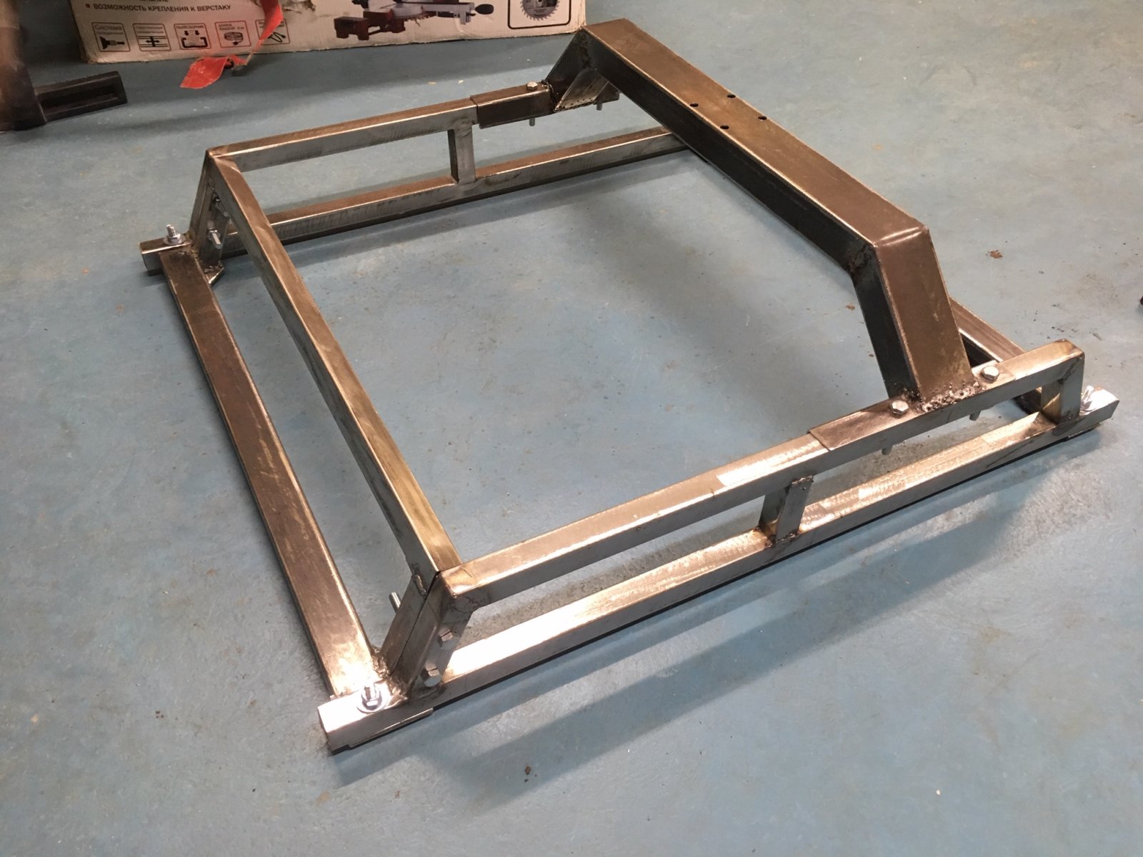

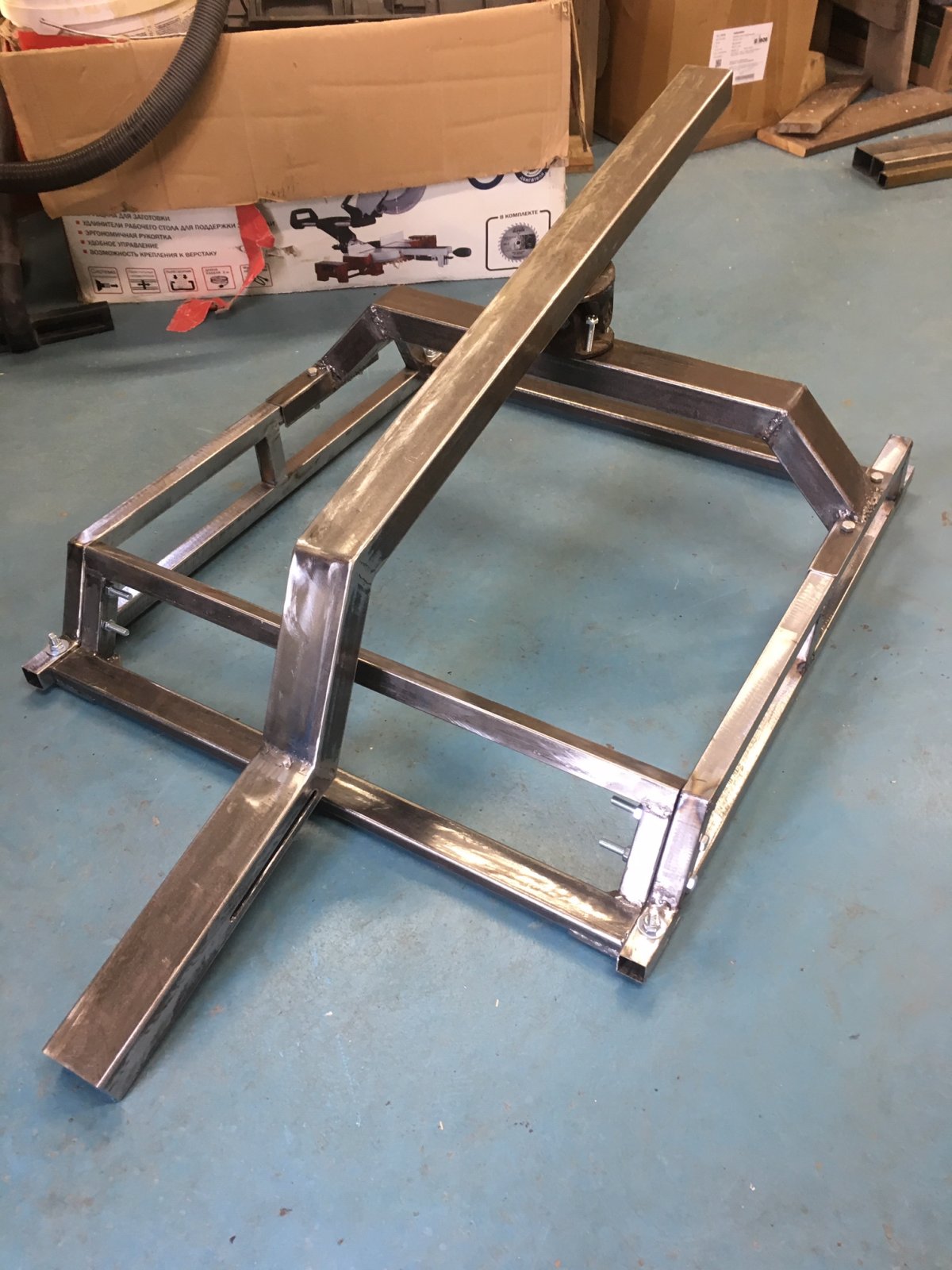

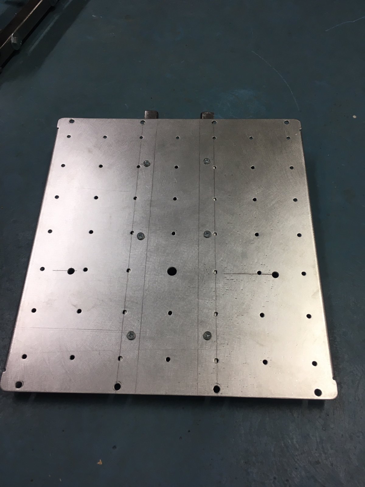

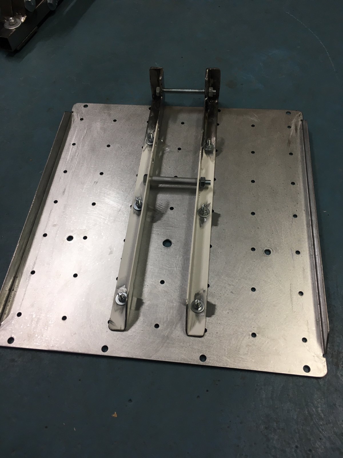

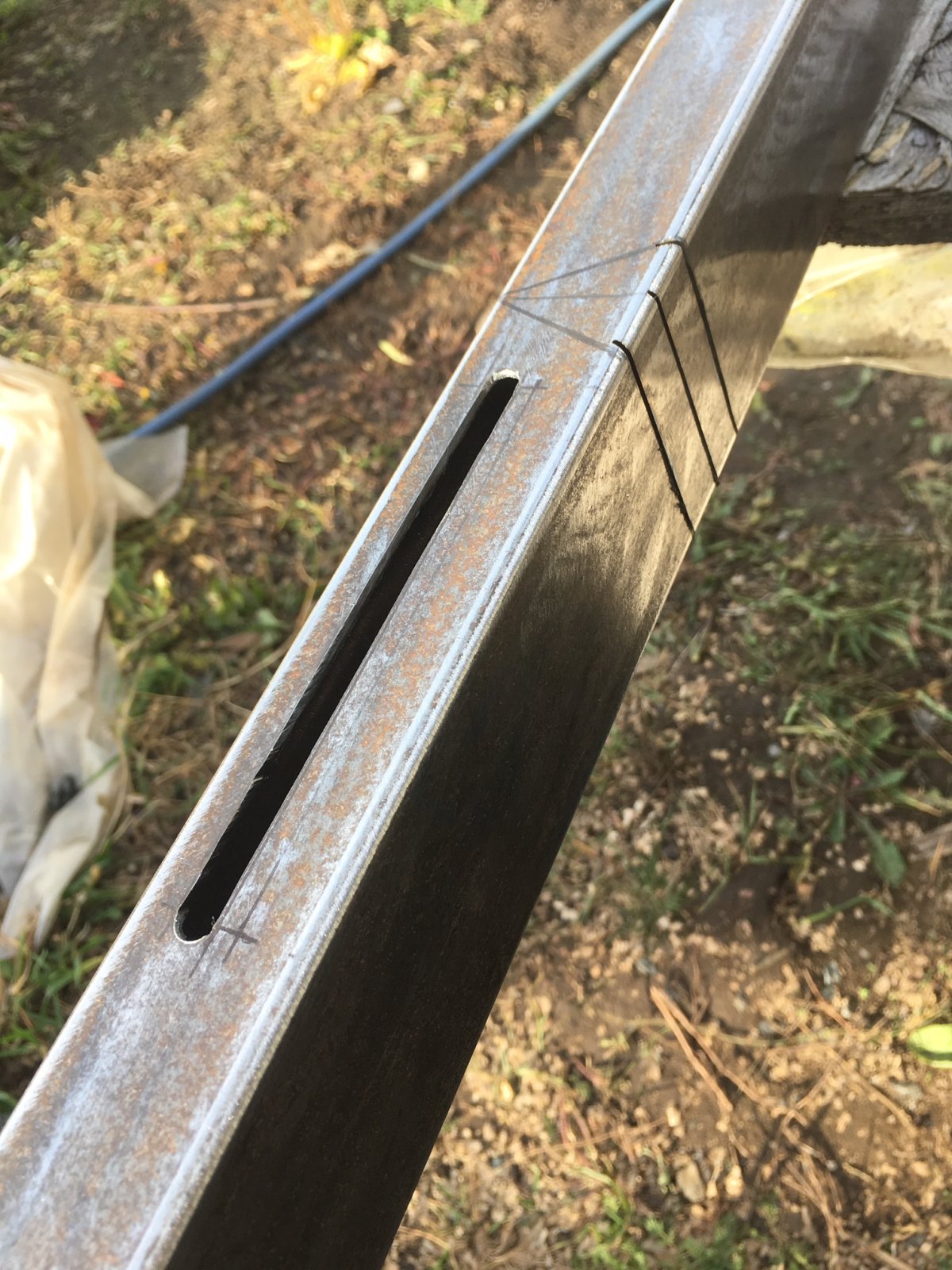

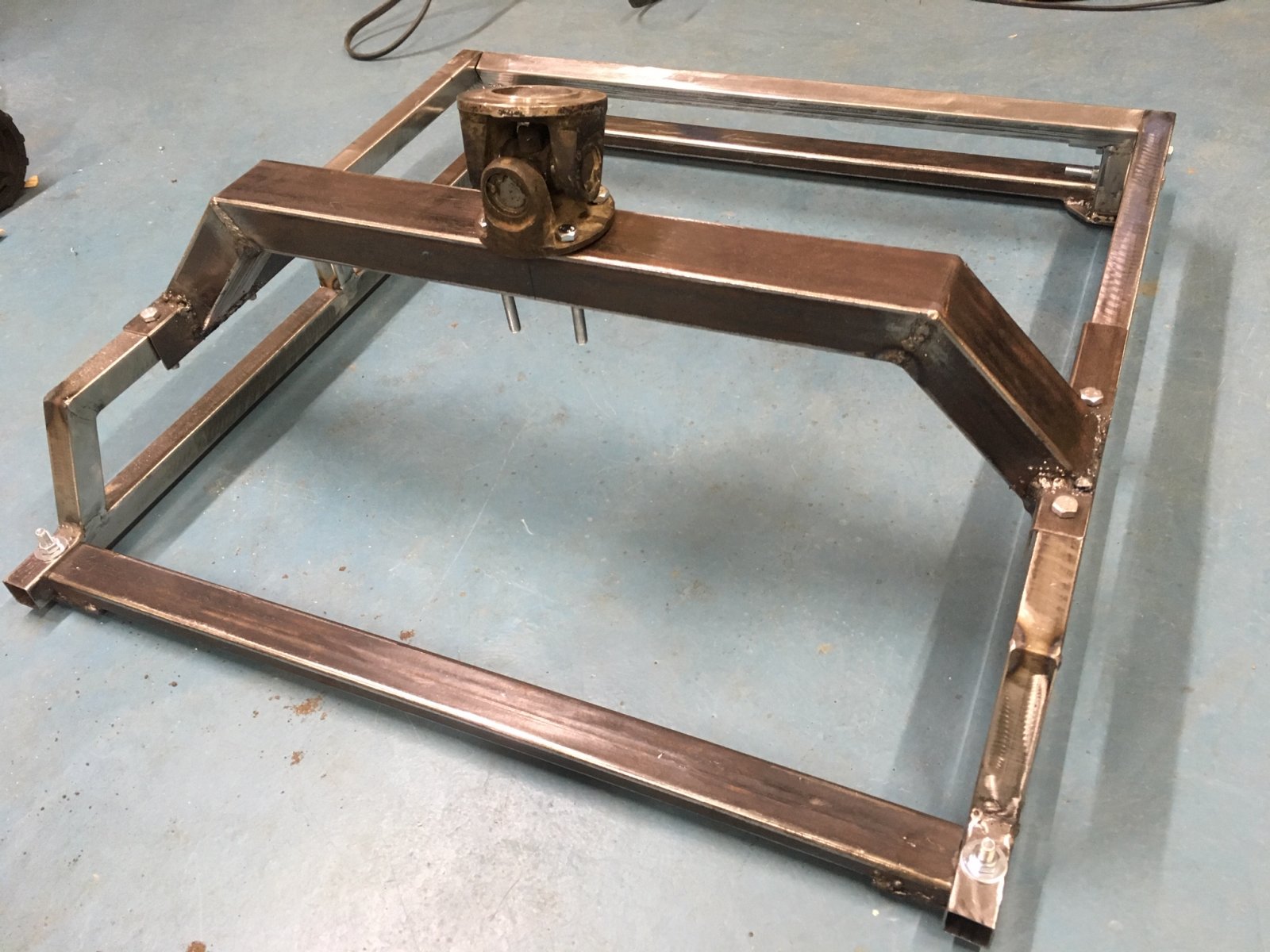

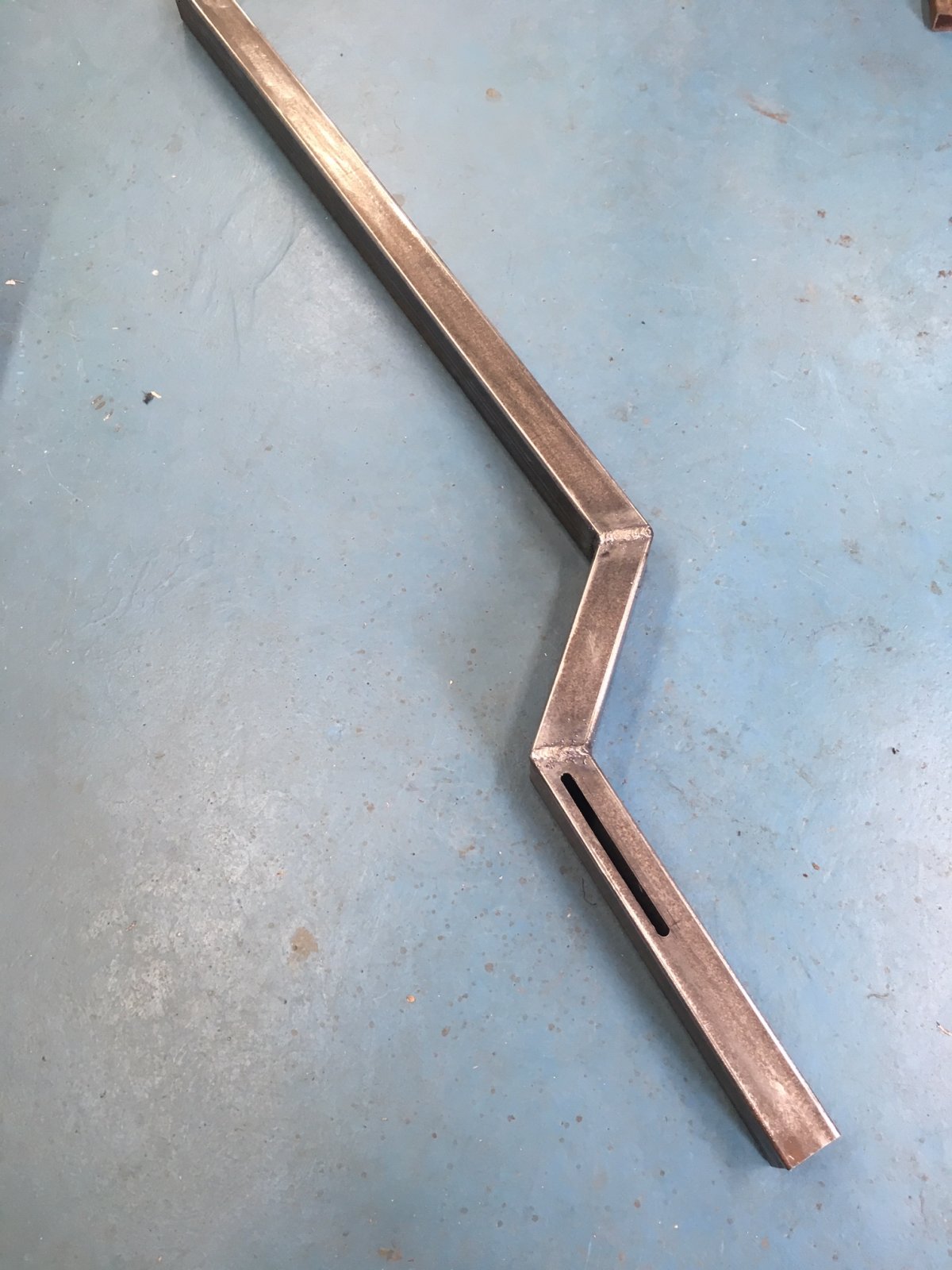

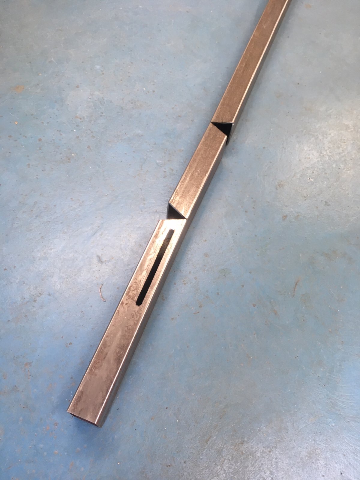

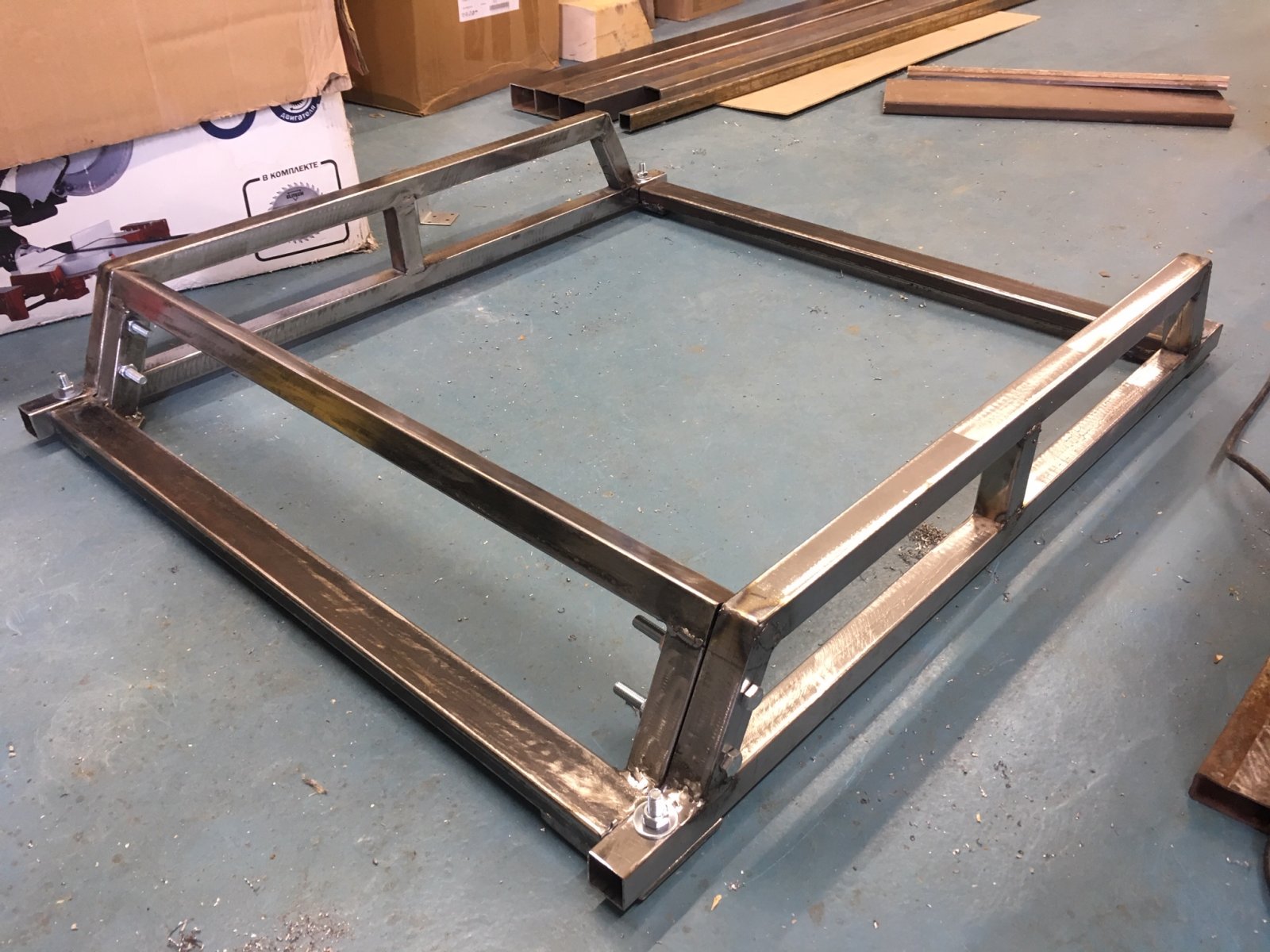

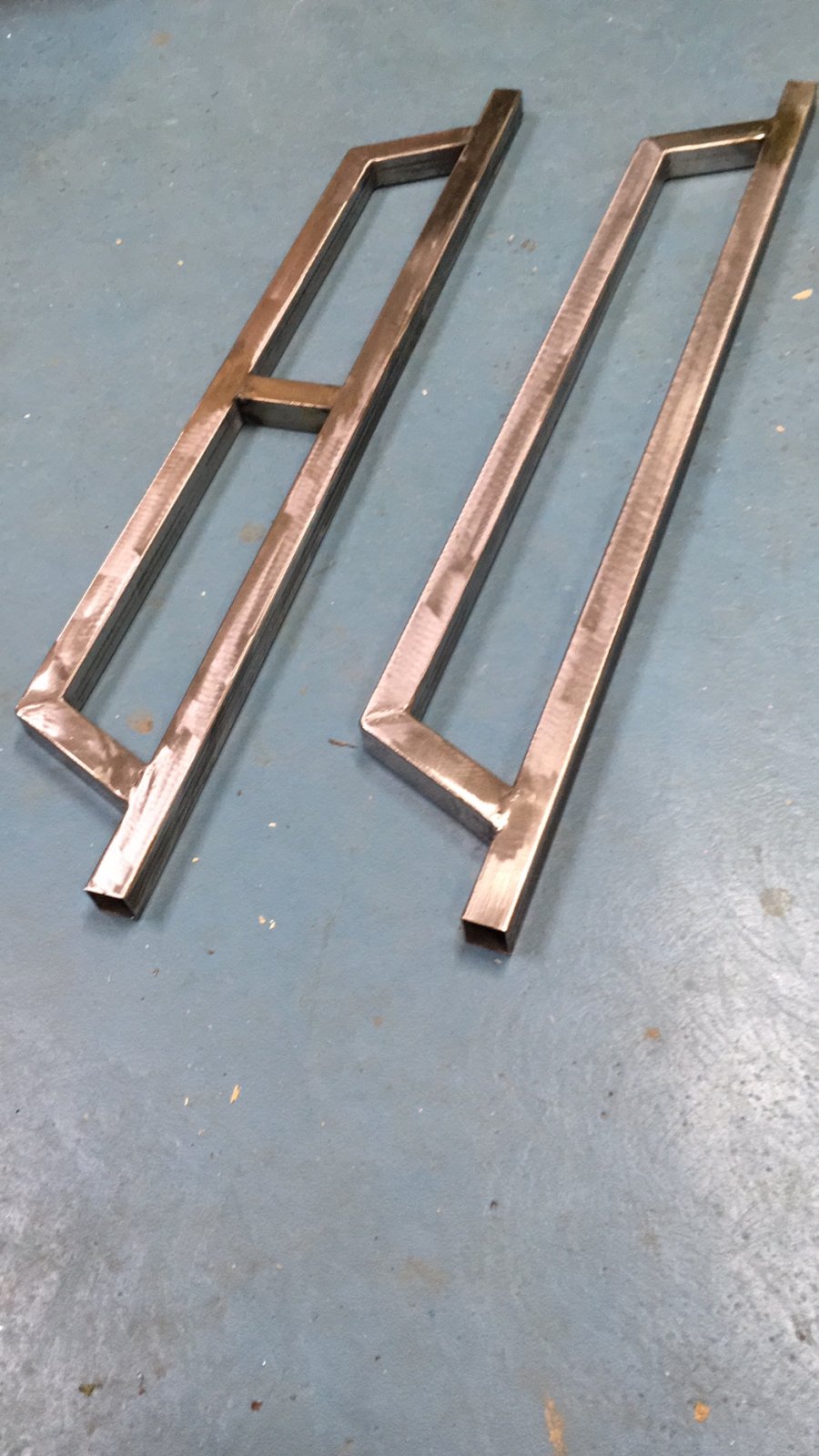

    Progress today:
  4. quq404
    quq404 New Member
    Jan 18, 2018
    27
    Russia, Yekaterinburg
    - 98Coins
    +15 / 0 / -0

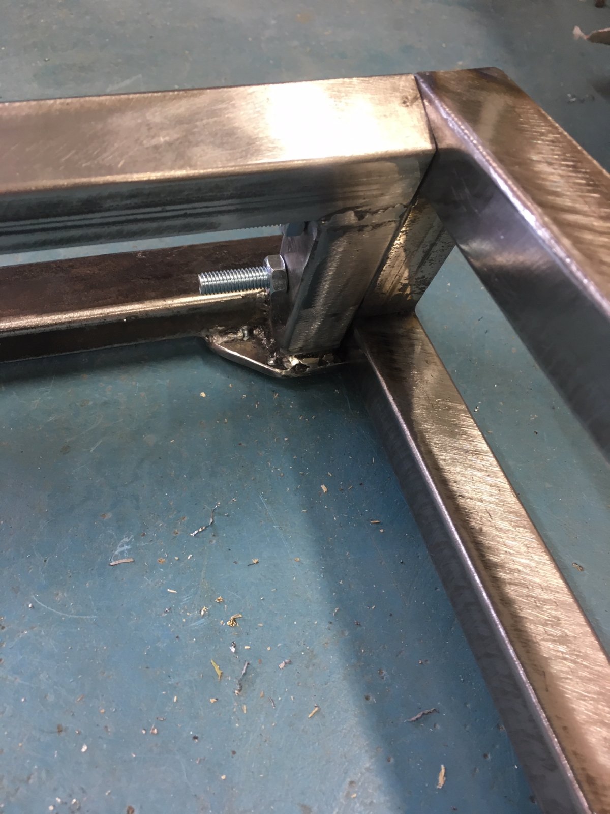

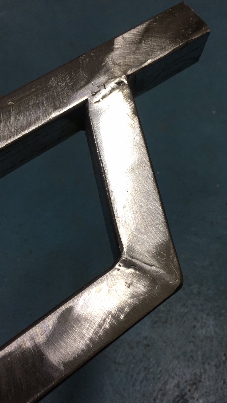

    Oops! The first size error. We'll have to redo it :)
  5. absyfadhel1
    absyfadhel1 Member
    Oct 19, 2017
    329
    bahrain
    442Coins
    +33 / 0 / -0
    In my build i got motor problem so you must be carefull for the (CTC) distance ( the rod size and position) .. i tryed many position then got the best movement but now i got temperature problem so you must do one of two ..change (CTC ) distance or get more powerful motor like (Worm gear motor, Wheel
    chair motor or truck wiper motor.. Hope its help and just wait for (@noorbeast) he will advice you the best

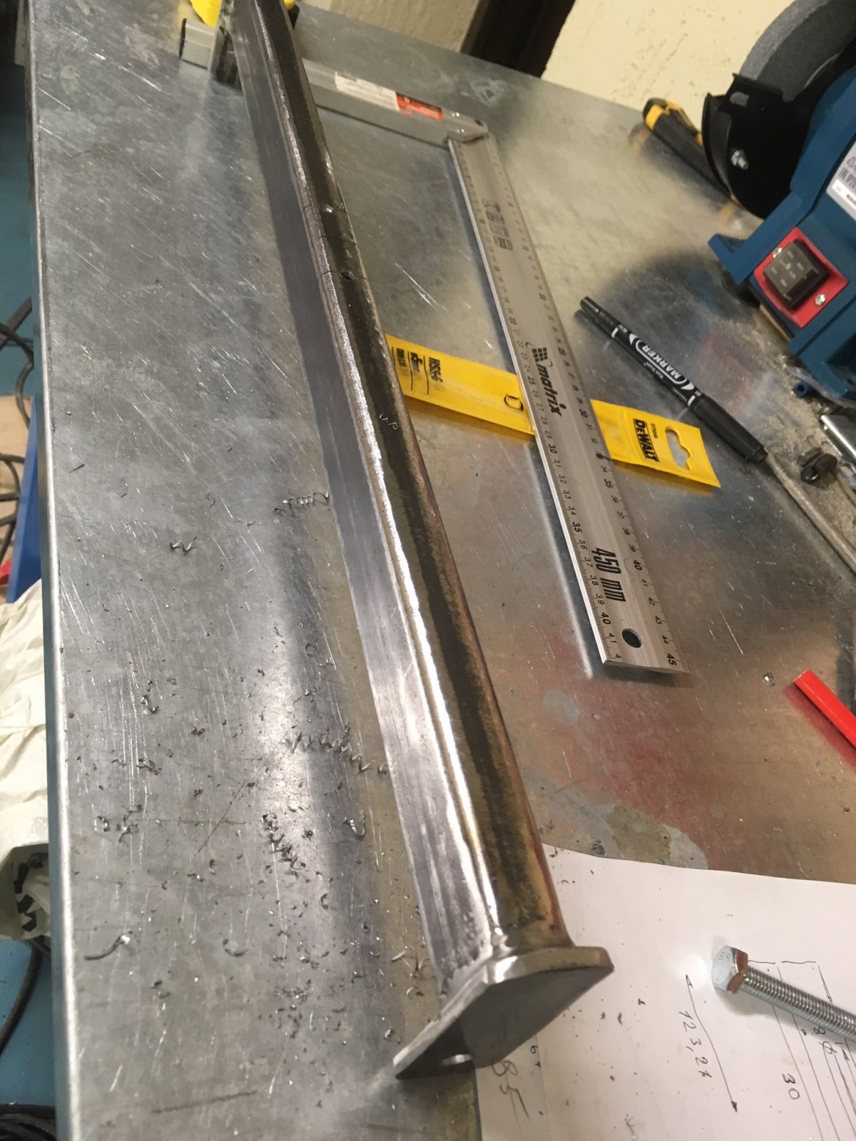

  7. quq404
    quq404 New Member
    Jan 18, 2018
    27
    - 98Coins
    +15 / 0 / -0

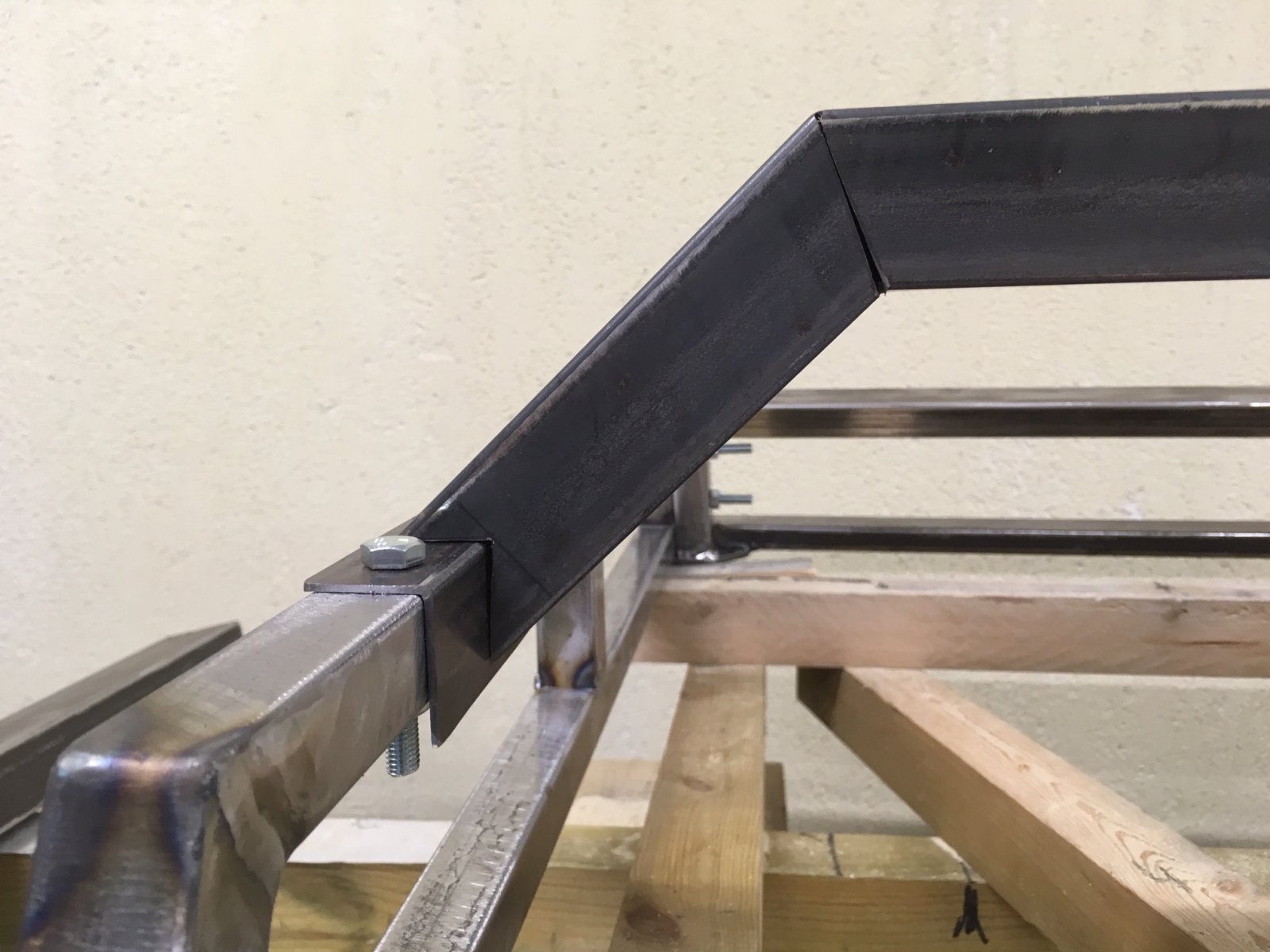

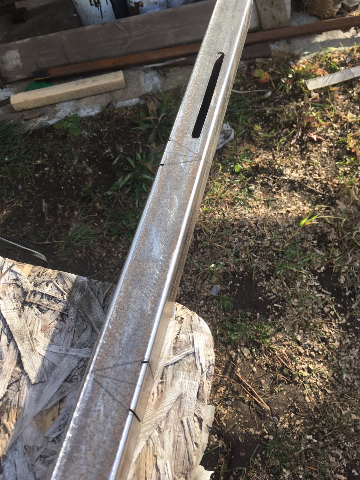

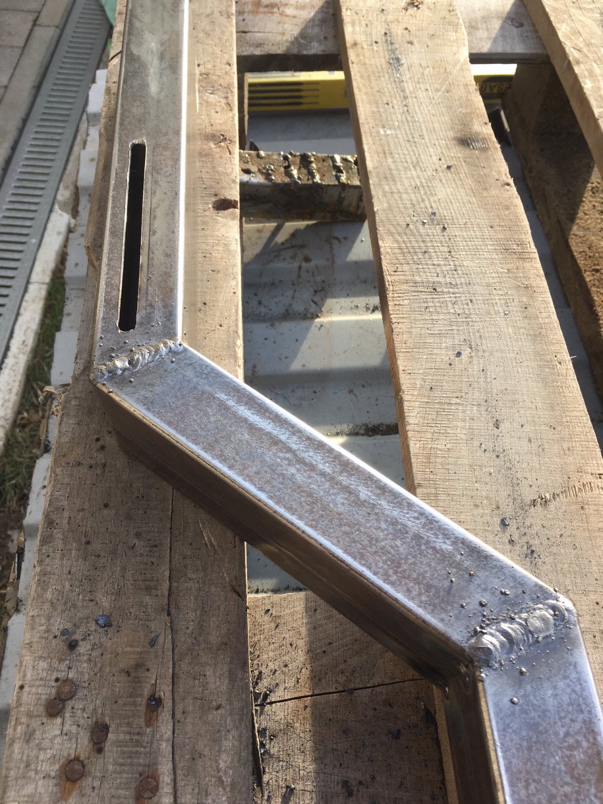

    fixed:

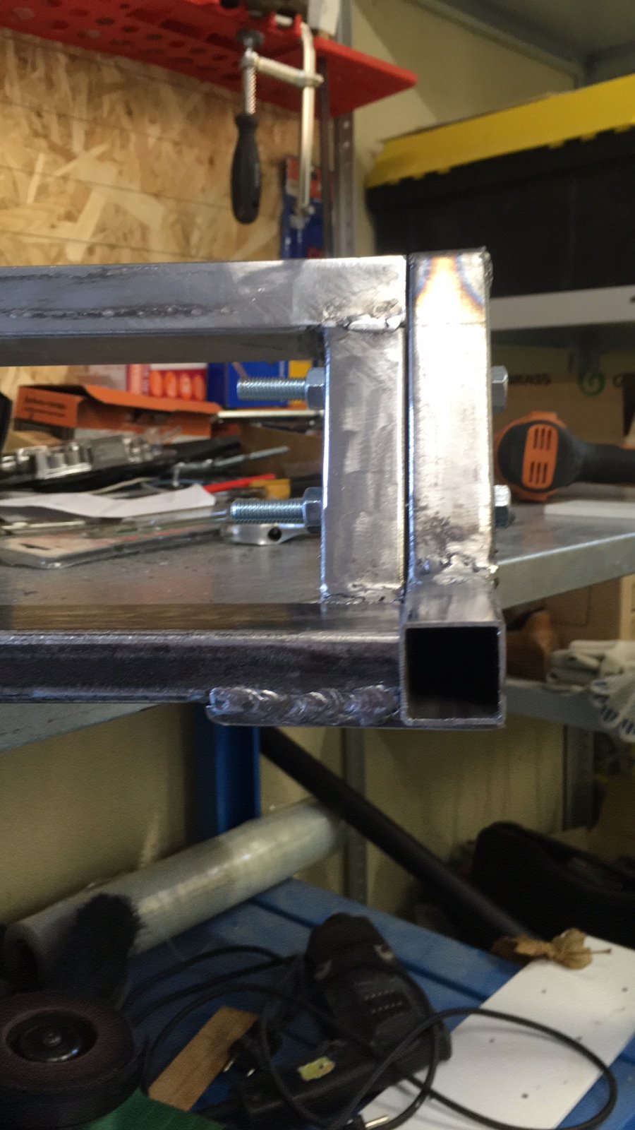

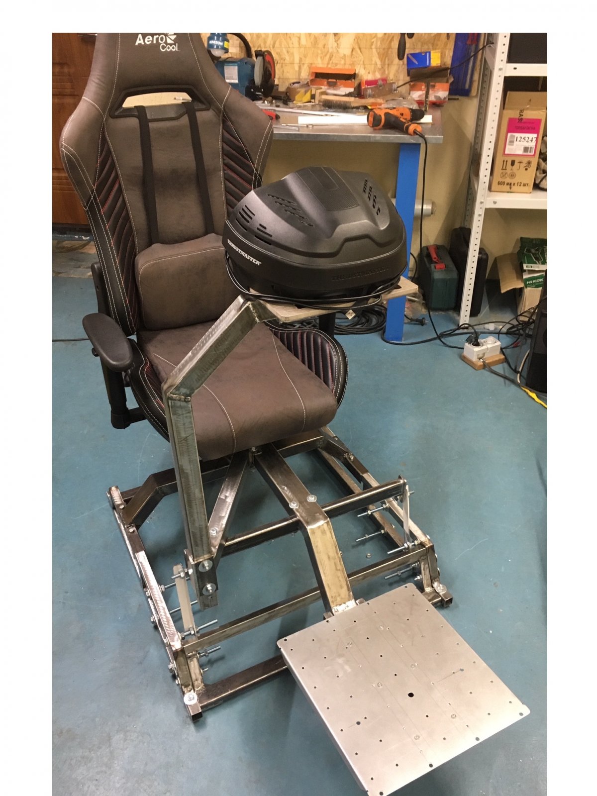

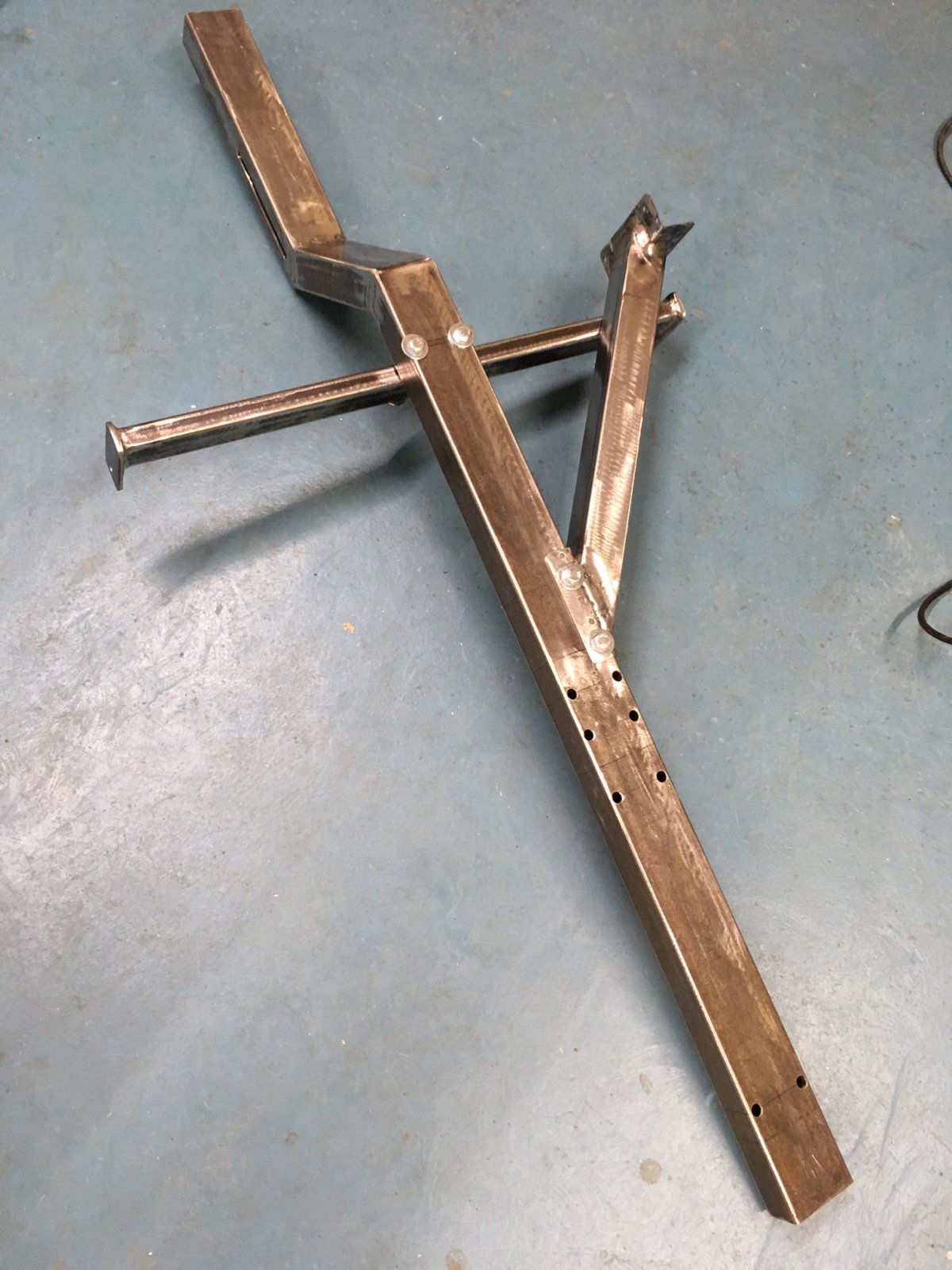

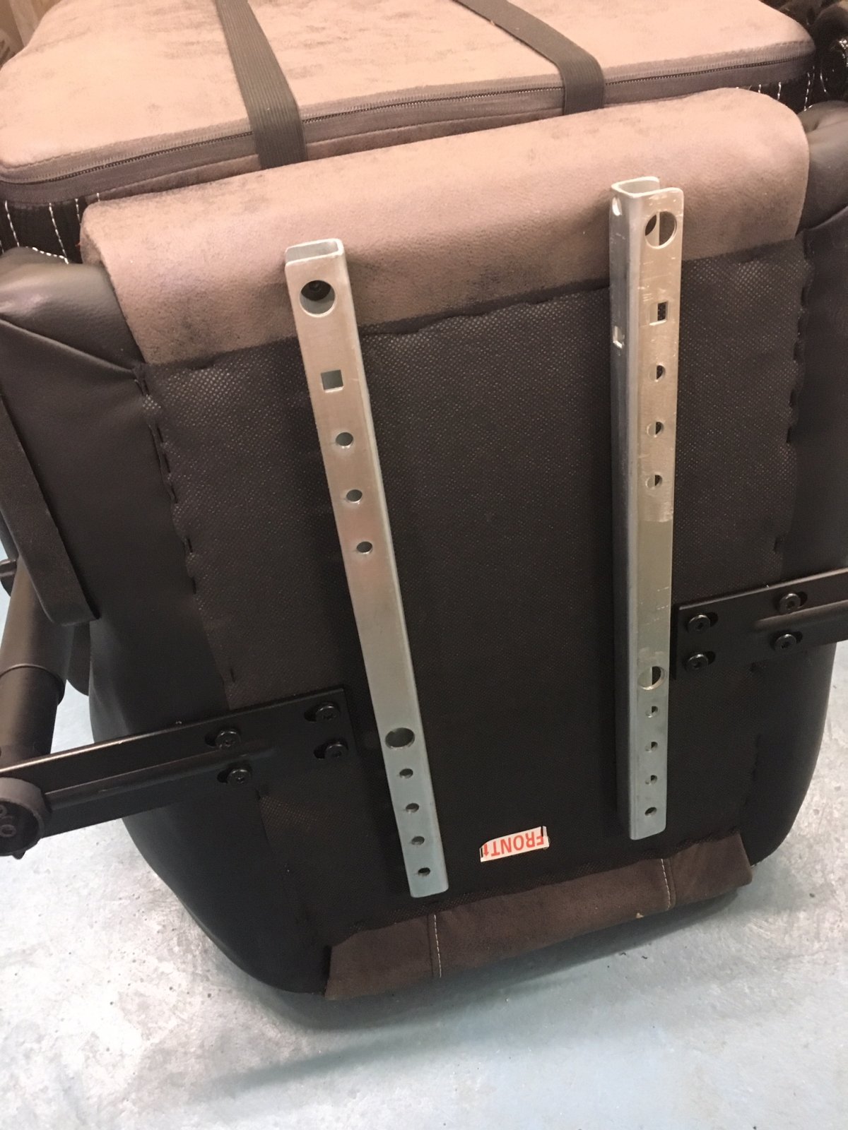

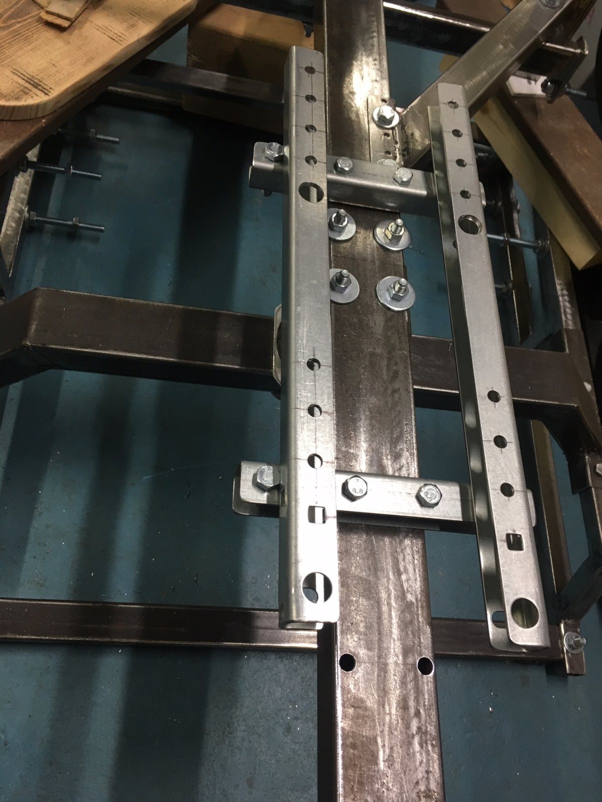

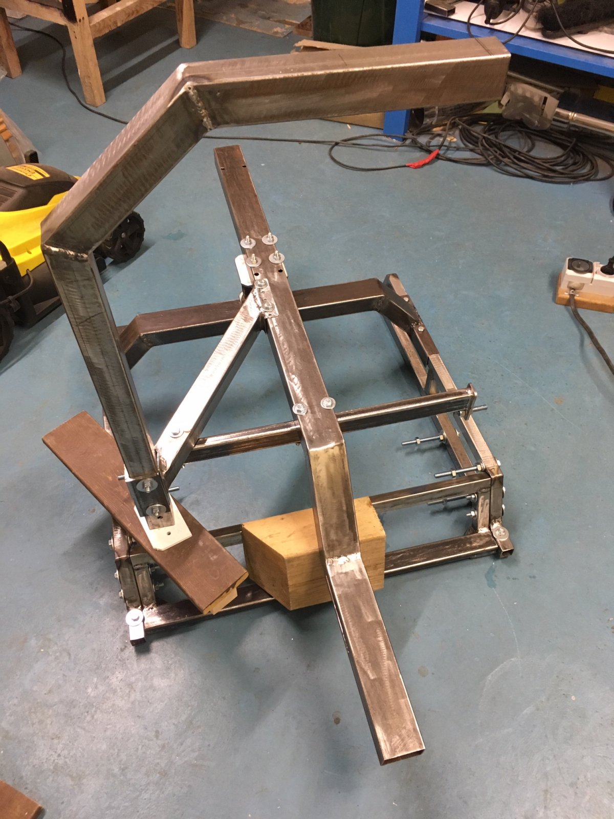

    Now need to securely fix the driver's seat:

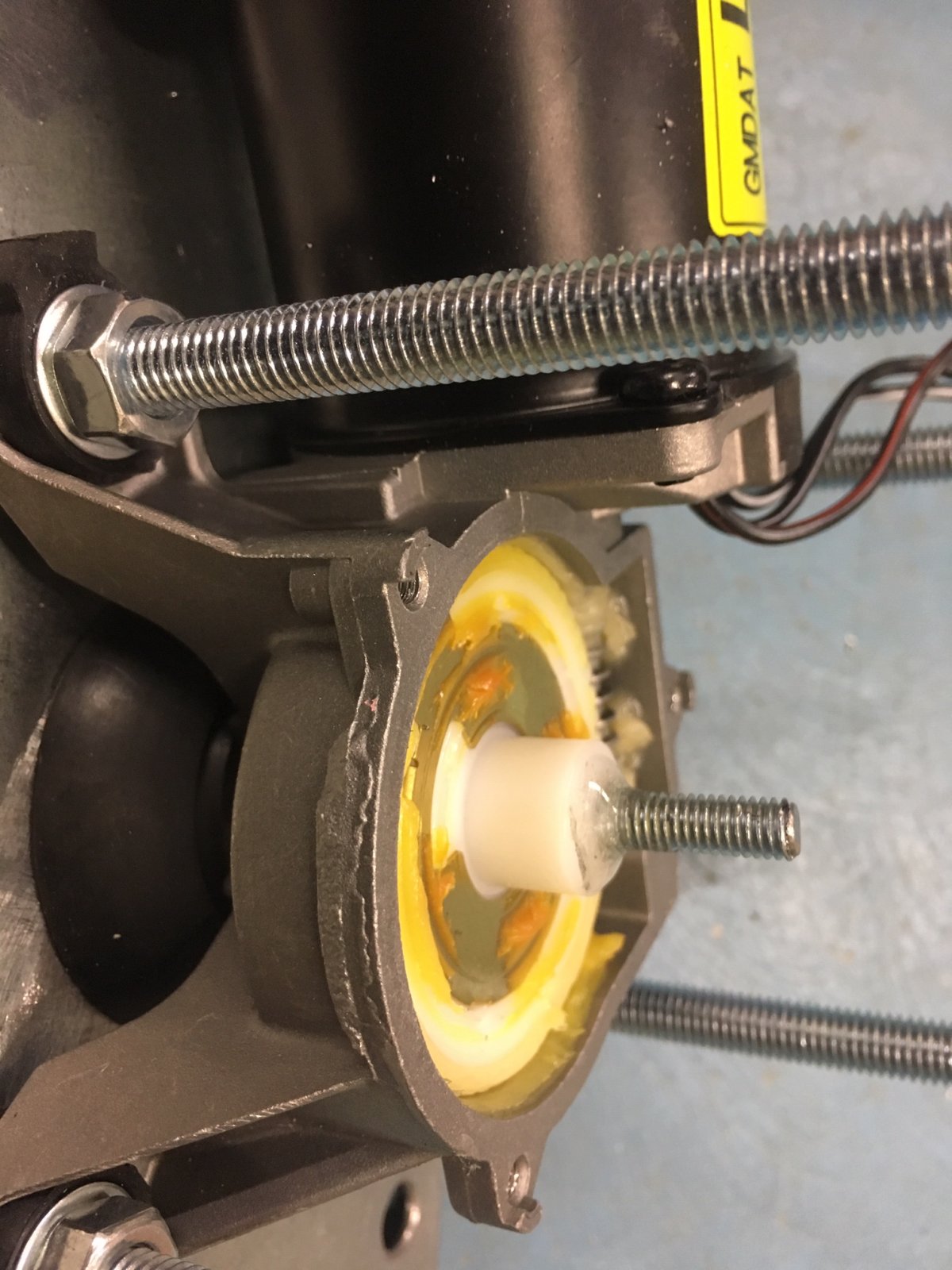

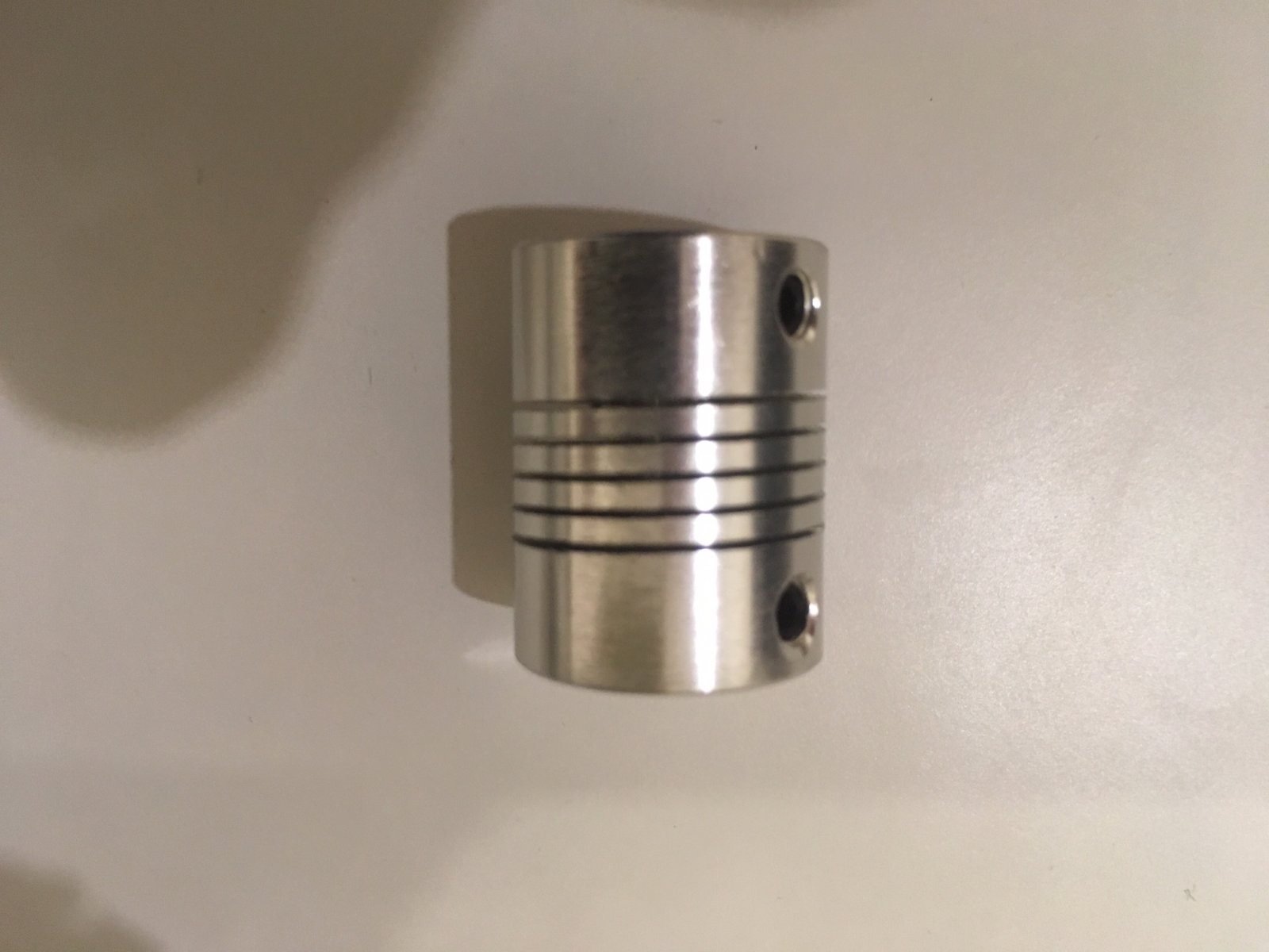

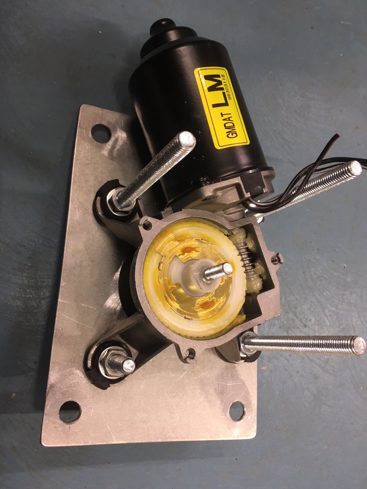

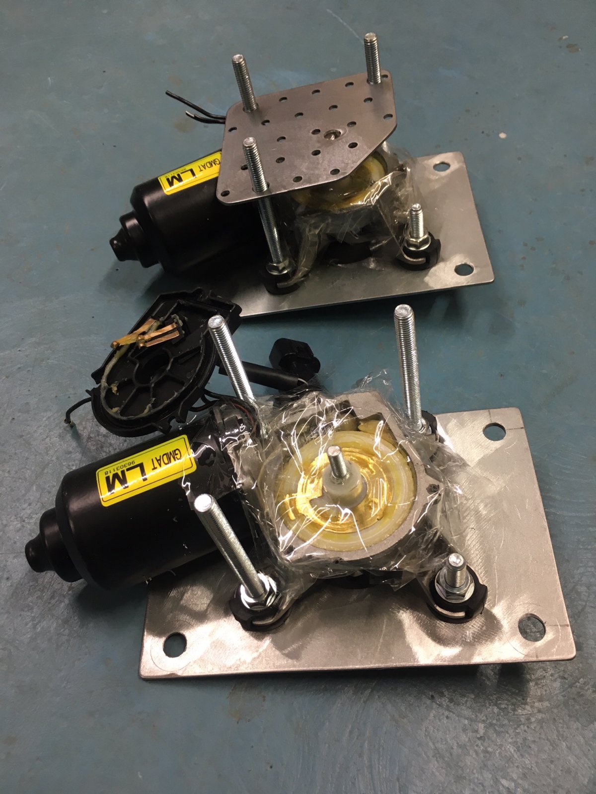

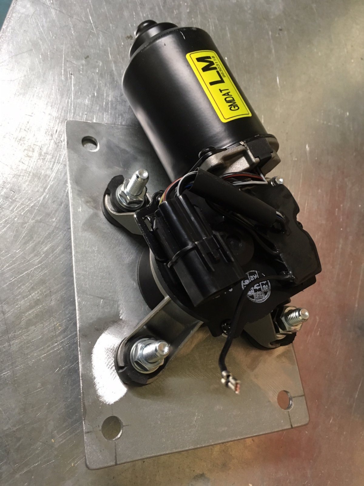

    Tuning motor gear:

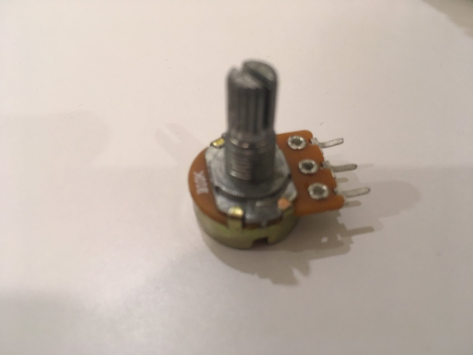

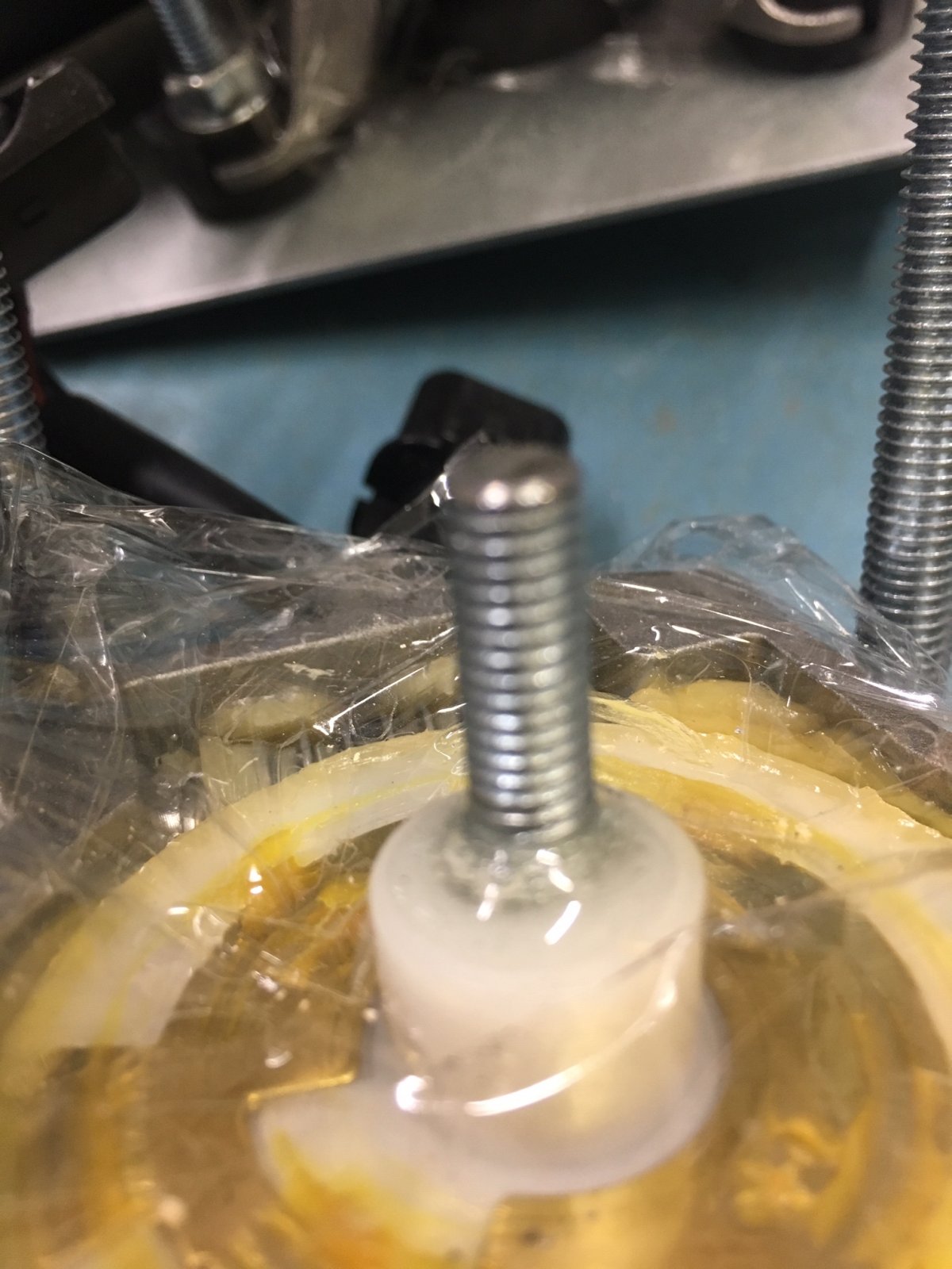

    Fixed studs М6 by epoxy glue for connection with potentiometer:

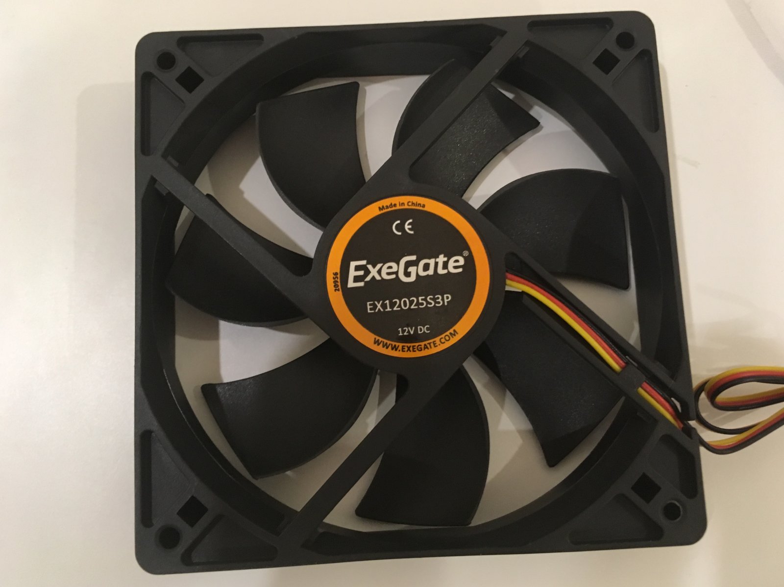

    I like silence :)

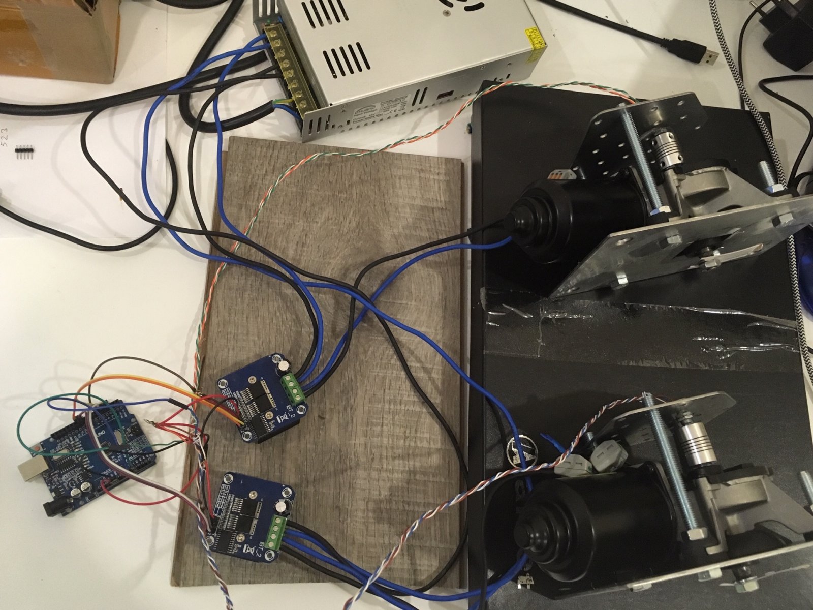

    First testing:

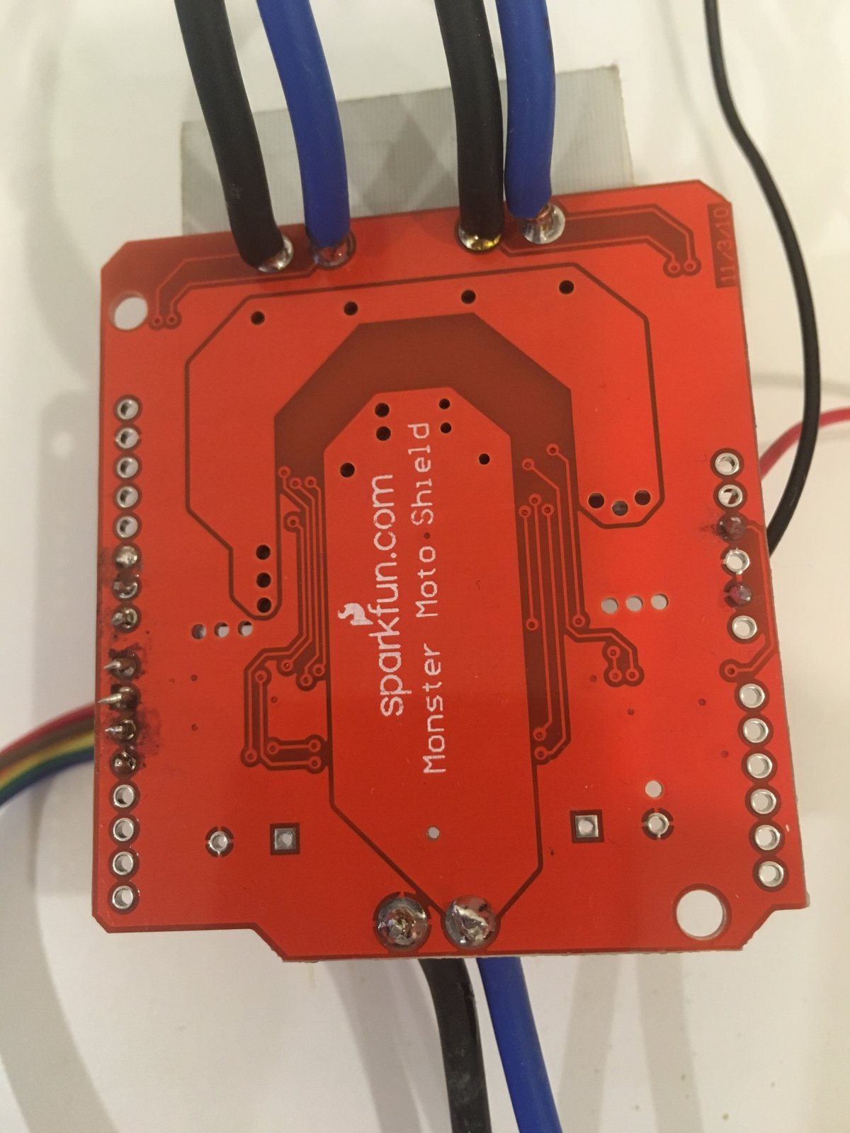

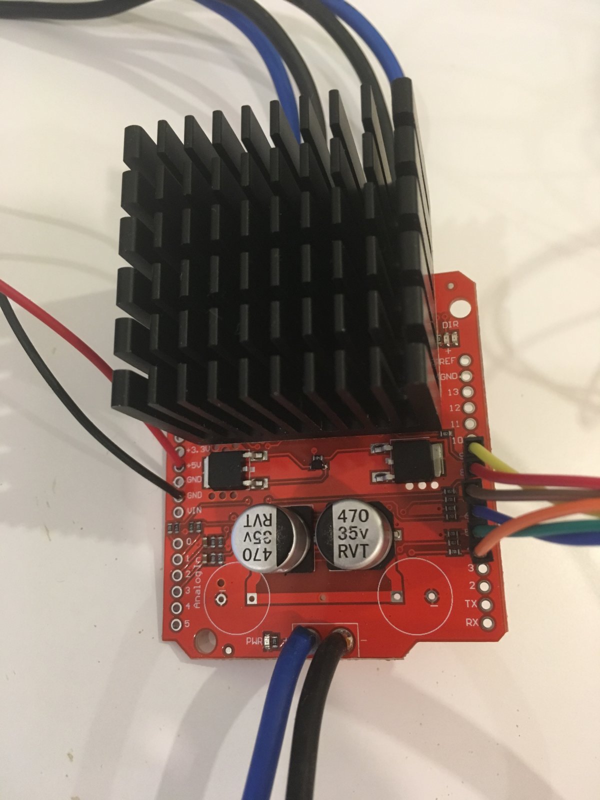

    I wanted to use "monster motor shield", but that worked with errors. The left engine was not moving well. The problem turned out to be the "monster motor shield", it was defective. The left channel only gave out 6 volts.

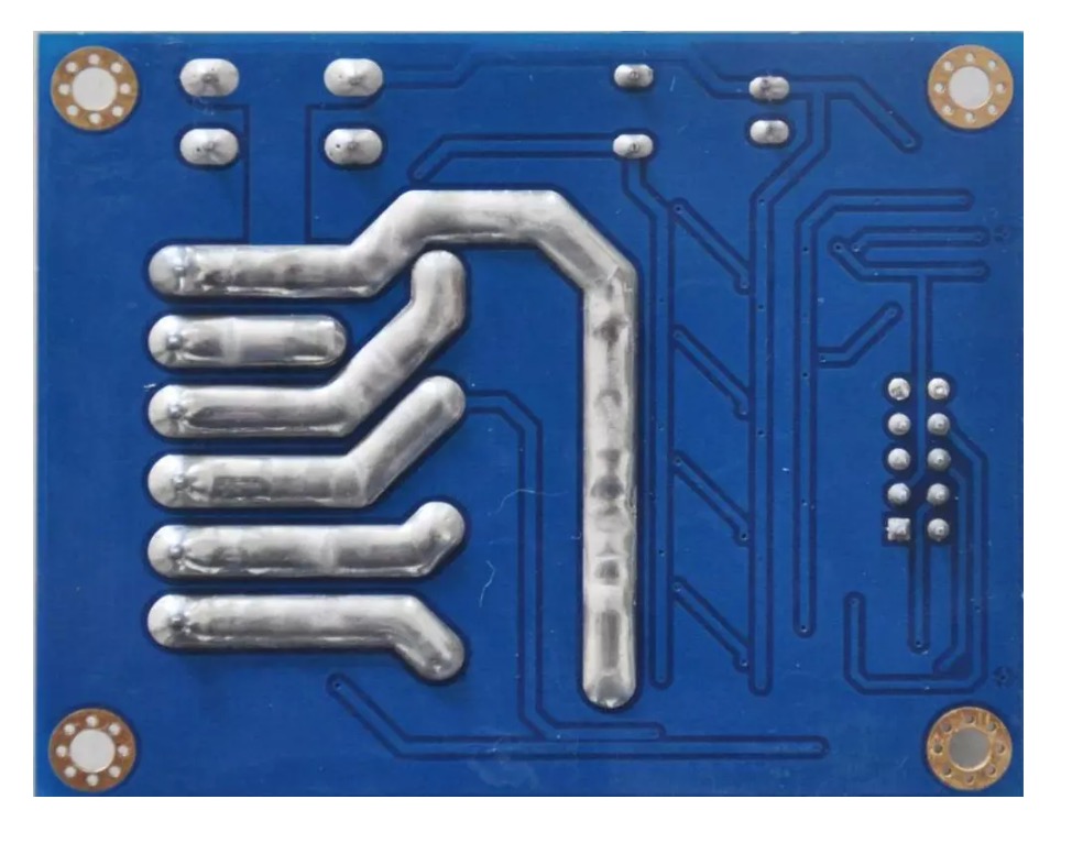

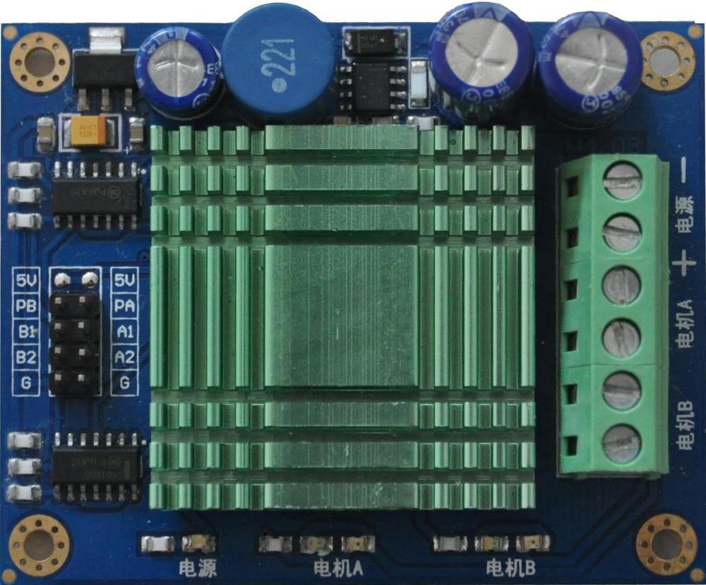

    Has anyone testing this module?
    Looks promising, but little information about it.
    60A High Power MOS Dual Channel H-bridge DC Motor Driver Module:
