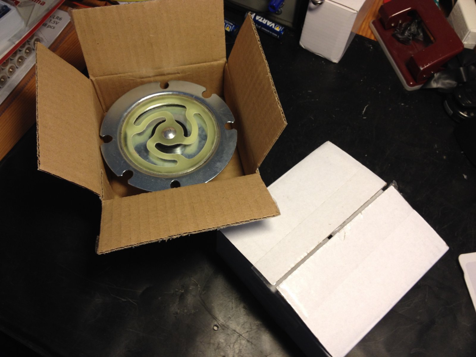

    The cheap bass shakers I ordered. I'm definitelly going to try these out, but how I should install them? I mean, should it be firmly attached agains the plywood, or do I need to leave a gap by putting some washers or something under the mounting holes? Or do I need to drill big hole to the plywood? Maybe I just start testing... :)
    What is sure is that I'm going to put the other under the pedal base and other under the seat base.

    Pedal base and seat base is a really good location choice!
    I have the same ;-)
    It has to be really firmly attached to transmit vibration!

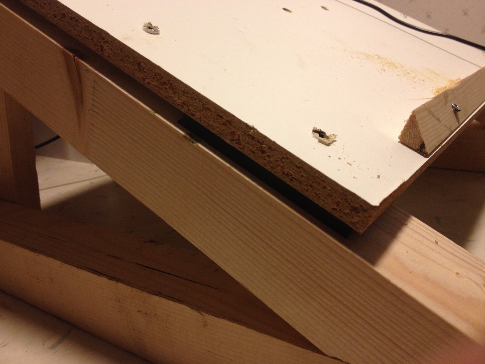

    Yeah! Thanks Historiker for your reply, I can hapily wait Simtools support for these, because even with normal audio this thing is awesome! It's allready somewhat working!

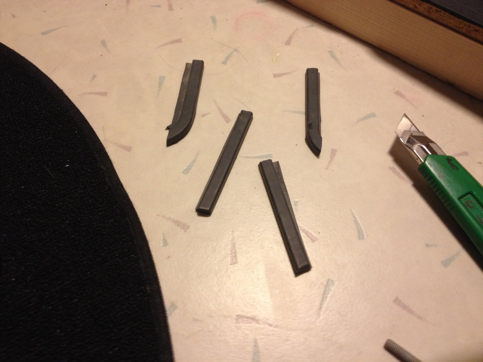

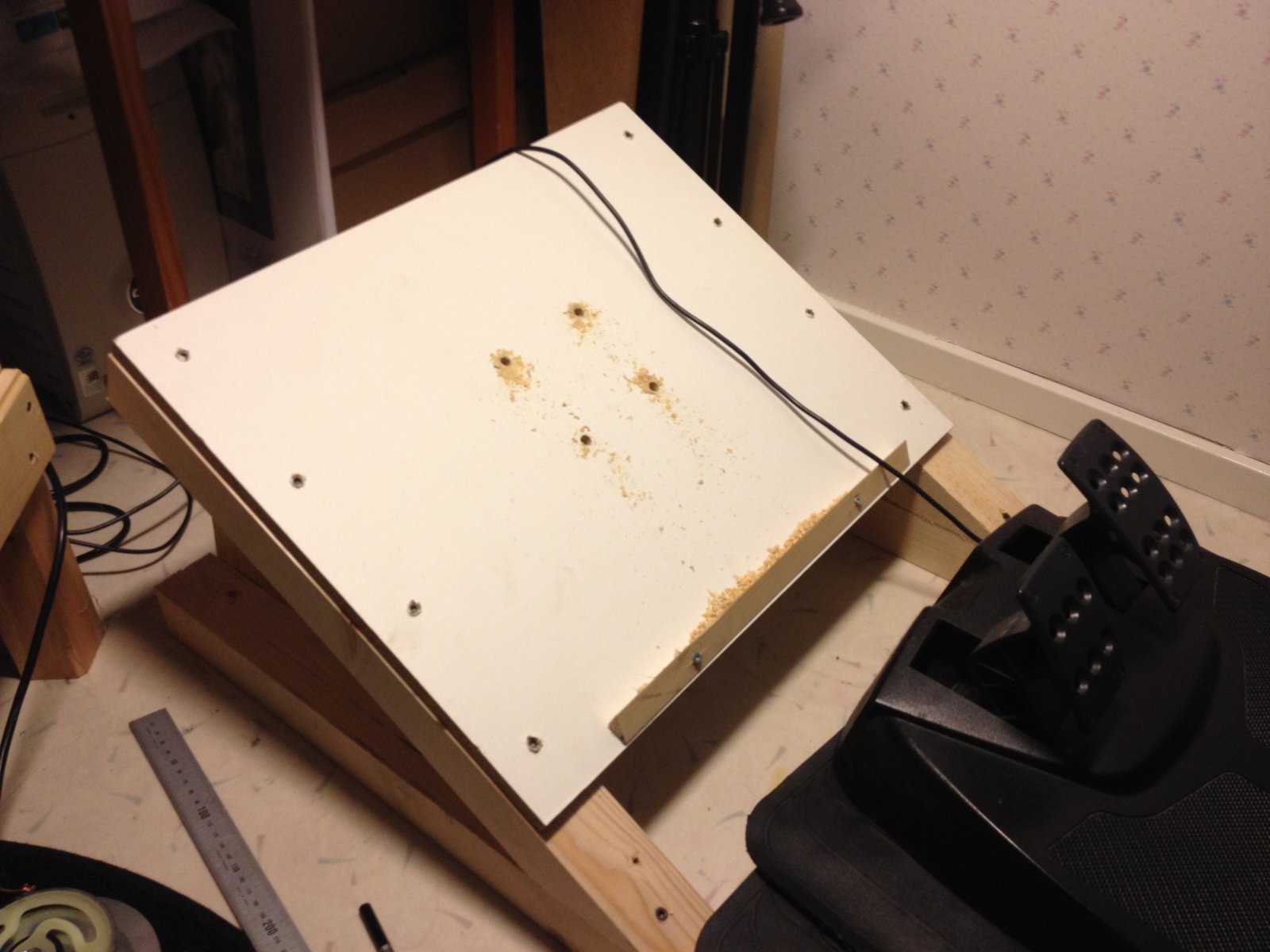

    I drilled holes through my pedalbaseplate
    Cut some rubber stripes for partially separating plate from the frame

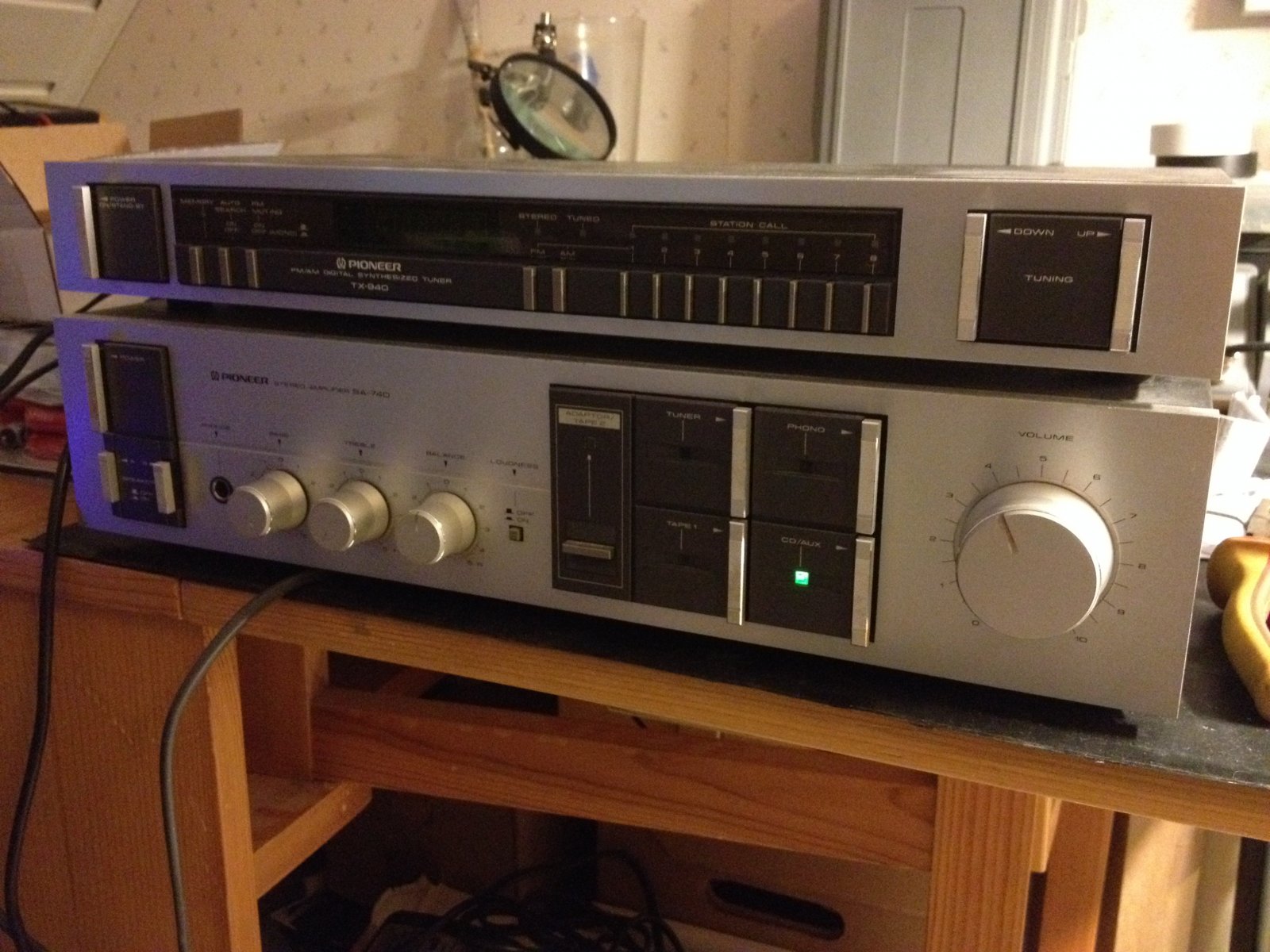

    Installed shaker, there are rubber washers between the shaker and plate, I Googled this kind of installation, but might change rubber to steel. There needs to be gap, because this is actually just the "insides" of the shaker, and otherwise it won't move properly. More expensive shakers are in nice casing where they are free to move, and they are ment to be tightened firmly in the base.
    I'm driving shaker with this old Pioneer, and driving it heavy... I would not be suprised if this is killing the amp. I'm hearing the game sound from the pedalbase very clearly, it is working like a speaker.

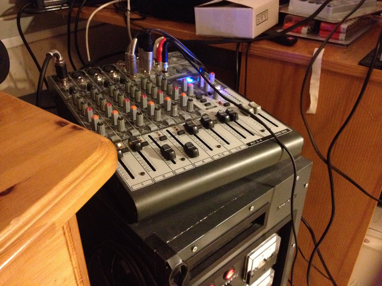

    I happen to have this mixer, which is very handy to route audio for multiple locations (from multiple sources) with ease. Was usefull with this also. I also have two soundcards installed, so that will come handy when Simtools have support for bass shakers.
    All in all, vibration is not very strong, but the first impression is still very good. I can feel engine revs, curbs and bumps under my feet and it's cool! Next I need to install the other one under the seat, which is a little more challenging. And THEN I take a break with this project :)

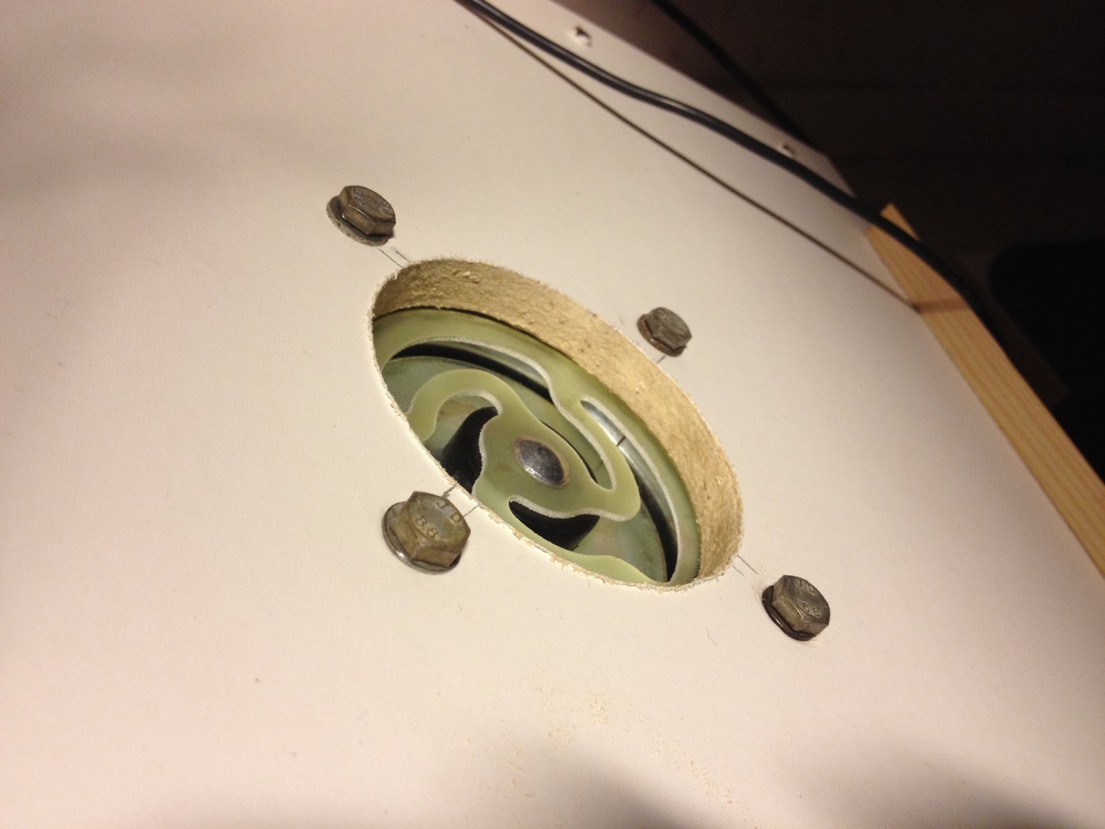

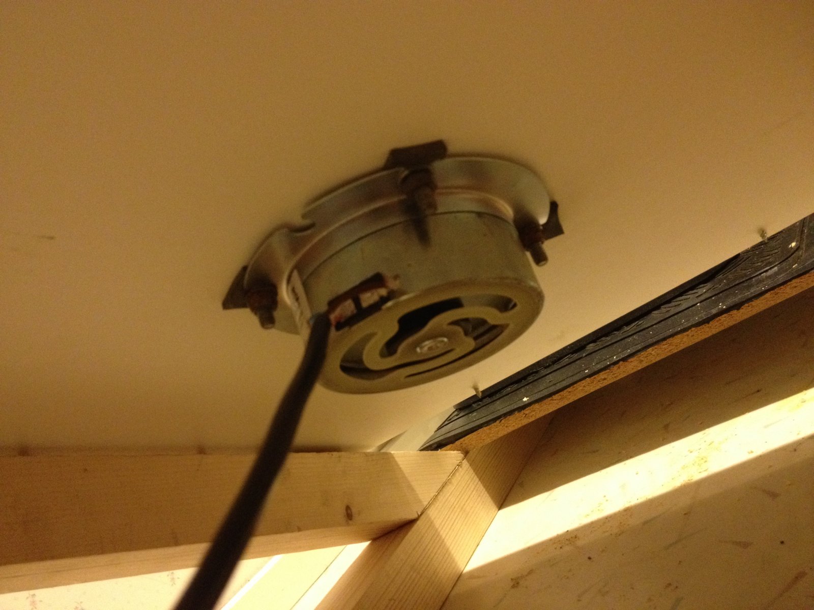

    I have seen them mounted over a hole bored in the wood, allowing the center to freely move up and down. That might work better than shims.

    Just noticed the early Christmas present Historiker, sorry I failed to see it earlier! Thank you very much, those 200 coins will come handy!
    Agreed, big hole in the center is propably the best solution. Will continue modifying the pedalbase and installing other shaker later, now that the rig is inside the house I cannot make any loud noises this late since my wife is allready sleeping. But sound of the shaker is not audible outside this room, which is quite unexpected.

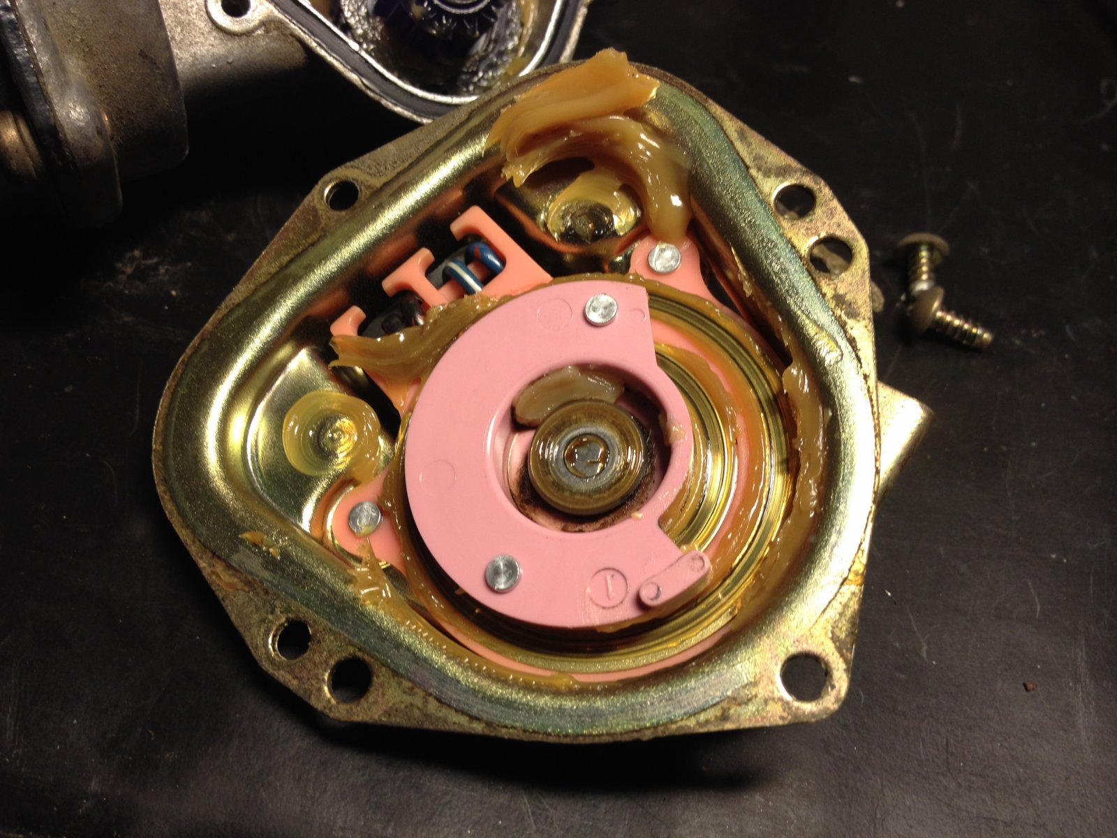

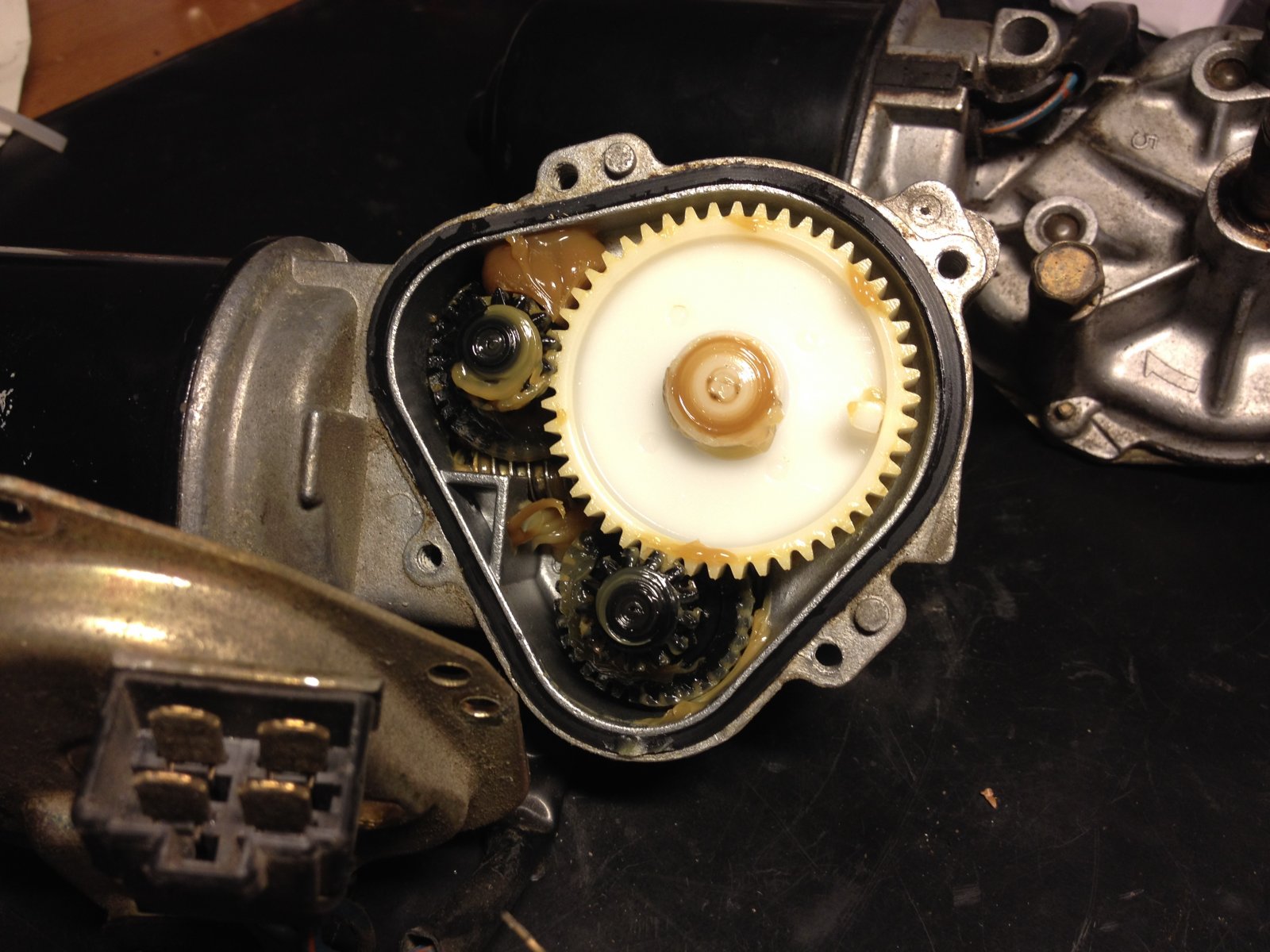

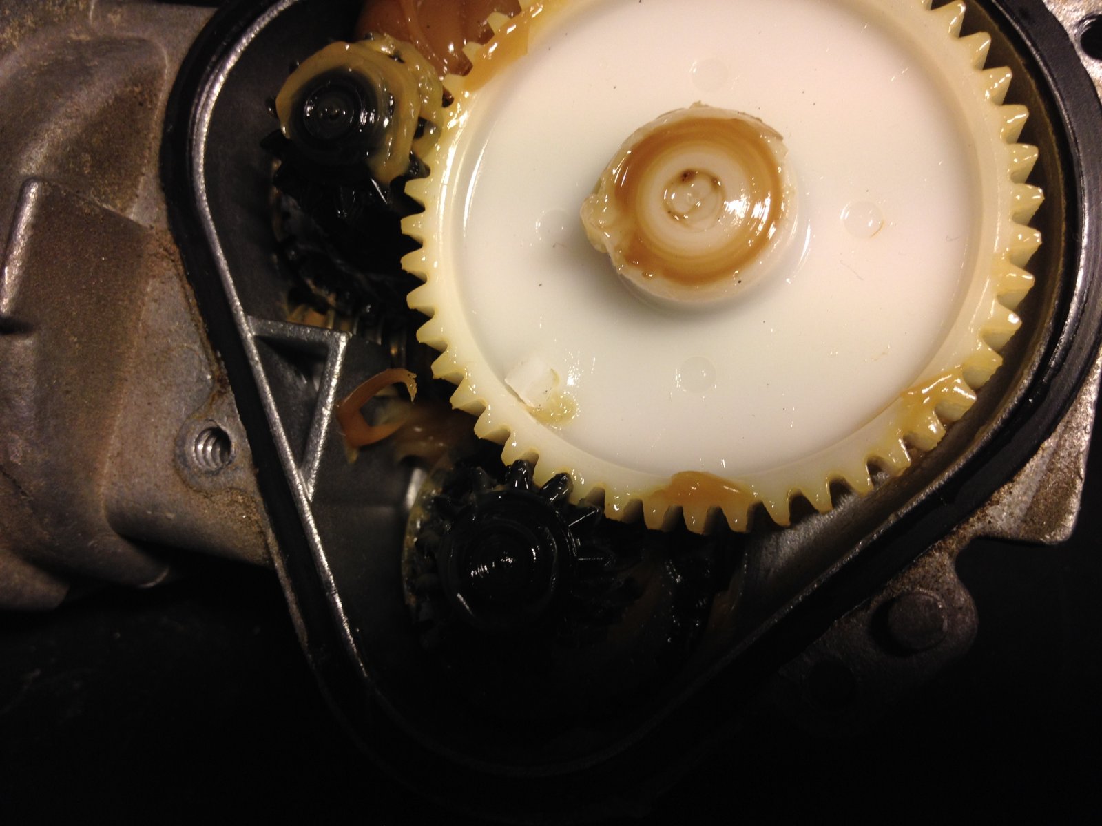

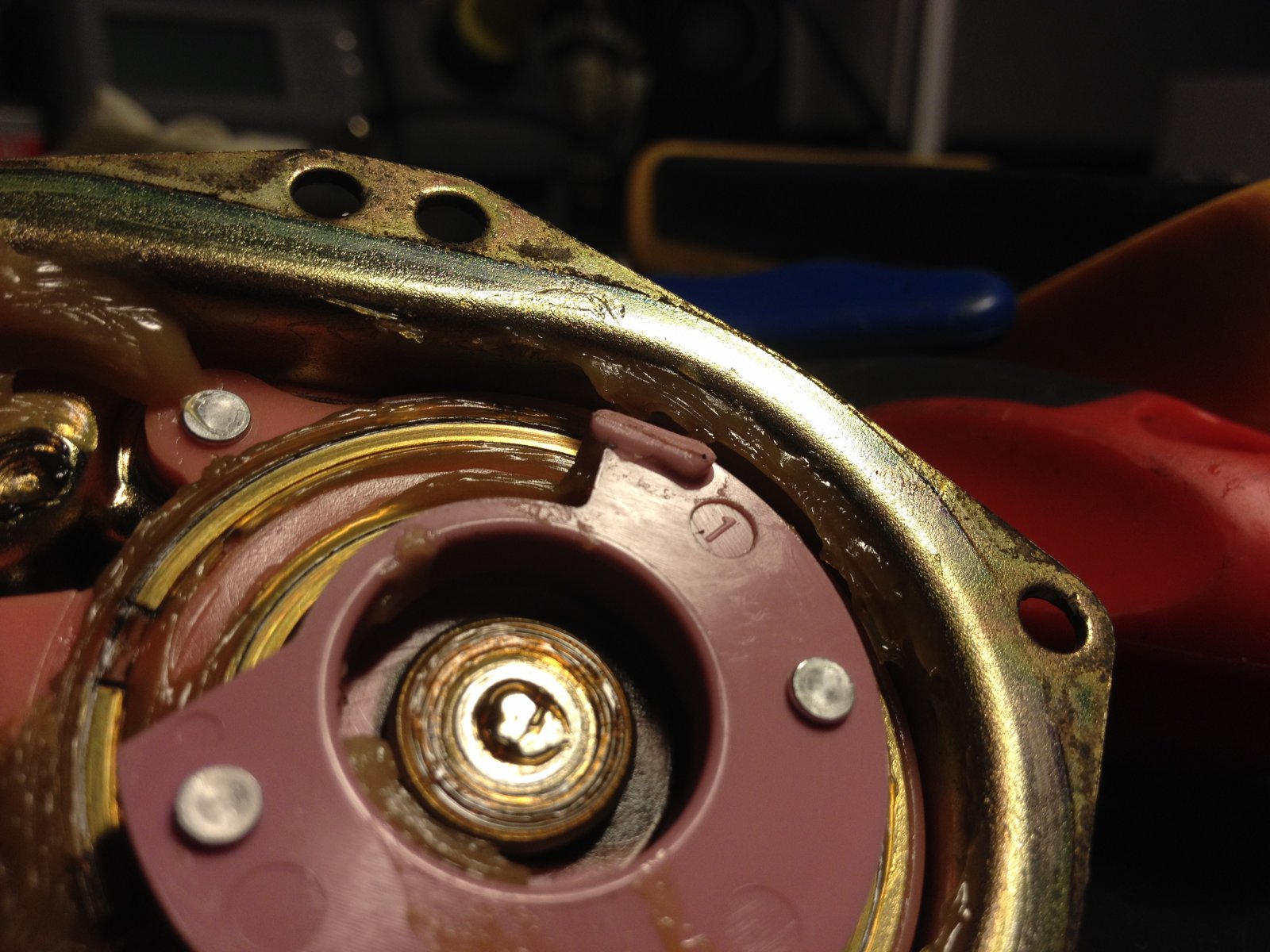

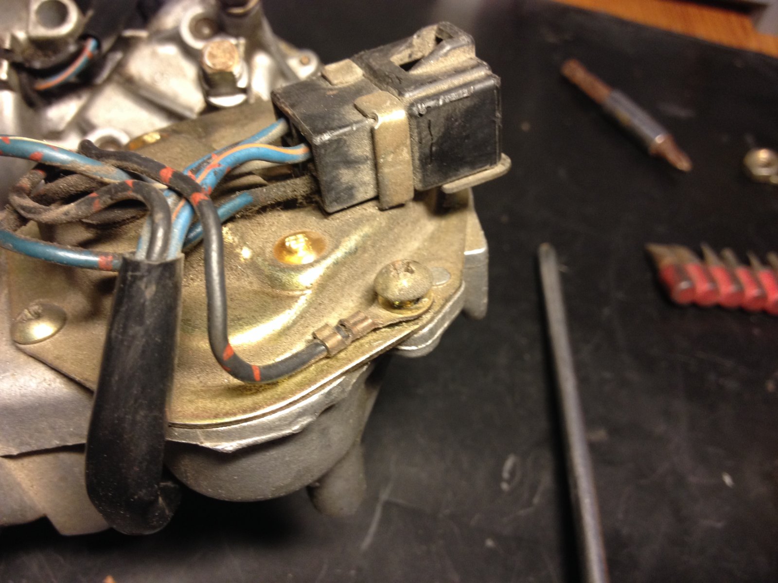

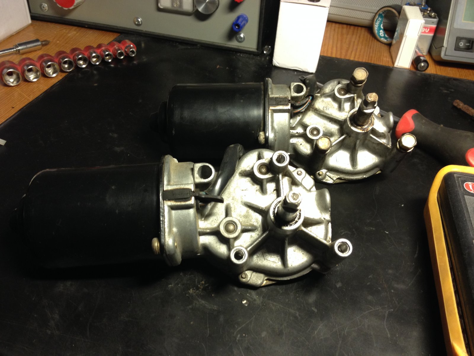

    Well, I just could not help my self and bought two wiper motors from the scrapyard. Even if I don't need them anytime soon, I just wanted to get my hands on them and see what they are about. So, these are from Mitsubishi Lancer, don't know anything else.
    First I removed the grounding to the case.
    Wanted to see insides. Looks pretty good to me.
    Here is, I think, the mechanism and contacts that changes the direction at certain point. I was curious and briefly tried to make sens of it with a multimeter, but all in all, we don't need this...
    So I cut the wires going there and left just the ones going to the motor.
    Testing!
    So it works, nice! Before I put the case back together I removed the stopper from the gear that would move now obsolete mechanism and also from the other side just to make sure.
    Enclose the case and we have modded wiper motor ready! Now the same to the other one ;)

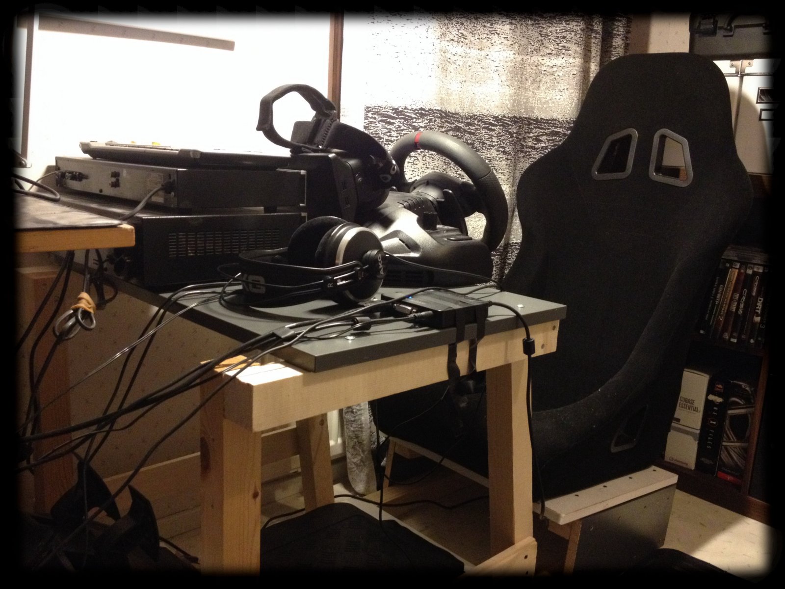

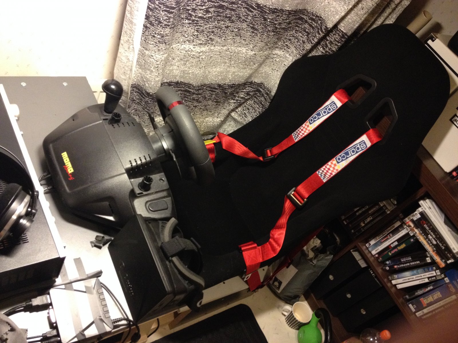

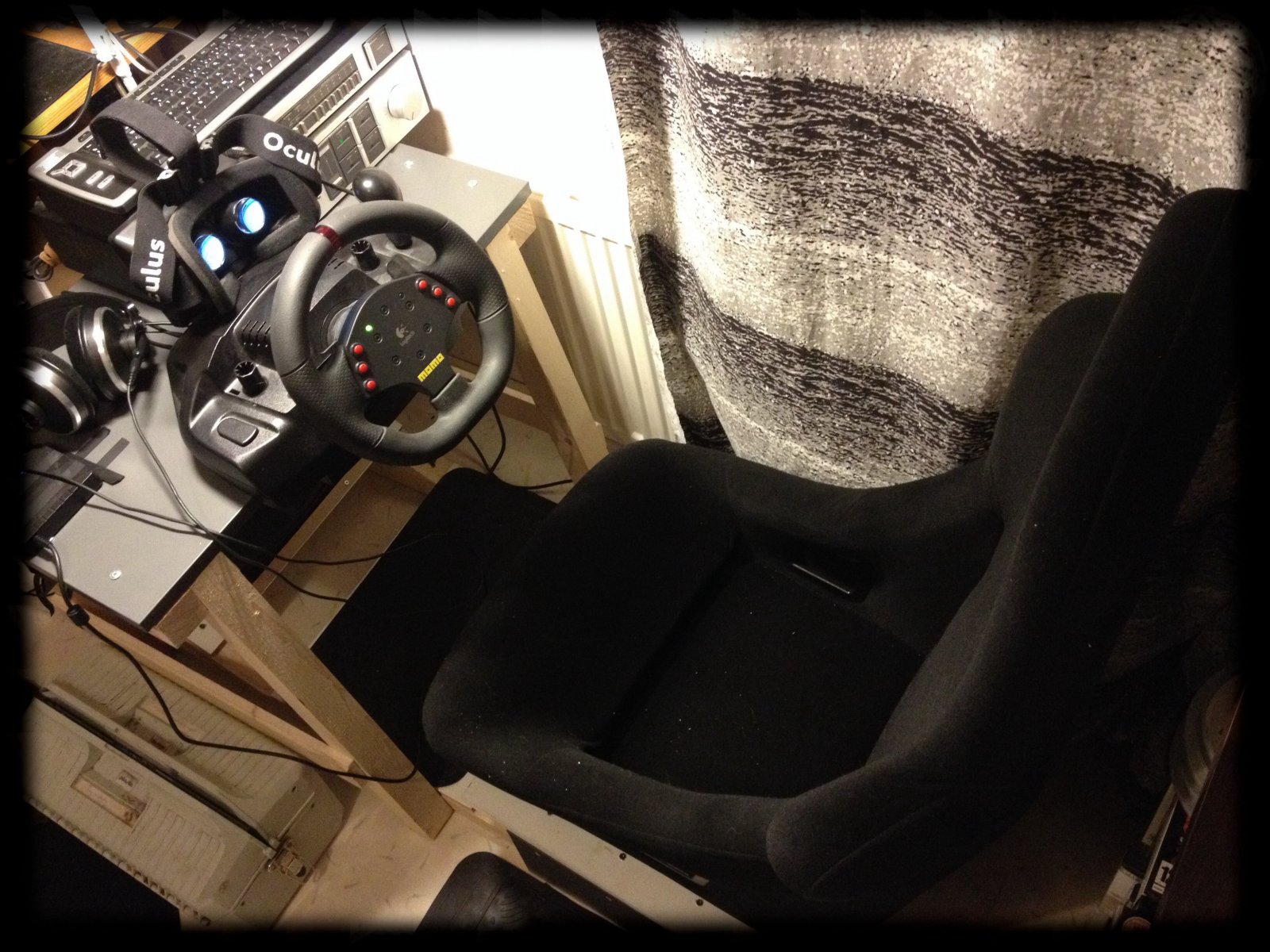

    Yesterday I modified bass shaker mounting like Historiker advice
    Actually did not notice much difference, but it looks neat! I also added shaker under the seat and that is something else! Feeling the Skip Barber engine idling when I started iRacing first time was sooo cool.
    Wooden prototype is now ready. Now I just enjoy racing with it and keep tools away for awhile... Until I feel ready to start welding together the real deal.
    This is were we got at "Stage1"

    Just a quick one, you did test with a multimeter that the case of the motor is now isolated from the ground, normally contain more than one earthing.
    And don't load the motors up with too much weight or the steel gearing will strip the big white plastic one.
    A controller and H bridge next, I think, and ya off and racing.

    Good notes earobbie, thanks for your post. I did check that the case was actually isolated from the ground wire with multimeter after I removed that outer wire. What comes to the workload, I try to keep it reasonable, just going to move the seat with rather short levers pulling/pushing long arms attached to the shoulder level. Still, if/when gearing wears out, I look for something more durable. Not expecting these motors to last for years.

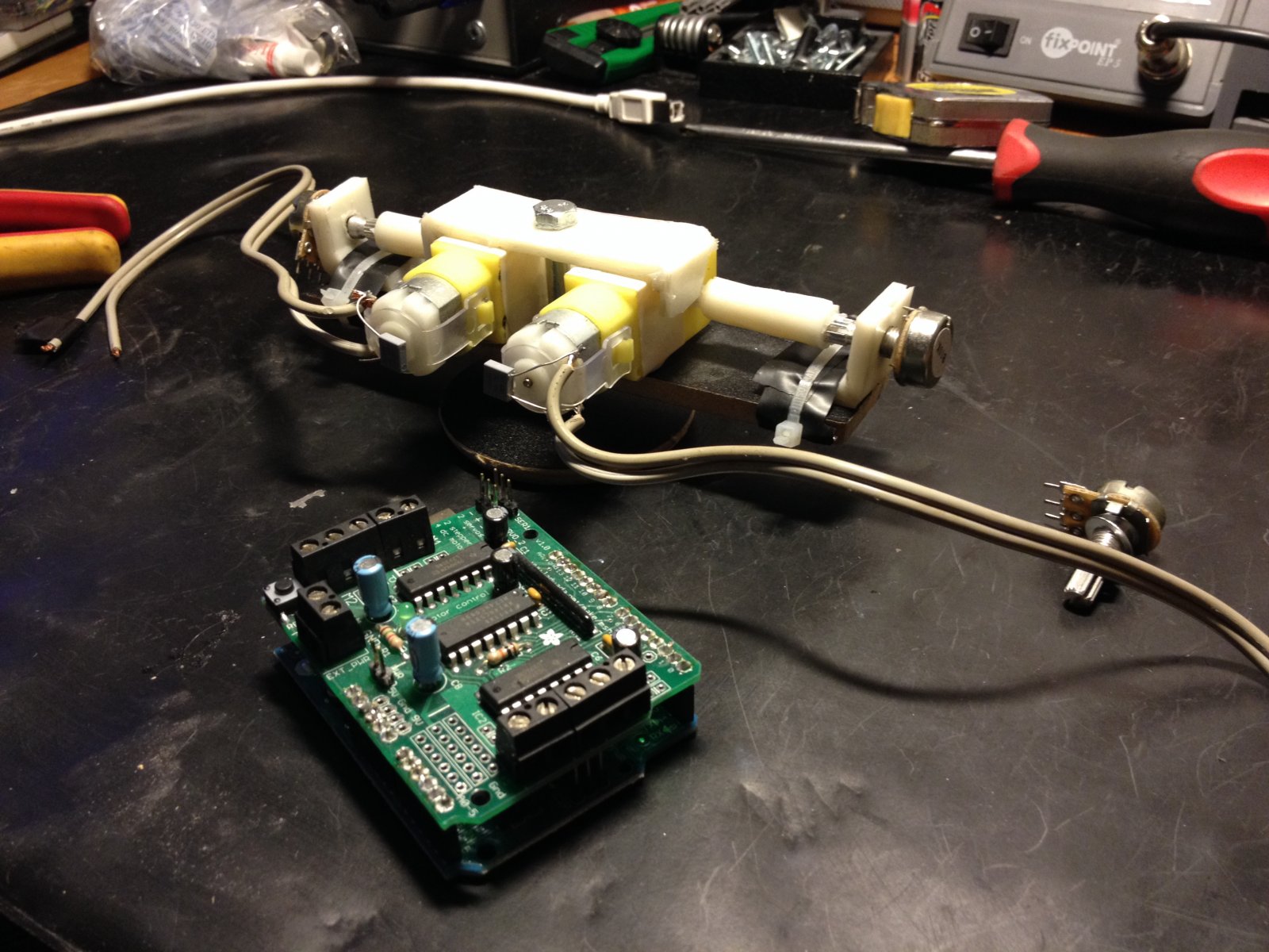

    Scraped together a testbench out of some wood, polymorph (very nice stuff for prototyping) and small gearmotors to try Simtools with Adafruit motorshield, but realized I don´t have the skills to adapt RacingMat's code made for motomonster to adafruit. Adafruit uses own library and it is very easy to program, but you MUST use the library. I'll just wait for motomonster, using this testbench with that then.
  18. eaorobbie
    20,489Coins
    +1,687 / 23 / -2
    I would wait I recently had a play with the same card, got it to run but noticeable lag in motor position and timings.
    Came down to the card, too clumber some of a library, takes too long to work things out.
    Wait for the Monstor Moto, will run on the test rig and will power the full sim , ++.

    YES, we have some motion, in small scale, but motion still! :grin
    First, I cannot thank you guys enough for your work here and all the information and software you share and thank you so much RacingMat for your arduino code, instructions and Simtools settings! This thing fired up at very first try following your instructions, no smoke, no bugs, nothing. Just plain workingness (not a word...)!
