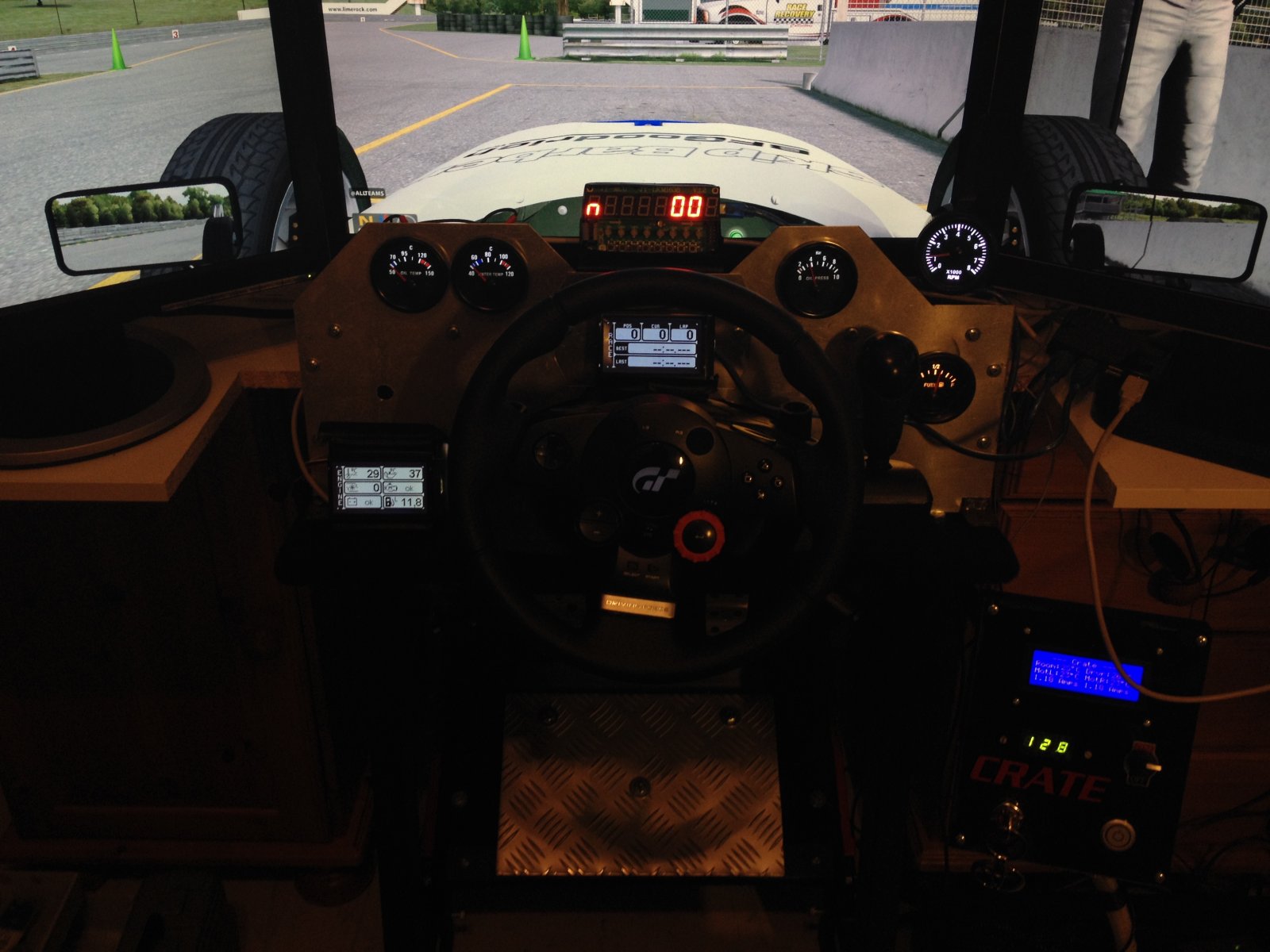

    Started to build a dashboard:

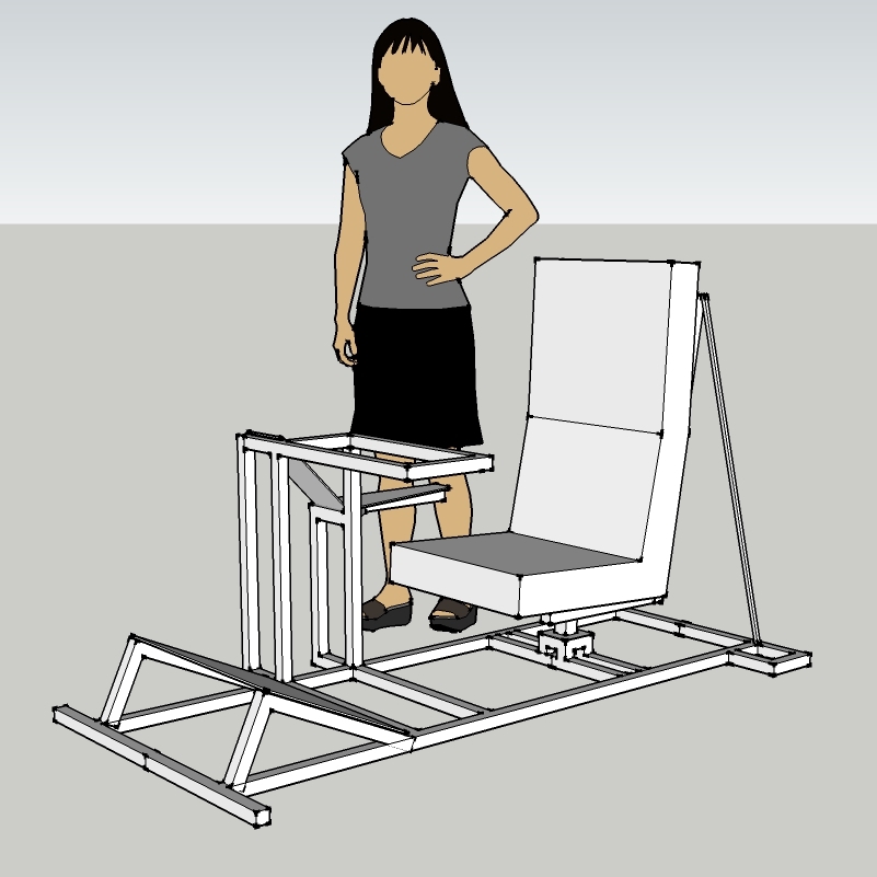

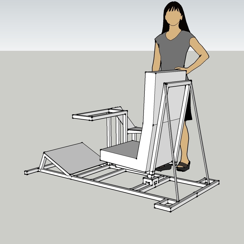

    I've been learning Google Scetch Up this evening and managed to get something done. So I'm going to move just the seat. Here are couple of pictures of the general design I'm looking for. No monitor supports, planning to use this with Oculus Rift, or in front of my desk if Iwant to use monitors. With the first wooden prototype I try to get the seat height and distance to the pedals and to the wheel correct. Wheel support cannot be done like this with wood structure though. Also, I may need to prepare the u-joint and bolt it in so I would get clear picture of how big safetyzone I need around the seat. This will also help to plan surfaces for mouse and keyboard. This scetch is made with 30x30 pipes, may use 25x25 with the real thing instead.
    That creepy faceless lady was staring at me the whole time I made this, so I decided tolet her in the pictures :)
    Edit. Uploaded pictures to proper location.

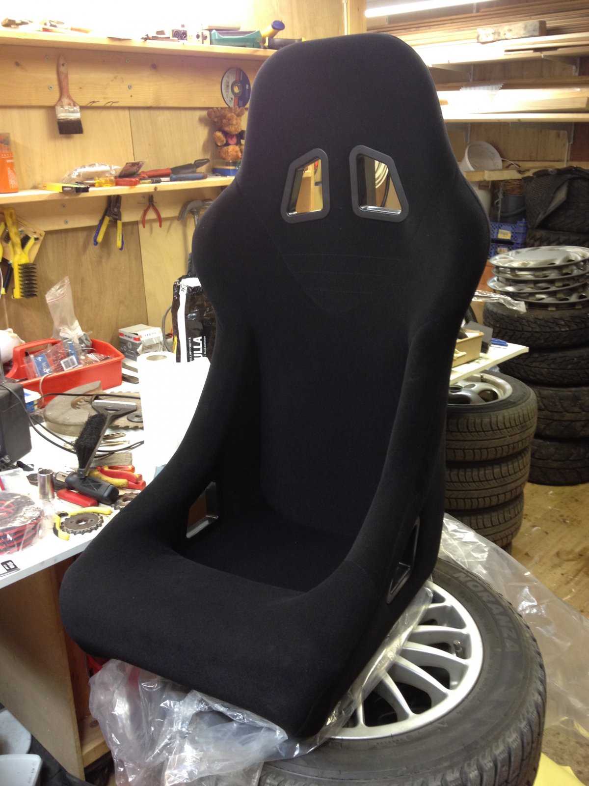

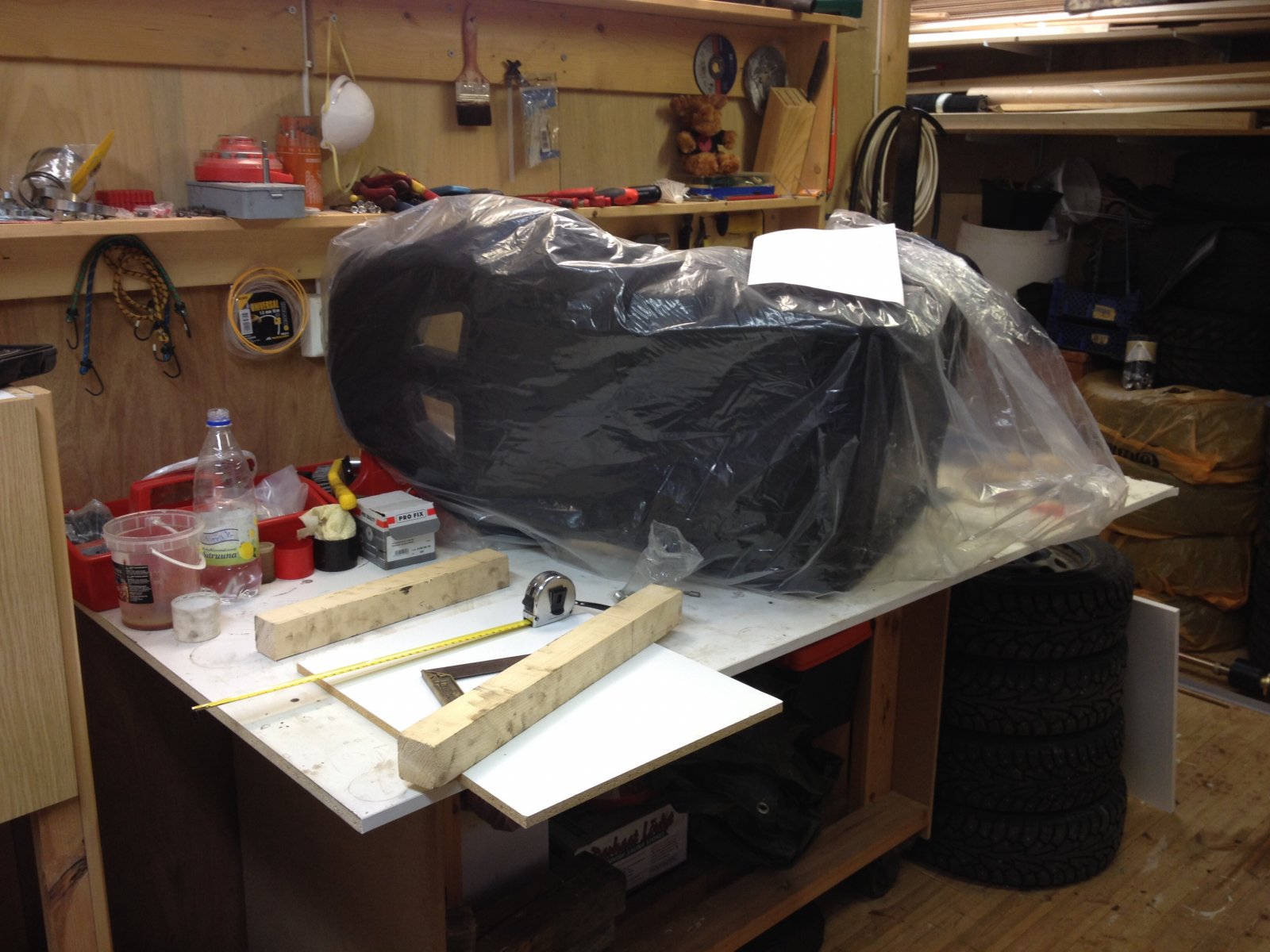

    Yeah, got the seat. It is lighter I expected and looks pretty good. I haven't sitted in it yet though.
    Need to clean my shop to be able to make the wooden frame there, now you can barely find a steady step...
    I'm going to weld the final frame at work, much more room there. And ofcourse, a safe place to weld :)

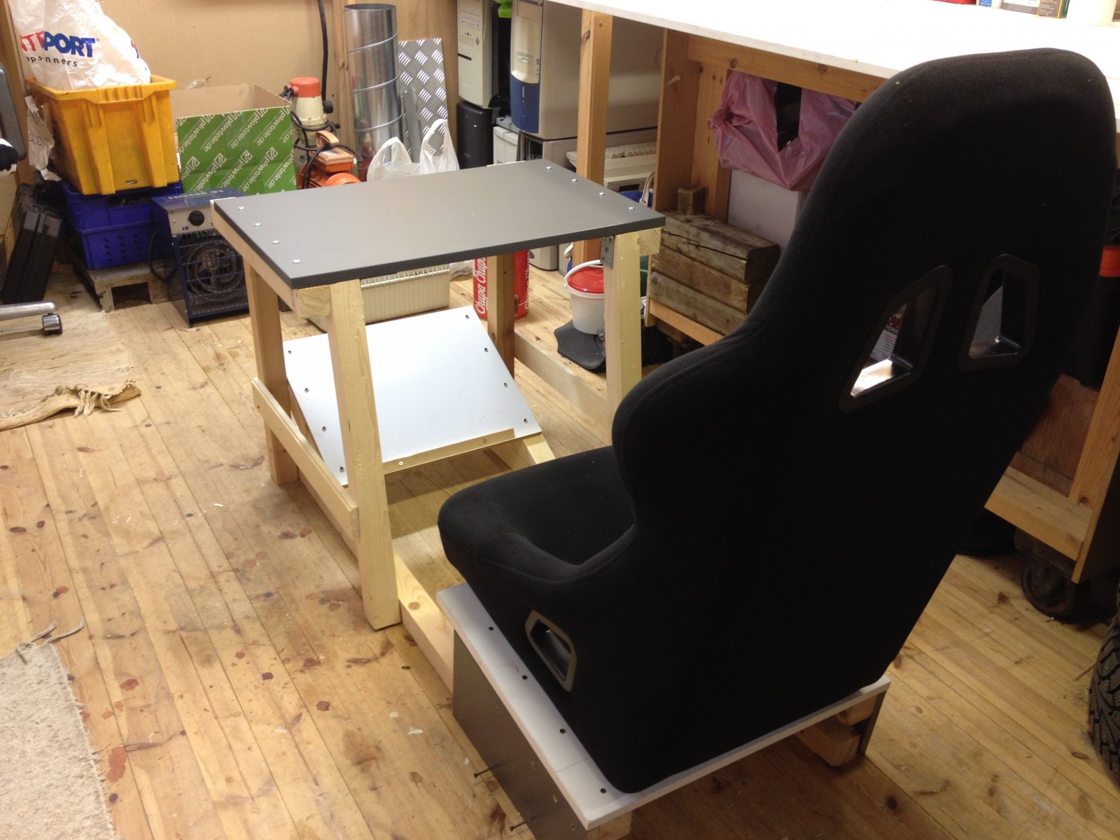

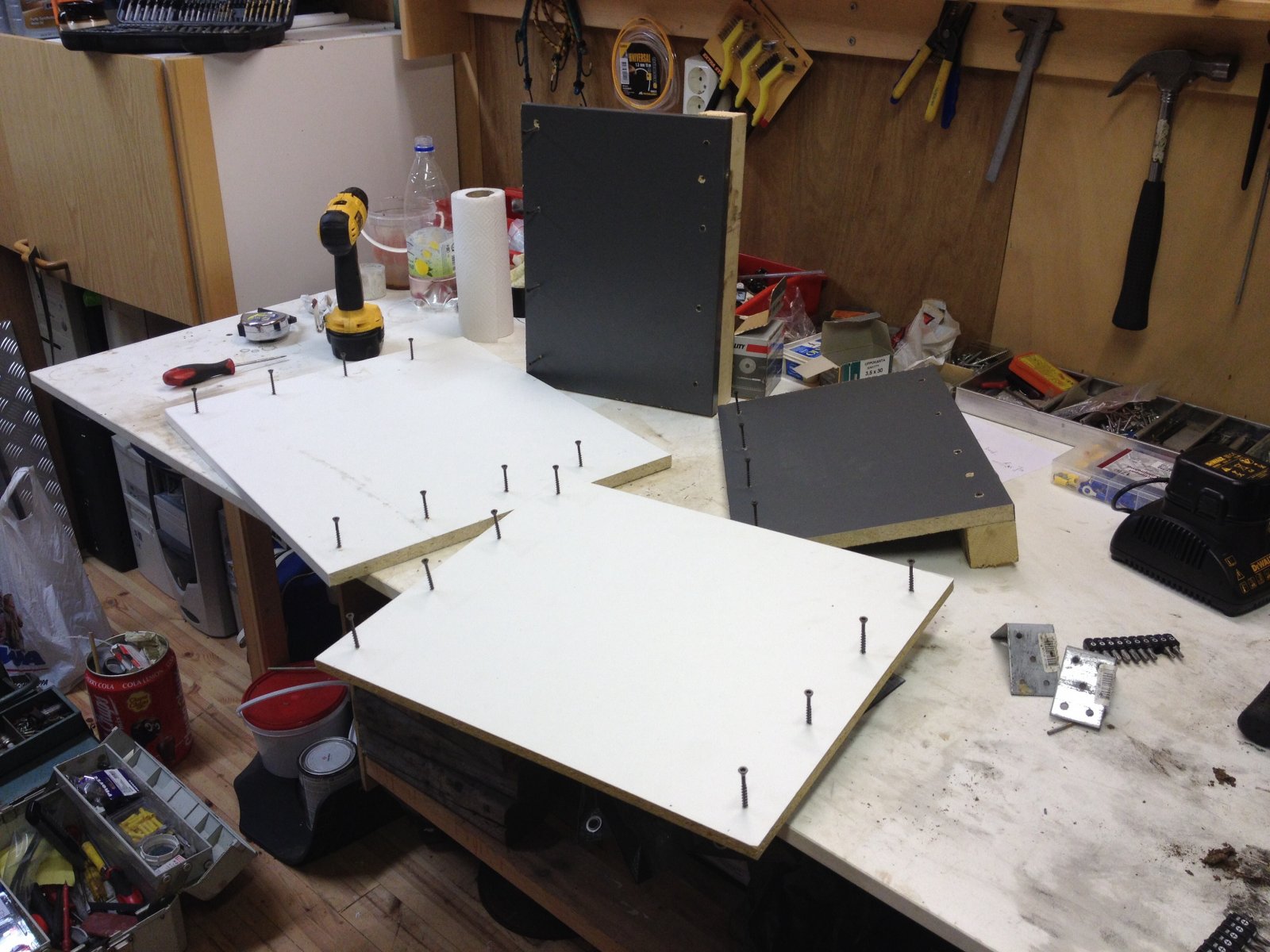

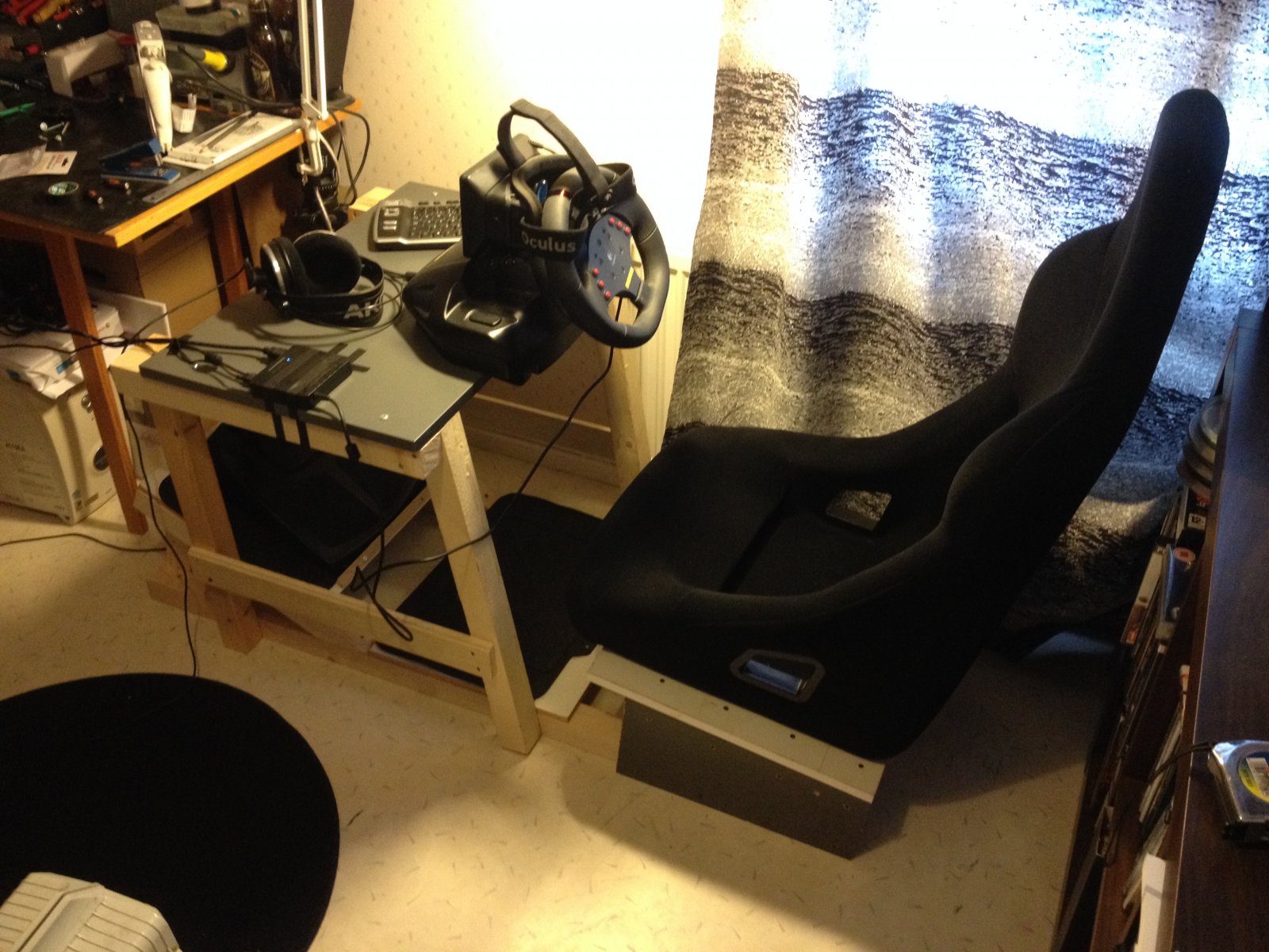

    I started to build the prototype. Im using at this point my current table to mount my wheel, so the height of that table is my reference point in this version. Final solution will be about 10 cm shorter in height.
    So it begins... Measuring seat attachment points.
    Main parts for the seat- and pedalbase.
    And where we got this evening.
    Seat is very comfortable and tight to sit. By the way, ordered a cheap 4-point harness from ebay. I've never sitted in a proper racing seat before, so I'm looking forward to be able to feel what it feels like to be tied firmly in this seat with a harness :)
  16. Scratch
    Scratch Active Member
    Apr 23, 2014
    170
    281Coins
    +181 / 1 / -0

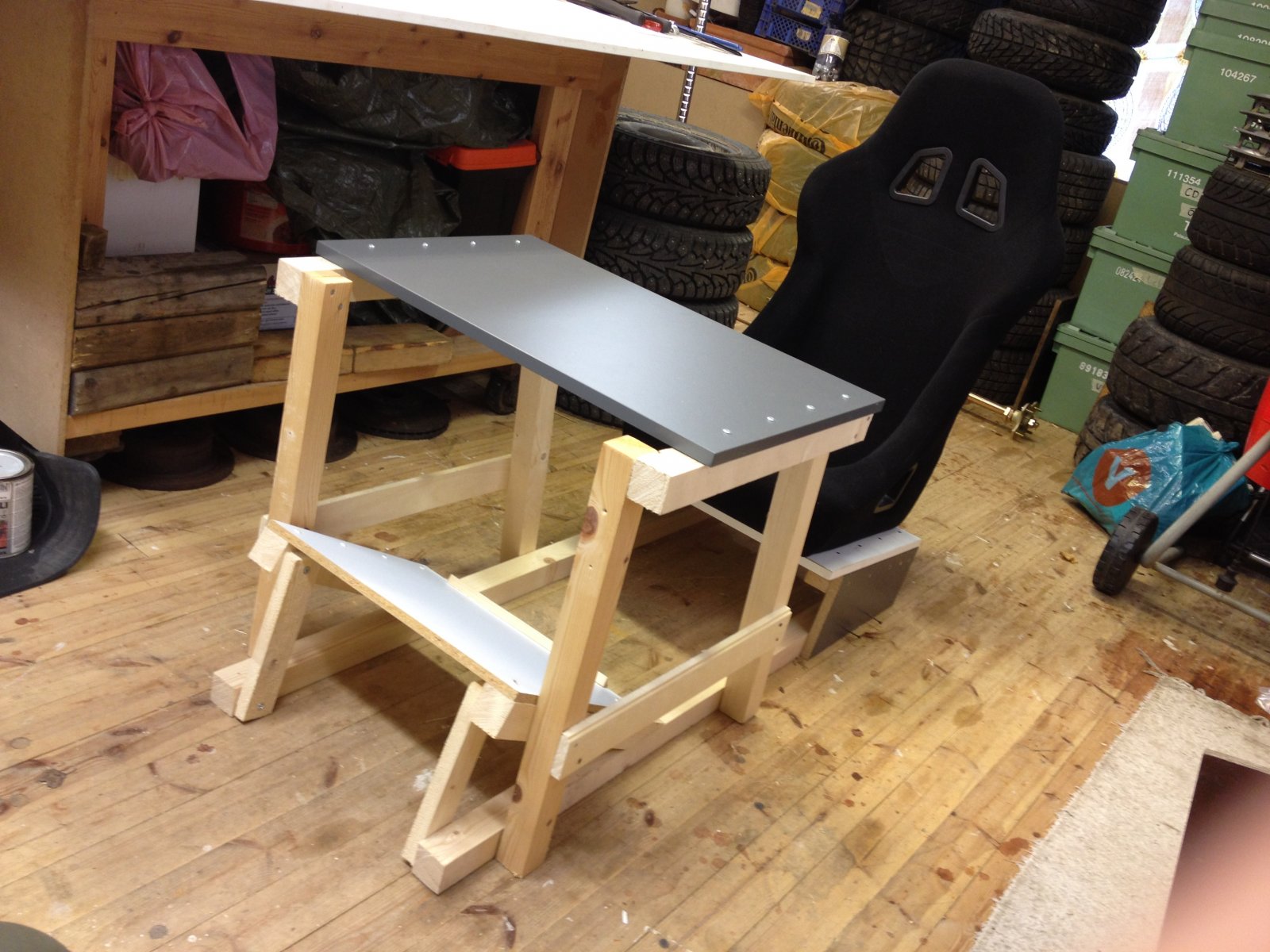

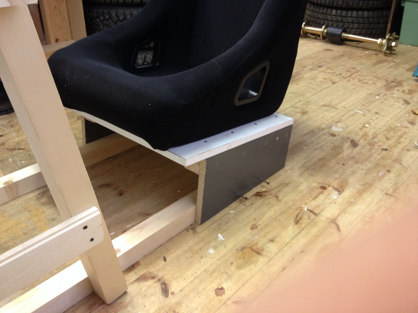

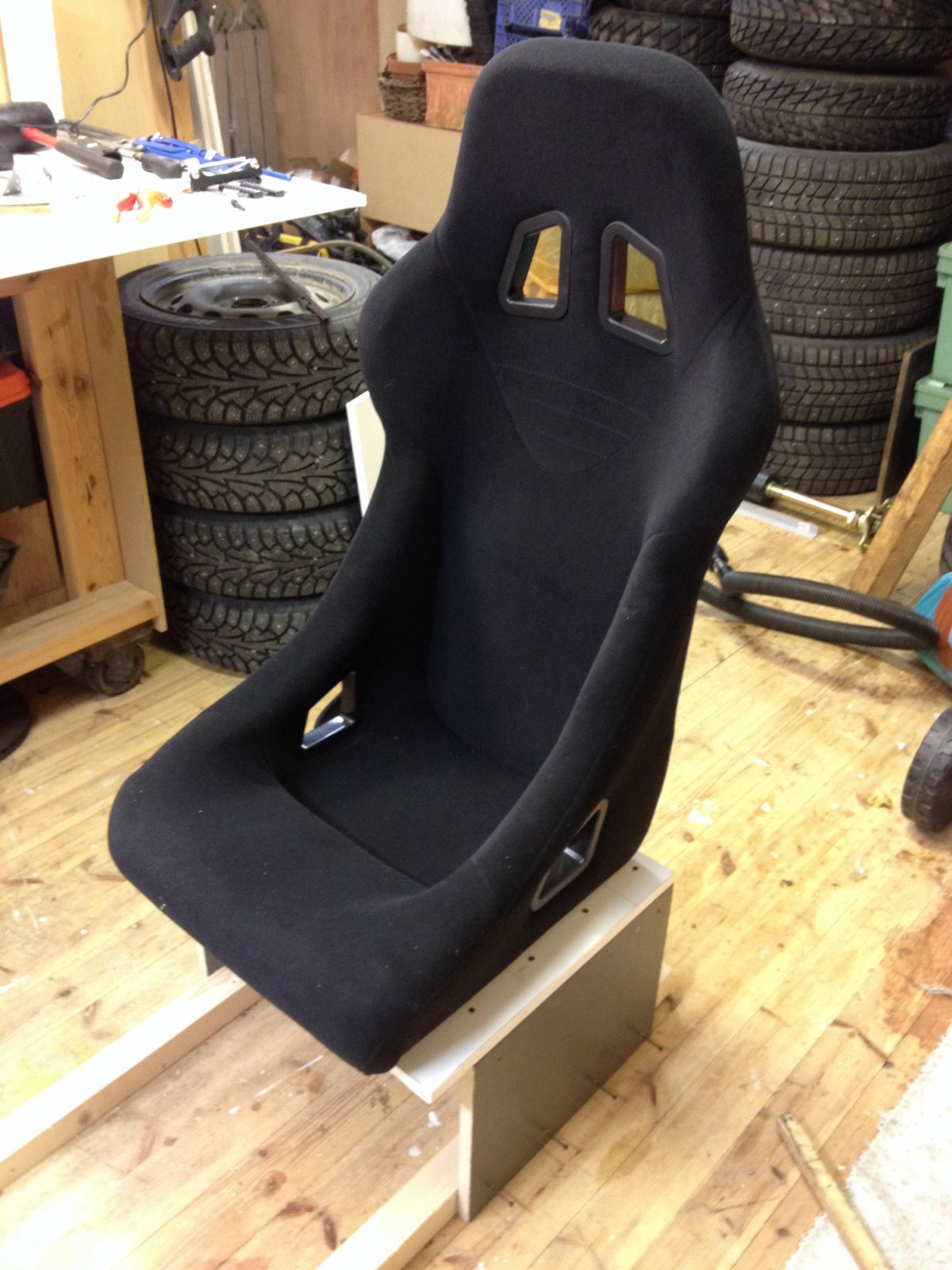

    Plans are made so one can change them! Today I decided to make wheel base as well so I can keep my computer table free for normal computer use. I also lowered and made a little tilt for the seat base and finished the pedalbase. The wooden frame is now completed and ready for testing :D
    Don't mind the ugliness, this is not ment to be pretty, just usable. Made it out of what ever I could find lying around. Very excited to give it a go, even if it's just an unanimated seat.
    Lowered and tilted seatbase.
    Ready! Added one plate for "floor" and rubber matresses after these pictures.
    And ready to race!
    Now might follow longer break in this, other more important thing to mind. But definitelly going to race with this as much as possible, I haven't played any sim during this first step of this project...
