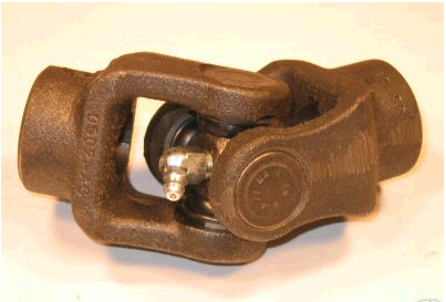

    @FAG Thx for the pics, interesting to see differents setups
    Is this type of U-Joint can be good ? or it should be bigger?
    Overall lenght 5
    Hub external diameter: 1 5/8
    Max angle 30 degrees
    Material: Cast steel
  12. bvillersjr

    The real universal joint pictured above will of course be the longer lasting item with the smoothest movement. The bell cup designs tend to wear and develop slop over time. It probably will depend on the price that you are able to get them for whether it makes sense or not.
    In my case, I have simulators in arcades where they are used all day long and need to be virtually manitenance free for years, so an actual Universal joint is the obvious choice.

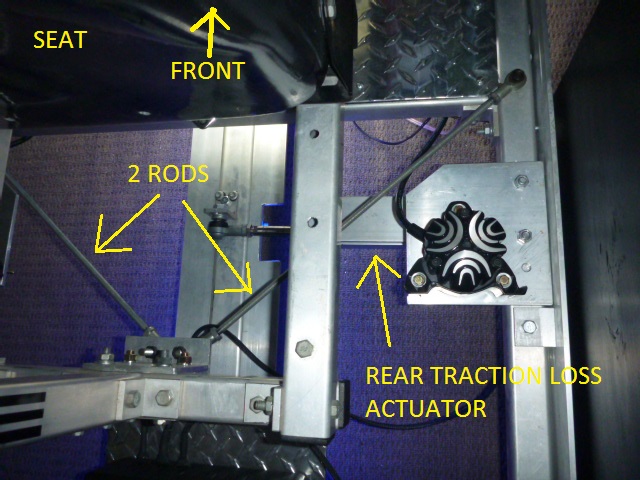

    The other advantage of the universal joint is that inherently prevents rotation, so you do not need to buy additional ball joints and rods and rig them up to prevent the rotation.
    Please keep in mind that regardless of the solution that you choose, that rotation can result in actuator damage and must be eliminated!

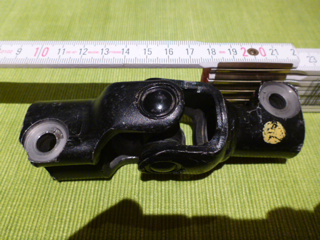

    Yeah, I might get a steering shaft knuckle. There's a power steering work shop around the corner where I can get one for little money.
    I'm thinking about modding it a bit - means cutting a bit off on one end and weld a plate on. You think that might affect its function - I mean the heat due to the welding?

    I have used a torana steering knuckle before its just a small uni joint same as a tail shaft one simular to the picture above, as Bernard has stated :thbup: , rotational movement will kill the scn5's, or this joint really needs to be strong as possible and allow no rotation of the seat or the scn5's will load up the wrong way and eventually snap the little connecting pin inside them, and its a bugger to fix them, but can be done.
    I actually use a seat mover at the moment but have minimised the overall movement to about 80mm on the motors, its matter of finding a nice point, with a seat mover you are simulating what is happening inside the cabin, i.e. your movement in the seat, so the movements are quite small, no big angles or it becomes really unrealistic.
    The truth if you don't have the expertise to copy the simx stuff, I would invest in buying the kit from Bernard to save any issue :thbup: , yes I have built them before but don't like the resulting movements and for $800 I can make a whole rig that moves faster and harder than a scn5 can today, proven on several sims but for ease of use and quality of components the scn5 is hard to beat.
    The centre of the knuckle needs to be approx. under 100mm from the underside of chair to the centre of the knuckle to minimise the weight transfer to the scn5's and because you are not using large movements , i.e. about 5-7deg of tilt the distance it moves away is not really noticeable at all. Minimising this distance will keep your scn5 safe.

    Ok, so I'll try to keep it under 100mm. Got myself this steering shaft knuckle:
    It's 120mm long (one side 55mm, the other 65mm). See how I'm going with the seat - might shorten it on one side in order to get the centre closer to my backside.
    I'm gonna install 2 threaded rods with rod ends on 45deg to prevent the seat from rotating - have a look at this one:
