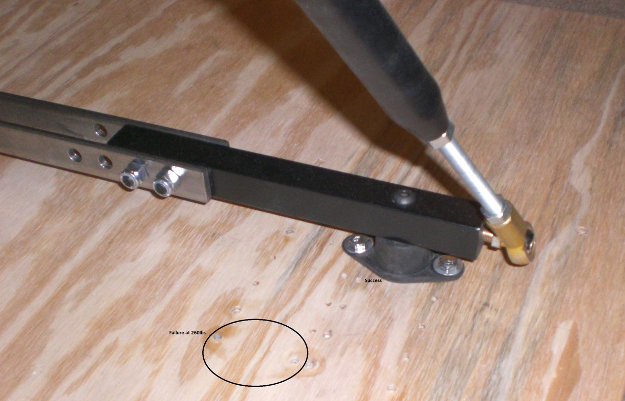

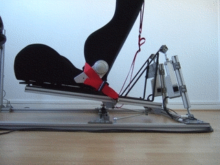

    There has been much confusion about the proper design for a SCN5 motion seat base. Some have experienced actuator damage as a result of misconfiguration. This post is an attempt to help those who will be building their own motion bases to avoid costly mistakes. These are the lessons learned while developing the SimXperience Universal Motion Kit. Since I offer a 1 year warranty on the actuators, I need to try to ensure that DIY users configure their seats correctly to avoid warranty claims!
    The test objective for Universal Motion Kit is to provide users up to 260lbs with good quality motion and actuator safety while using 150mm actuators.
    It is important to recognize that their are a variety of critical factors and that they all need to be combined correctly to produce a good feel and increase the life of your actuators.
    -Seat tilt on the seat base
    -Distance of rear actuator bar from pivot
    -Width of top-side actuator bar
    -Type of pivot
    -Location of pivot
    -Dampening mechanisms
    Important minimum dimensions
    30.50 outer dimension from bottom-side ball-joint to ball-joint.
    11.25 outer dimension from top-side ball-joint to ball-joint
    28.50 from center of pivot to center of rear bar.
    Tips
    -Use rubber bump stops
    -Generally speaking, the pivot should be located directly under your butthole.

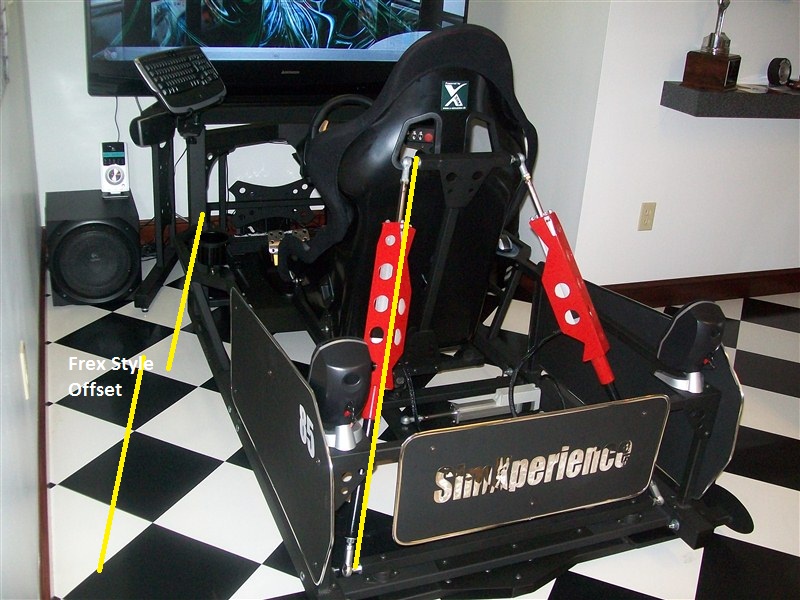

    -Test your design with the test sliders INCREMENTALLY (I posted a tutorial here a year or so ago with a video on this)
    -My actuators are mounted inline!! If yours are offset (like in a Frex design) then you should compensate for this. .50 inches is the difference between success and actuator failure.
    -The Frex design is NOT sufficient for 150mm actuators. It failed every test on my test platform with 150mm actuators.
    I will update this post with pictures when I have time.
    Reference Pictures
    Happy building!

    There are many benefits from a feel perspective to having the mounting bar in the rear as well. I stumbled upon this quite by accident, and was very pleased with amount of realism it added to momentum shifts and changes in direction. It makes the motion more fluid as it would be in a real car.
    The rubber bump stops are easy to make. I simply buy a strip of rubber, cut it, and then drill it with a drill press.

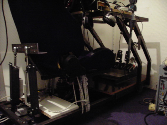

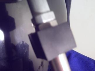

    Regarding the rubber bump stopps: I've made my own modification - squashballs ! I drilled a hole a little bit out of the center of the squashball, pushed the lift rod through and countered it with a big washer on the upper side. So everytime the lift rod moves down, the squashball absorbs the last mm of the movement. Must take a picture when I'm with my sim the next time !
    Originally I wanted to get such a rubber to cut thos bump stopps by myself, but unfortunately I haven't found them at the local stores here... If someone here has this material left, I'd like to buy it from you...

    Bernard, why ? What is the difference between these three SCN5-mounting-versions:
    • SCN5 mounted on the actuator arms, facing to the seat back (= Frex style)
    • SCN5 mounted on the actuator arms on the back side (= my actual style)
    • SCN5 mounted facing each other (= your actual design)
    I've tried version 1 and 2 and I didn't notice any difference in the kind of motion or in the behaviour of my SCN5 !
    Next question is, whether it is still needed to use lateral stabilizers if there is a cardan mounted (not a rubber pivot).
    I only had them mounted to avoid torsion in the beginning when I used a rubber pivot. But now I have disassembled them, 'cause I switched to a strong cardan pivot.

    There is no need for stabilizers if using a universal joint.
    Your actuators are still offset no matter how you turn them. My earlier designs were offset as well, but I have remedied this in later designs. Please allow me to illustrate.
    The point is that if you are using the dimensions that I have posted, you should consider that this offest actutually changes the dimension. I prefer inline because I use dampeners in my actuator covers and an inline dampener is more effective.
    I have also considered more narrow designs such as those employed by Frex and Nima (the origination of the ProSimu style mounting). None of these designs meet my performance criteria. Additionally, both designs tend to hop around on the floor, damaging the floor. This hopping also reduces the quality of motion. A wider base is more stable and when used with a dampending bar and inline dampeners, improves motion quality and eliminates the hopping common to these other designs.
    Nima is now redesigning his simulator away from that style. He originally did this to save space and understands that this is not optimal. Please do not copy his design!
    I use this simple wooden platform for testing a wide variety of actuator angles, mounting positions and widths. I test each scenario with a 260lb driver load at full actuator speed for 1 hour minimum while measuring actuator temperatures and missed targets (actuator re-targeting due to missed positions, some of you may know this as the famous actuator bleep noise).
    My findings posted above are the results of these tests with 150mm actuators. It is correct that a 100mm does not need quite as much angle and can use a slightly smaller footprint. It is however my opinion based on extensive testing that a Frex design and Nima/Promsimu design are less efficient and prone to actuator failures. I have no ill will toward anyone at Frex or ProSimu and I wish them the very best. I would however be very hesitant to offer a 1-year actuator warranty when used in those designs.

    I have used your methods and can 100% validate that it makes a huge difference. I have had someone weighing over 250 lbs on my sim rig and it performed with no issues. The only thing I do is limit the lateral movements a little more than I would if I were driving since I do not use the 25% limiter (but i do use about 10% inside my profile). I do not recommend anyone not using the limiter unless they fully understand how to optimize their entire configuration to avoid damage.
    I have a question about the above rubber blocks that can be used to help protect the actuators. Can this damage the actuators during initialization? I notice that the actuator will try to compress the rubber and it is difficult for them to do so which is desirable when driving but I'm not sure what long term effect this will have on them. Is there any way to calibrate them so that they do not compress that far during initialization?

    The rubber blocks are intended for use during initial testing and with the 25% limiters on. Once you have verified that your motion base design passes the test, you can safely remove them. Of course if your motion base does not pass these tests, leave the rubber blocks and 25% limiter in place!
    I do not recommend using the rubber blocks with the limiters off unless you are using a VERY soft rubber than can be compressed by the actuators during initialization without significant strain. This of course makes for a fine balance between being compressable and providing some kind of protection.
    My rubber blocks are .74 inches.
    As a point of reference, my motion bases do not ship with the rubber blocks because the unit is already thoroughly tested. I am 6'3 tall and 230lbs. I have no issues even with my limiters off.

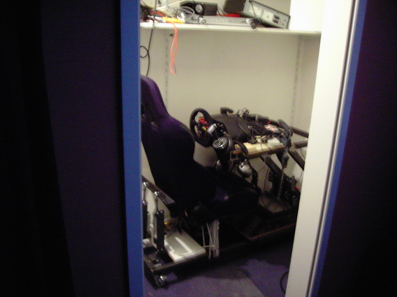

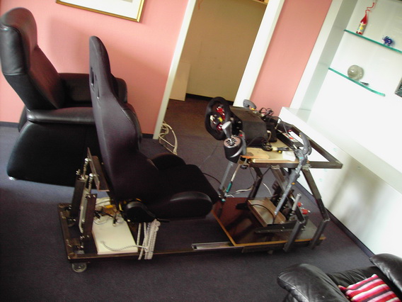

    bernard wride:
    this is right i have make this design only for my place.after playing i must move the sim in other
    littel room.if the sim only 2inch more length i dont can move in the other room.for my new sim
    i go in a other room.the room has not a big size.i can make my new sim 220cm long,
