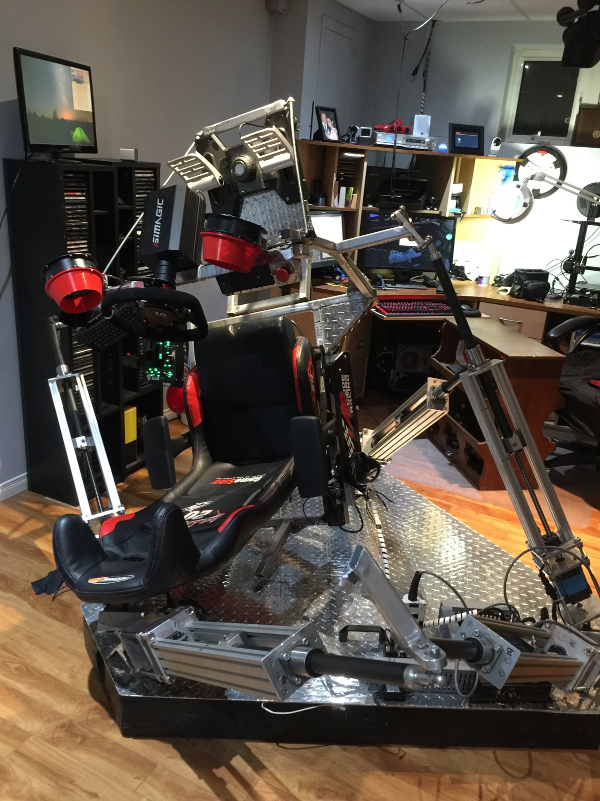

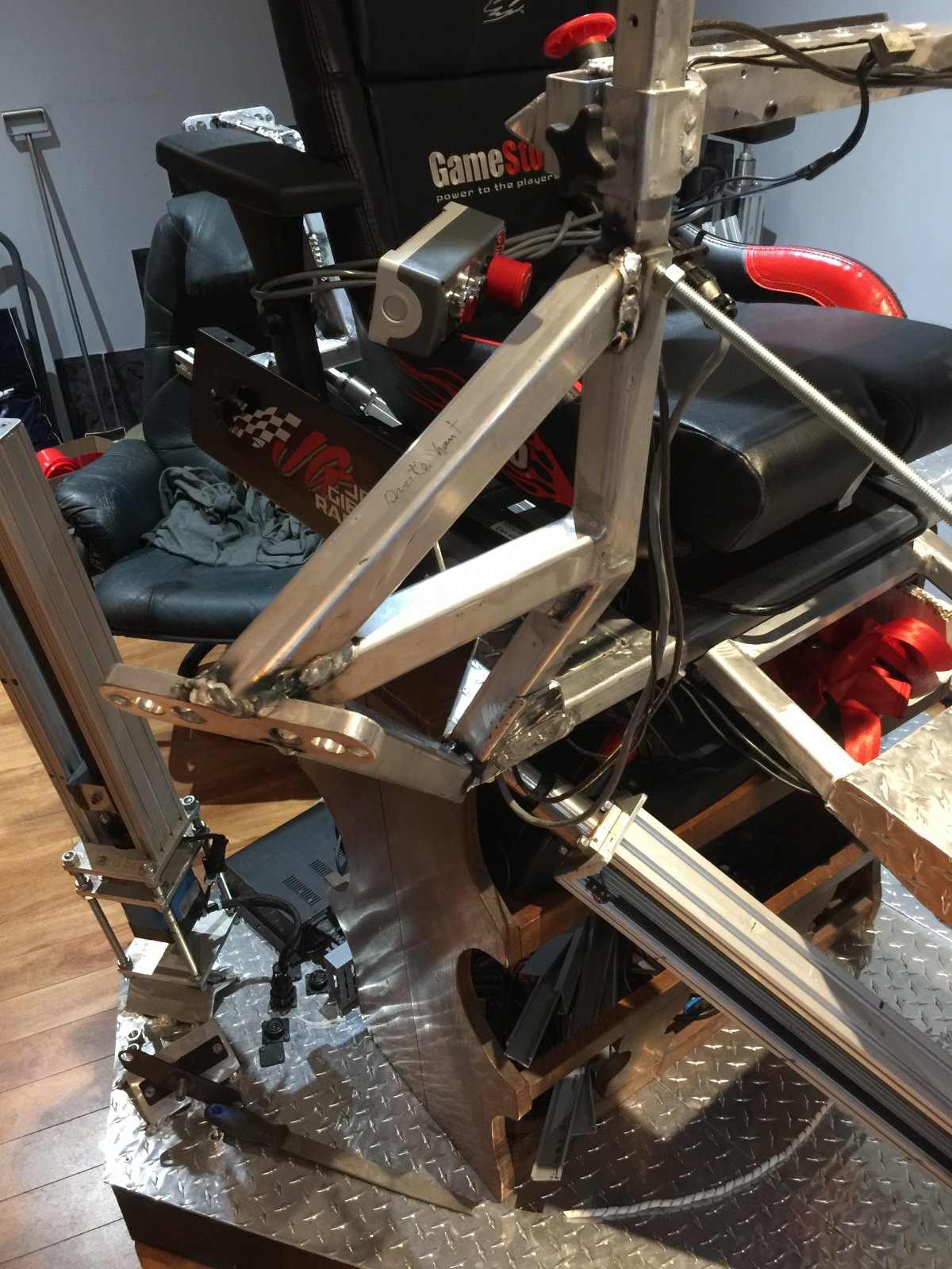

    DC motor, 6DOF
    @pmvcda ,@hannibal ,@Pierre Lalancette , @SilentChill,@fanch64

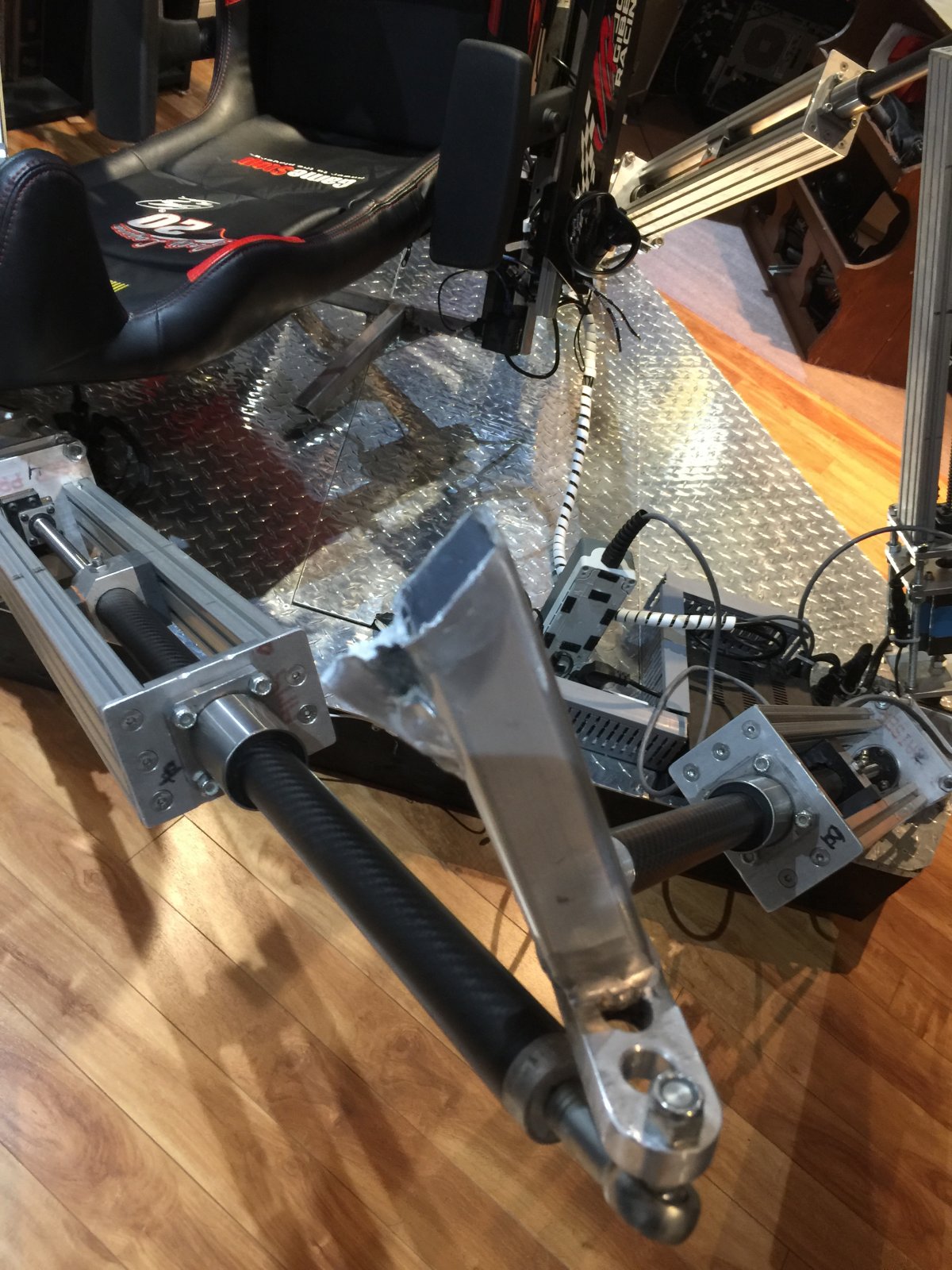

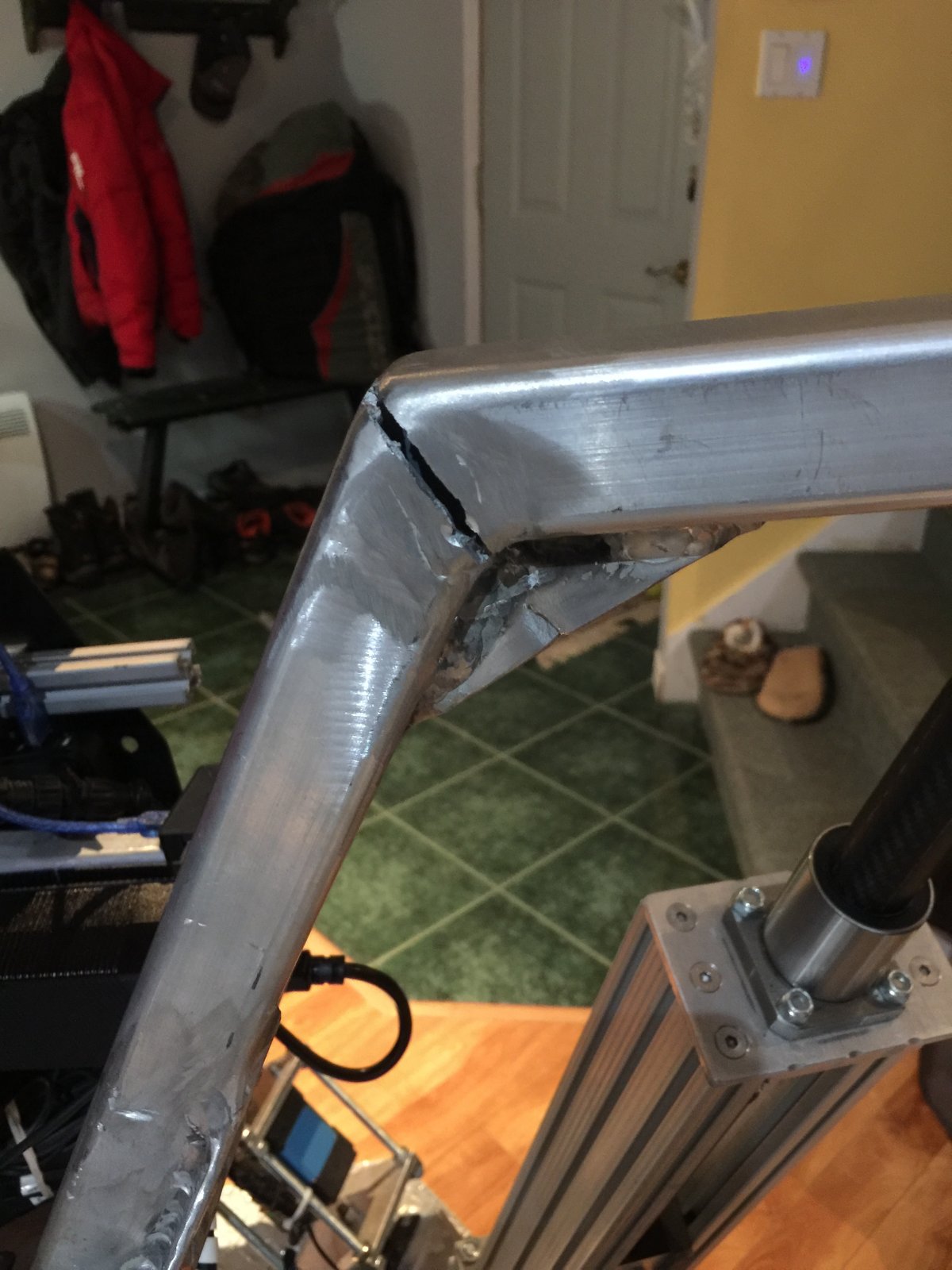

    Big accident at Daytona 500 tonight ( NASCAR ) , My brother(210lbs) came to try my new set up !!
    And hit the wall with others cars !!! Everybody are ok !!:grin
    2 Weeks Off and need repare the back frame little bit stronger!!!

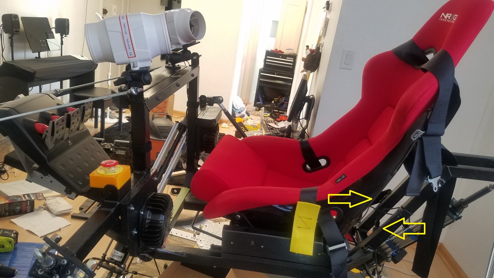

    the gausets that i added afterwards

    The important thing here is that nobody got hurt.
    It`s a great chance it did not happen when it was your wife on it.

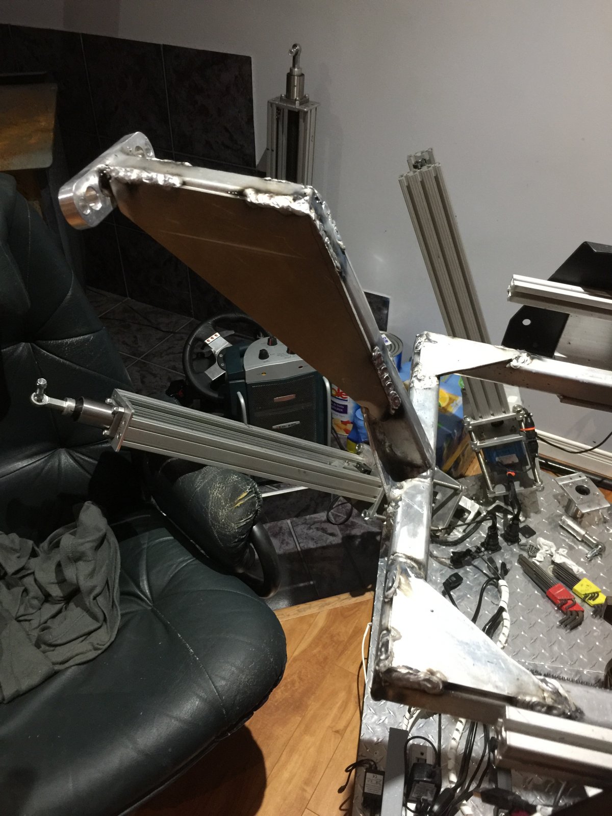

    Yes good idea to do this ! aluminium frame it's lite but fragile and with new vibration ( from FLypt program ) no help at this situation ! Next year I Will chane it for Metal frame , similar like you !
  11. SeatTime
    2,572
    +2,854 / 40 / -0
    When the simulation is too real....:). From my own experiences, even a steel frame needs gussets in the high stress areas.

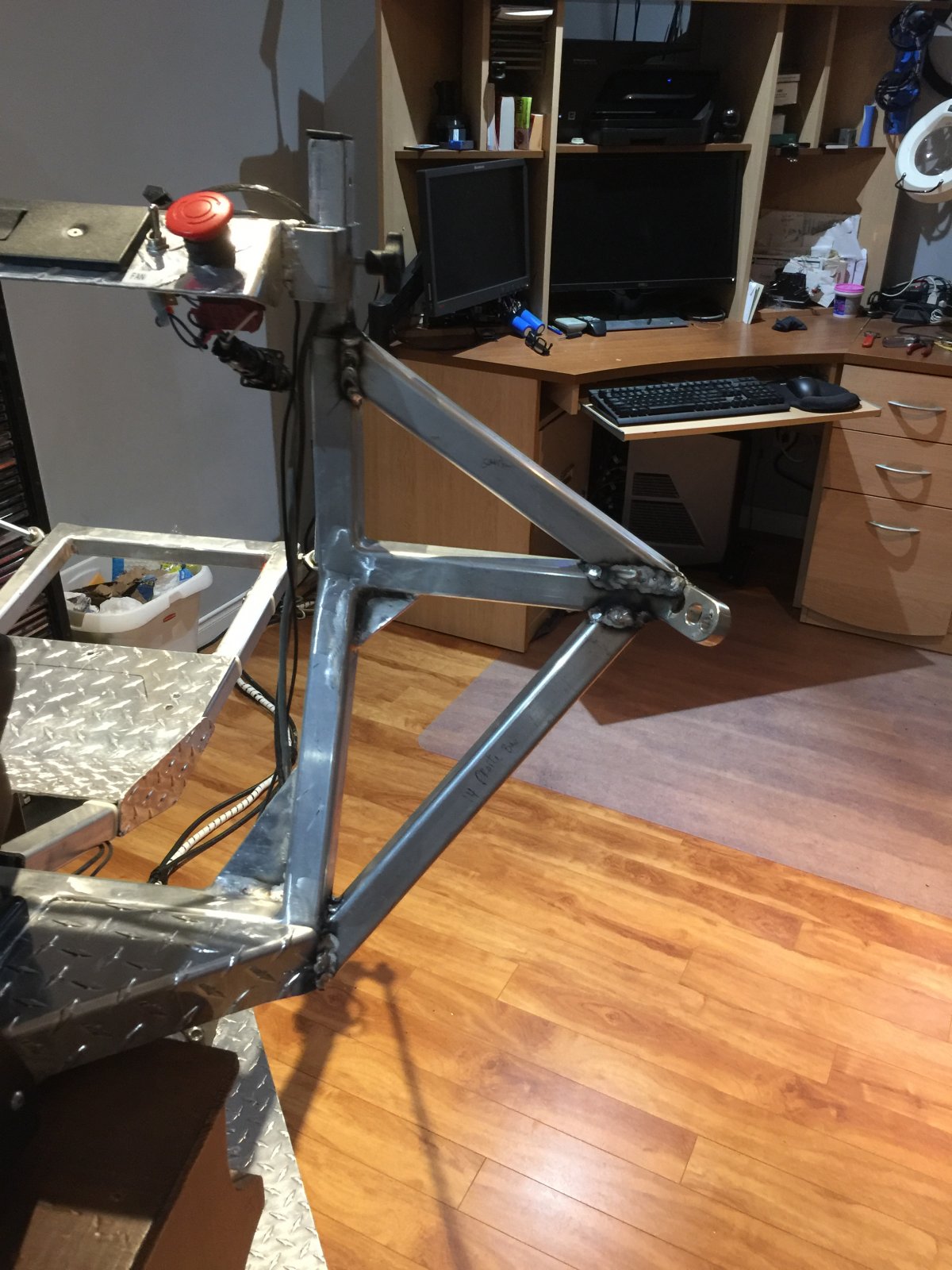

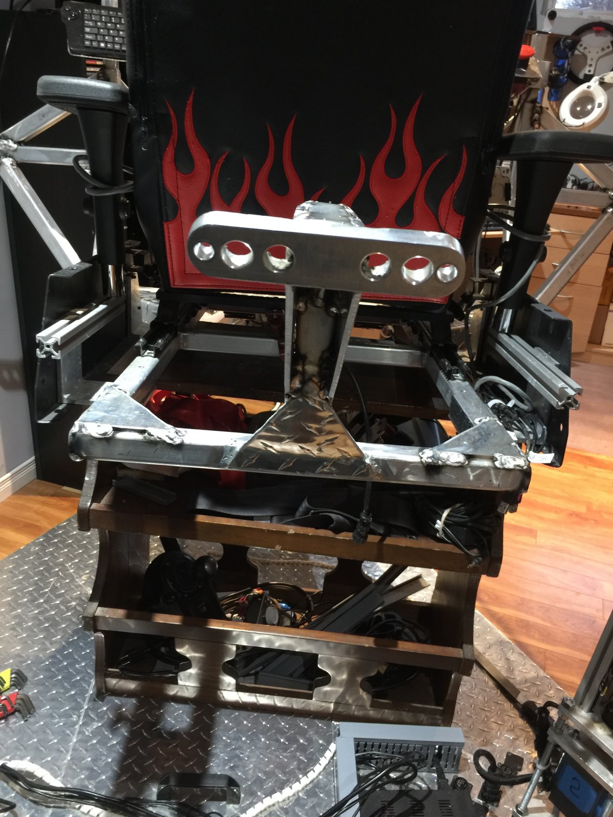

    New up date !!!
    À little bit Stronger !!!

    Droite haute. LOL
    Triangles, that's the way!

    thats some serious welds!

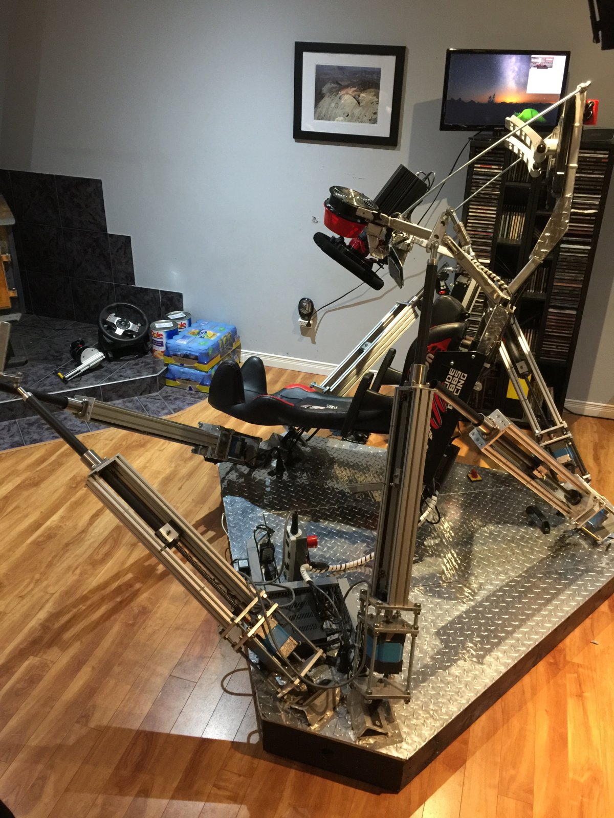

    your 6dof looking like an X-Win FIghter!
