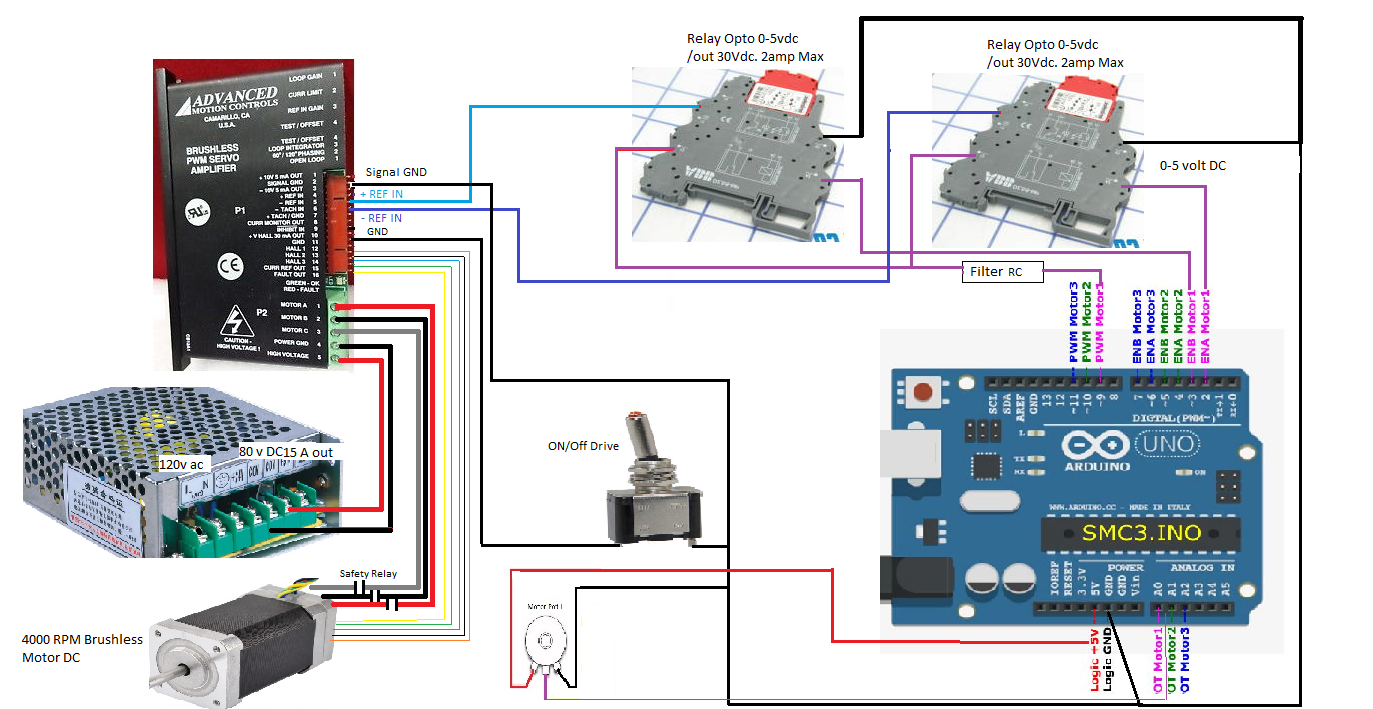

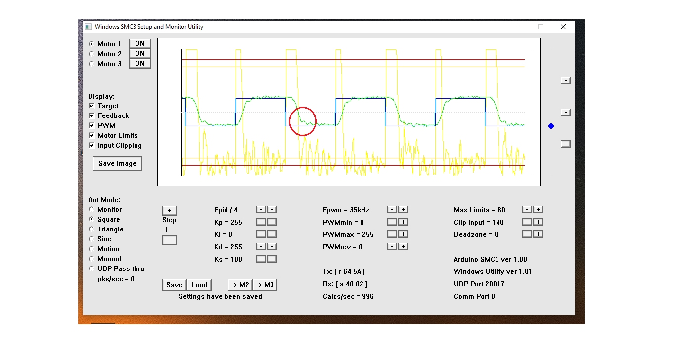

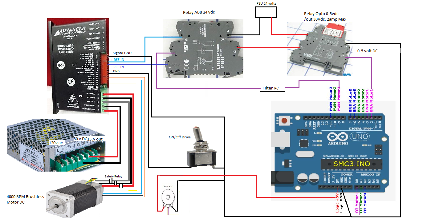

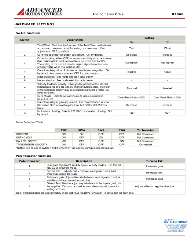

    Finally , I found my problem . I must use two relay Opto 5vdc to control the drive and release the contact relay 24v and PSU 24 v . the response time is much faster like this !!

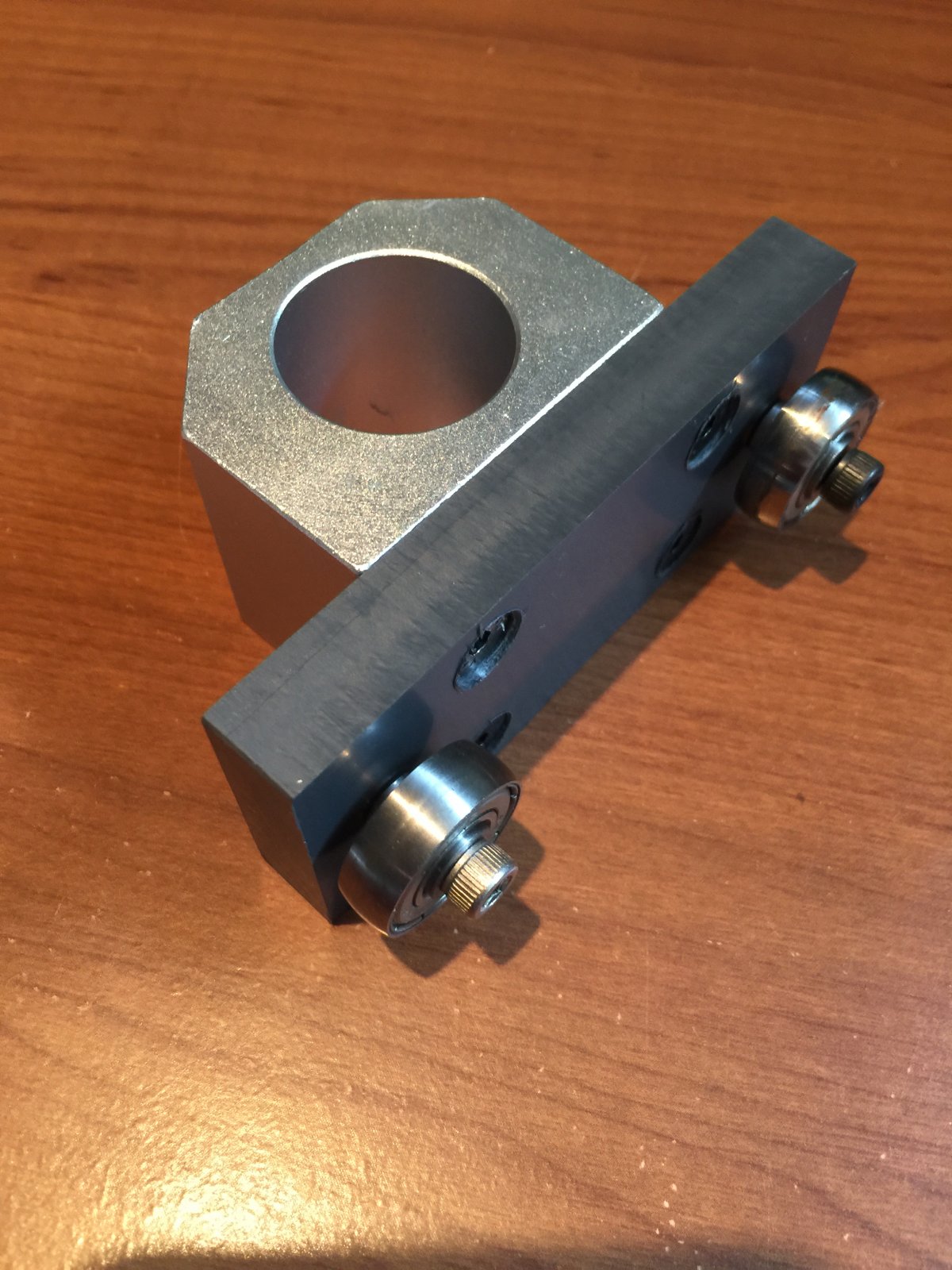

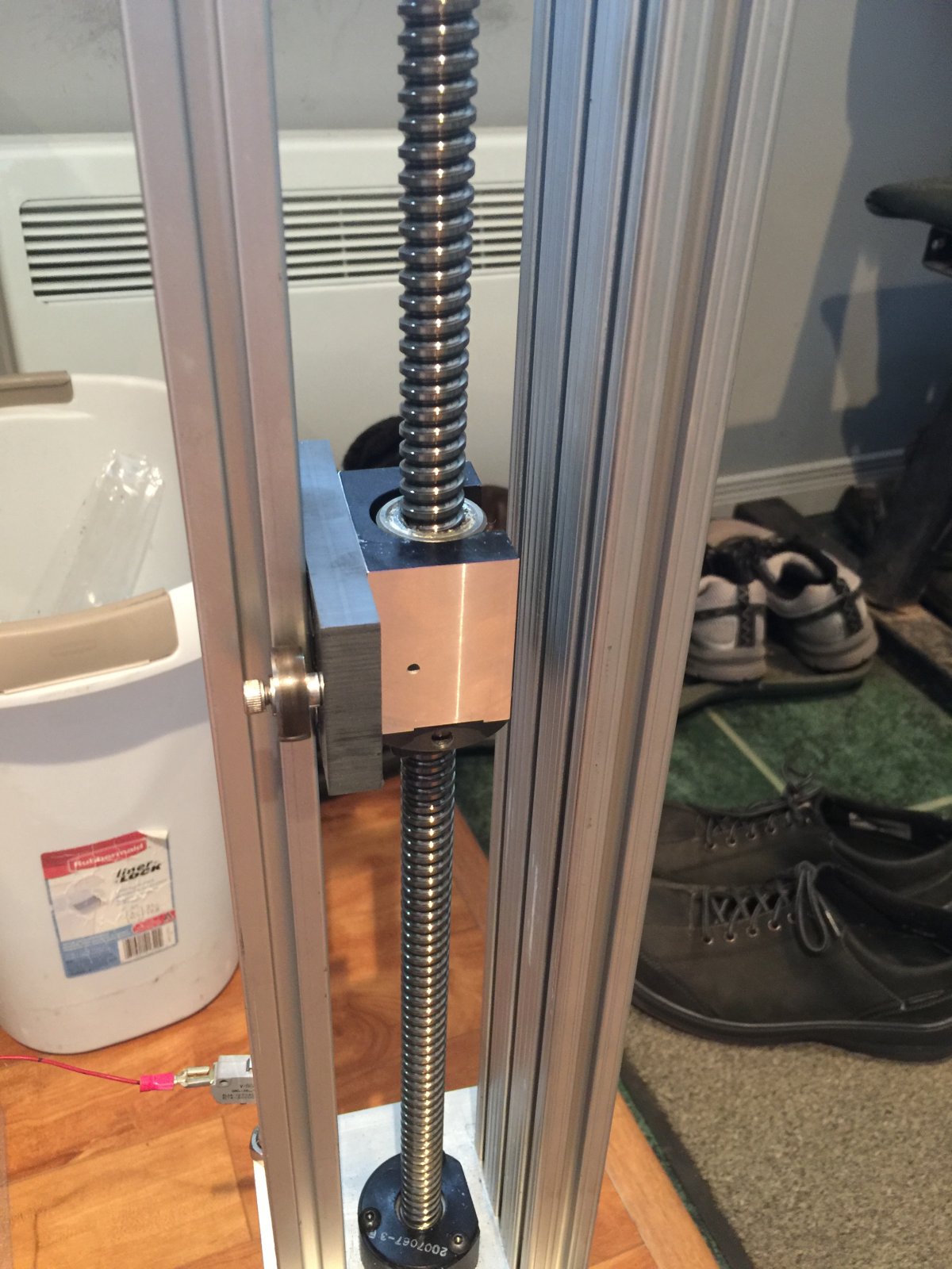

    hey @Flymen what kind of material did you attach the bearings and ball screw nut housing? that plastic block material.. i like to know about it!
  9. Flymen
    May 19, 2018
    355
    Montreal, Canada
    2,503Coins
    +196 / 2 / -0
    DC motor, 6DOF
    yes , plastic PVC that was my last set up ! Now I have a New one !

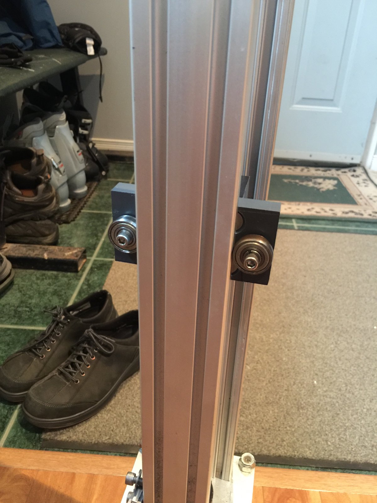

    this photo.. was your old setup? any pics of your new method of linear guide?

    The link send us to a 80 volts? Aren't you gonna fry something? Usually, motor goes at 24v or 12v. Anyway, you know what you're doing. But then, you say 6 x 12 Volts. Maybe you don't know what your doing... :)
    I have 3 times 24 Volts / 12.5 Amps in parallele. I had no problem. No Diode or anything.
    I don't understand your regenerator problem with batteries.

    hey @Flymen i like to ask, what size bolts did you use to attach your Vslot aluminum rails to your plates? i plan to use M5 bolts, but i am trying to figure out what length the boths should be...
    asking @wannabeaflyer2 as well.. :)
  14. wannabeaflyer2
    Jun 12, 2015
    724
    london uk
    8,362Coins
    +958 / 7 / -0
    Hi @hannibal if memory serves me well I used Set screws with at least 20 - 25mm Threaded into the Extrusion . remember the plate you use will be a factor in screw length , so overall I allowed for Support Plate material thickness + 20mm minimum , that ensured that I had at least 20mm Of full thread contact in the extrusion.. Hope this helps ,
    It may be overkill with thread depth but would not hurt so what the heck :) that's what I used in my assemblies
  15. Flymen
    May 19, 2018
    355
    Montreal, Canada
    2,503Coins
    +196 / 2 / -0
    DC motor, 6DOF
    yes , 5mm was perfect for this without drilling and only tapping for me ! total length with v 30mm or 25 mm thread ! My plate have like 10 mm

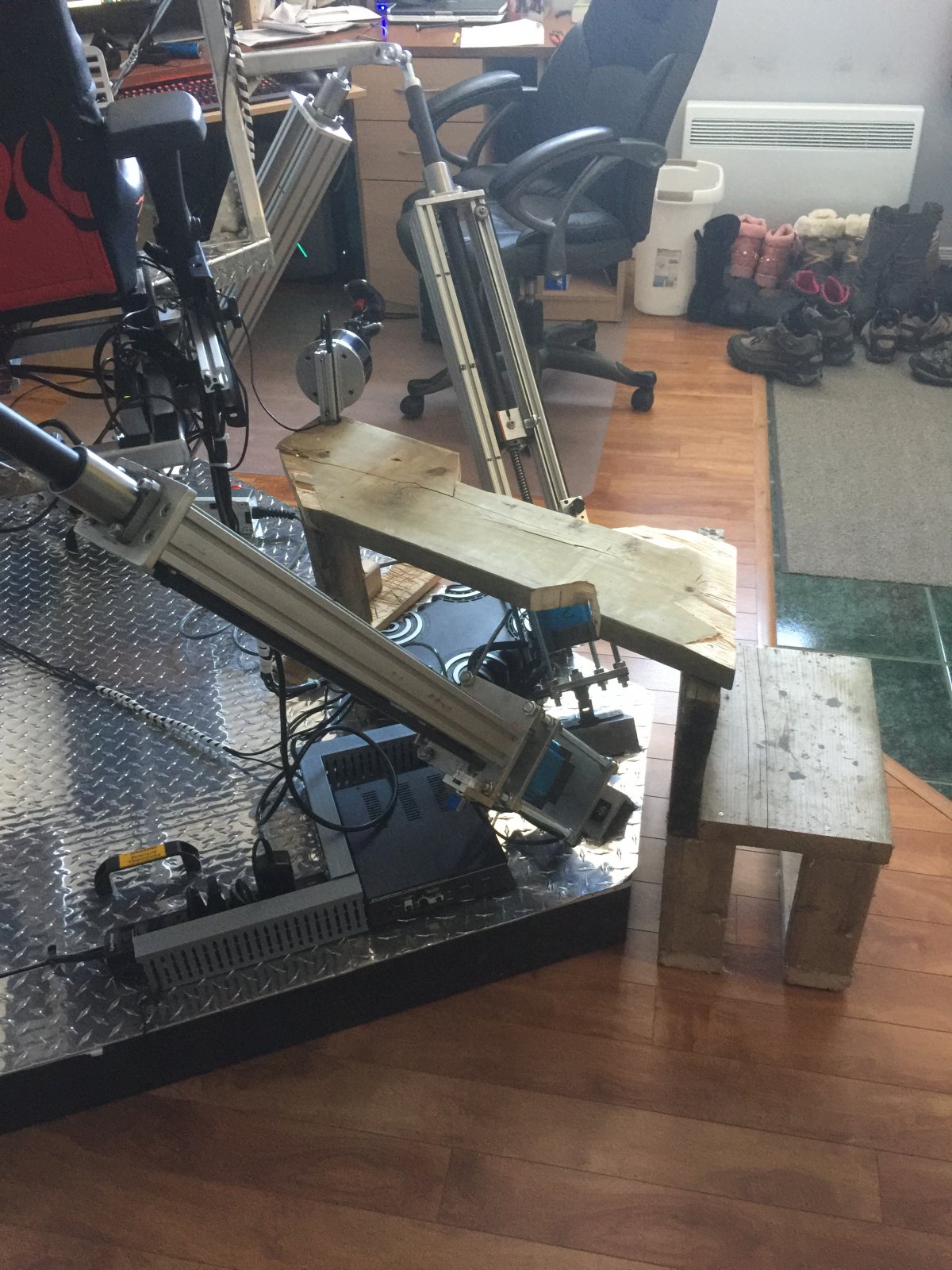

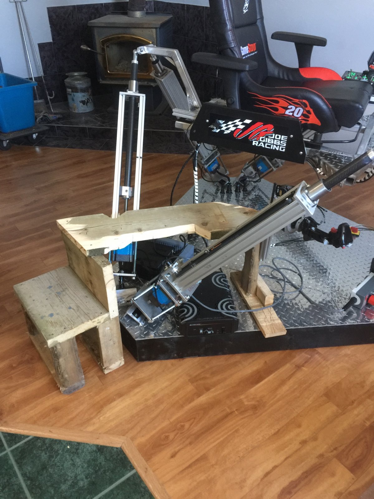

    Temporary set up to access on the seat !!

    amazing work @Flymen ! let see you ride that bad boy!
