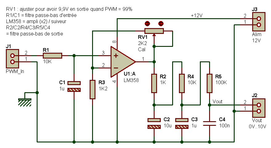

    This is overkill, perhaps a simple RC filter would do same with R=10k and C=100uF
  5. Flymen
    May 19, 2018
    355
    Montreal, Canada
    2,503Coins
    +196 / 2 / -0
    DC motor, 6DOF
    I will try this tomorow !!!

    ok …. ouff finaly the filter must be between the level shifter and the drive !! And the Command Sources drive must give
    + 10 and -10 volts perfect , for example,if one side is + 10v and the other -14 volts ... nothing work !!!
    This video show the speed of signal PWM with filter ( sorry I don't have oscilloscope) before level shifter 0- 5 volt and after filter with ampli (normaly: 0-20 volt ) .
    The right meter show : when it over 10 volt the actuator goes up and when it below 10 volt he goes down ! and the left one 0-5 volt PWM with this code :
    // wait 100 milliseconds
    delay(1); // Change value to make change in speed faster or slower
    // Change speed
    outputValue+=increment;
    if(outputValue==170 || outputValue==88) increment=-increment;
    Conclusion : I need amp to follow input 0-5volt like LM358 . 0Volt IN = -10Volt Out and 5 volt In = +10 volt Out or total= 20 volt
    Next step is this :
    http://henrysbench.capnfatz.com/hen...rduino-lm358-op-amp-pwm-to-voltage-converter/

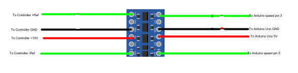

  12. Flymen
    May 19, 2018
    355
    Montreal, Canada
    2,503Coins
    +196 / 2 / -0
    DC motor, 6DOF
    Answer : I would like to do this :(one pin for two directions but , my last experience with the level shifter +/- 10 volt from Command Sources drive must give
    + 10 and -10 volts perfect , for example,if one side is + 10v and the other -14 volts ... nothing work !!! Each of my 6 drives gived+ 10 and -10 volts perfect and after the test with PWM and level shifter , one side have change to +10v for +14 volt ..May be a Bad luck Idon't know but if I repeat the experience I'm afraid to blow another drive ..( she work again but not for this way ) .

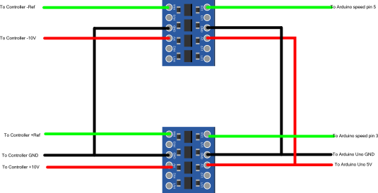

    Finaly I take another chance with one output :blush:popcorn
    with your first code is like this !!
    Yellow multi :0-5volt PWM
    Gray multi :after level shifter and filter +/- 10 volt ( over 0 volt goes up / below 0 volt goes down) actuator .
    Black multi : the one who must stay at 20 v and no more (Command Sources drive must give + 10 and -10 volts perfect) . You can see with the multi gray that he pass more time in negatif than positif time ! and slower than yellow one too!
    I try to put the code more faster but i'm not eable . I changed the delay for 1 ( this video) but it's still not enough short ! but working and stable with less noise .:thumbs
    this video is with delay: 100

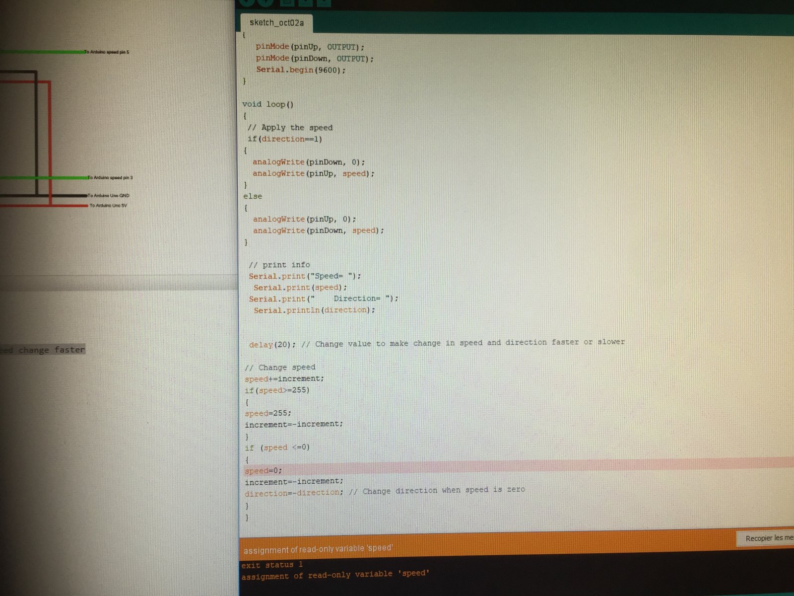

  15. Flymen
    May 19, 2018
    355
    Montreal, Canada
    2,503Coins
    +196 / 2 / -0
    DC motor, 6DOF
    code erreur ( speed variable) .JPG code erreur ( variable speed )
    Thanks a lot for your help and time , I really appreciate! hug:
    It will be like this ! more simply and it is not necessary to have -10 volts from driver to control input - REF IN
  16. pmvcda
    pmvcda aka FlyPT
    Nov 3, 2010
    2,296
    Portugal
    16,036Coins
    +2,746 / 18 / -0
    Sorry, copied the const int... it should be just int in the definition.
    Code corrected, copy again please.
    speed, increment and direction should not be constants.
  17. pmvcda
    pmvcda aka FlyPT
    Nov 3, 2010
    2,296
    Portugal
    16,036Coins
    +2,746 / 18 / -0
    :eek:
    OK, I tried to compile it and...
    speed and direction are keywords of the language, so I added an x on the variables names.
    Please copy all the code and try again. Really sorry.

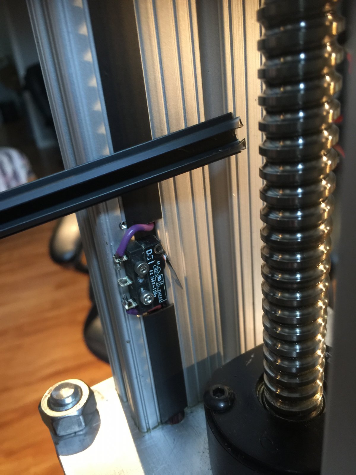

    You can adjust the delay for the size of your actuator, but without limits you risk to damage the actuator or burn the controller.
    You need to get some feedback for position and also the limits.
  20. Flymen
    May 19, 2018
    355
    Montreal, Canada
    2,503Coins
    +196 / 2 / -0
    DC motor, 6DOF
    Yes it work ! thanks
    but the delay haved change 20 to 1 and still too long !
    A chance that I have limit switch , the actuator goes every time there :grin and i'm still waiting of this product again ( the compagny are very slow ) !! https://lsicsi.com/#/products/Development-Kits/LS7366RSh , for feedback position and also limits !
    Send me your adress and I will ship this gift for your support ! IMG_0612.JPG
    It's clean and snap right there with space for some wire !!
