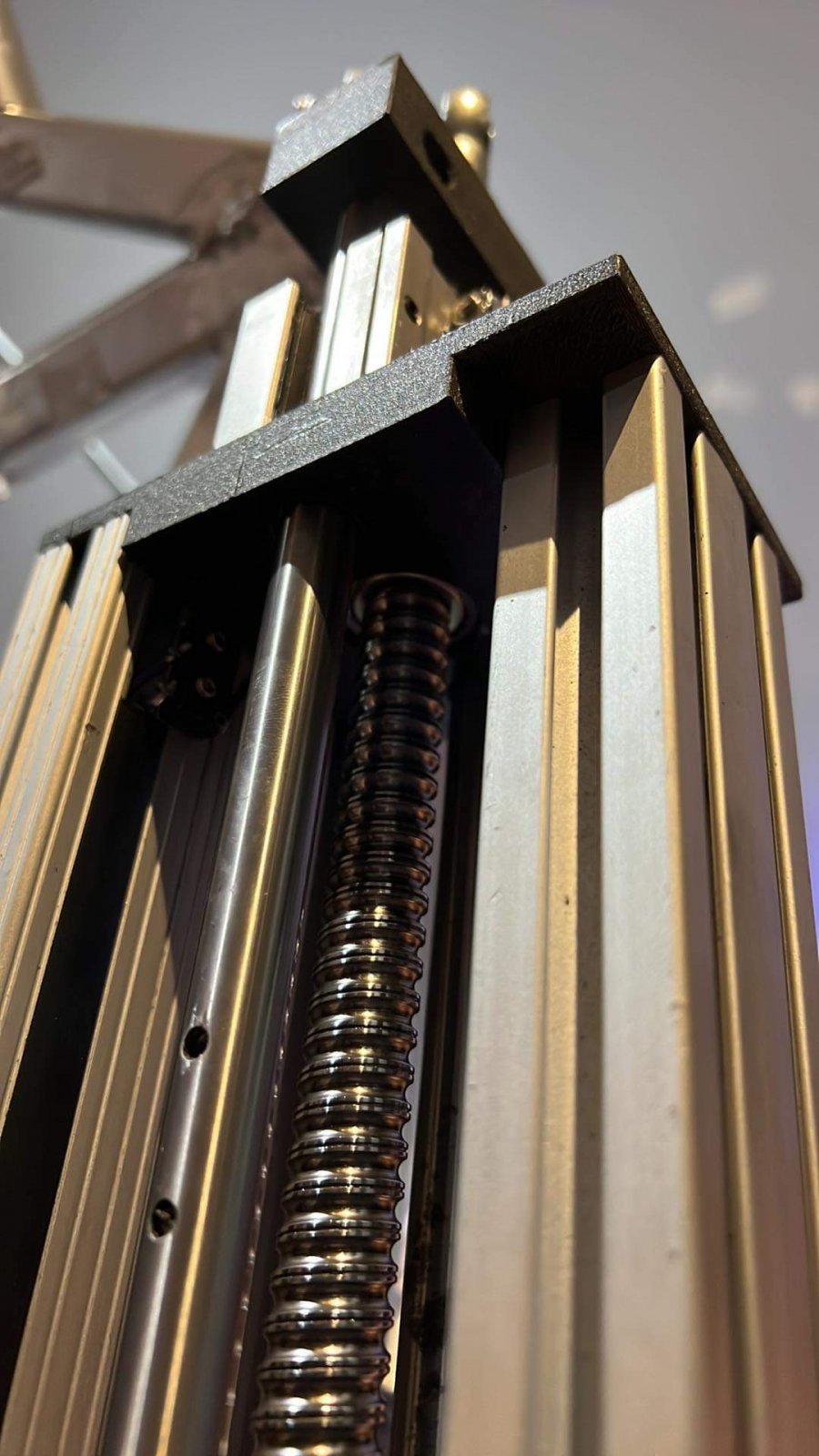

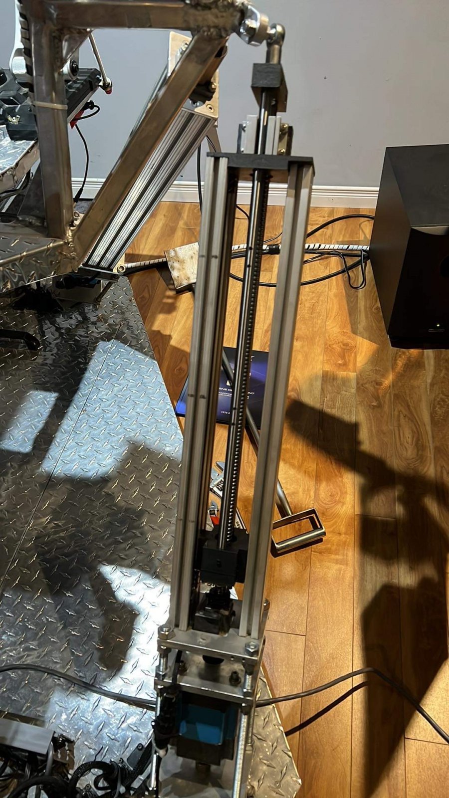

    We will see it !!! For the moment it about 50% less noise and smooth for just one… if everything goes well in the future … I will change 5 others

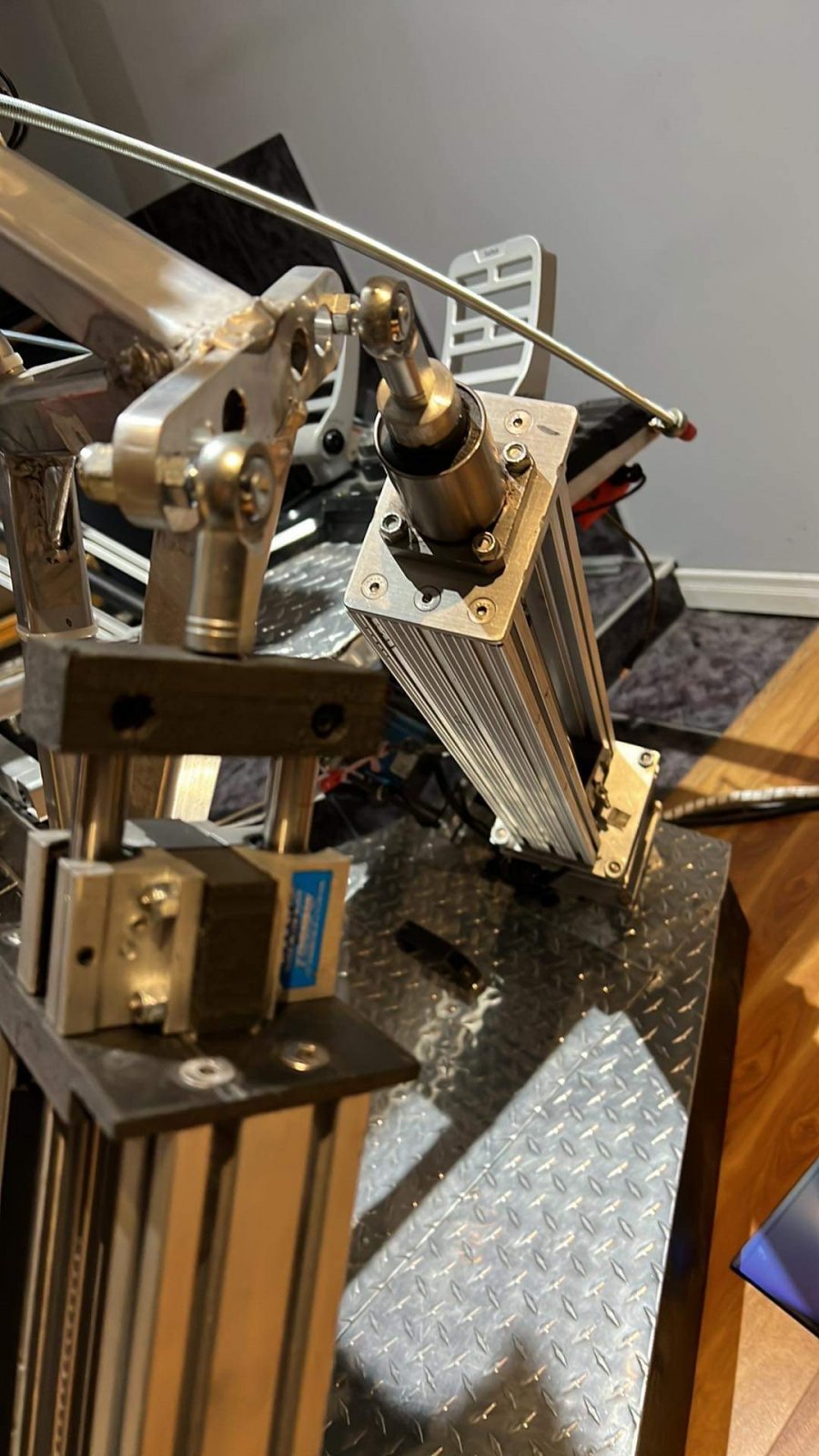

    Hi @Flymen!

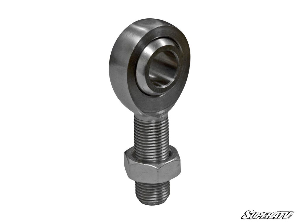

    Happy to see another quebecois in sim plateform. I am currently working on one also similar and I was wondering how tge actuator were attach on your setup. Is the bottom part of the actuator attach using a universal joint that does not rotate and top part attach with a ball joint that enable rotation? I saw somewhere else that 1 of the attachments point need to rotate. Best

    Bienvenue Frosted123 (Je suis un Drummondvillois travaillant à Matane).
    My 6 DOF had a universal join at the bottom, not turning. At the top, is a piece similar to this. It is called a Helm's joint.
    Pierre.

    .Hi , you can put a bigger joint then my mine , like silentchilds with 3D print

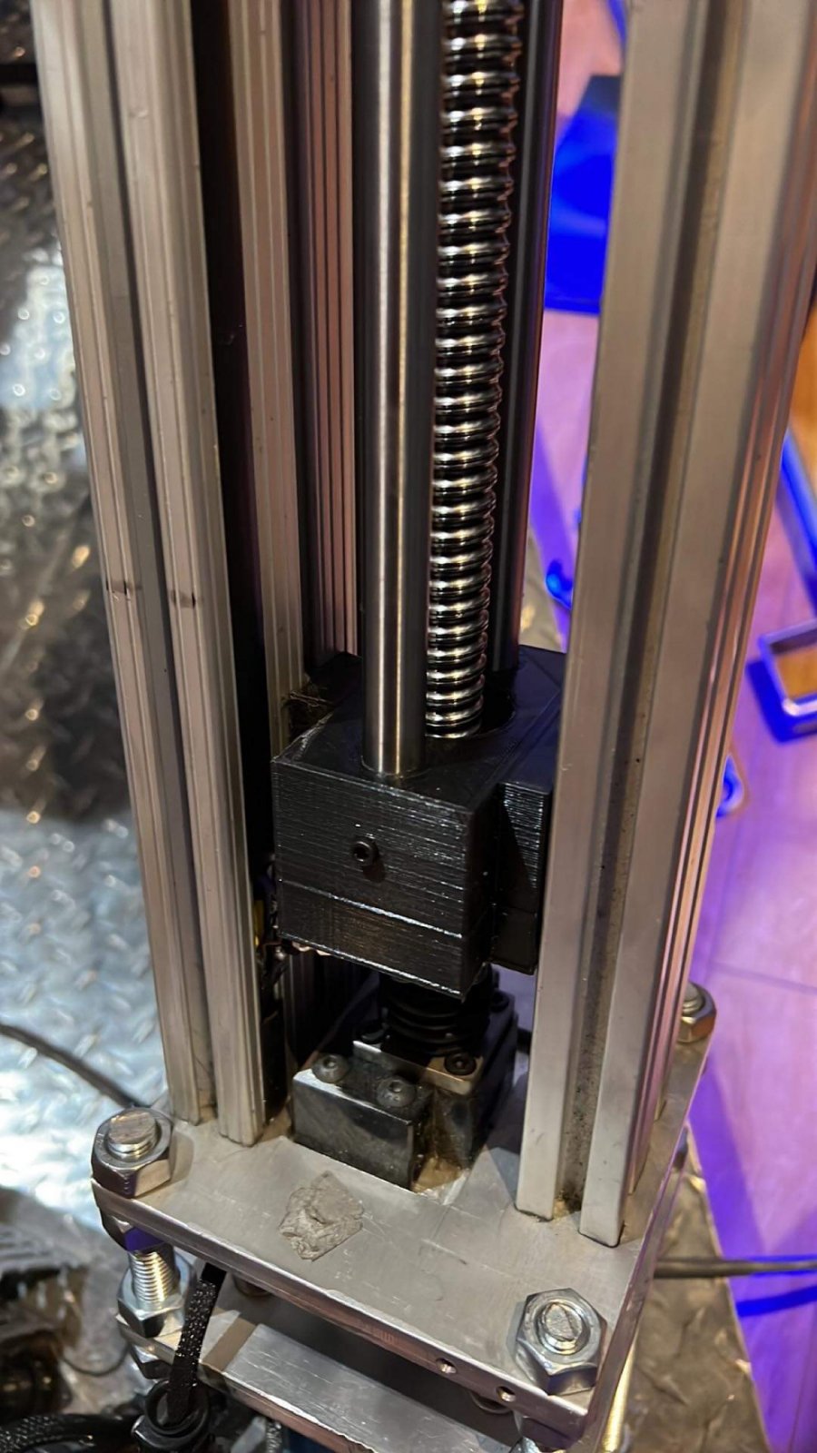

    Another question, I saw somewhere something about an anti-wobble kind of ring that can be fix to the top of the ballscrew. Would one of you be able to share the design?

    Hi, here is my version.

    It's better if you put a bearing like my last set up ( and two rod ) . the plastic Anti woble is a plaster . go for it with bearing like me or Silent child .
