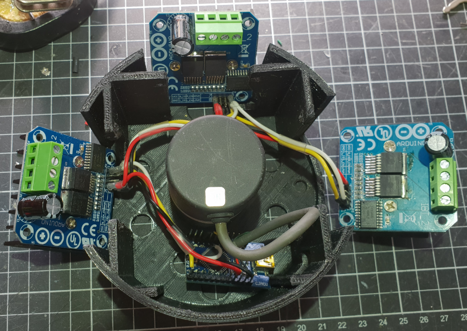

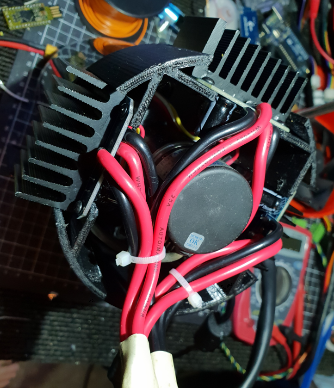

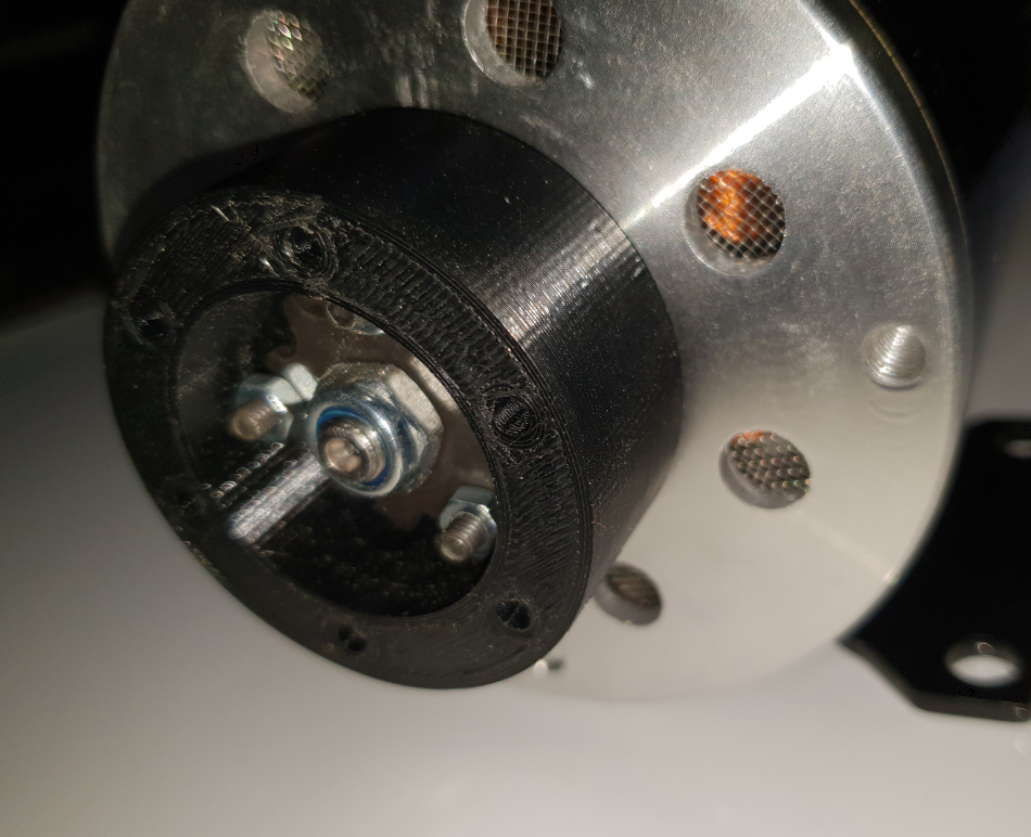

    DC motor
    Maybe you wanna see my build. I used MY1016 but using belt driven and they running with MMOS.
    My build:
    My test:
