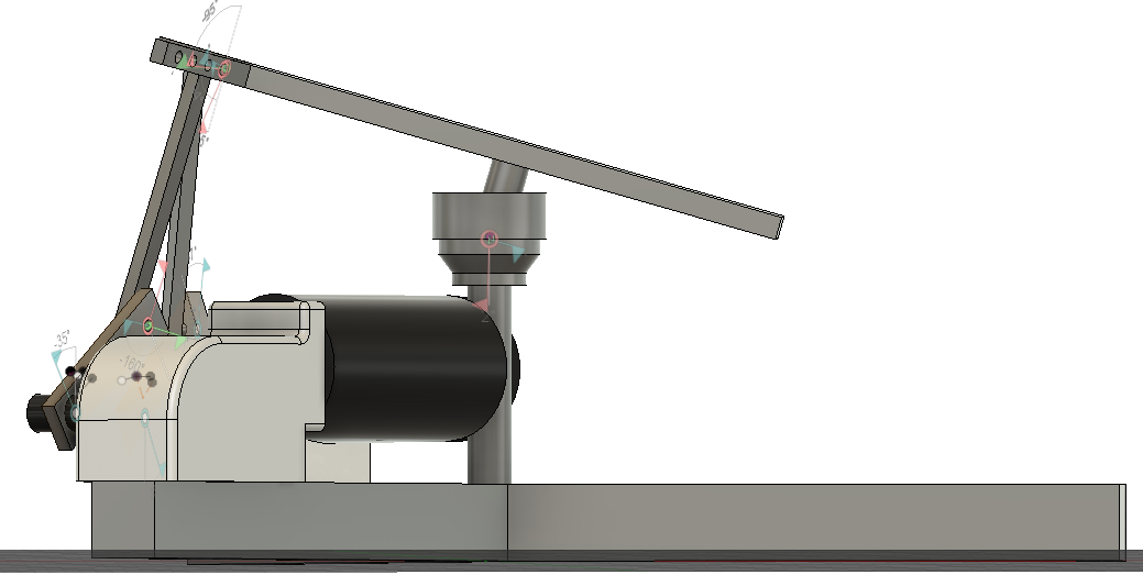

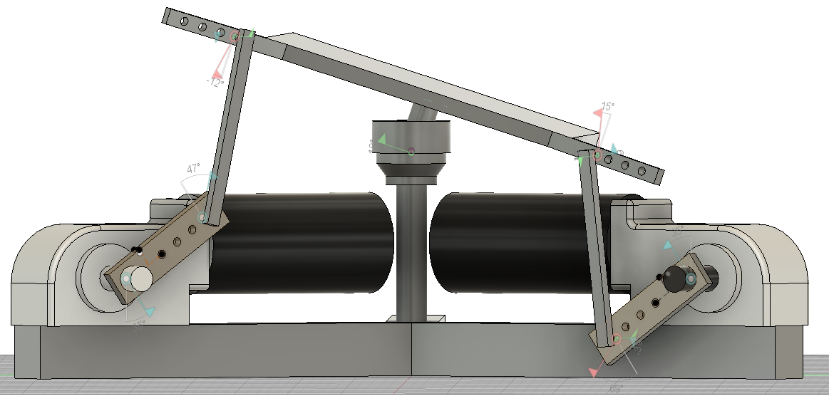

    Hi all, I am starting my first motion sim build so this will be the log for it. I have collected pretty much all of the parts i need to begin construction and I am now trying to design a compact setup.
    Basics:
    Full motion 2DOF sim (not a seat shaker)
    BIG Wheelchair motors
    Modded/Hacked wheelchair controller - controlled with Modded version of SMC3 Code
    CV joint for pivot

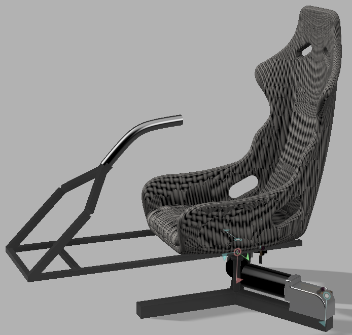

    I am trying to design something that is fairly simple to construct but should be durable.
    This is the design I have come up with - Is it just pointless and should I stick with a generic square format? Is there any disadvantage to this design?
    It provides 20 degrees of movement on all axes with only about 35 degrees of swing either way on the motor axes (100mm CTC)
    Welcoming feedback!

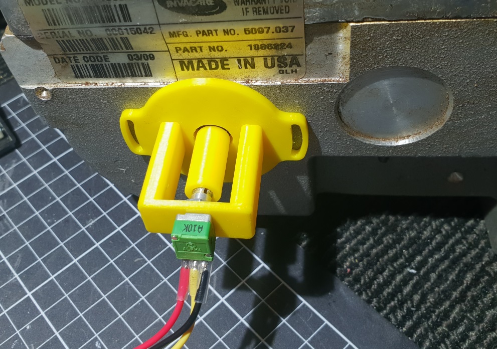

    Position sensor feedback on motors
    Some of you may have seen my other post on the Wheelchair controller. I was testing using some cheap pots from a local supplier but then I decided a better way to go is with Hall sensors.
    I used UGN3503UA Hall Effect Sensors and some 4x4x2mm rare earth magnets salvaged from a dead RC brushless motor I had lying around (I fly RC racing quads...)
    This is what I ended up with...
    2018-10-17_09h51_56.png 2018-10-17_09h53_15.png 2018-10-17_09h54_40.png 2018-10-17_09h55_11.png 2018-10-16 21.15.53.jpg
    Unfortunately the legs on the hall sensor are a bit too short so I added a recess into the back of the holder to allow for soldering wires but I have not printed that version yet.
    This is what the pot version looks like mounted to the motor - I intend on drilling and tapping 3mm holes to secure the mechanism. The holes are elongated to allow for center fine tuning.

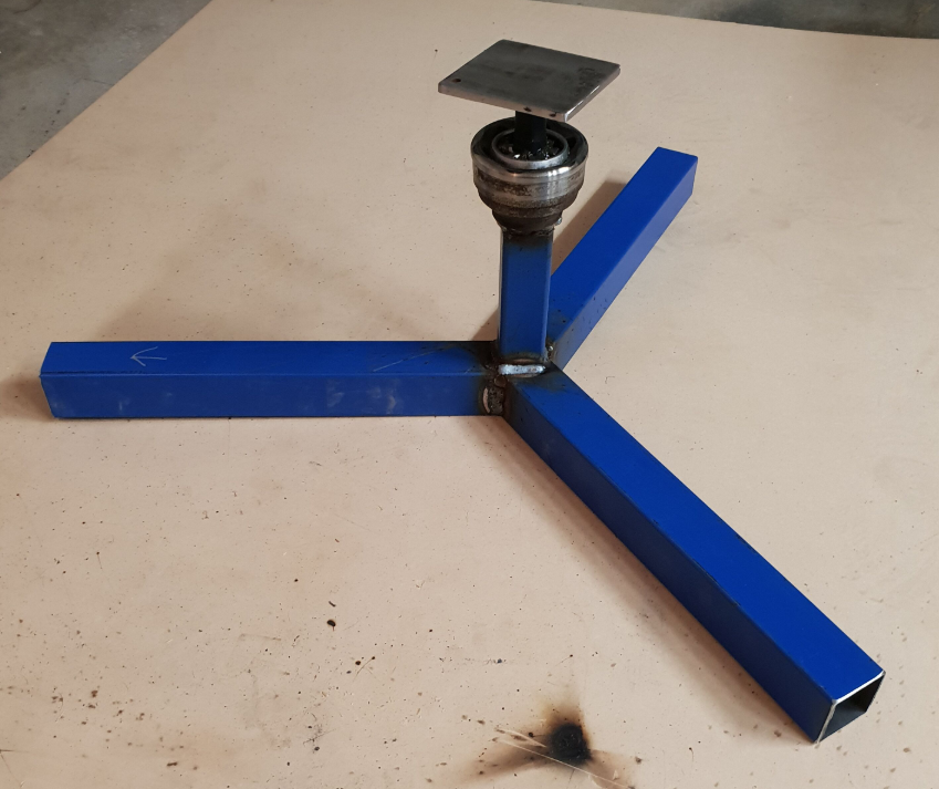

    So I started on the frame base today
    Welded up the Y frame and mounted the CV Joint.
    Tomorrow:
    Weld the plate to the CV joint and make up a seat base that will bolt to the plate.

    I finished welding on the seat mount and I have done a concept design for the upper frame.
    I'm torn on the simplicity of a single mount for the wheel and pedals (meaning you end up with the wheel mount between your legs) or this type of design.
    dimensions subject to change...
    I'd appreciate comments for/against either ideas.
    21,582
    151,106Coins
    My view is the more powerful the wheel the more chance of flex with the forward mount design, so what type of wheel do you intend using?

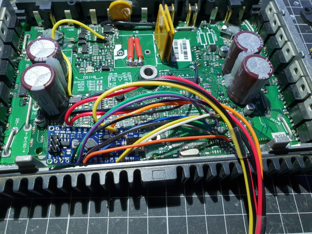

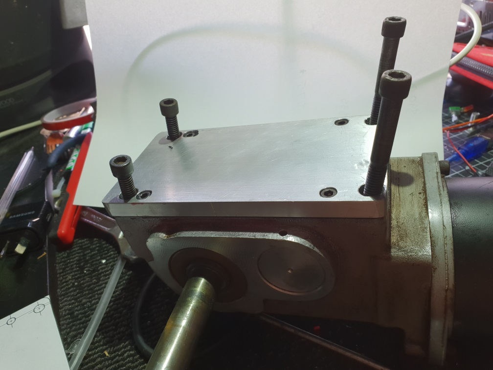

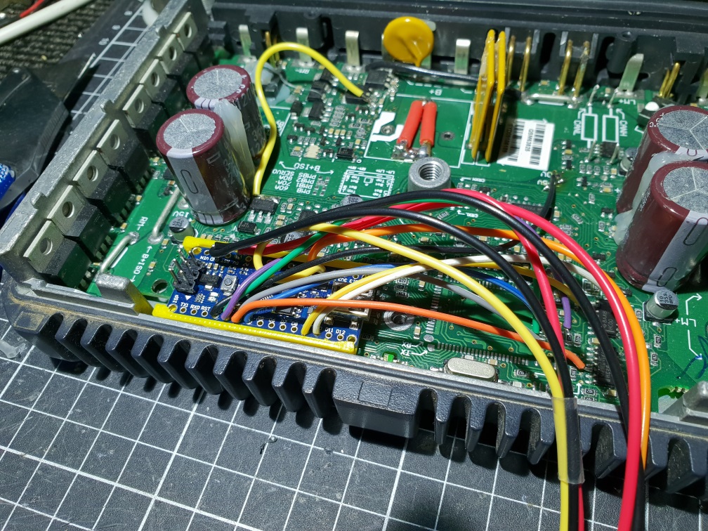

    Small update - So after waiting 4+ weeks for my Arduino Nanos to arrive, I discovered that I accidentally ordered the Atmega168 version and not the Atmega328 version - Doh! Luckily, the SMC3 code still fits on the 168 (It has less RAM and Progmem but runs at the same speed).
    I soldered it into the wires from the wheelchair controller and tested it ok. I also printed a small holder for the Nano so I can safely secure it inside the unit.

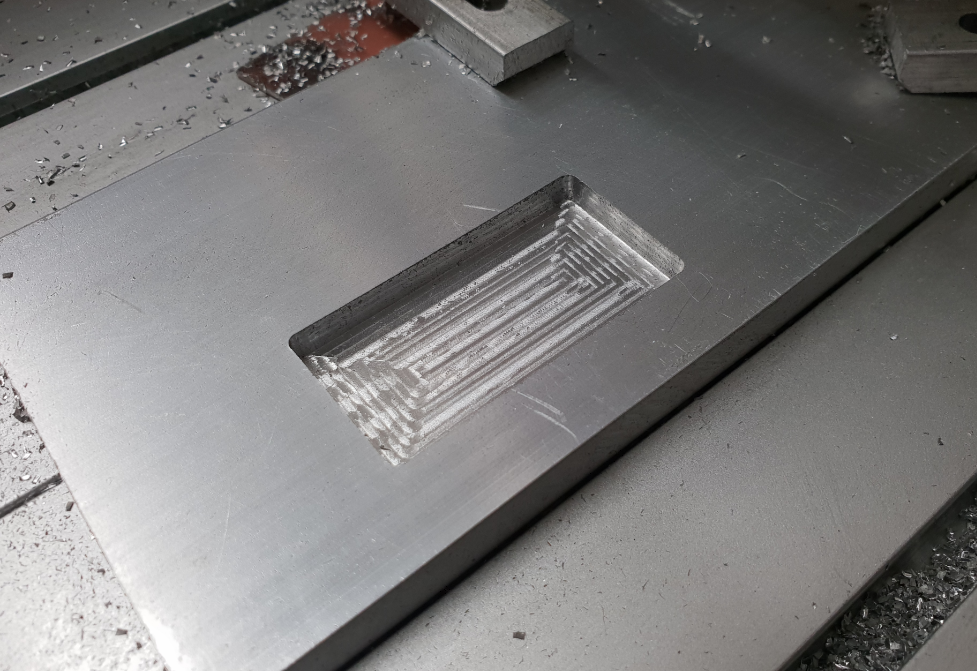

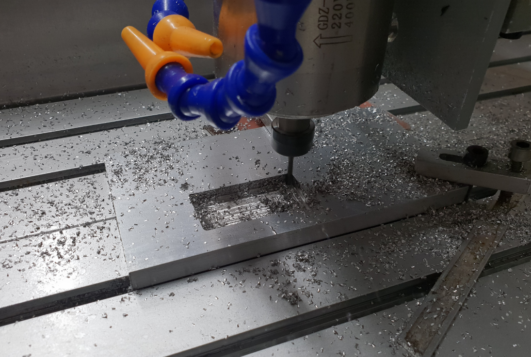

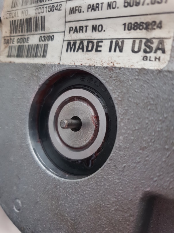

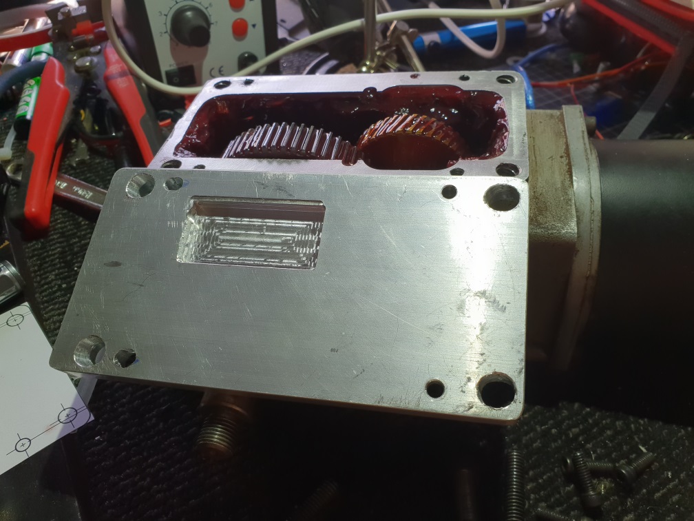

    I have made up new gearbox covers for the motors as the original ones were angled and I wanted a flat mount. 10mm Aluminium with a pocket machined out as the main output gear comes past the machined surface of the gearbox.
    One thing that I did not realise until after going down this path was that the main motor mount bolts are actually on an angle too. It's not that harsh of an angle but annoying. Too hard to change - If i have to I will make up some angled washers for when it is bolted to the frame.

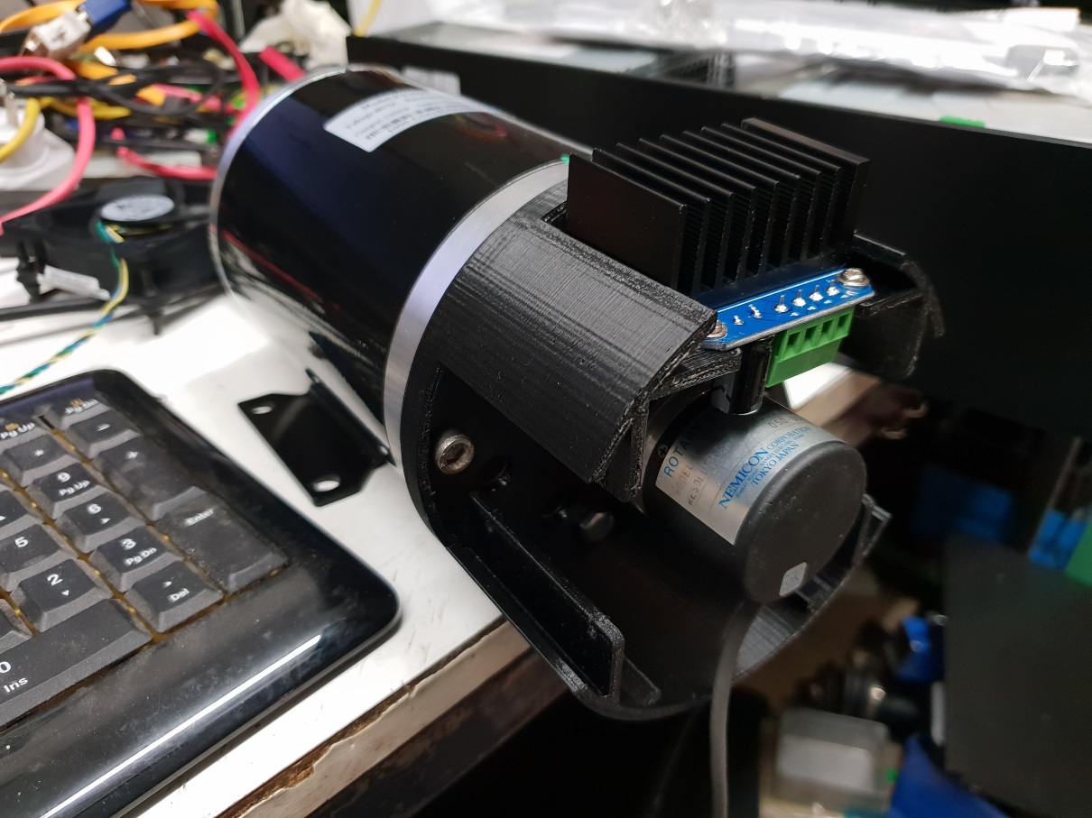

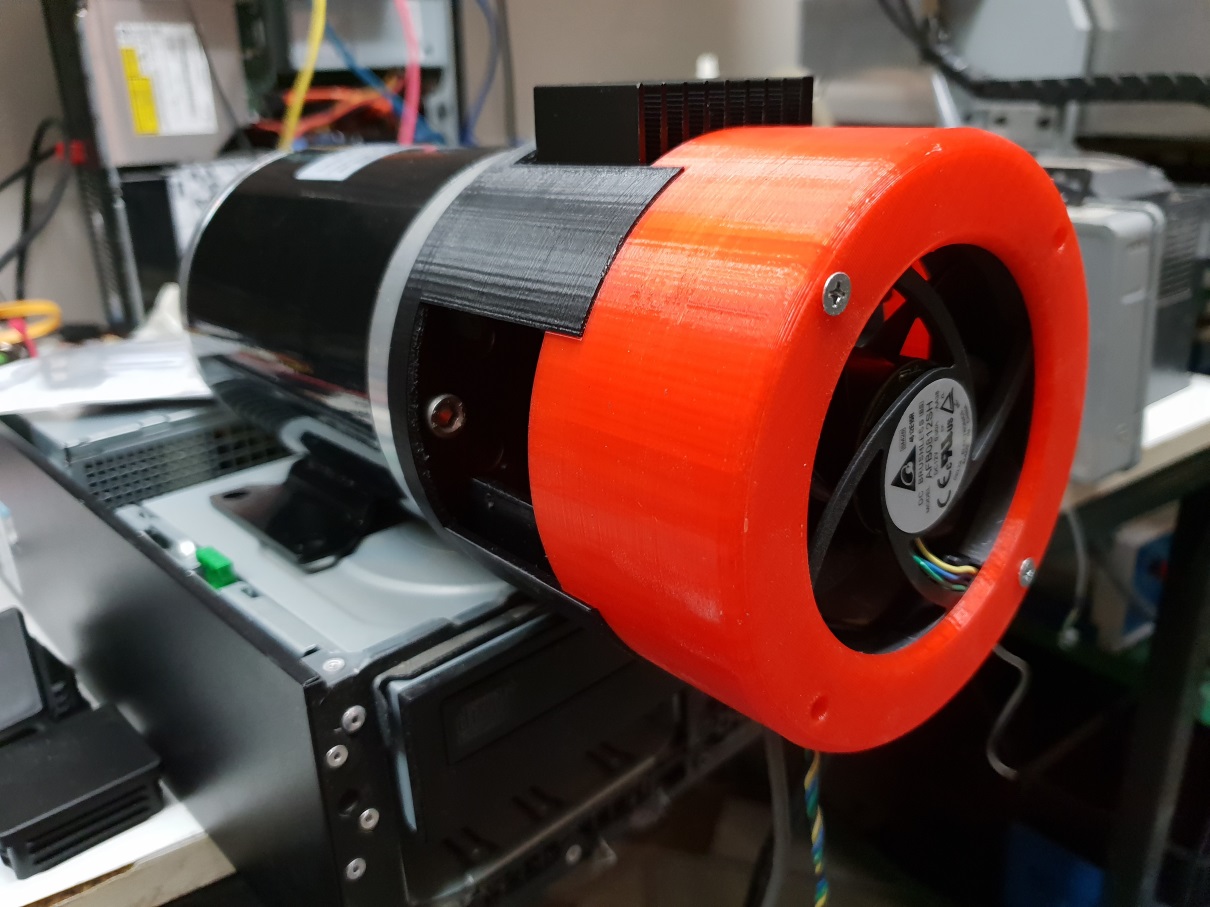

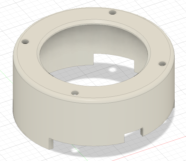

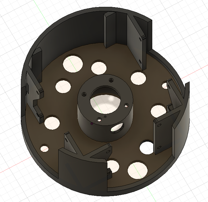

    I have decided to do a full rework now and have scrapped my G27 in favour of the MMOs DD wheel ('Cousin of OSW' thread here). I have also decided to make some new pedals too. Something lighter and more compact than my previous sim pedals.
    I acquired a 1000W 48v DC motor from Motion dynamics, ordered a few IBT_2 H bridges and an STM32F4 board.
    I took the idea of the work of .dumbass (Member here) who designed a mount for the rear of the motor to mount all the wheel bits. His design was not quite what I wanted so I re-drew his idea into something that works for me.
    2018-11-11_11h11_53.png 2018-11-11_11h12_12.png 2018-11-09 19.56.06.jpg 2018-11-10 12.51.57.jpg

  14. elnino

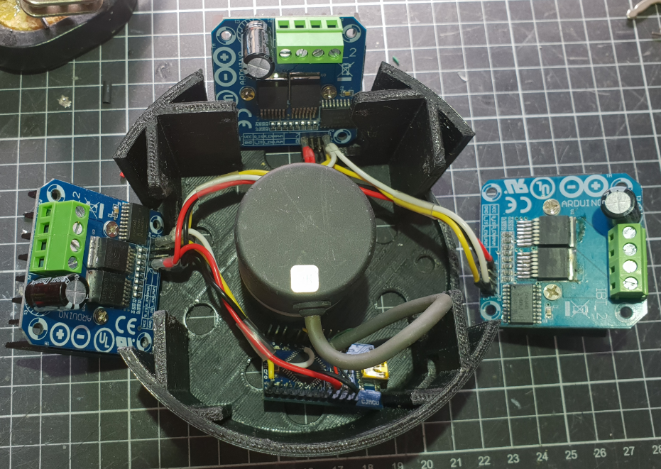

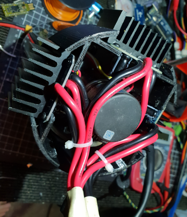

    Done some more work on the wheel today. Still waiting on my stm32 board so using a pro micro for now. Annoying that it landed in australia back on the 6th and i still dont have it!
    I removed the green screw connectors from the ibt2 boards, scraped away some of the coating and soldered the wires direct to the boards. Many of the green connectors had stripped screws anyway.
    Reflowed the chips on the boards to fill in all the vias to help with heat transfer. I also added a thin heatsink pad between the heatsink and the board. I am not confident that the heatsink is properly isolated in the stock form and we are dealing with big current potentials.
    All smoke tested ok other than needing a pullup on the zref encoder i forgot.

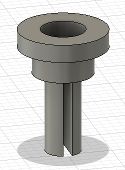

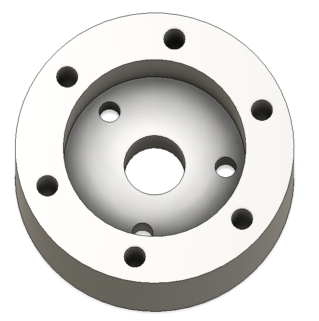

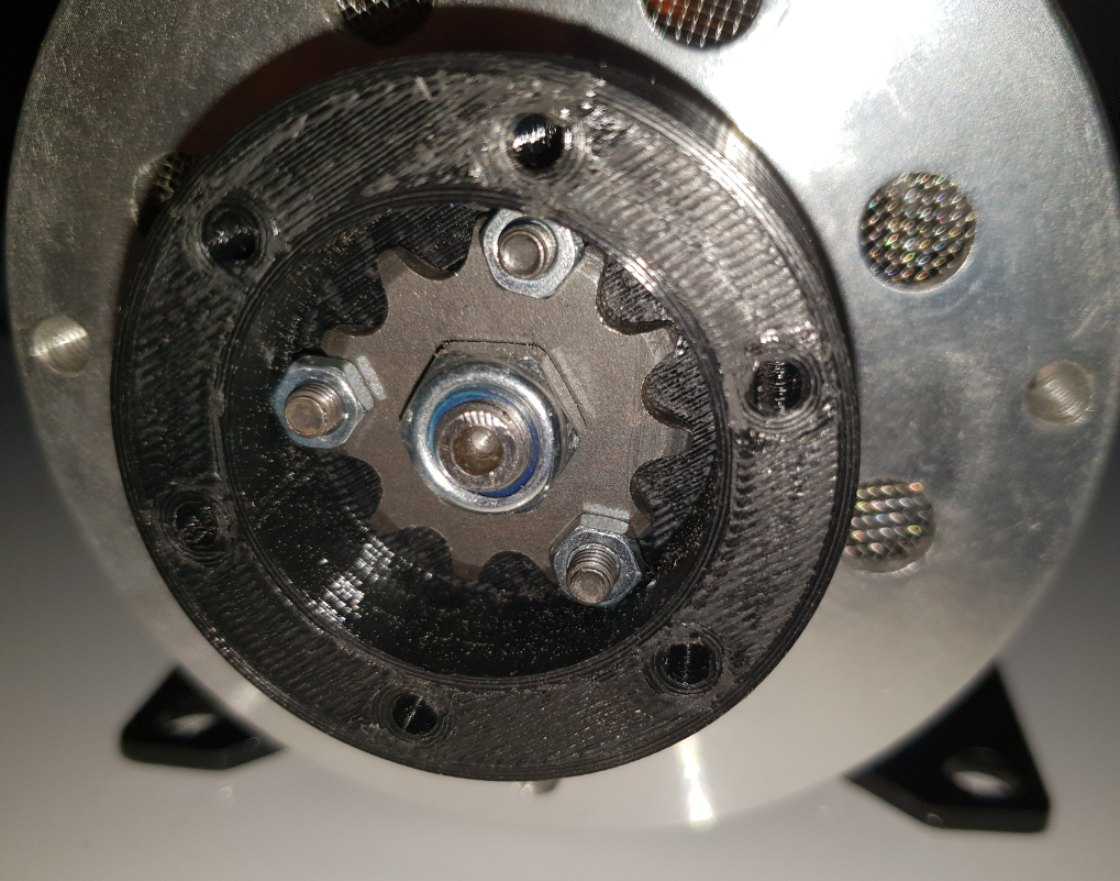

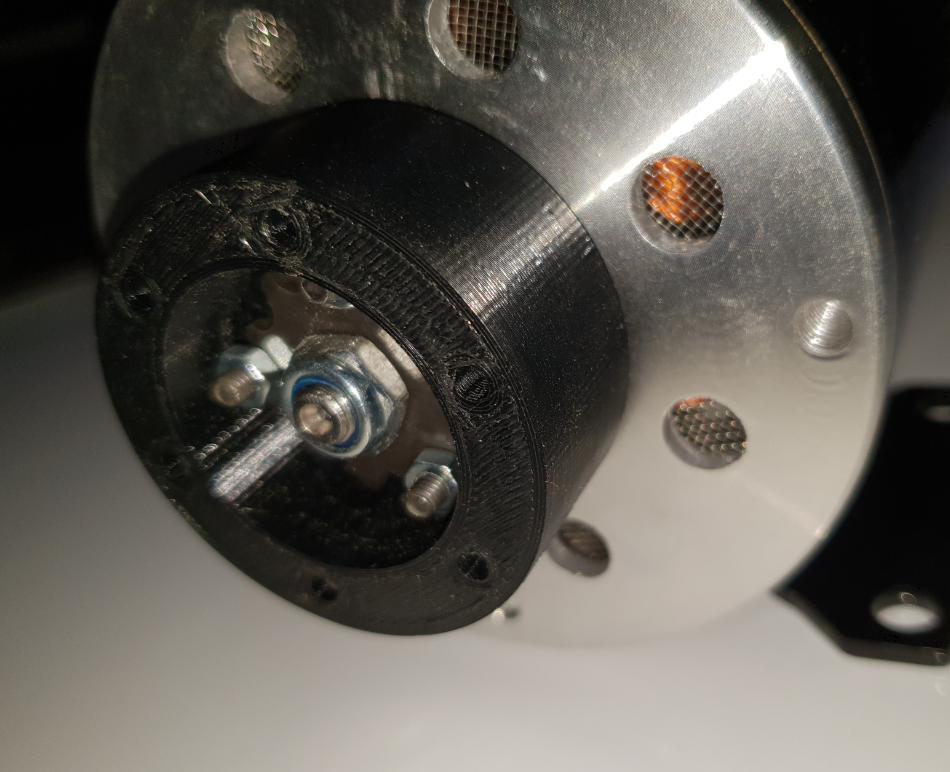

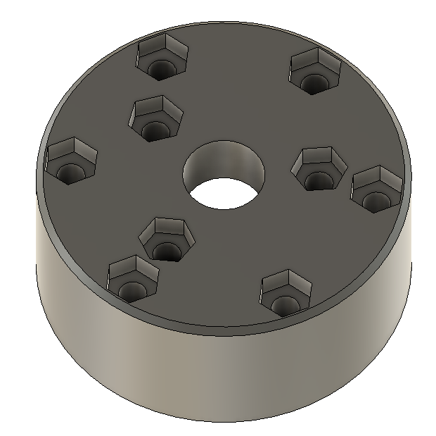

    Wheel coming along more, I made up a hub adapter to connect the shaft to a wheel.
    The standard 11t steel sprocket is secured into the adapter with 3 4mm bolts. Captive nuts on the back. There is about 1mm clearance to the motor body. I installed the bolts backwards for now because I could not be bothered shortening them...
    Printed in PETG @ 25% infill and 4 perimeters for good strength, plus the wheel bolts go all the way through so I don't see that there will be a problem with de-lamination of the layers.
    2018-11-18_22h14_28.png 2018-11-18_22h14_45.png 2018-11-19_08h45_24.png 2018-11-19_08h45_10.png
    Also some pics of the H Bridges
    Interestingly, the encoder that I have is supposed to have 2k pullups built in but I could not get it to work without them externally (the pullups I installed were 10k)

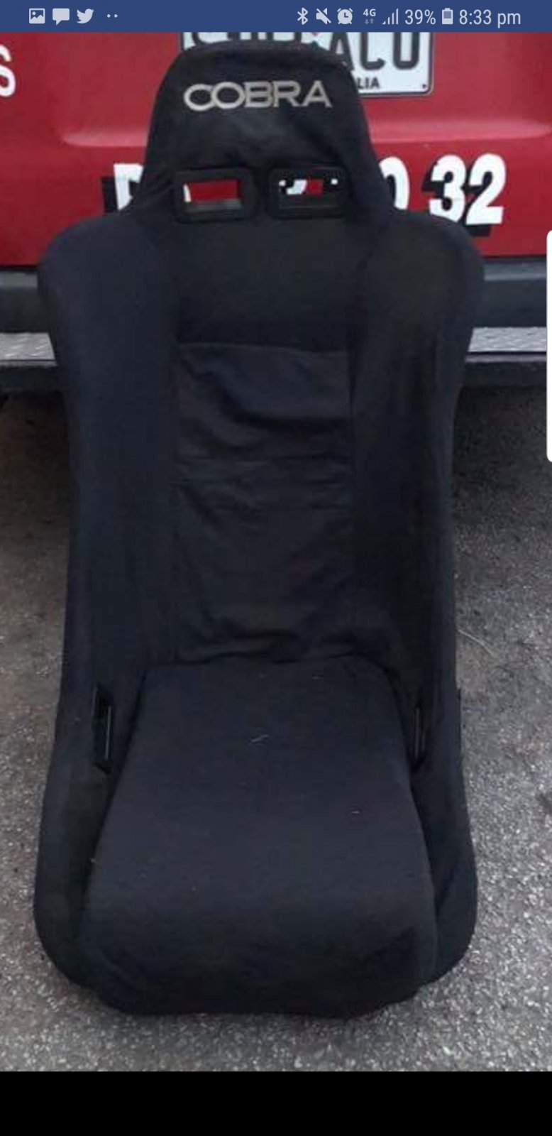

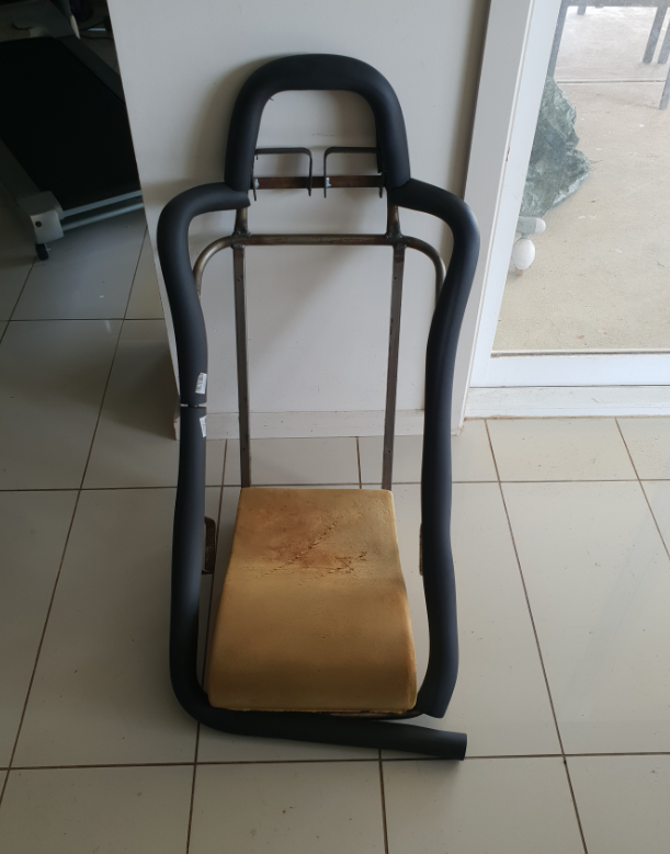

    I also picked up a race seat for free - It was basically useless but I removed the trim, repadded it all and retrimmed it in a faux suade...

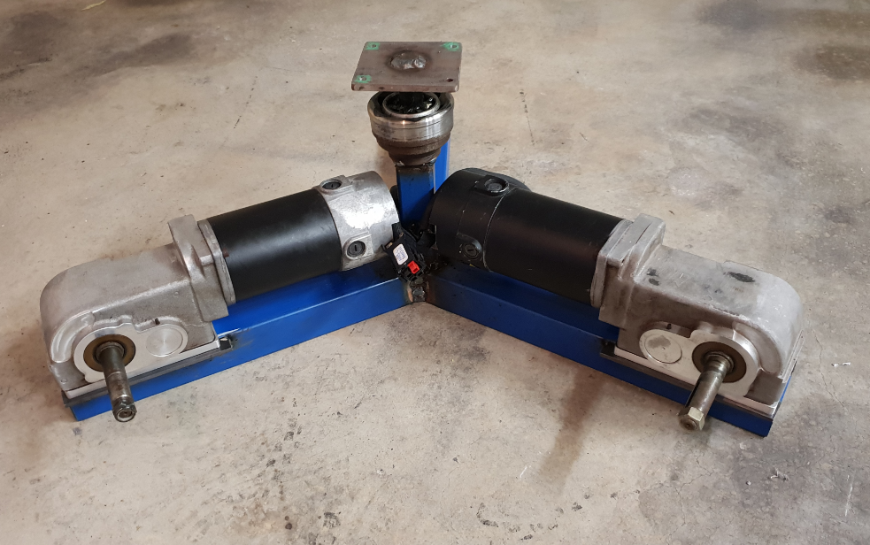

    Minor update
    Got the other motor gearbox cover machined up and mounted the motors to the frame
    5X20mm mild steel has been welded to the sides of the 50mm square tube to mount them. They use 5/16 UNC thread bolts (bloody Americans and their refusal to go metric!) - There is not quite enough clearance for a standard bolt, it needs to be a socket head bolt, will need to order some...
