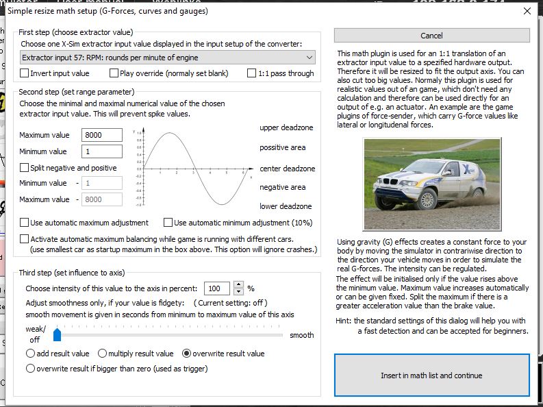

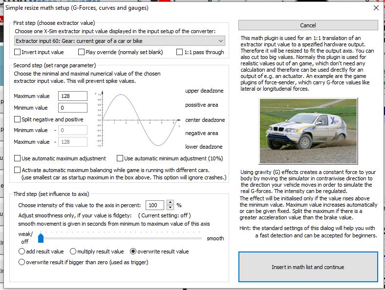

    Please note that this project was initially developed using the X-Sim package and my goal is to adapt the equivalent configuration to SimTools environment so the XSimulator community can also use it and tweak it as they like.

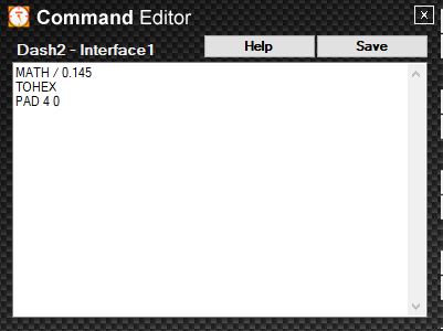

    I started to make some attempts at writing the right commands in Gamedash Command Editor to get smooth RPM input but I'm going blind since I have absolutely no clue what command I should use. X-Sim and Simtools interfaces are very different. I had perfect inputs with X-Sim. The motion I get now with Simtools Game Dash are not smooth and there's a huge lag although I'm using the same output rate. See the commands I'm using in the attached pic. Tks
    My goal is to achieve the same level of fidelity as the project depicted in this thread: https://www.xsimulator.net/community/threads/tacho-controller-arduino-e46-canbus.5463/#post-155294
    Anyone has a clue what command should I use for RPM with CAN-BUS system? Tks

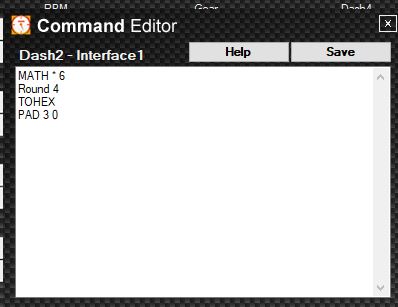

    And I tried these commands that give a better input but it is not a 100% perfect. Still a bit of lag-half-a-second-and I can't get the exact same revs as in Assetto Corsa, i.e. the car is reving from 950 to 7000 RPM and my dash goes from 700 RPM to 7500 RPM. I don't know how to tweak the data to match the RPM perfectly.

    I can't get speed to work with Gamedash Command Editor and Assetto Corsa. I tried many commands but none is working. So far I'm just getting RPM and it is not perfect. If someone has an idea what command I should use it will be welcomed. Without help with Gamedash commands I won't be able to advance that project further. My plan was to prepare a document with the complete procedure that I could share with the community. But until someone could provide me with some expertise with Gamedash I will have to put that project on ice.

    I'm also including the snips of the commands that I was using with X-Sim.

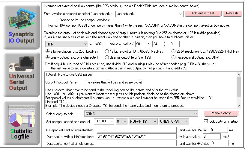

  18. yobuddy
    5,408
    50,691Coins
    +5,166 / 19 / -0
    Hi Buddy,
    So the output string for Game Dash would look like this:
    G<DashX>R<DashX>S<DashX>D<DashX>
    Where X is the dash value of the corresponding output for the game.
    And the output is a char Character from 0 to 255.
    Looks like we have:
    G for Gear?
    R for RPM?
    S for Speed?
    and D for?
    Let's take them one at a time.
    What game are you using for the tests?
    Dustin

    Yes, the string is correct. The D is for Digital Speed that sends speed data in a digital format to my little tm1638 display. I'm uploading a snip for gear. Below is the complete Arduino code for all the functions. The one shown in a previous comment was limited to Speed and RPM for testing purpose.

  20. yobuddy
    5,408
    50,691Coins
    +5,166 / 19 / -0
    So let's figure out what your code needs.
    Looks like the G is a single 8bit digit.
    (don't think you need this) - (gear = gear - 127; // offset the 0 value in 8-bit)
    (possible commands for G)
    Replace -1 255 (if -1 is reverse for the game, replace with what's used for the game)
    ToChr
    I just need to know how many char's are used for each (G, R, S, D)
    Chat soon,
